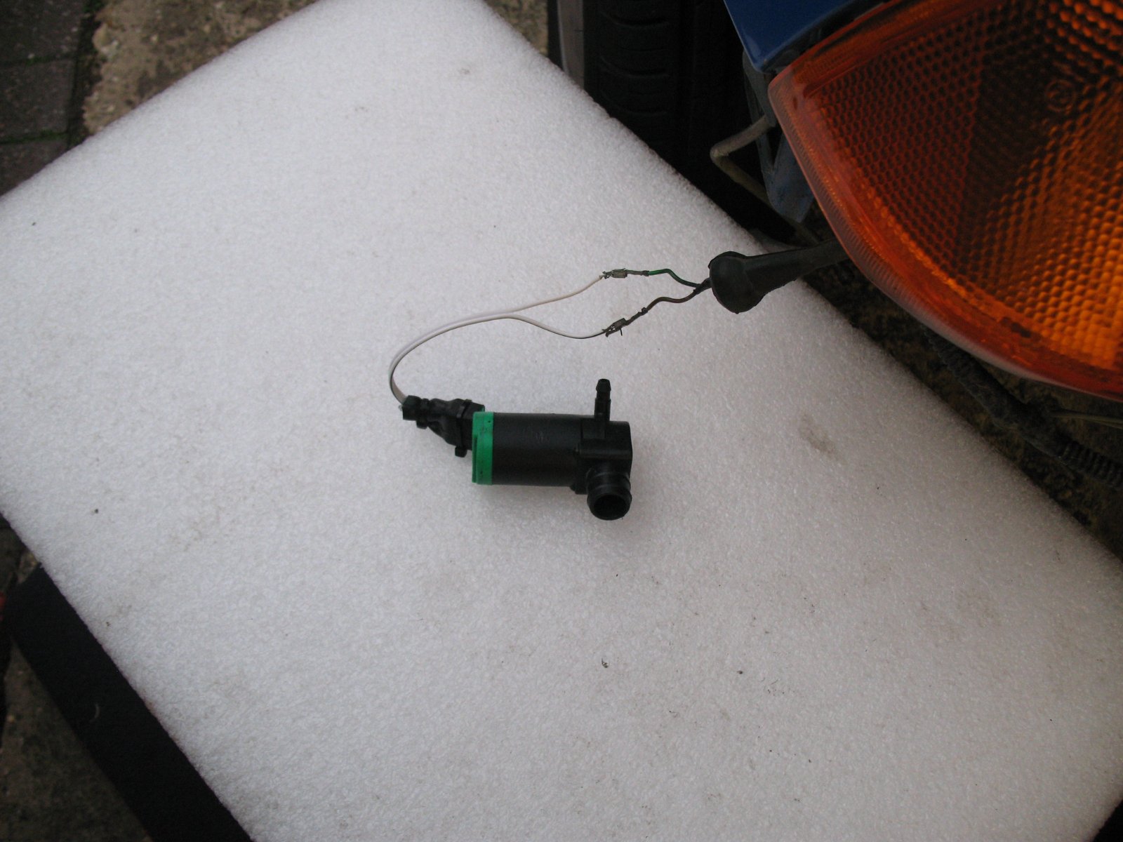

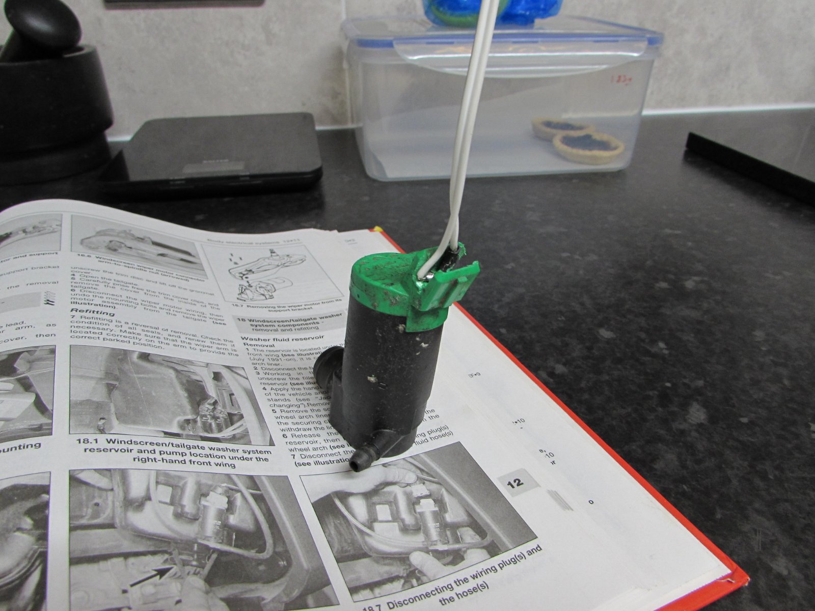

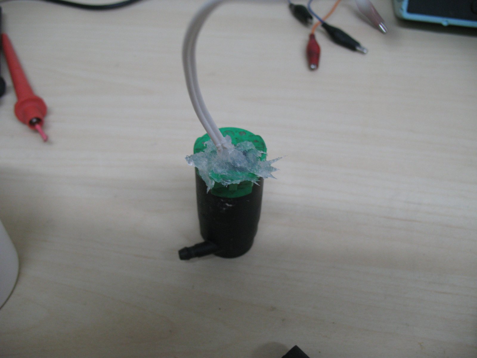

And a little bit of work with a junior hacksaw, a small file and a soldering iron has revived an otherwise scrap pump :D
A bit of temporary pluggery and sockertry and it'll live to wash a screen another day ;)
I do have a new pump on order and have sourced a replacement connector - they will be fitted when needed and for now can go into stock...

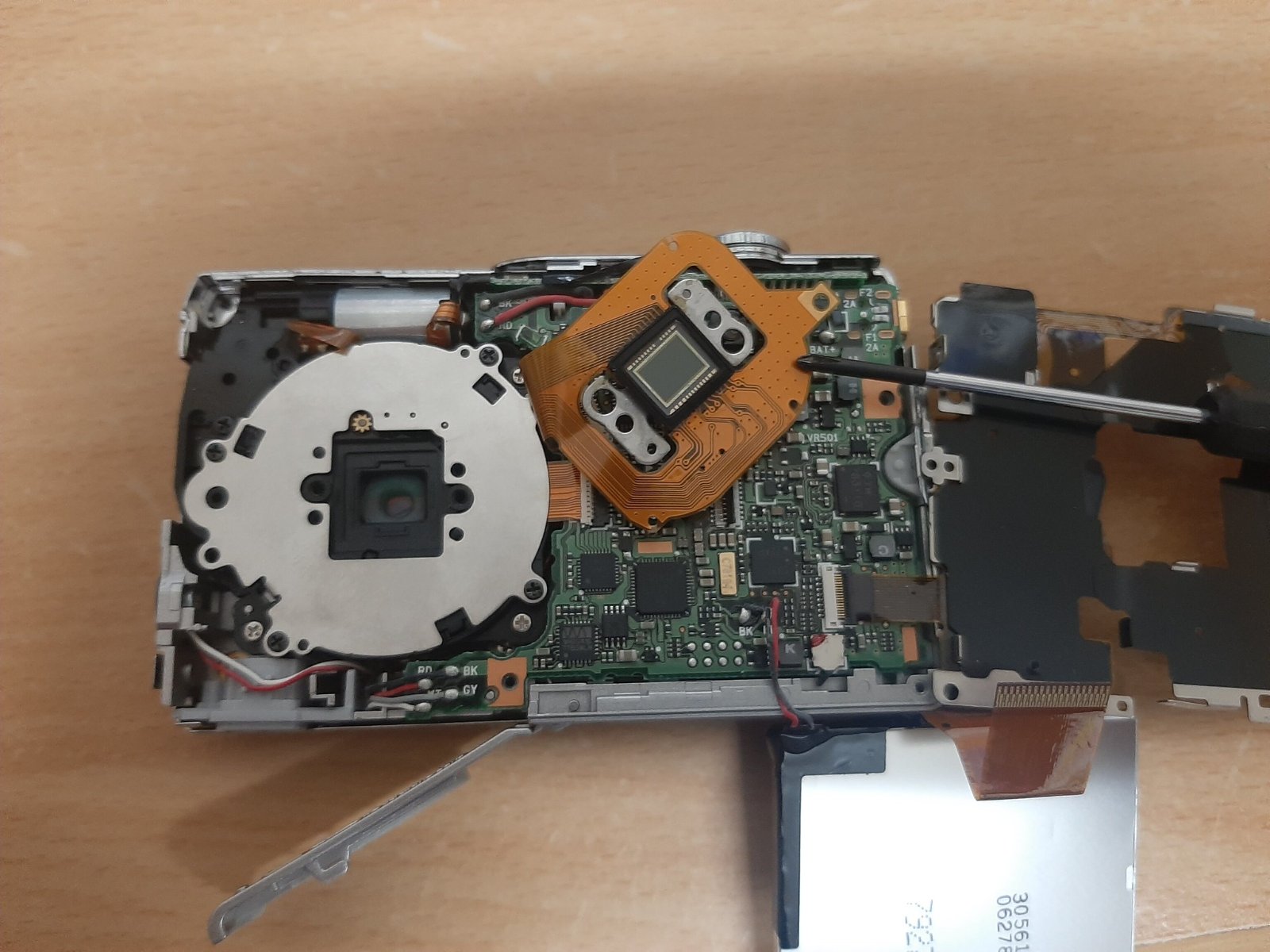

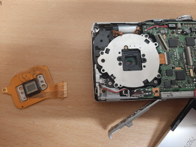

This afternoon, something very different and one to test my fine motor skills and eyesight... Many wars ago, dad bought a little Olympus digital camera and at the time, quite a good one. I used it for several years before smartphone cameras made it more or less redundant...
With my recently renewed interest in photography, I dug it out a couple of weeks ago and found the Imaging CCD had failed with random lines and breakup across it.
Today I plucked up the courage to strip it after a gentle exploratory investigation yesterday. I was keen to see if there might have been a bad connection to the CCD.

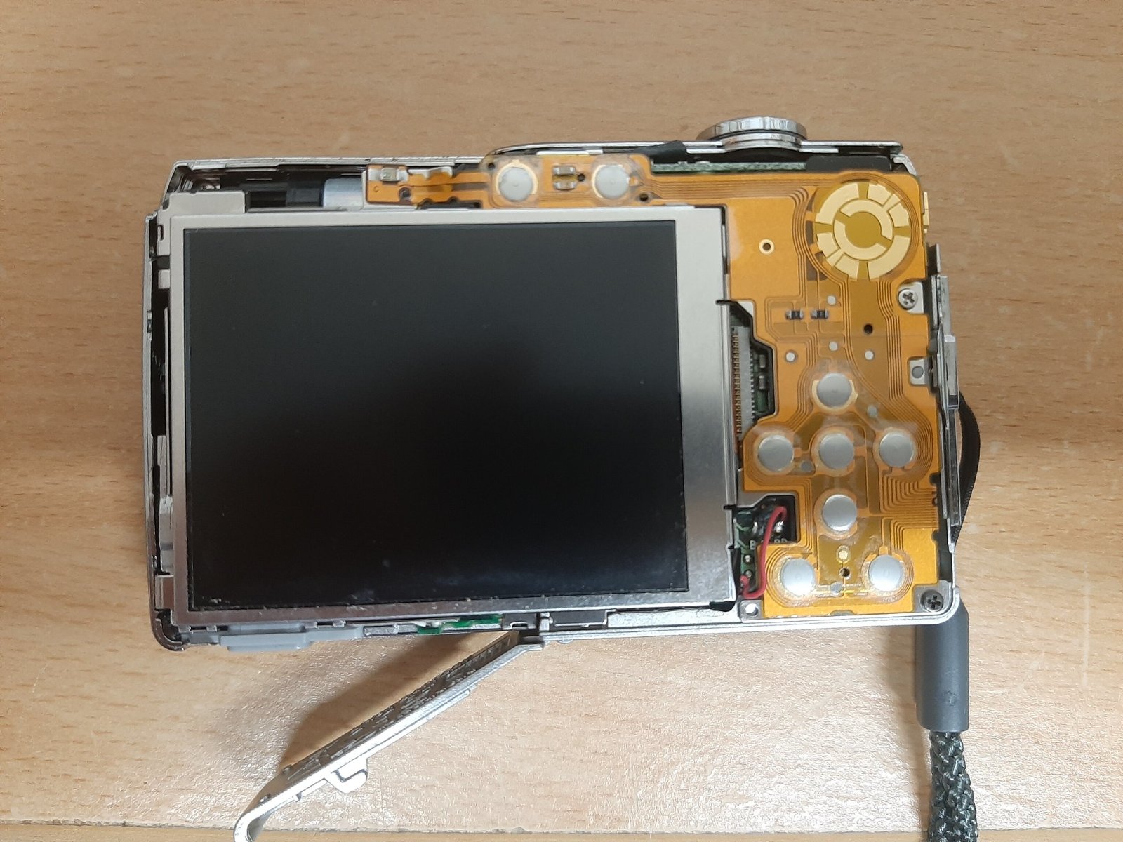

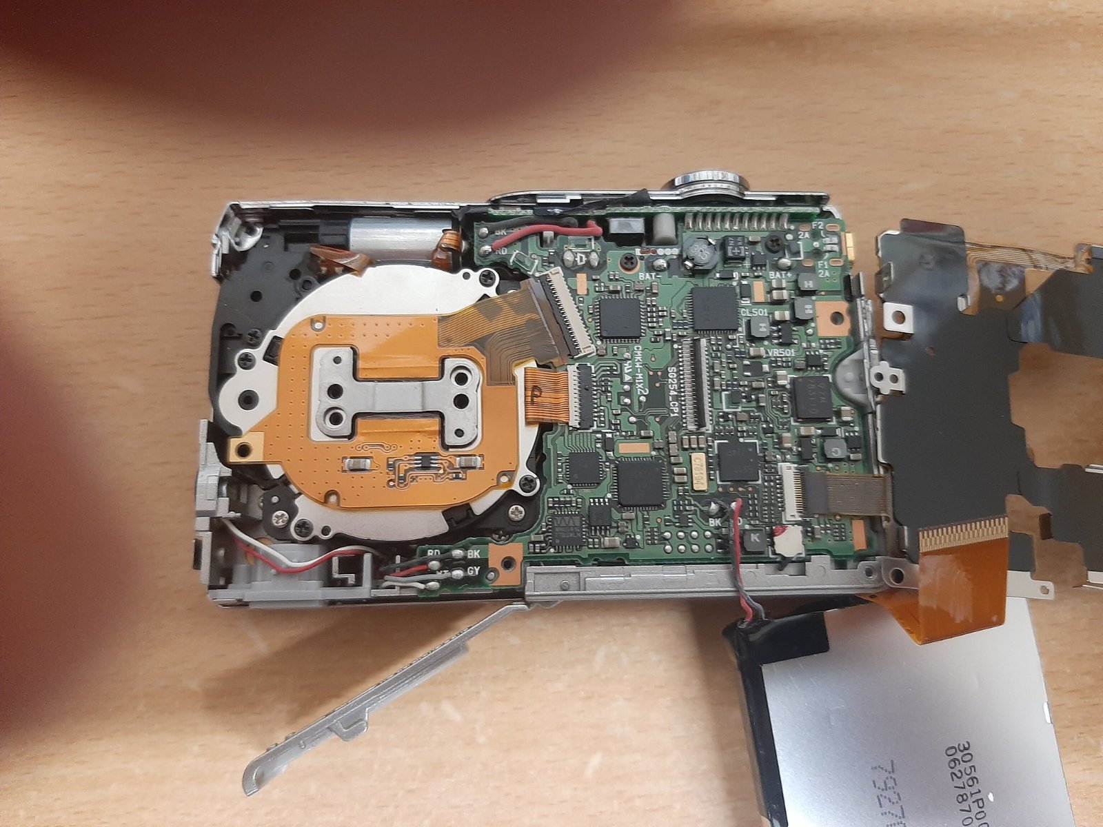

With the back removed...
Display screen moved out of the way...

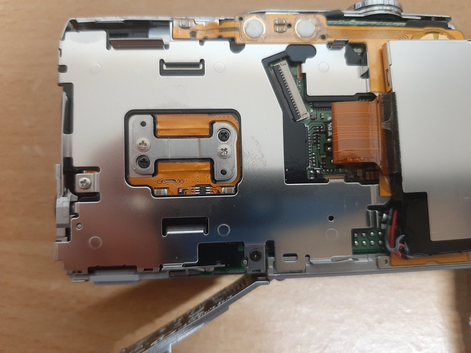

Screening plate removed after disconnecting the diaplay screen...
CCD Sensor prepared for removal...
And removed...
And removed...
I cleaned up the CCD and its connector with a bit of IPA and reassembled the camera...
It still works! The original fault remains however :(

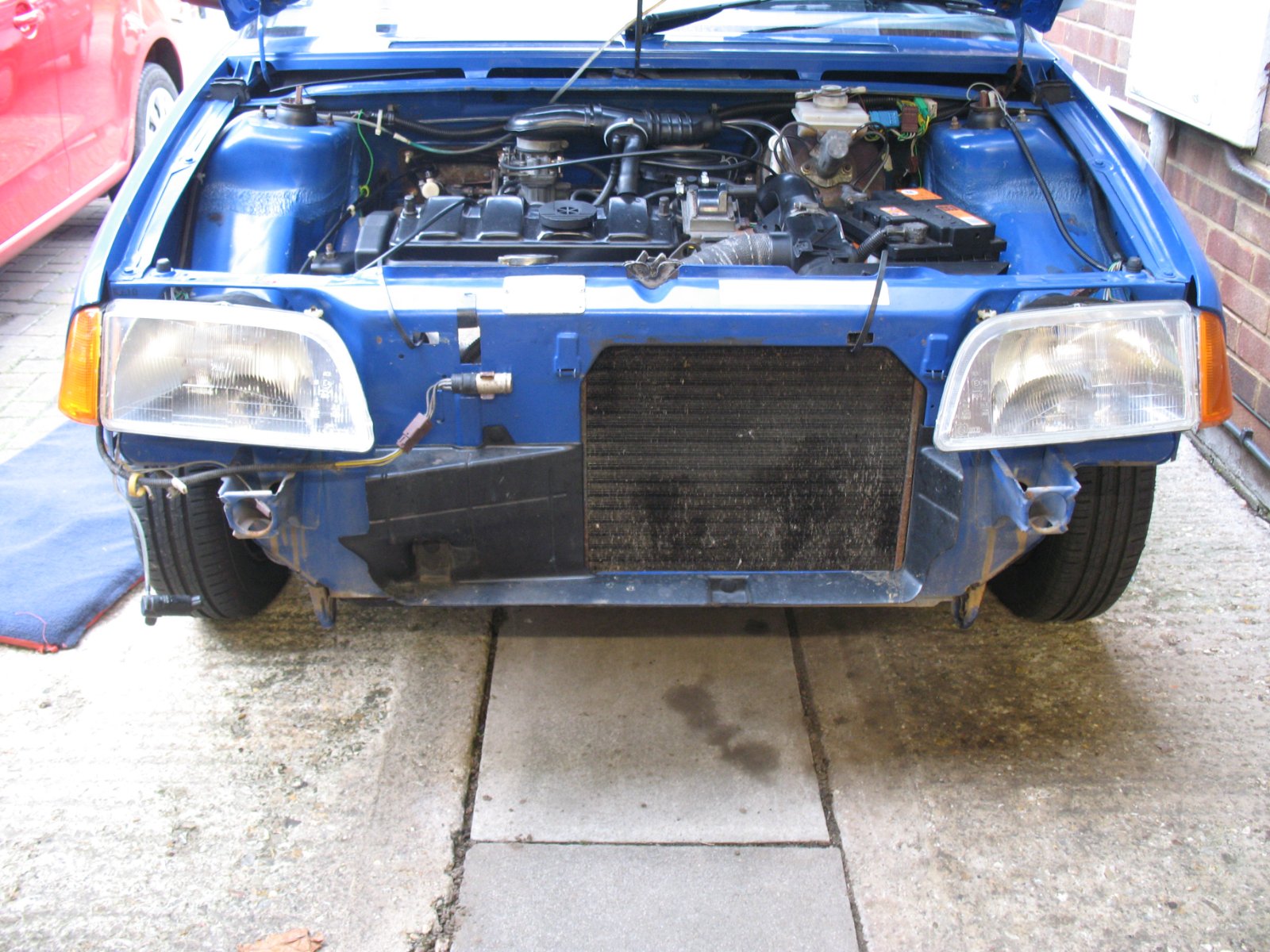

After a superb Club run this morning and after very successfully installing Windows 11 on one of my 'unsupported' laptops, I got back to work on Bluebell and her rear screen washer...

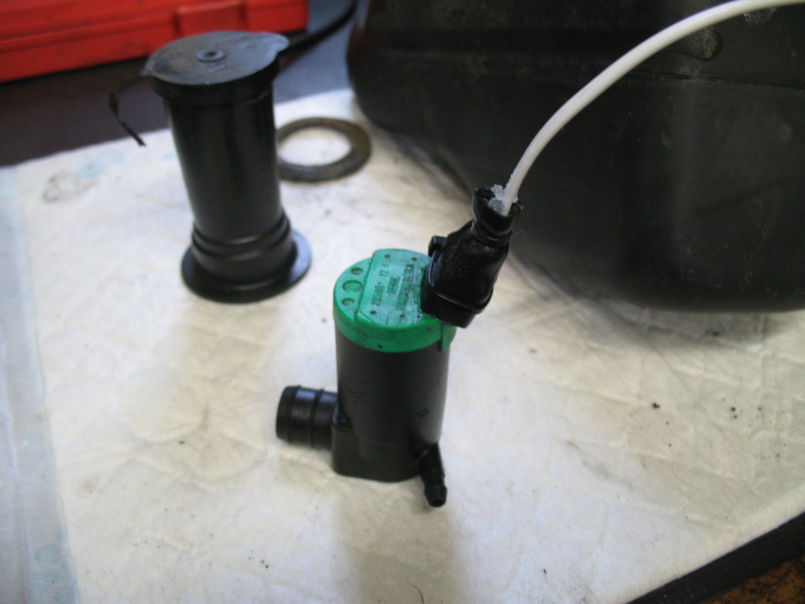

Late last week I'd 'repaired' the old washer pump and on Sunday I waterproofed the repair by using a bit of bike inner tube as a sleeve and filled it to the brim with silicone grease to keep the moisture out...

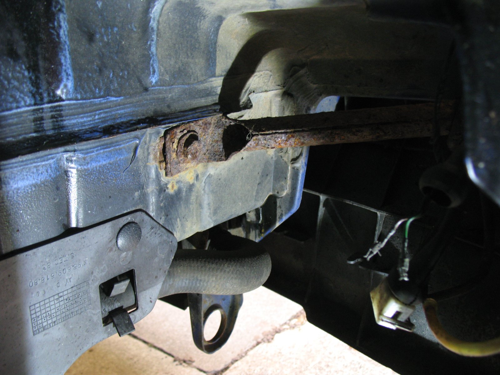

As the pump connector is broken and the old bits are corroded it proved necessary to remove the front bumper to do the job properly...

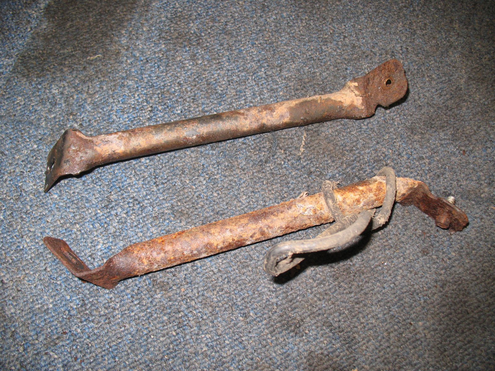

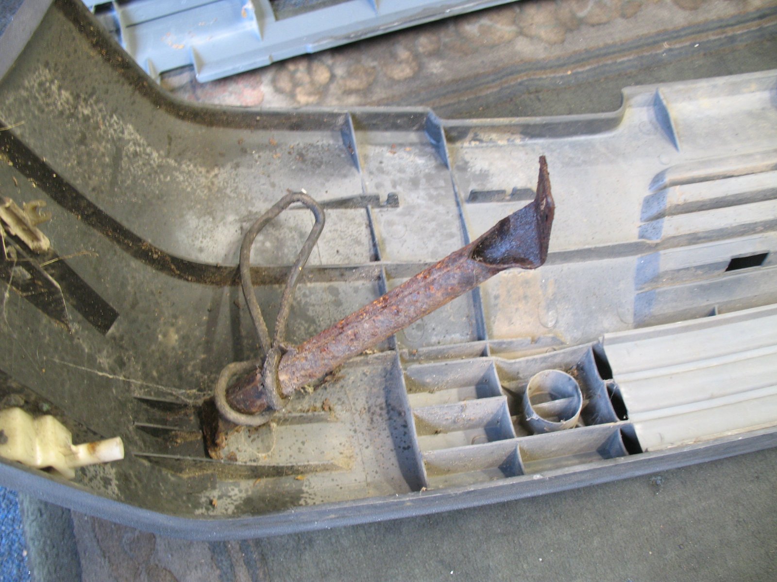

The bumper struts look very crusty...
They look a lot, lot worse than they are and the bolt came undone easily despite looking horrible. The chassis rail under is solid and is just dirty...

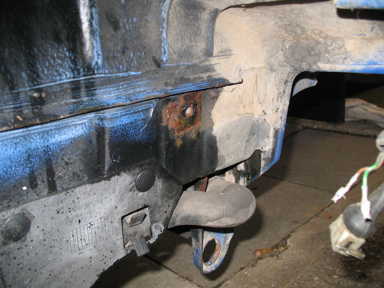

With the bumper off, the front panel is in very clean and good condition... What looks like rust is just muddy dirt :D

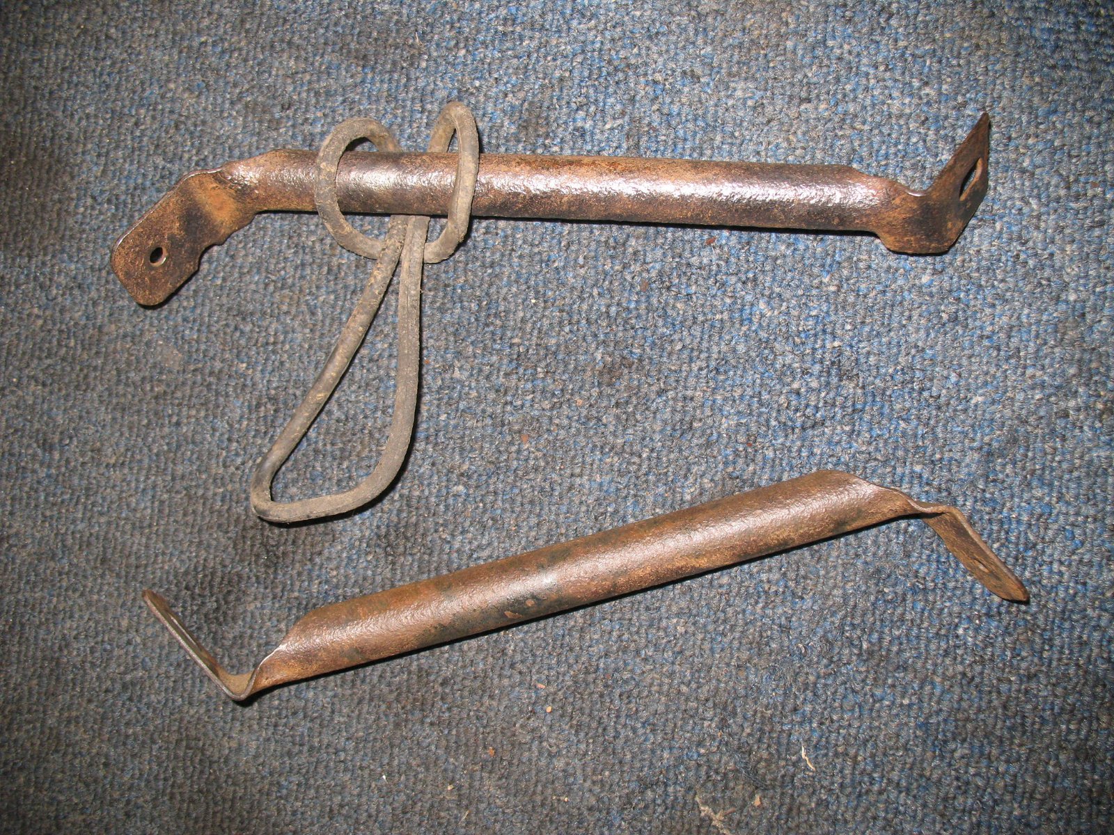

I gave some attention to the bumper struts... Both were full of old spiders webs! Both looked very crusty but after a session on the rotarty wire brush, they look much better... Both are absolutely solid...
Before...
Before...
After...
After...
The big rubber band secures the base of the washer reservoir...
I tested the washer pump and found I have a high resistance somewhere. Likely the ends of the wires are too corroded to pass enough current. A small bulb lights...
