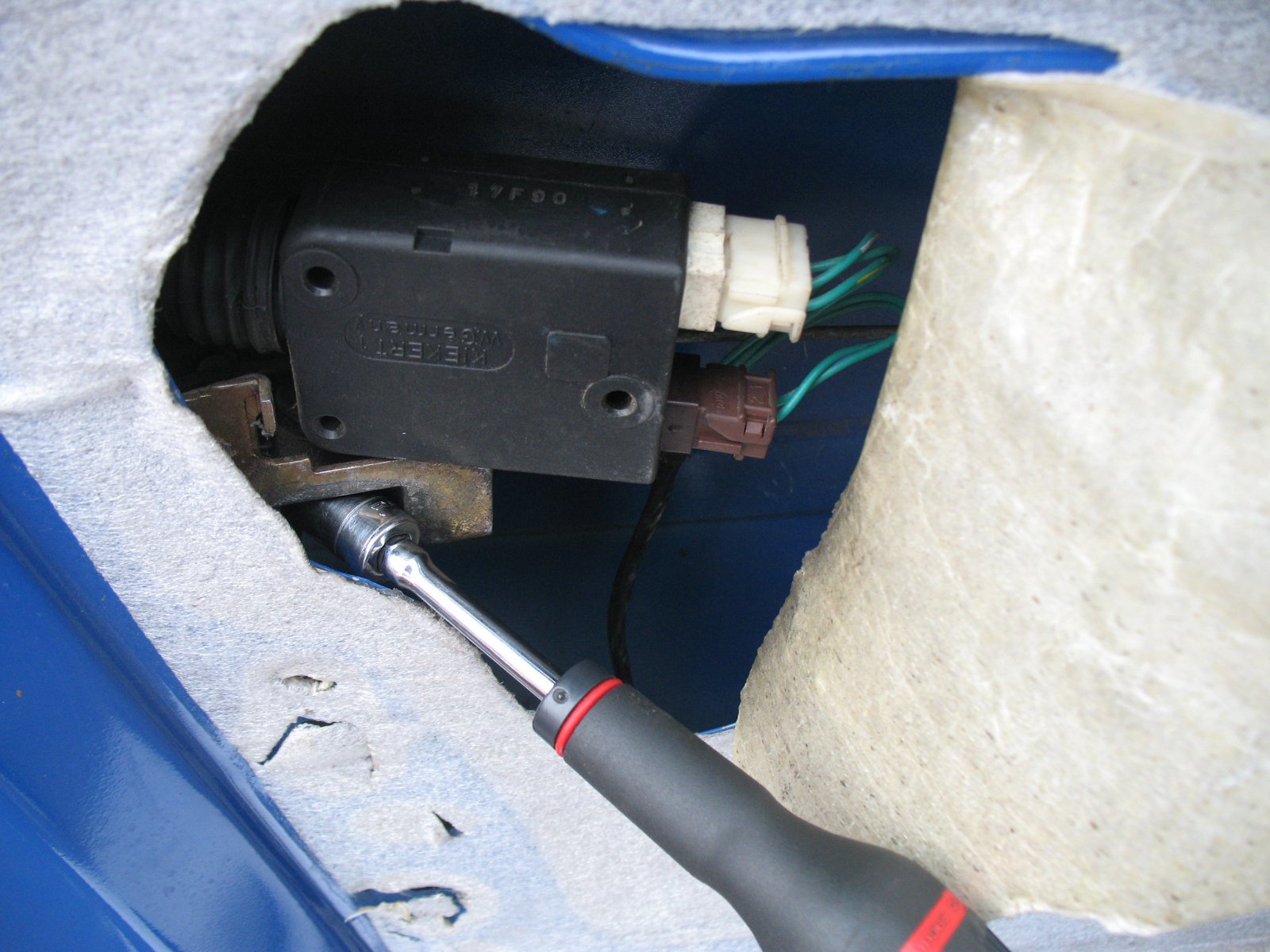

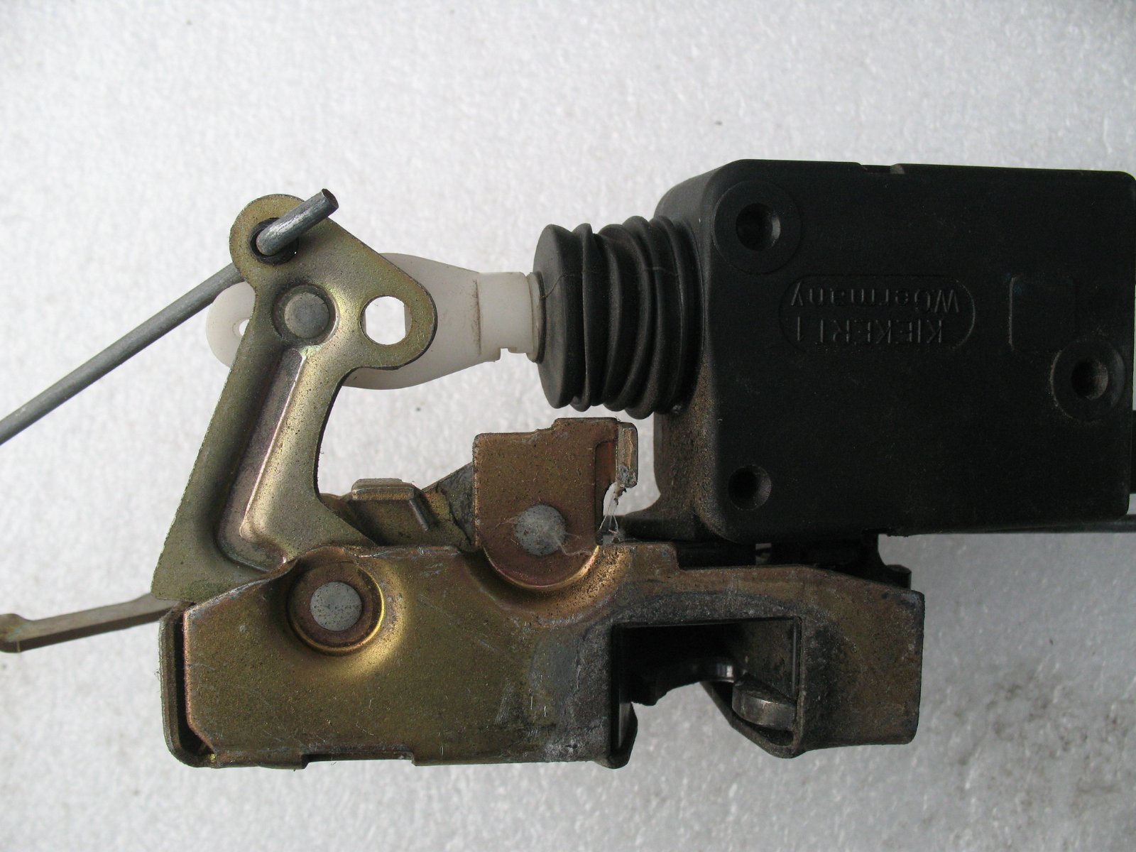

Fundamentally, the whole lock mechanism has to be removed. This involves removing the lock barrel and the window guide. Then after removing the door 'handle', the interior release lever and removing three screws the whole lock assembly can be slid out after rotating it through 45 degrees. Except, if the central locking motor is in place, it won't because the assembly is too big to slide along between the inner and outer door skins...

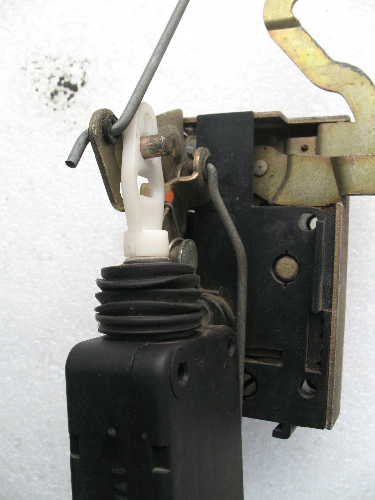

Luckily, the central locking motor fell off whilst I was trying to slide the assembly out and gave me a clue to the underlying problem...
Here it is hanging on its wires...

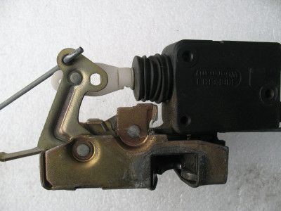

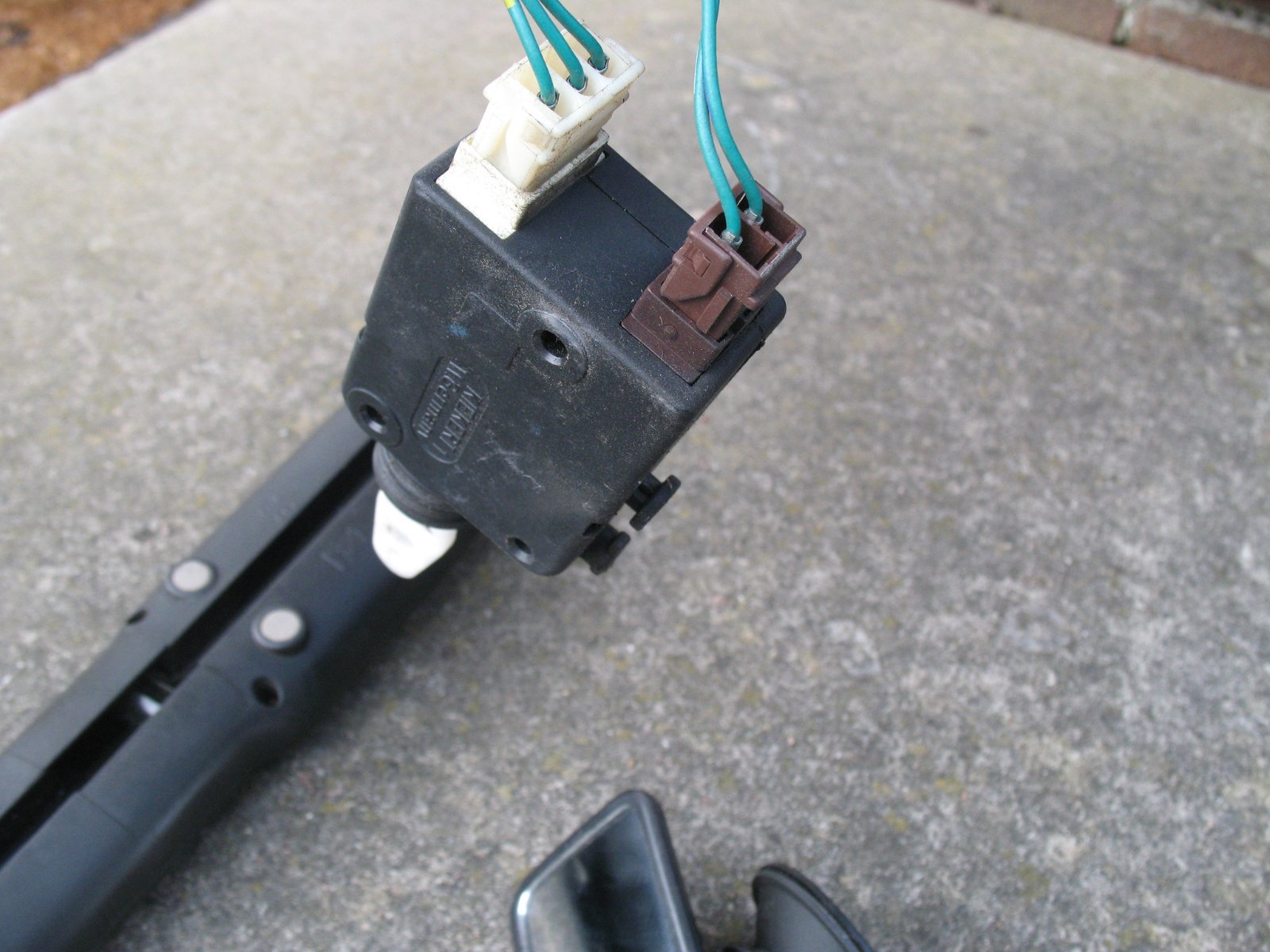

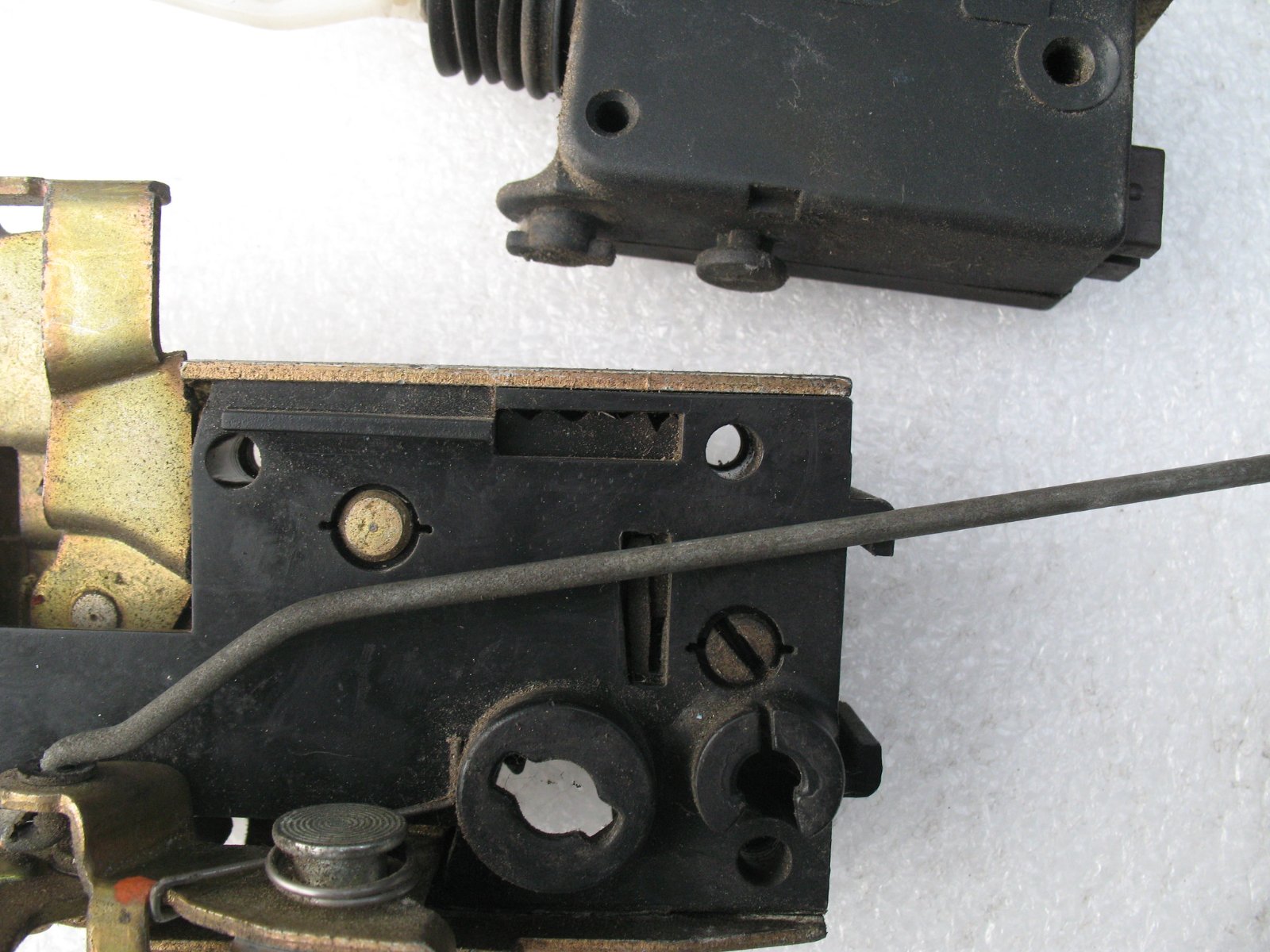

Once out, it can be seen the central locking motor clips onto it's sub-chassis via a bayonet and a rotation into a clip... Hard to explain but obvious when seen:
The original problem was that it had come unclipped and rotated. How and why I don't know for sure but have thoughts which is connected with something else I did on the door today. The clip when it's 'home' is very secure and tight and no way would it have fallen out of its own accord.
Reassembly is more or less a reversal but... The motor cannot be clipped home as the lock assembly is then too wide to slide back into place. It's necessary to initially have it half in position and then do the final push to clip it into its final place when the lock assembly is firmly screwed back home on the door. Tricky as you have to support the motor, the lock assembly and the rods to the lock button and interior release all simultaneously!
This gives an idea of how to initially position things... The socket driver is just there to support it all whilst I took a picture

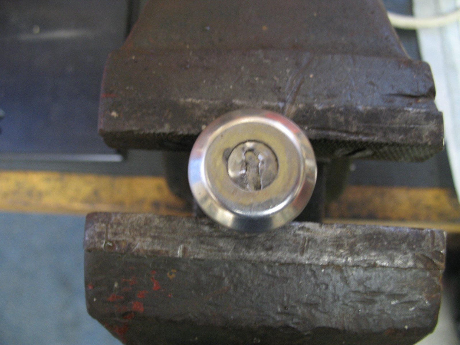

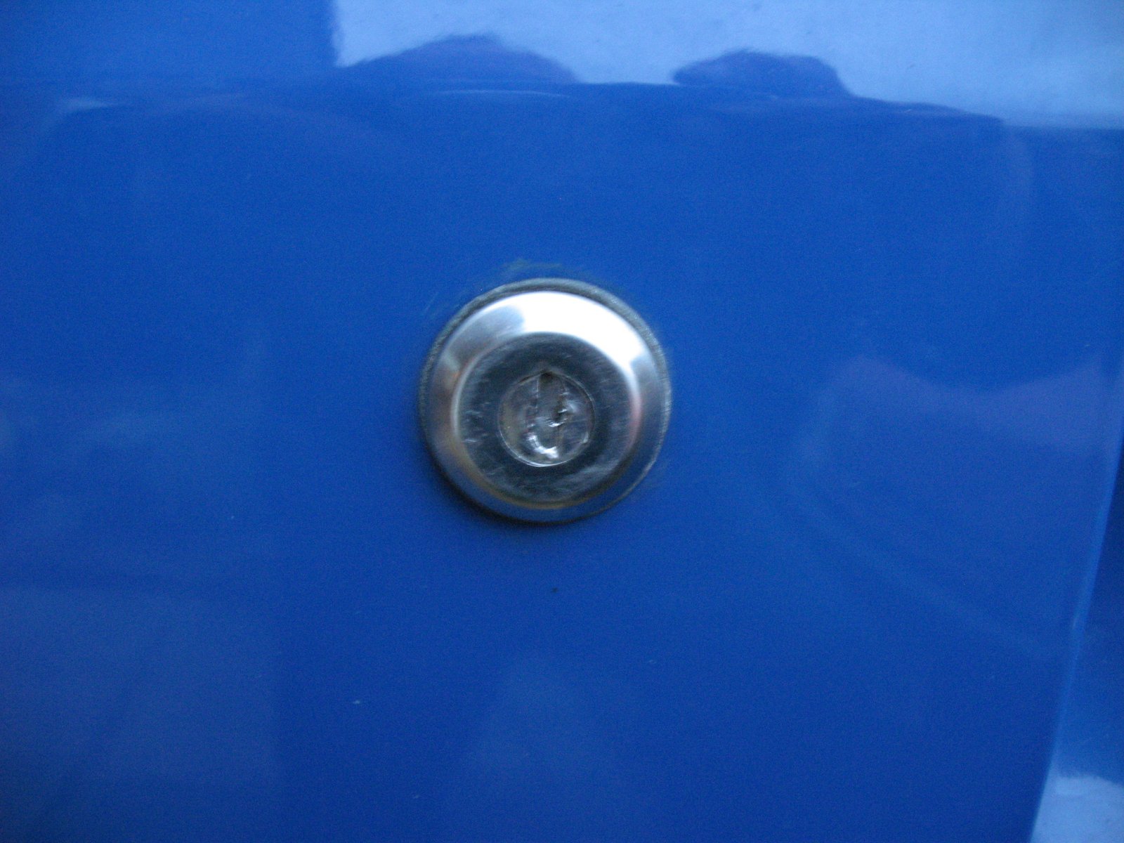

One thing that always niggled me was the damage to the door lock on the passenger side. At some point, I expect when the car was derelict, the lock was 'screwdrivered' to gain access due to lost keys. The lock barely worked... I think someone may have gone into the door to try to remove the lock in the past, gave up but in doing so, disturbed the central locking motor...
I had it all in bits, cleaned it up, battled a few 'pingfuckit' moments and did the best job I could to knock the bent and damaged shutter components back into some reasonable sort of shape. This job involved the unpeening of the bezel from the body and this took some doing to manage it without causing further damage.
No photos as I was too engrossed in what was a tricky job.
This is the lock with the bezel replaced and the shutters improved:
And back on the door... Not perfect but much better than it was and now the lock works smoothly.
