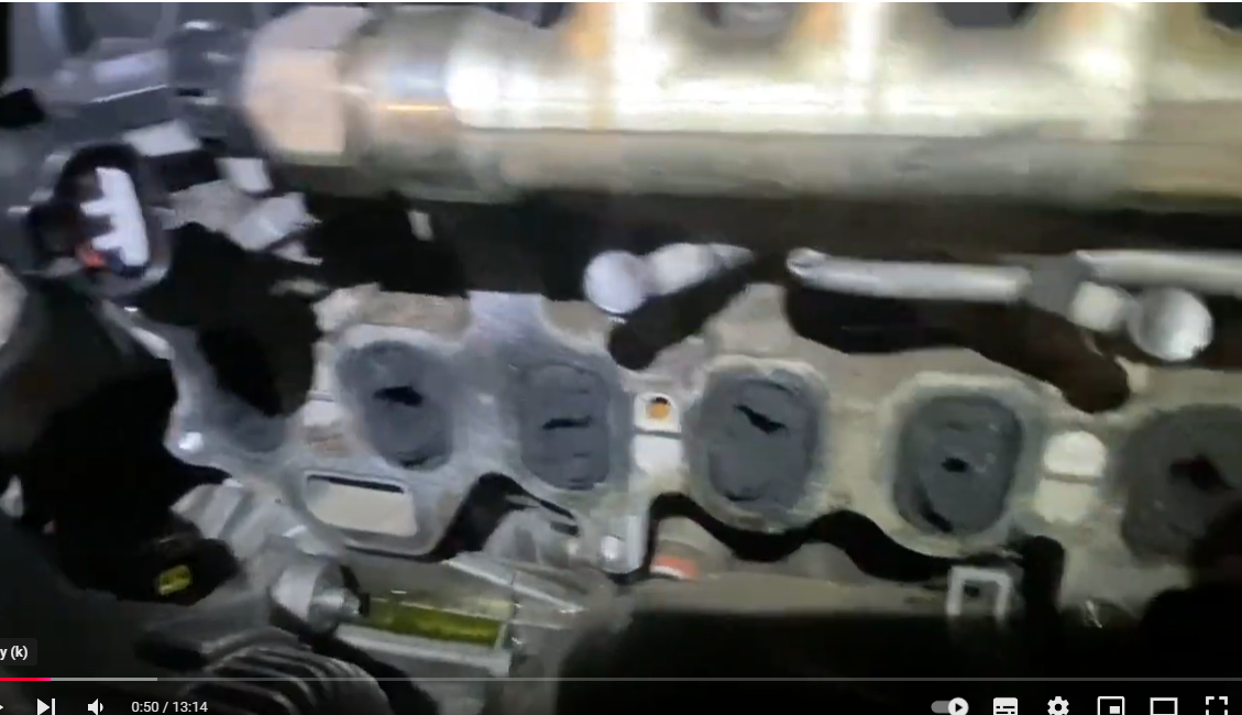

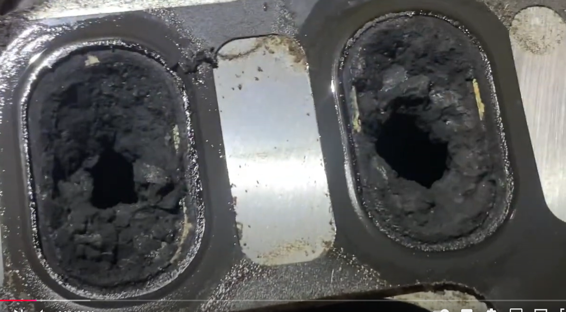

I very much doubt it, but nothing ventured, nothing gained! Here is a still from one of Peter Kennedy's vids to show just how blocked these can get:

Those stills are rather shocking... Amazed the engine could run at all

OMG ! That carbon is shocking.RichardW wrote: 18 Nov 2024, 13:59 I very much doubt it, but nothing ventured, nothing gained! Here is a still from one of Peter Kennedy's vids to show just how blocked these can get:

Ditto! That is amazingly clogged.
I'm wondering if it is more a case of a particularly poor PCV system?
Surely, if purely lots of soot from EGR only, it'd likely pass into engine fairly readily, but the PCV system providing lots of oily vapours is providing the nice sticky coating to the inside the manifold (and onto the layer of carbon) and allowing it to build up?
Just thinking aloud
