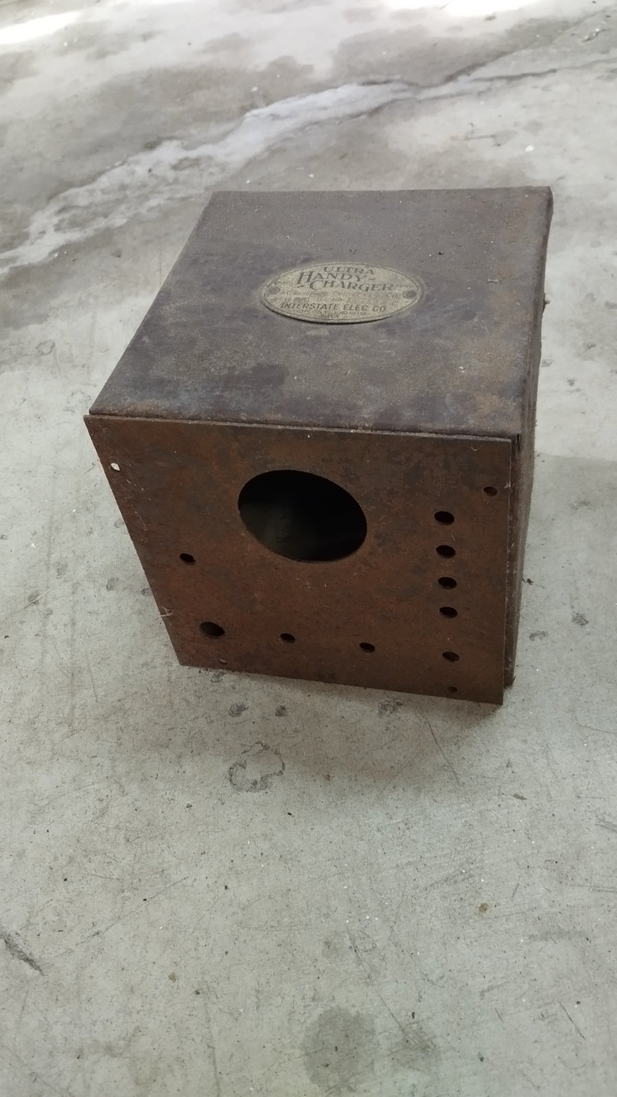

I am back in NZ and I dug out the old charger, which turns out to be in a worse state than I remembered. I last saw it 25 years ago, and my dad partly dismantled it 40 or 50 years ago....

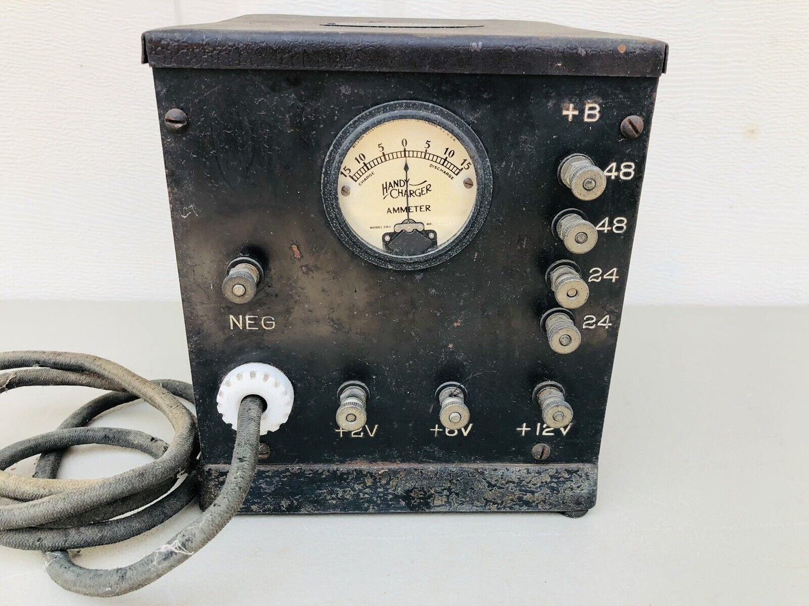

Having see the name plate, I did a web search and there is an almost identical unit on ebay.com which is much more photogenic:
Now here is my sorry example:
I am now hoping that I find another box containing the ammeter and screws. I am not confident. The transformer on mine also needs rewinding....

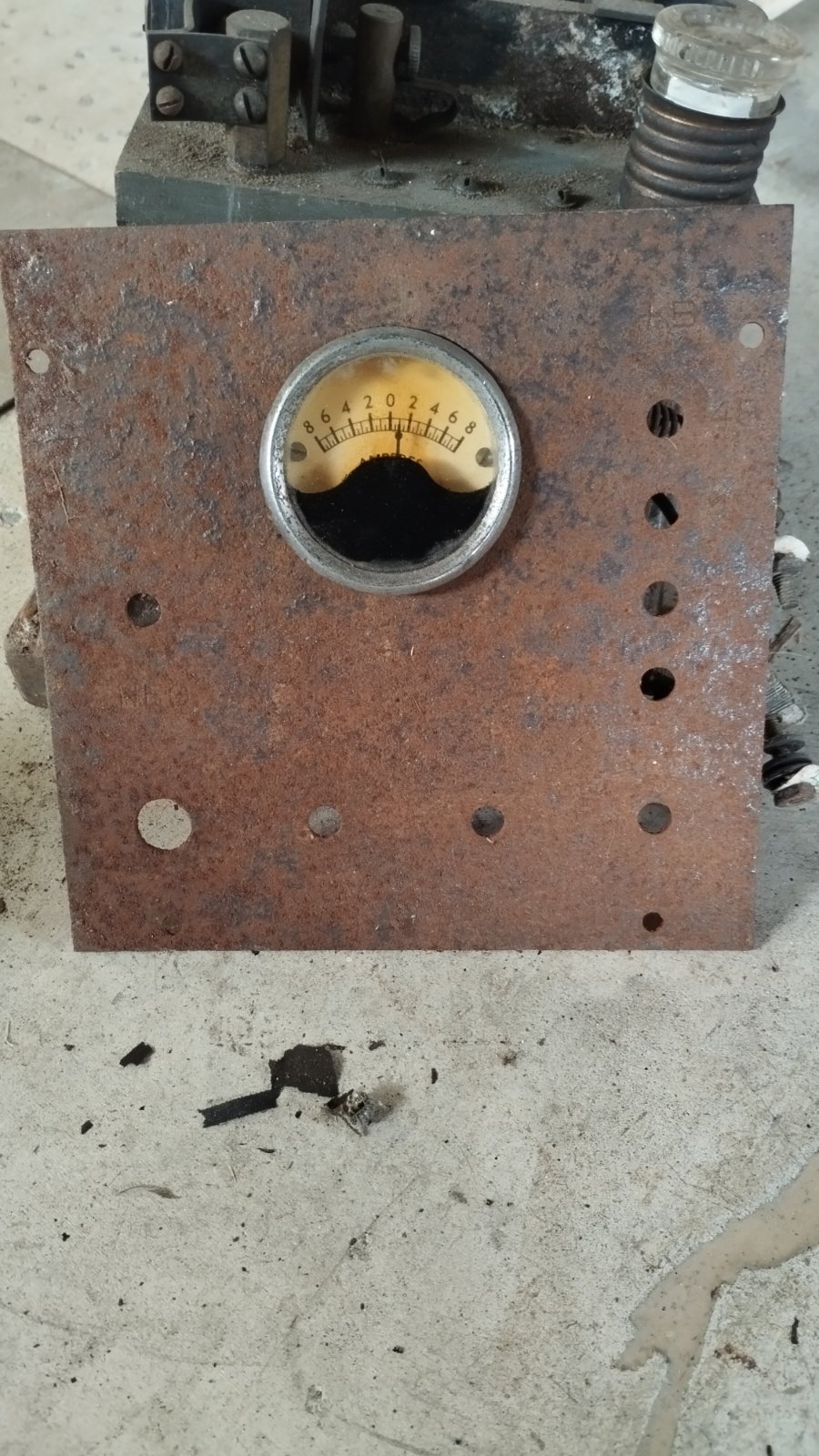

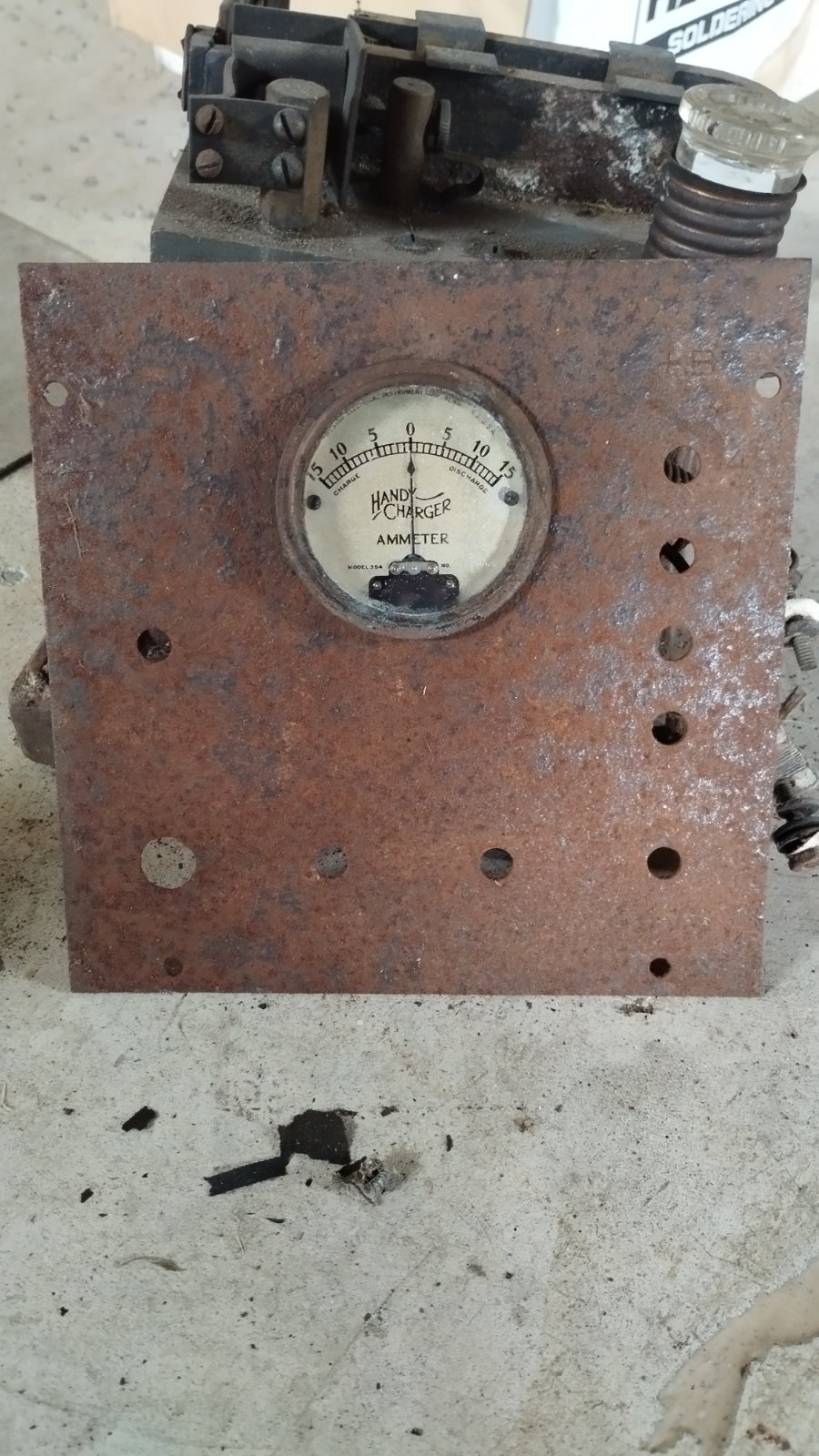

I ventured to the back of the garage today and on the top self was a wooden box with the label "Good Meters" in my dads writing. Fortunately it was one of the few boxes which had not fallen in the 2011 earthquake. I rummaged though the box and found this, which is only about 60 years old, but looks like it has been in use for 100 years.

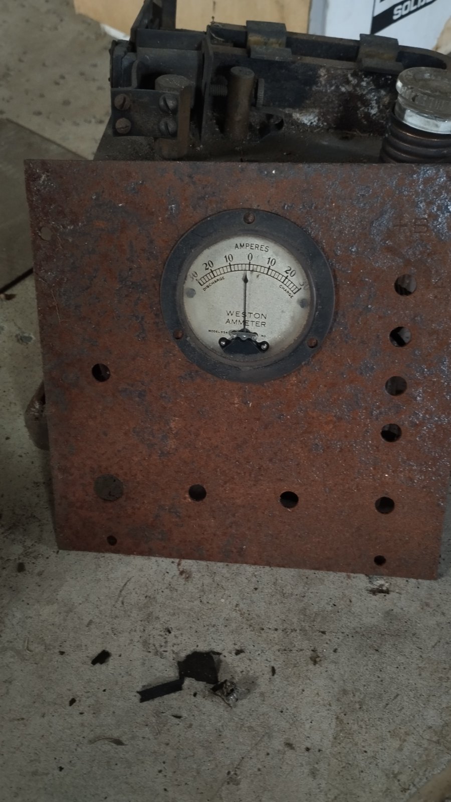

I rummaged some more and found this, which is period correct, and even the corred make, but the range and mounting are wrong.
Getting right to the bottom of the box, I found....

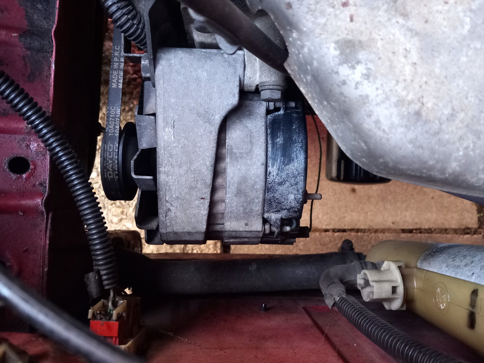

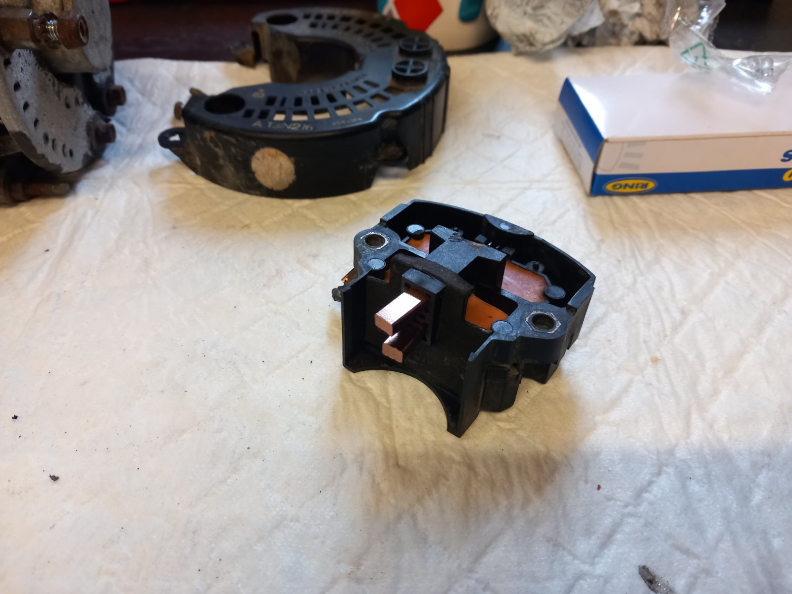

After a lovely 8 mile run early on, I fitted the new alternator brushes:
Then the alternator was reassembled and crudely bench-tested by connecting a battery between its frame and the big B+ terminal and taking the ignition (charge) light terminal to the battery positive via a 2.2 ohm resistor. Spin the alternator by hand with the battery disconnected and observe it spins easily. Connect the battery and note now how much harder it is to spin it - indicating the rotor is now nicely magnetised by the excitation voltage produced by the regulator module. Disconnect the resistor whilst leaving the battery connected to B+ and frame and it will spin easily again as the magnetic field collapses.
If that happens then chances are all is good. A further test is to connect a voltmeter across the battery and see the voltage rise as you spin the alternator. You don't need to spin it very fast at all to see it start to charge the battery.
The ignition light circuit is essential to excite the alternator. The test resistor above effectively takes the place of the ignition bulb on the dash and its bypass resistor.
Those tests passed, I installed it into Strawberry for the ultimate test ;)
All is good :D It was interesting to note the alternator on Strawberry was a Mitsubishi. It's the first TU engined car I've ever seen to not have a Valeo/Paris-Rhone alternator fitted...

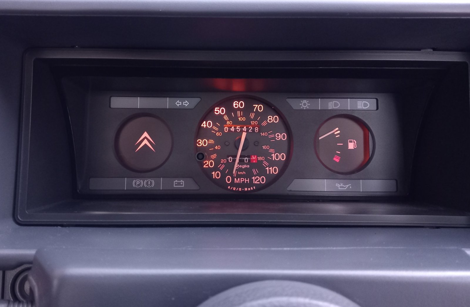

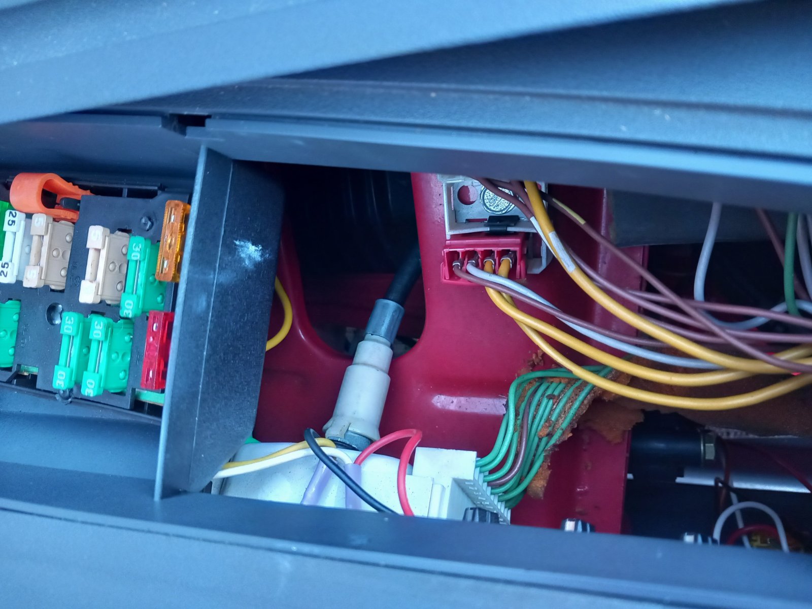

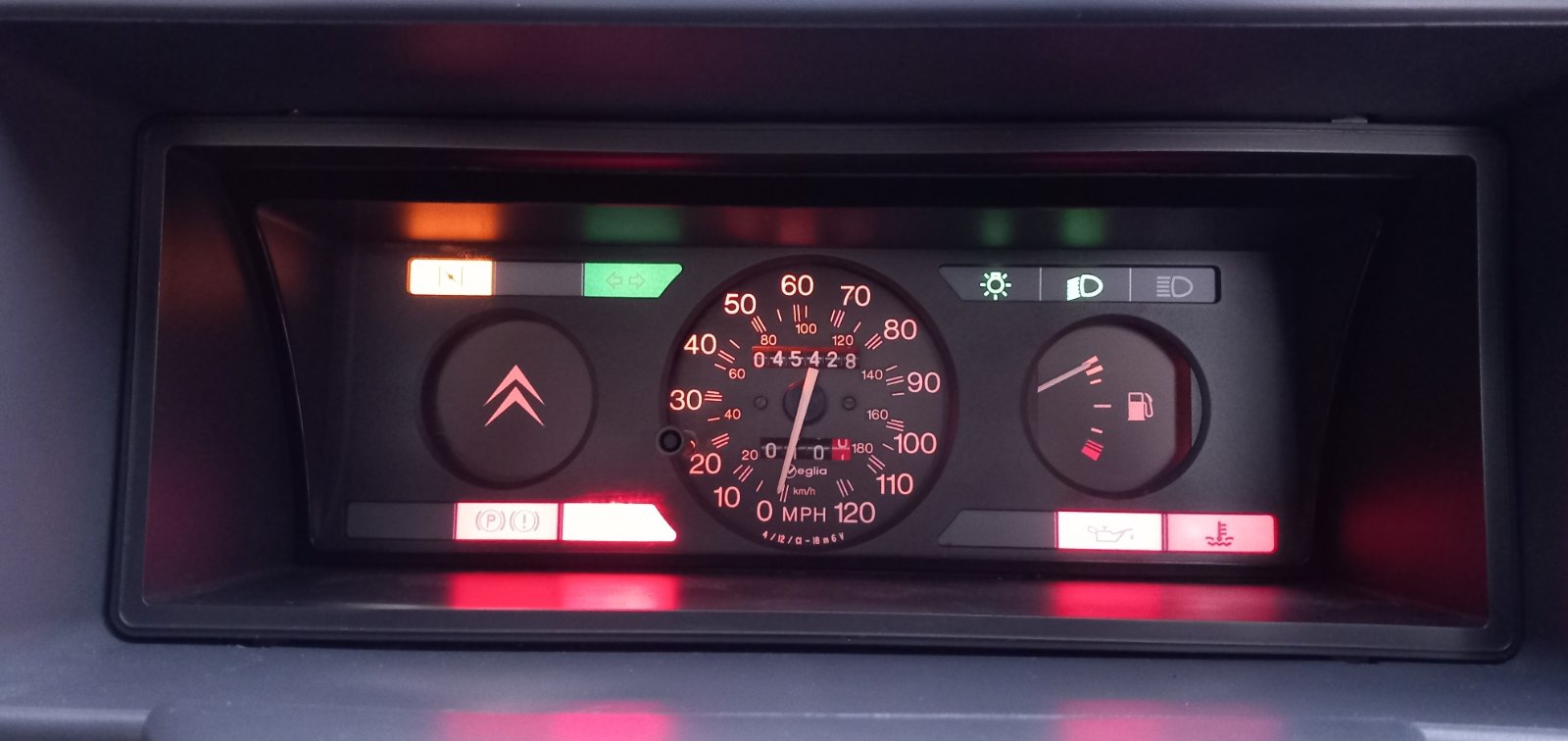

That done, I addressed Strawberry's irritating lack of instrument pod illumination. Steering wheel off and fuse box cover lifted to give access to the Speedo drive and the connectors. All very easy to disconnect with girly fingers like mine.
So much easier in a Series 1 AX; in a Series 2 it's a right old hand-shredding faff :(

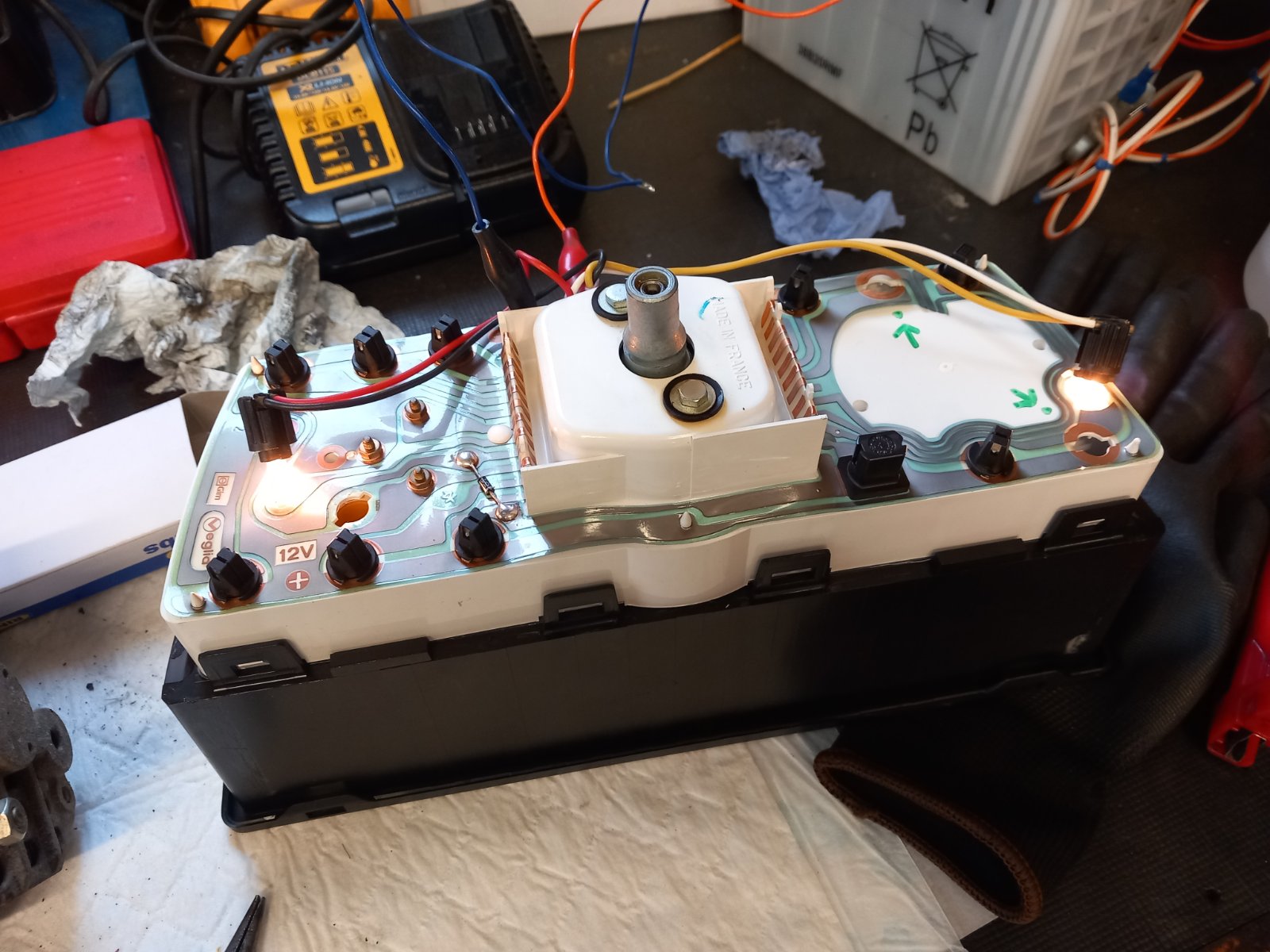

Pod out and on the bench, I replaced the blown bulbs and tested before reinstalling:
The result :D
That's better!

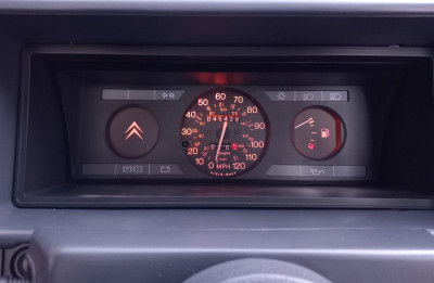

And finally, a test of all warning lights :)
I'm happy now :D
