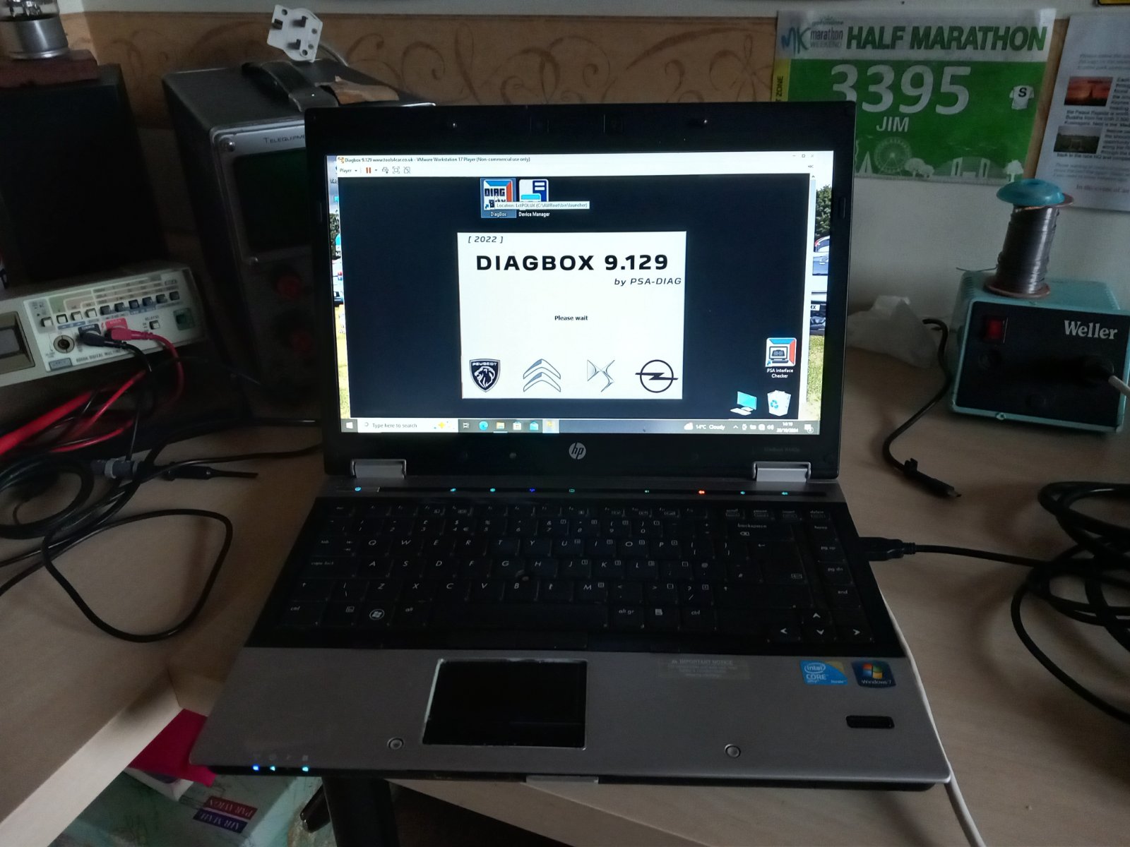

A cautionary tale of the propensity of a Solid State Drive (SSD) to suffer 'bit rot' if not kept in regular use has been very clearly observed today...
It's been ages since I've fired up my Diagbox laptop and thought I should, taking into account the above... Too late
It seemed to boot normally initially and I could start Diagbox in the VM. Then the underlying OS started to reboot at random short intervals, blue screen and occasionally claim the hard disk was missing. Finally, it became impossible to start the VM.
A Windows update resolved the issues with the underlying OS but the Diagbox VM was sufficiently corrupt it needed a reinstall from scratch; even the source files were corrupt and failed to extract in WinRAR with CRC errors. Good job I had the files safely backed up on an old-school hard disk!
All is good again but it does underline how SSDs should be kept in regular use and never used for archival storage...
I must now remember to fire up the Diagbox laptop regularly...
The SSD in use in the Diagbox laptop is identical to the ones fitted to both my constantly in use Win. 10 laptops and they have been fine.

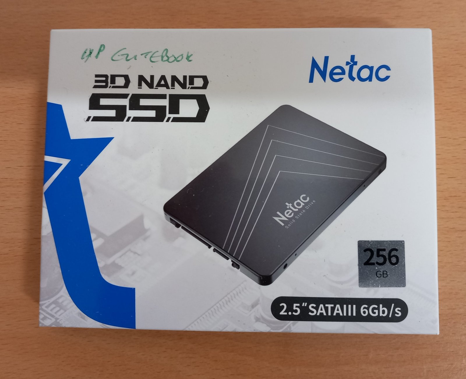

I'm in agreement with that Zel... It was about 3 months I'd say... And I think it's a bit poor.Zelandeth wrote: 27 Oct 2024, 12:40 I know SSDs aren't suitable for archival storage, but even so it shouldn't die if left sitting for a couple of months. Something is far wrong there.
These are the disks in question:
I bought three in total, all from the same eBay supplier. The ones heartily endorsed by a number of the Vintage Radio forum members and from their recommended supplier, being aware of the fakery that goes on...
Who knows, the one in question might be a fake... A good chance I suppose... They were not massively expensive.
There was a very long, detailed and interesting thread on there about SSDs, their fakers and susceptibility to bit-rot...
I can't post the link here as it's in the members-only area and one only accessible after a minimum number of posts have been made...
Two of mine were 512GB ones, bought a few days apart, and have been, touch wood, faultless in my regularly used Win 10 Laptops and this one pictured, a 256GB one, was bought a bit later for my Diagbox machine...
From now on I'll fire up my Diagbox machine on a regular basis and see how it goes... Given the behaviour of the Diagbox machine, my first thought was an intermittent hardware fault but after updating the underlying OS it then ran fine for over 24 hours so that's now less likely. Only time will tell on this one...

Interesting. Only ones I've bought in the last 10 years have been Samsung or Western Digital. Thus far no issues to report.
One has a relatively low state of health reported through the self monitoring system. Though I reckon that's largely down to having spent three or four years 24/7 in a system that was too old to have an SSD aware BIOS, so the Trim functionality and other OS optimisations to help look after an SSD weren't available. There were a number of cludges involved in that machine - the oddball 32-bit UEFI boot environment (it was a 64-bit machine) being one of the most annoying as it requires non-standard install media to make things actually boot. I guess that's what you get with old Apple hardware though when you're not running their OS. Credit where it's due though - I was still using it as my main machine until less than two years ago. It also cost me nothing saved for the £30 or so of ECC memory I needed to max it out at 64Gb. Was purely the CPUs that really were starting to be a bottleneck though. A pair of Xeon 5365s were stormers in their day (4 cores each at 3GHz), their architecture was just showing it's age. Oh, and it's ability to turn the computer into a very effective space heater when busy. Still a lovely bit of industrial design though.
I can't actually remember which one that is...I *think* it's the one which currently has Windows on. I'll need to have another look at the Smart data to see if the state of health reading has changed since I last looked. I'm guessing the answer is most likely going to be a no though.
Of course unlike Windows, at the very least all the mainstream Debian based Linux distributions do read that data, and will pop up warnings if anything untoward is recorded. Something which did save me a bunch of hassle ~15 years ago when I had a hard drive randomly die. It noted the throughput performance had dropped sharply, warned me that the drive was likely failing, and gave me time to take an updated backup before it died completely (or rather was wiped then sent back to the manufacturer as it was still under warranty - by about a fortnight!). I really don't understand what possible excuse Microsoft can justify as their reason for not giving you access to that diagnostic data. I guess it's only a 30-ish year old protocol, maybe still too new fangled for them.
