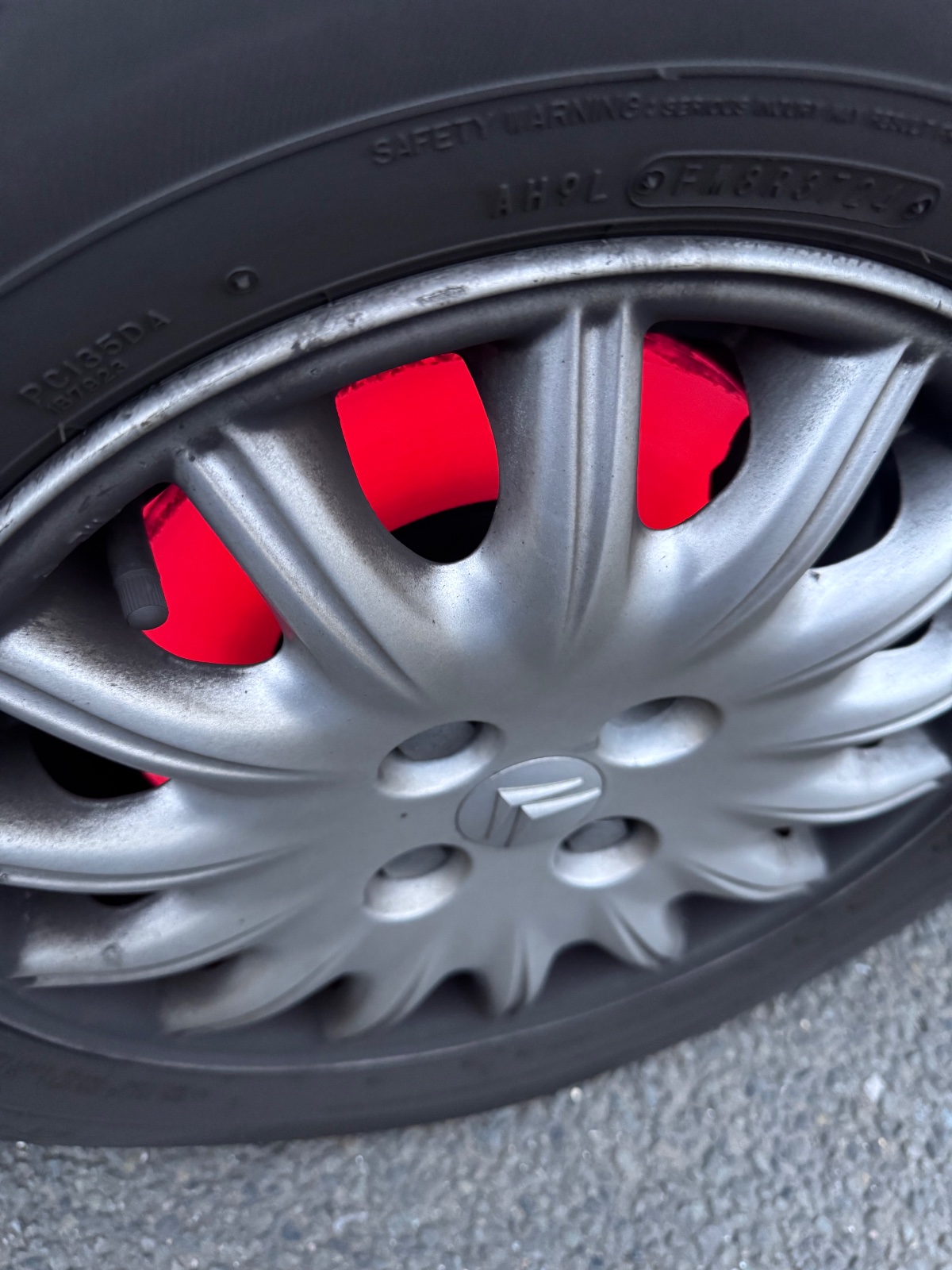

Re: C5 2.2HDi 2001 Front Brake Caliper handbrake seizure
I clearly tempted fate by replying to this topic…
Last night! (Pic taken after blowing out the flames from the pads)
