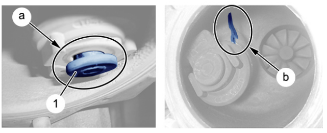

Check the turbocharger wastegate (1).
In the presence of traces of wear (in "a") or in the presence of cracks (in "b"): Carry out intervention 4 (The relief valve
discharge (1) of the turbocharger is no longer watertight).
In the absence of signs of wear (in "a") and in the absence of cracks (in "b"): Do not apply this document; Perform
thorough troubleshooting.
