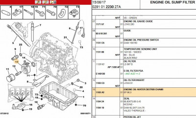

I never did post the part number for the original oil cooler.
Here it is (1103.A2) - Should help match up the right aftermarket one...
Click to enlarge
Click to enlarge
