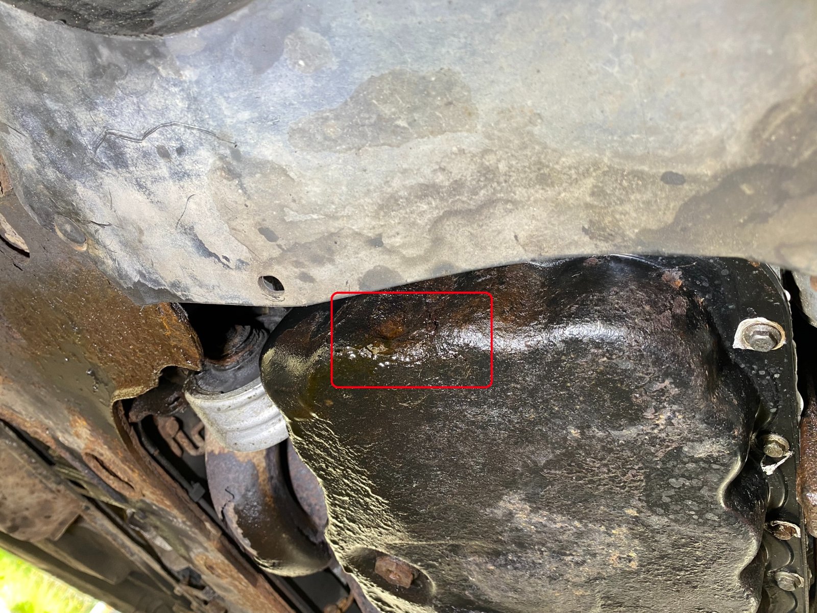

That's all good but after the test drive to check the ABS sensor I had another look at the oil pan and realised that the drain plug was not the only leak. In fact the drain plug stopped leaking after I loosened it off and tightened it again, but it seems that the sump pan itself is leaking through a rust patch!!
I don't know how well it will show in the picture below:
This is surprising to me because that rusty patch has been there for years, and last year when I had the sump off I checked the inside and it was pristine with no sign of rusting through so I assumed it was surface rust, and for most of the last year it has not leaked.
But there must be a pinhole or crack on the inside now which is allowing a slow weep through the rusty patch. Not quite believing it I wiped it clean and lay under the car as it idled and sure enough a drop of oil started building up from the rust patch and then started trickling along the bottom of the pan and it was definitely not coming from the drain plug or the flange, it was emerging from the rusty patch.
So where does this leave me ? I'm assuming this is NFP and not available after market, are there any second hand ones going around ?

Coincidentally I noticed some surface rust on the engine sump and transmission sump of my Xantia last weekend and gave them a quick coat of paint.
I expect that new sumps may be available. But you may be better off getting yours fixed with a bit of braizing.

I had a very similar issue many years ago on my Morris 1000 sump. Being skint I painted the rust to cure it, then filled the pitting with fibreglass resin mixed with just a touch of filling powder to stiffen it and make it wipe onable. I sold the car to a friend some 6 months later and she ran it for 3 years before selling on and no further leaking occurred. I was so chuffed with the success of that, I used the same method to seal a core plug in the end of my Reliant MK6 block and that too never gave any further trouble. It may not be acceptable practice but its cheap and it works!!

The problem with brazing is finding someone to do it (and repaint it) and that also leaves the car off the road with a missing sump out in the weather for a while, I'd probably need to tape some plastic sheet over the bottom to keep the moisture out. I have too much to do on the car over the next few weeks for the MOT to have it immobile for long.xantia_v6 wrote: 26 Jun 2024, 17:31 Coincidentally I noticed some surface rust on the engine sump and transmission sump of my Xantia last weekend and gave them a quick coat of paint.
I see a couple of places list the part but both out of stock:
https://bartebben.com/parts/citroen/xan ... 301j8.html
https://eurofrance24.com/oil-sump-0301h ... nault.html
Can anyone confirm the OEM part number for the sump so I can have a better chance with my Google searches ? It often works better finding obscure parts searching by the OEM code than searching by descriptive name.
I have many pairs of cheap reading glasses of different strengths... I'm around +1 for distance and +2 for reading now but no single focus pair of glasses is usable when working on the car I find as I need a lot of correction for very up close (at least +2) and then things at even arms length are going out of focus with that strength so I'd be changing glasses with dirty hands constantly. The bifocals are a workable solution but they only have a half moon reading section so it's difficult to tip my head to the right angle sometimes when I'm trying to look in through a wheel arch etc...Depending on your basic prescription, you may find that a cheap pair of reading glasses are better for working under cars.
I'm just glad I'm not a mechanic now I need glasses! (or ever, to be honest)

I am fairly sure the original part number is 0301H2, but that does not seem to find any actual stock. It is the same part on the 406 V6 (B9), which may give more scope for finding one at a breakers.
Mandrake
- Posts: 8692
- Joined: 10 Apr 2005, 17:23
- x 694
Re: Simon's new Xantia V6 and Leaf blog
This page seems to suggest it's the oil level probe ?xantia_v6 wrote: 26 Jun 2024, 19:46 I am fairly sure the original part number is 0301H2, but that does not seem to find any actual stock. It is the same part on the 406 V6 (B9), which may give more scope for finding one at a breakers.
http://www.peugeotparts.co.uk/files/Peu ... an2022.pdf
"0301H2 I2 ES9J4 SUMP FILTER PROBE 0"

The description is slightly misleading, it is a sump with a pocket for the oil level probe, I presume that there was another version for engines without oil level sensor.
- Posts: 12512
- x 1457
Seems to be the right number Mike, but it's NFP.
Sump looks pretty crusty Simon! I imagine if you 'investigate it' it will be a proper hole... If it's not too big it should be possible to fix it with JB weld or similar, but you may need to remove the sump to get it clean enough, although if you drop the oil and clean it well with brake cleaner and wire brush you might get it clean enough to get it to stick. If it's really small and localised a gob of RTV might fix it....not pretty! If it is localised, and on a flat area, then removing the sump, drilling through it, and putting a bolt in with PTFE tape either side might seal it.

JB weld is some kind of epoxy is it ? I've never used it before. Trying to get the outside clean enough to use a glue could be nearly impossible without a lot of work - apart from flaking paint it has multi-layer rust wafers that are impregnated with oil, you'd really need to grind it back to clean steel to get something to glue properly too. I assume this tray is in fact steel ?
Unfortunately it's not a flat area either, it's on the side of the curving section.
Another thought I had if it's steel would be to try to patch it on the inside - for example solder a thin rectangular strip of copper over the inside of the hole ? Some copper strip could be beaten into shape to match the curvature then soldered all the way around the strip to make a seal.
A plumbing torch (which I have) and plumbing solder/flux should in theory be able to do this, and I assume plumbing solder would stand up to the 90C or so that the oil gets up to ? Another advantage to this kind of short term repair is it could easily be removed again without leaving any real damage and allow a more thorough repair to be done in future.
Failing that it really needs to be given to someone who could grind, weld and repaint that section to do a proper repair, but I don't know where I would take it for that to be done...I don't imagine there would be many places keen to attempt this kind of repair on something like a sump tray.

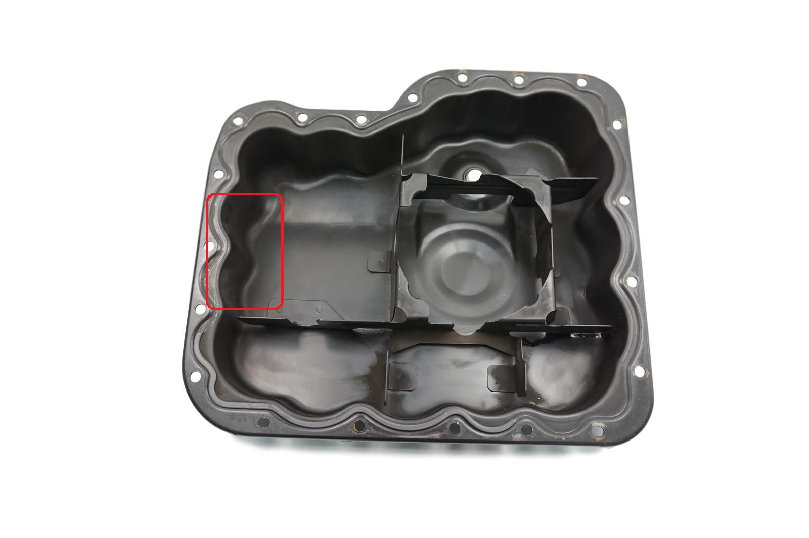

Found some pictures of the inside and this is the area where it must be cracked or have a hole:
Looks like it is painted so soldering would not be possible without first sanding off the paint in the area.
