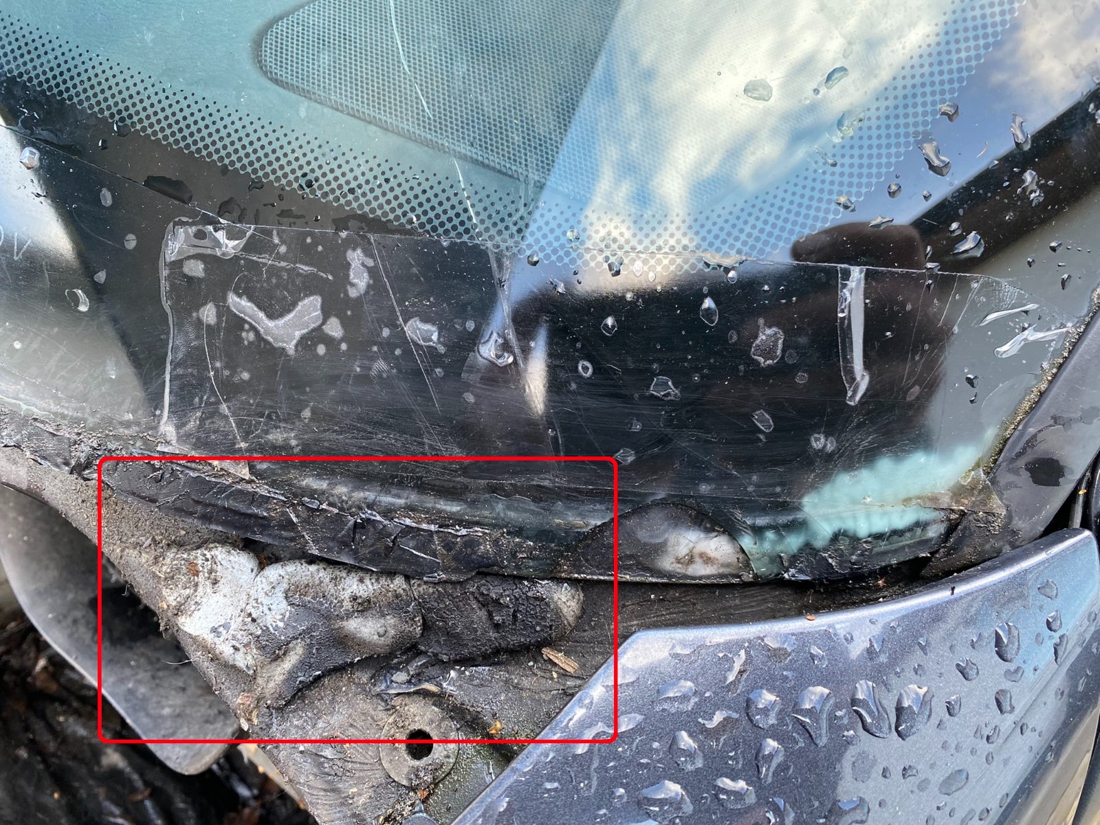

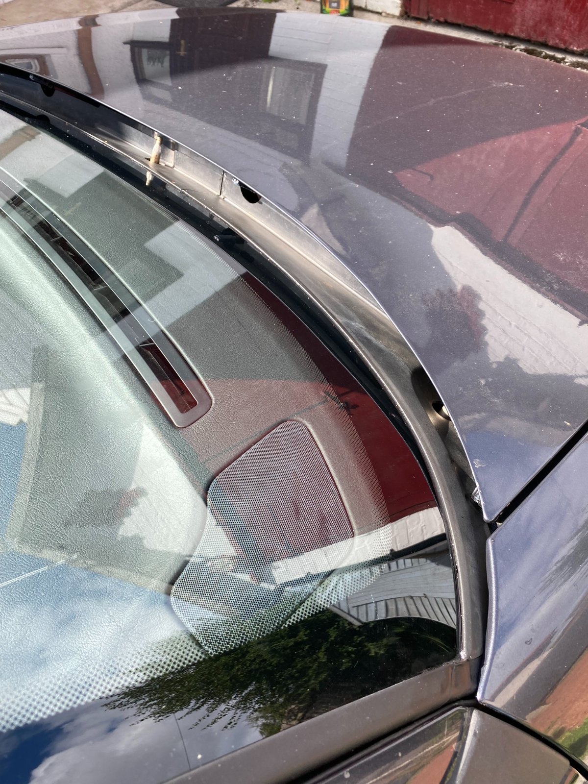

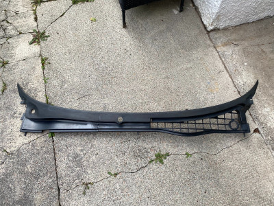

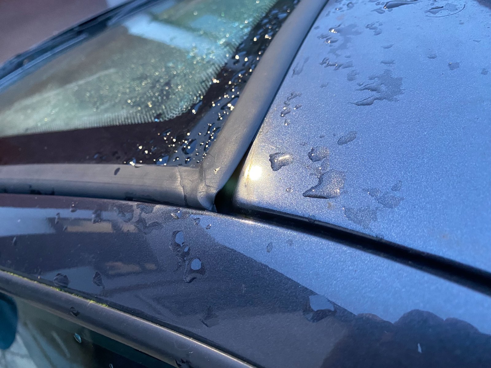

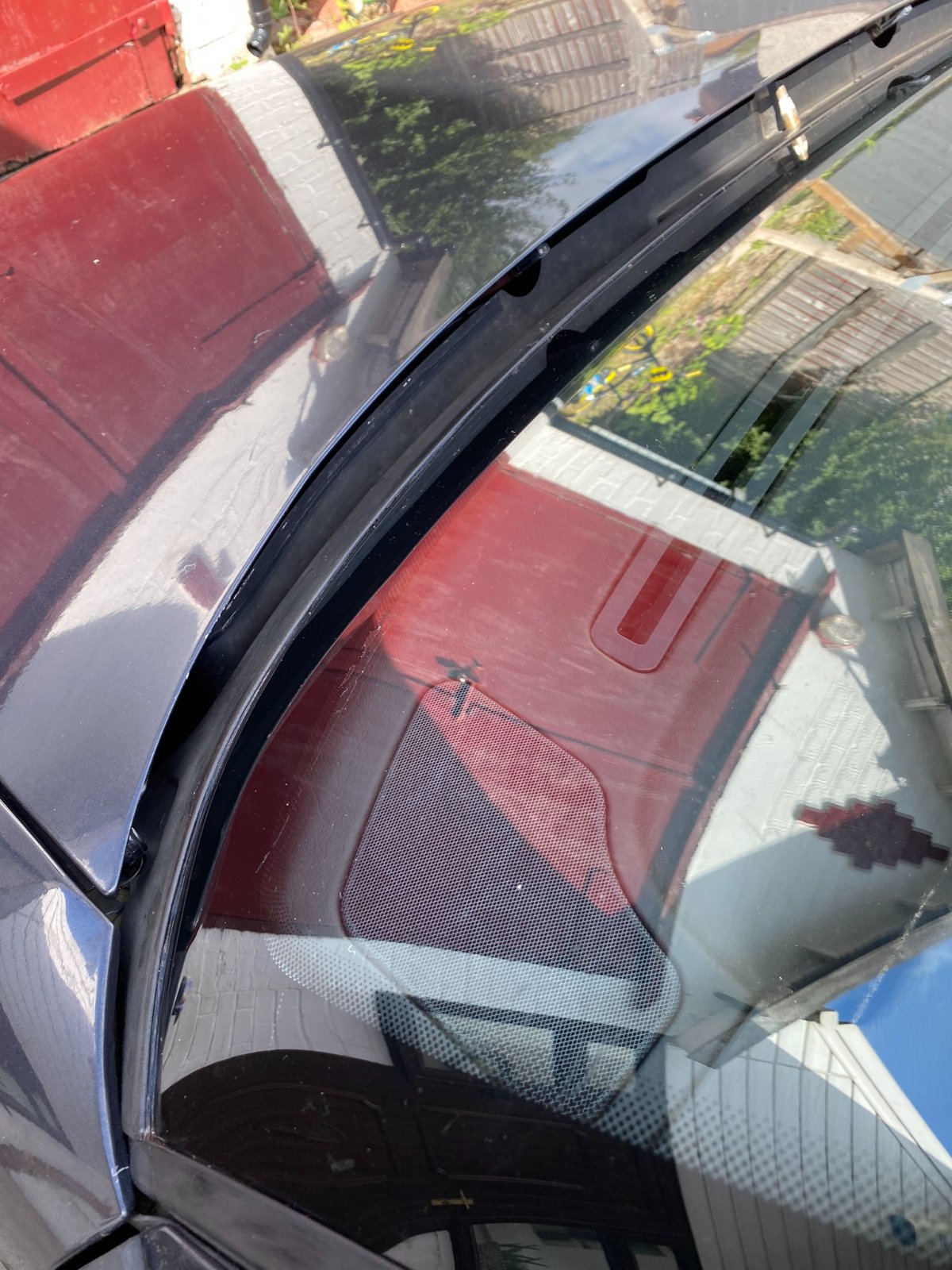

Sadly I've not had a chance to work on the car since I last posted or even take the carpet out - mainly down to two bouts of illness in January and seemingly never ending weekend rain. The carpet is starting to show mould spots now and is totally soaked on the front left passenger area.
(The right front and rear carpets are still dry)

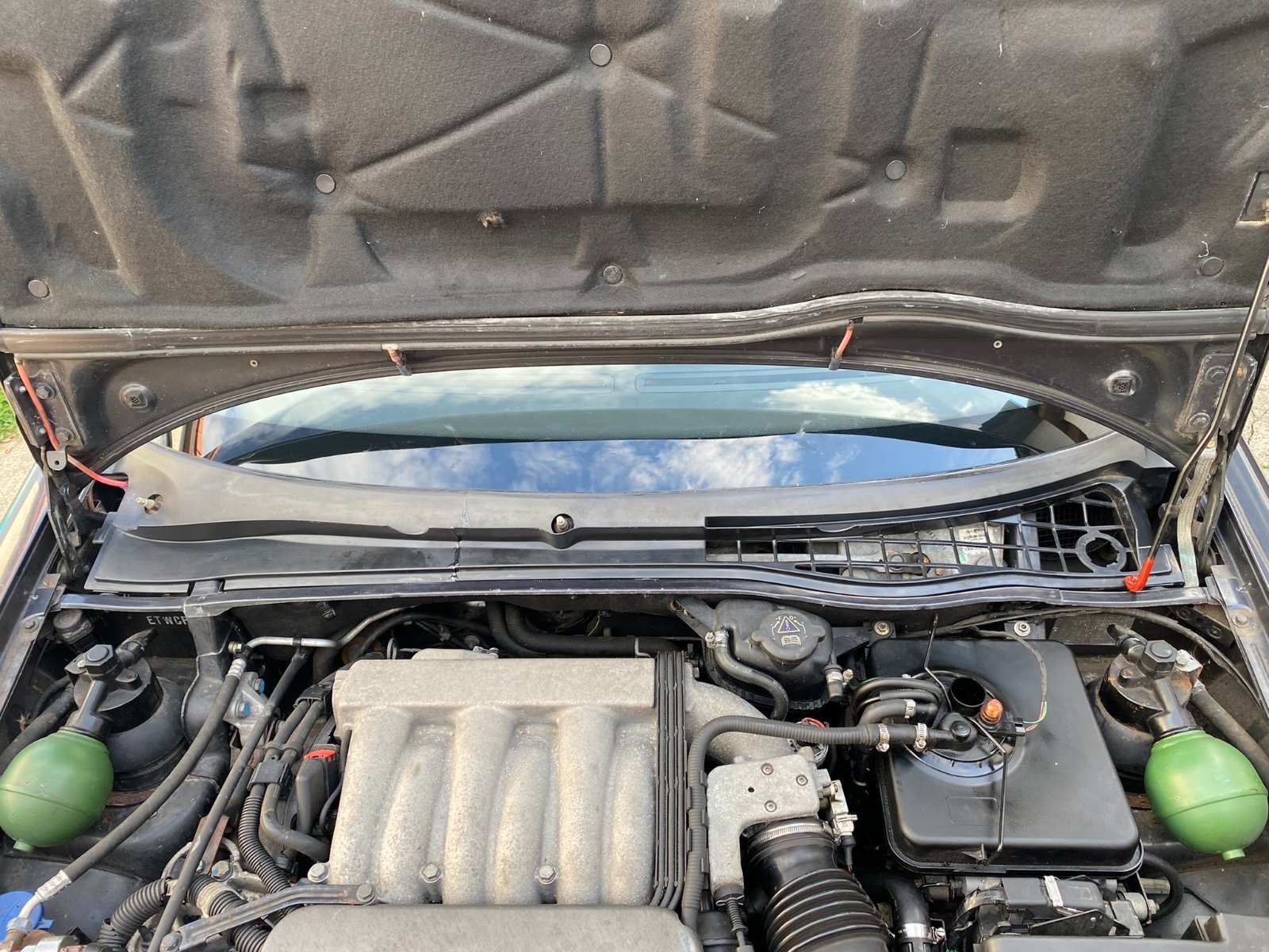

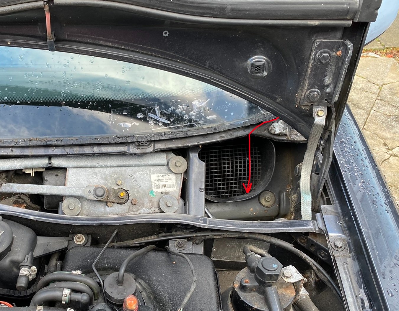

However on Thursday night I did discover WHERE the water is getting into the car, but not HOW it is getting to there. It was light to moderate rain when I came home so I popped the bonnet to convince myself it wasn't getting in through the heater fan intake vent, but it is!!
There was one drip every 5 seconds falling into the vent landing just at the bottom of the mesh grid in the vent with a long wet trail visible all the way down into the bowels of the heater vent:
It fits the symptoms that the front left footwell is flooded up to the level of the carpet but the drivers side and rear carpets are still dry.
The problem is I cannot understand HOW the water is dripping from the under side of the scuttle into the vent. I was VERY careful and neat when I fitted the scuttle, the silicone sealer seal line between the window glass and the top edge of the scuttle is still intact and is immaculate all the way across so there is absolutely no way water is running down the outside of the glass and into the gap between the scuttle and glass.
There are also no cracks in the scuttle at all except for the one clean break over towards the drivers side which is epoxy glued across the entire join. So everything seems perfect.
Which means that water is somehow travelling on the UNDERNEATH side of the scuttle from somewhere else and is somewhat annoyingly choosing to drip exactly above the vent, as I didn't see any drips anywhere else.

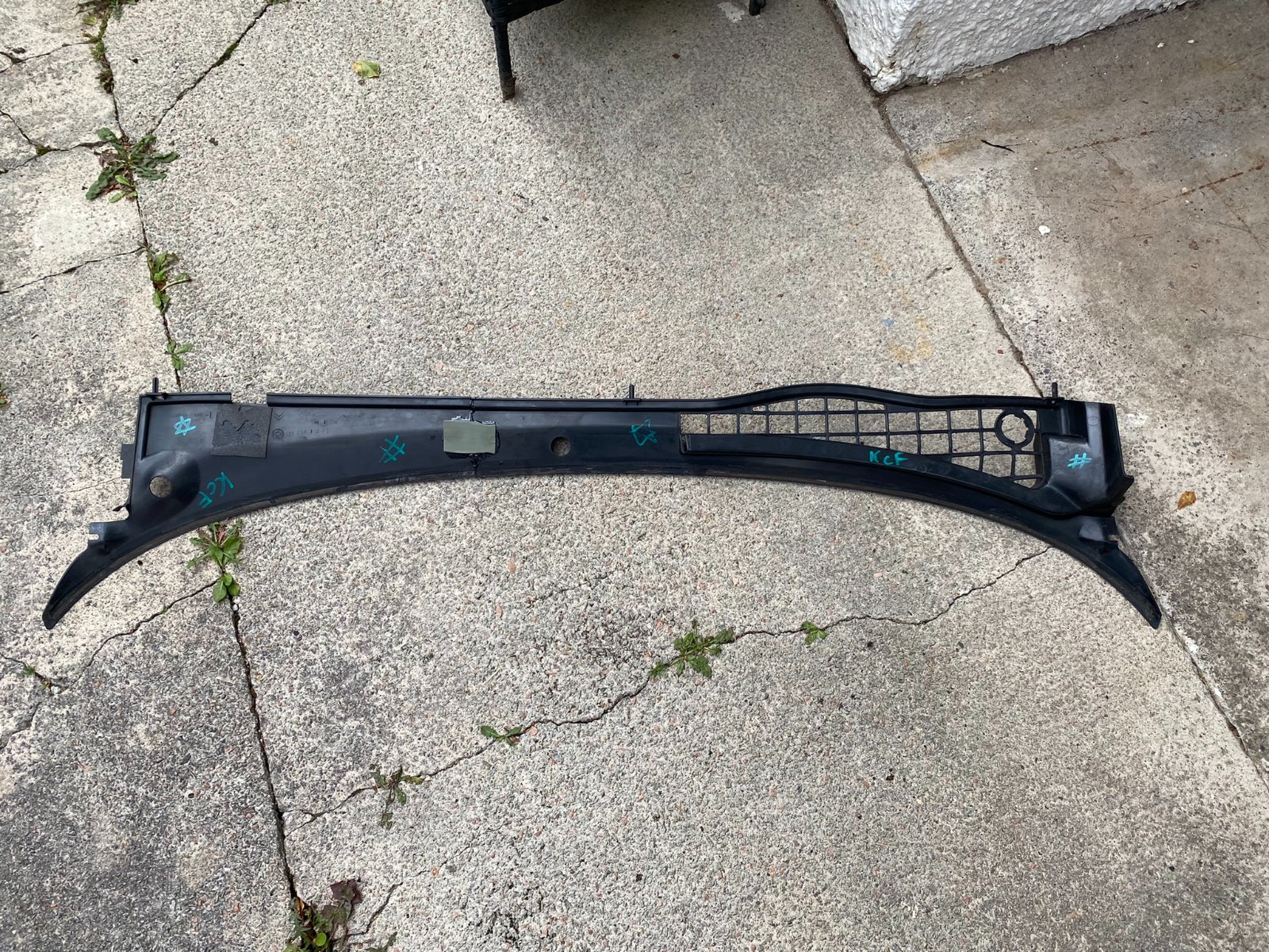

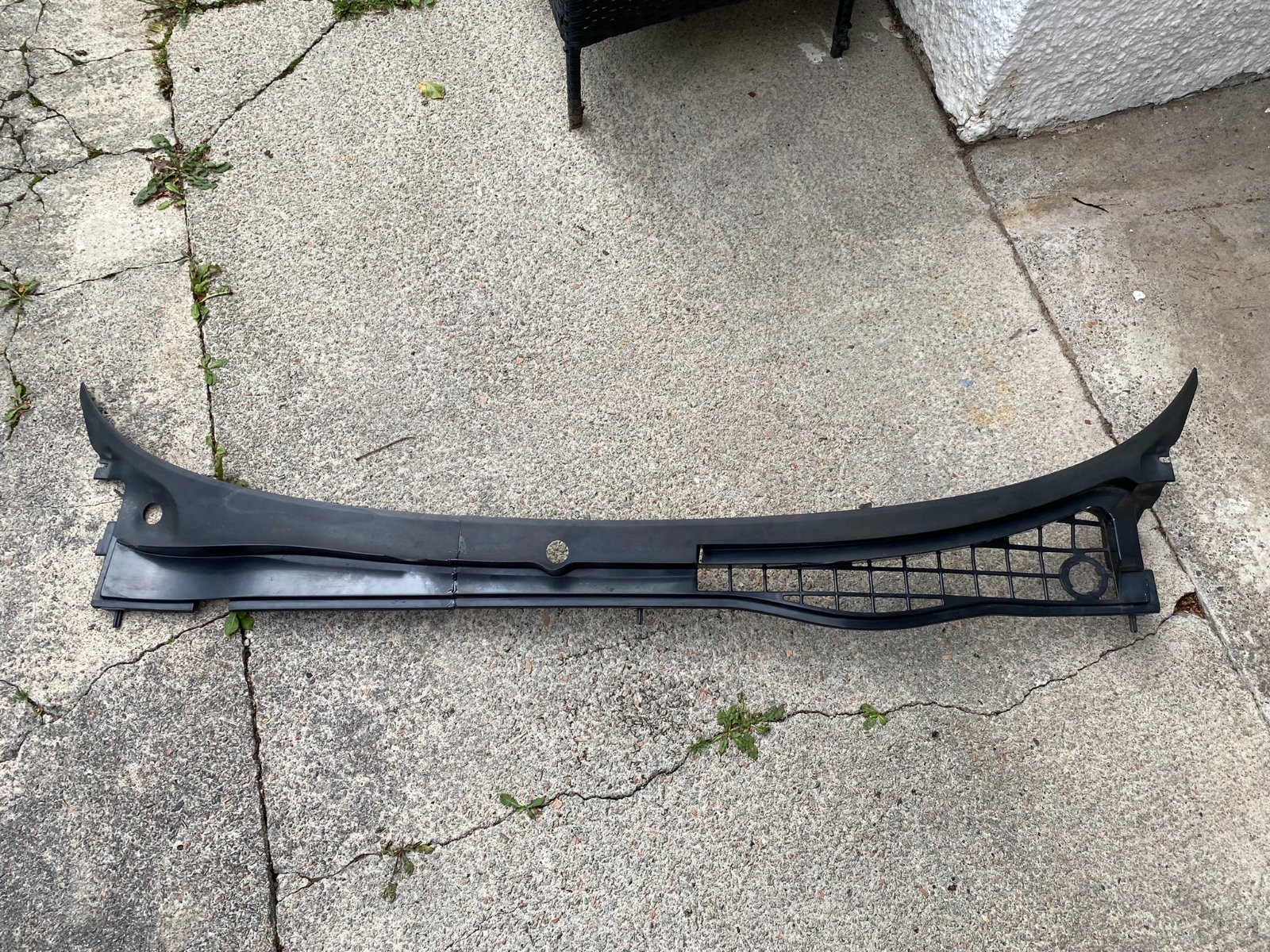

The only two possibilities I can think of here are:
1) There is a drain hole near the middle of the scuttle which allows water to drain down past the wiper motor into the trough - could water be going over this edge then running back along the underside of the scuttle until it reaches a curve or bump which forces it to drip ? The car is parked with the front left wheel in a drain hollow on the drive so is on a lean to the left. However if this is what is happening that must be a design flaw surely ?

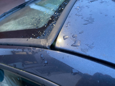

2) Could water be getting in at the top left corner of the windscreen edge and running down the edge of the glass under the rubber (but outside the cabin) and then run along underneath edge of the glass - which overhangs the body work quite significantly - in which case it could be dripping from the under edge of the glass where it overhangs the vent directly into the vent, not even wetting the scuttle ?
Two things make me wonder if this second theory could be the correct one - one is that the rubber seal doesn't really fit properly at the top left corner of the window, and is one aspect of the glass job I was not happy with: (other than breaking and failing to fit the scuttle of course!)
As far as I can see this does not affect the integrity of the seal between the glass and the frame of the body and is there more for looks, however I'm wondering if water could run into this gap then slowly work it's way down between the edge of the glass and the rubber, travel around the bottom edge of the glass and finally drip off the bottom of the glass ?

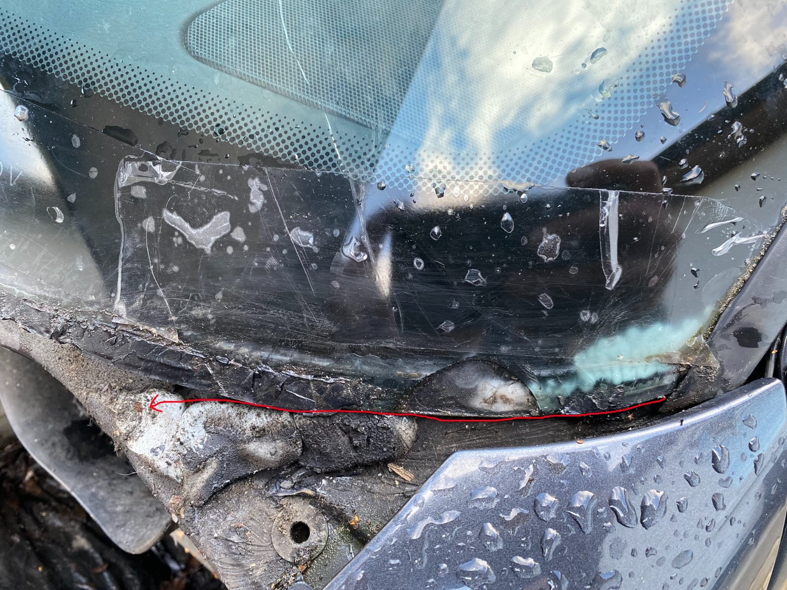

The second thing that makes me wonder this is that I previously noted that I found a giant blob of putty on the bodywork when I removed the original scuttle which looks like it has been there for a long time:
Could this be a bodge or even a factory mod to try to prevent water coming down the edge of the glass and dripping into the vent, and by throwing away this blob of putty I'm now seeing this problem ???
Without the putty blob the water path might look like this:
That slight V in the body work lines up almost perfectly with where the water is dripping...
What do people think of this theory ? If I'm correct I need to remove the scuttle again (argh!!!!) and replace the missing putty blob with a big blob of silicone sealer that goes right from the corner of the glass down the metalwork to direct any water dribble coming down the side of the glass away from the vent. (And I would be inclined to put a blob on the other side of the vent as a dribble break as well to stop any water dribbling across from the other side when the car is parked on a lean!)
I'm very reluctant to remove the scuttle due to the high risk of breaking it or chipping the glass again as I'd be back to square one if I broke the glass.
It looks like I will have my first chance in a couple of months to have a look at this so I'm trying to decide whether to take the scuttle out tomorrow or not!

Could you put a cowl of some sort over the top of the vent to direct water away from it?
