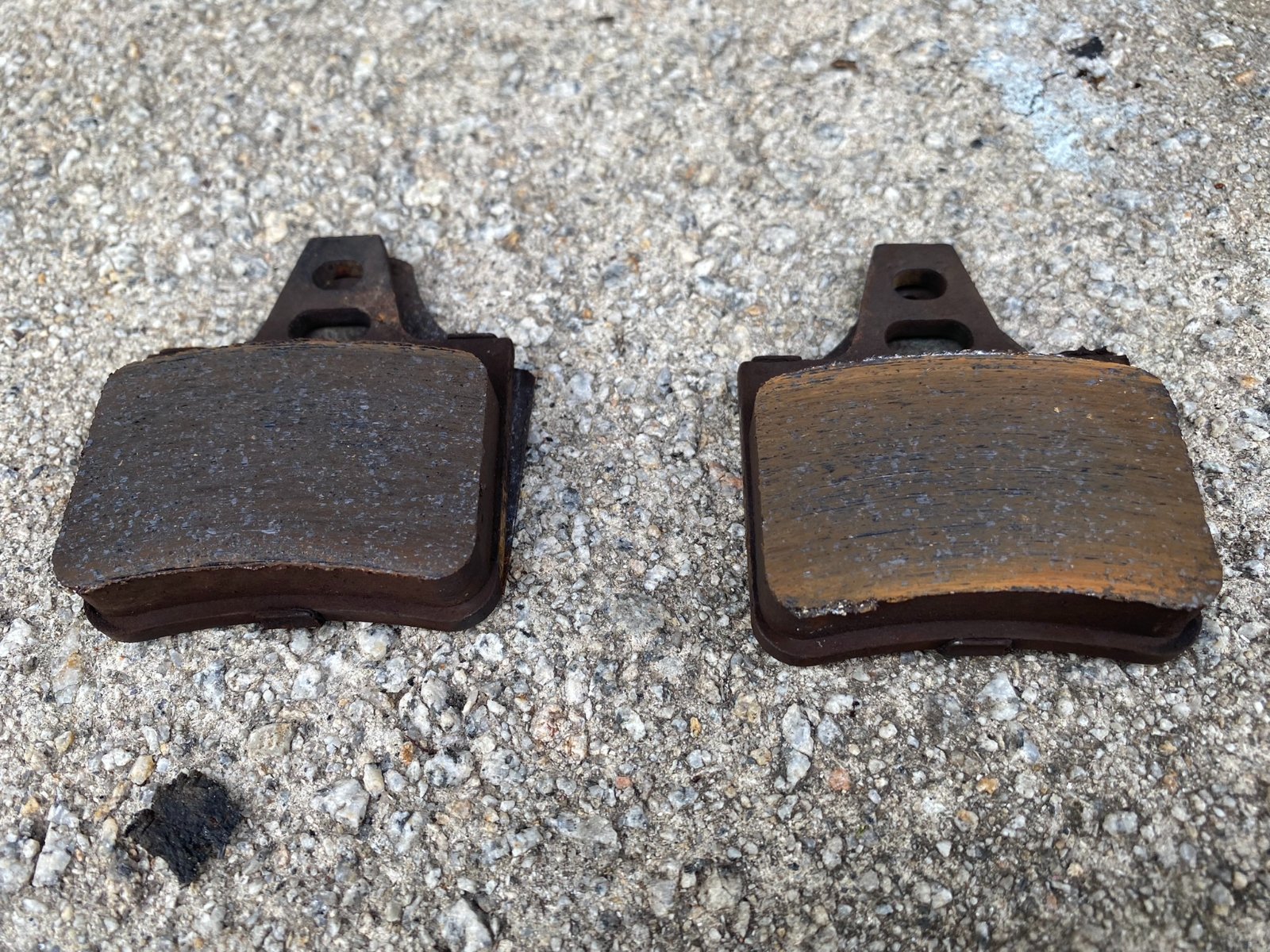

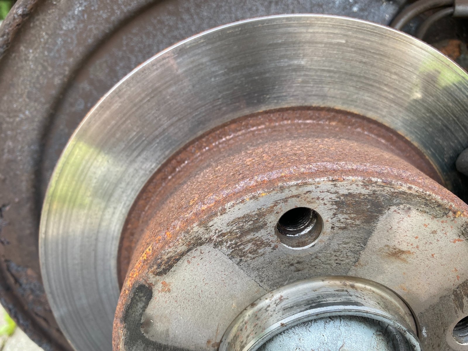

In other news I picked off one more job for the MOT - rear brakes.
The only thing of significance I could find was that there was a lot of "air" in the common section of rear brake line. The fact that it seems to accumulate "air" so frequently in the rear brake lines is what kicked off the replacement of spheres, so I'm hoping that finding the stuffed (punctured ?) rear strut spheres and basically replacing all the rear spheres has finally put that recurring problem to bed. Of course changing the rear spheres will have introduced some air into the lines as well so it's not surprising I found a lot - the question is whether it stays away this time.
Mechanically the rear brakes seem in very good condition - which they should be when I serviced them only a year ago. Despite the car sitting outdoors for nearly 6 months through the winter without use and only having a small amount of use during the current repairs the discs are in immaculate condition with a nice finish with no pitting or surface rust on either side:
The pads have plenty of thickness and turn out to be Bosch as I thought. (I couldn't get the full part number off the back unfortunately as part of it is rubbed out) The only thing I would say is there are slightly glazed:
So I gave them a scruff up on the concrete and they look good as new again. The callipers are still perfectly aligned with the discs, (no skew) there's no rust/rubbing between the pads and pad guides, the pistons move in and out freely etc. In short there is nothing wrong with them.
A test drive shows they are working normally again (the rear is not flying to the top under hard braking) so it was probably only "air" causing the issue, again. So hopefully that doesn't come back now.

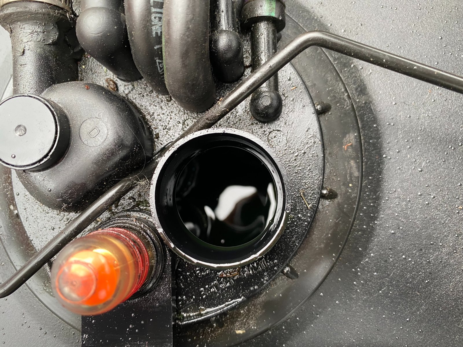

On a hunch I checked the LHM tank when I got home from a dump run:
God damn it! After a couple of minutes idling it cleared up again:

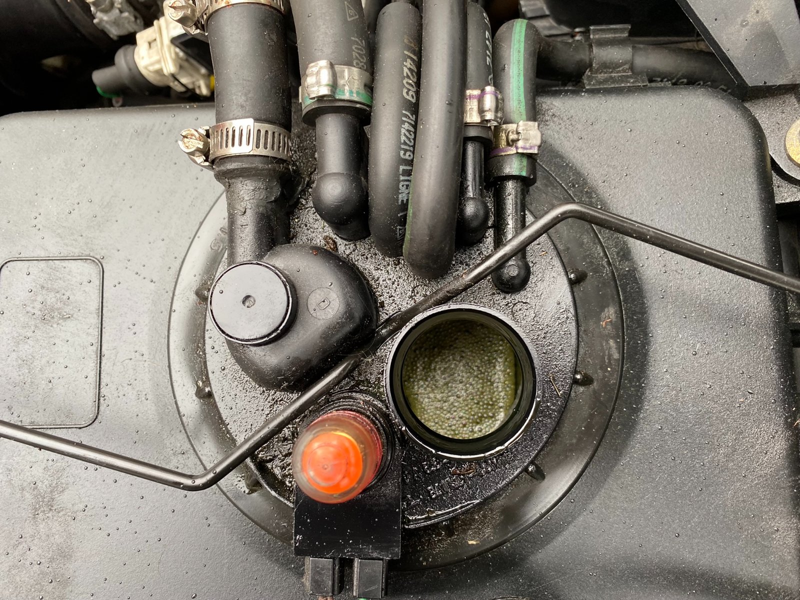

After the next dump run I saw the same thing, with it being full of large bubbles but clearing after idling for a couple of minutes.
With the engine revs held to 3000 for a minute or so I started to see a lot of very fine bubbles forming on the surface like a fine froth.
Has anyone ever had success eliminating the air leaks that cause these kind of bubbles ? I've been trying since 2005 without a lot of luck... (see my posts from 17 years ago!!!)

This is a very long thread Simon but there are a number of proposed solutions to eliminating those bubbles.
The filters are there to break them but sometimes seem to be overwhelmed.

I bought a Xantia V6 which had sat for a year or two, and both rear corner spheres failed on the 10 mile drive home.
On my current Xantia, I fitted a pair of NOS front corner spheres (not multi-couche) and they both failed suddenly but separately after a few months of use.
Mandrake
- Posts: 8692
- Joined: 10 Apr 2005, 17:23
- x 694
Re: Simon's new Xantia V6 and Leaf blog
Maybe, but it turns out both have failed!RichardW wrote: 23 Jul 2022, 17:58 That's a bugger... Probably only one has failed, the roll bar will prevent them moving individually.
Phew. Luckily the Tax renews just before the MOT runs out rather than the other way around. I checked and it's Taxed until August 2023!No need to SORN it just because the MOT is out, as long as it's taxed DVLA don't care, you just can't use it on the road.
These are supposedly "new", but what does new mean ? They're Citroen branded - both the spheres and the boxes, and I find it unlikely that Citroen are still taking delivery of Citroen branded spheres from IHFS (who makes them) in 2022. They might be "new" as in unused (they look brand new, no rust etc, and have possibly had the gas pressure topped up) but if they've sat in a warehouse for 10+ years the diaphragms will have gone brittle with age.xantia_v6 wrote: 23 Jul 2022, 18:23 I bought a Xantia V6 which had sat for a year or two, and both rear corner spheres failed on the 10 mile drive home.
When they go brittle they work OK for a while but can fracture when they are put under high stress - such as being folded back on themselves tightly when the suspension is set to high. Also rear strut spheres are the lowest pre-charge pressure of any sphere on the car at 30 bars (next lowest is 45 bars on the front) which means they flex the most when subjected to maximum pressure at high ride height, so are the spheres likely to fail first as a result of brittle diaphragms.
In any case here are the LHM fountain videos to prove they've both failed, and spectacularly so!
Westeron want the spheres back for inspection before they're willing to send replacements, so I've refitted the originals so as not to leave the car disabled. While they are indeed very stiff, they apparently are not punctured because the ride is firm but not bouncy as it was on the punctured spheres. So the car is as driveable again as it was before I fitted the "new" spheres.
When I did Citreorobics after re-fitting the old spheres while monitoring the LHM tank I saw no bubbles at all, zilch. I then bled the rear brakes (again!) and got quite a lot of air out presumably from either the punctured spheres or from the air leak at the pump or both, and went for yet another test drive.
This time the rear brakes are working nicely - the car was pulling to one side a bit at first but after a few good hard stops the brakes seem excellent.
I got back home and immediately checked the LHM tank with the engine still running - calm as a millpond with no bubbles whatsoever even though the car had been driving hard for about 20 minutes. A totally different story than before I fixed the hose on the pump!
So it does look like the ill fitting hose on the pump inlet was the original source of air that kept finding its way into the rear brakes. Fingers crossed that no longer happens, because if that's that problem solved the rear brakes should be able to pass an MOT with or without the new spheres at the rear.
So, two steps forward and one step back today but I'm very pleased to have apparently found the air leak in the system that has probably been there for years now. I think all it came down to was the hose clamp needed to be right on the bump on the end of the spigot where it could get some bite rather than further down the spigot where the diameter was too small for the hose to clamp onto....
