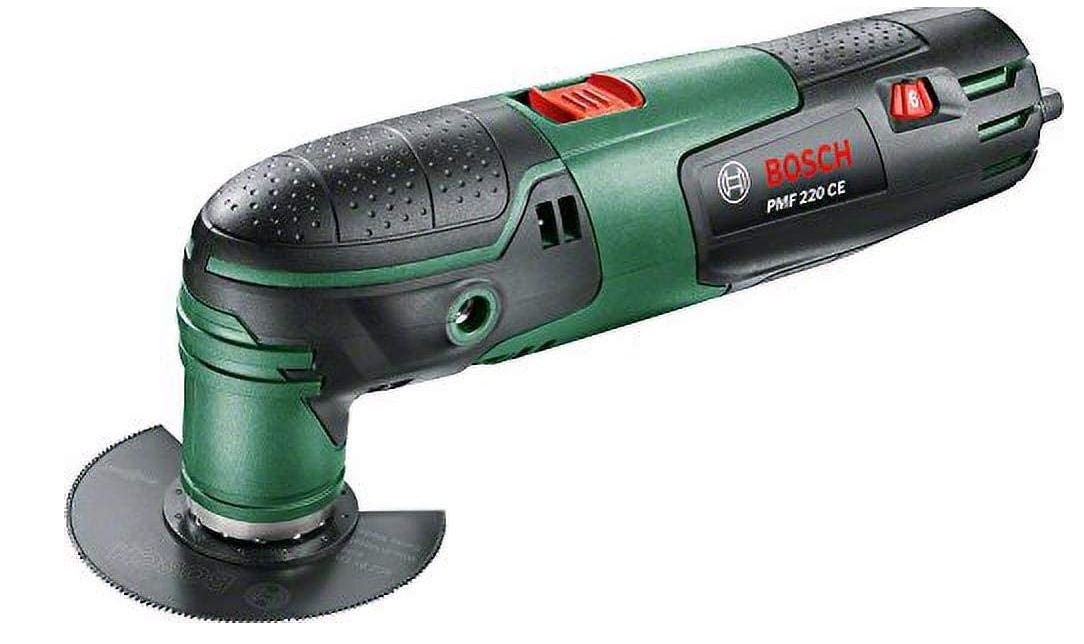

Don't quote me on this, but as the screen is now a write-off, would it be possible to get one of these in between the screen and scuttle to cut most of the bond ?
