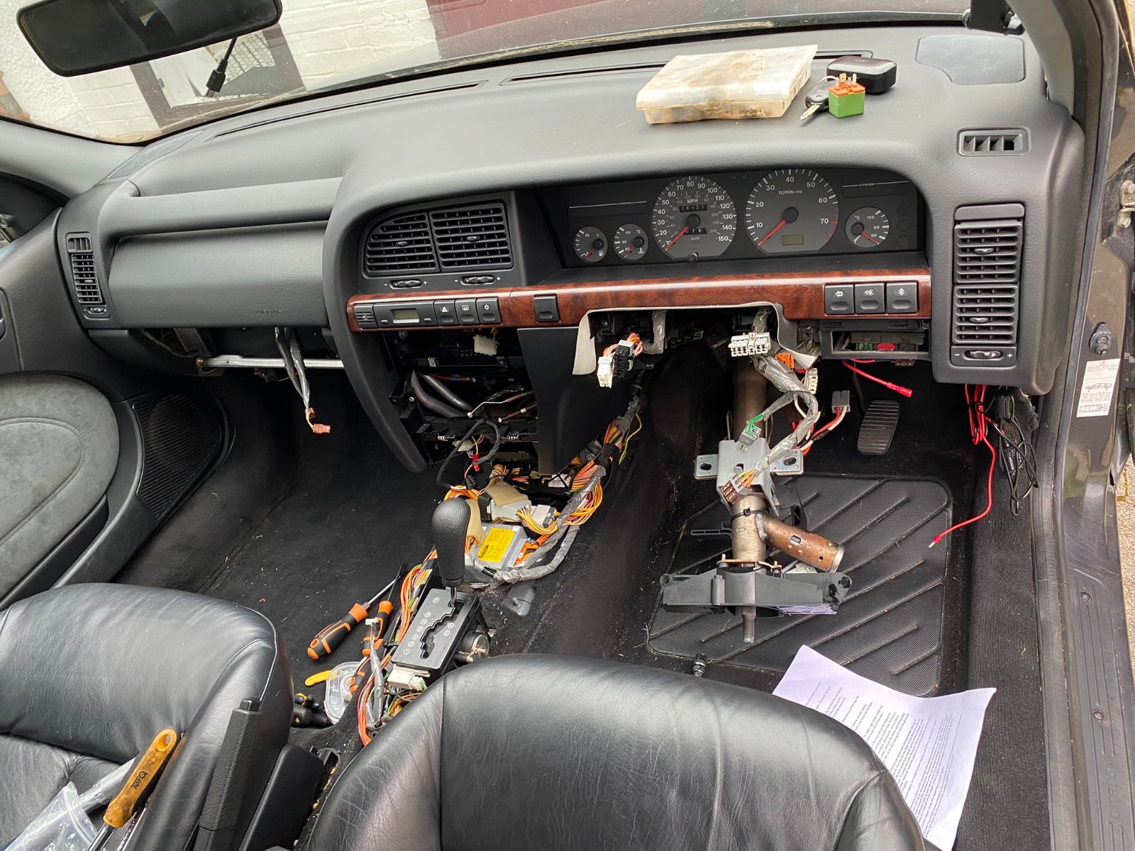

A progress update after getting a chance to do a bit more today.
I've got the steering wheel off and most wiring etc disconnected, annoyingly a bodge repair I had to make in the past which goes between one of the wires on the key switch and the interior fuse box is going to get in the way and is going to have to be disconnected and remade later... so the inside of the car looks like this at the moment:

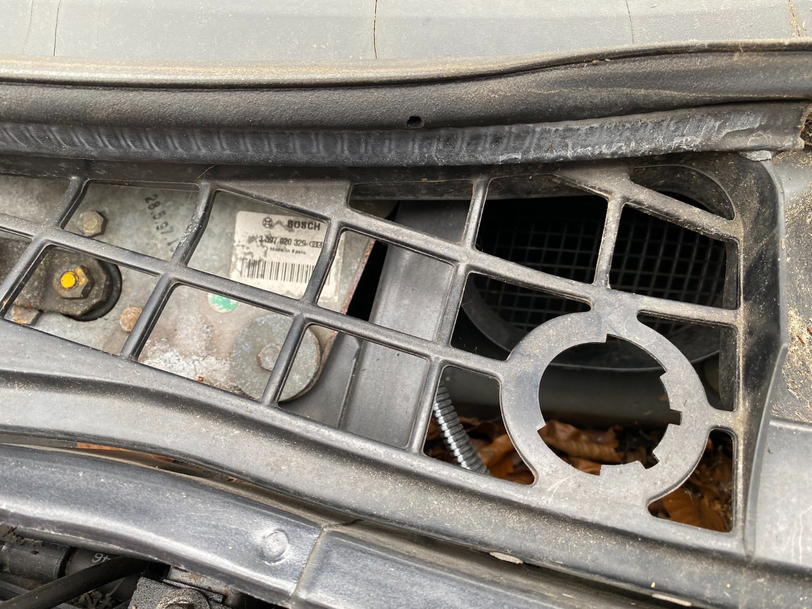

However I'm now stumped on the bolts in the scuttle area. According to CitroJim you "just" remove the scuttle and move the wiper motor to get at three 10mm nuts, however CitroenXM says:
"Also there is NO NEED to remove the wiper assey to remove the three dash securing bolts that are behind grommet covers.. a deep 10mm socket on small socket set will get past the wiper arms under the scuttle. Remove the scuttle will be very hard. Indeed if its still citroen original bonded and runs risks of cracking the screen.. yes its bloody hard."
Which to me implies that it's possible to get a socket onto these nuts without moving either the scuttle or wiper motor but on inspection this seems impossible to me! :(
I can't see or feel any nuts through the gaps in the scuttle and really have no idea where these bolts are:
So despite CitroenXM's comments is the hope of doing this job without removing the scuttle only a pipe dream ? As the photo's will show, the scuttle is going to completely disintegrate if I try...
Is there some difference between S1 and S2 in regards to nuts in the scuttle area ? I'm starting to feel a bit out of my depth now, however I have to press forward as there is no way back now. What possessed Citroen to design the car so that a glued in scuttle has to be removed to access external bolts to remove the dashboard ??! #-o

The bolts that go through into the scuttle area, do they hold the dashboard in, or do they just mount the heater matrix assembly to the firewall ?
Can I at least get the dashboard off to get a better look at things before I have to tackle the bolts behind the scuttle ?
I presume that when the dashboard is removed the heater matrix assembly is still mounted to the firewall and further disassembly is required to free it from the firewall ?

The fasteners under the scuttle hold the dash frame. Maybe the centre one holds the heater box. There is another fastener mentioned in some guides that holds the evaporator box, but on a car with A/C it should not be undone.

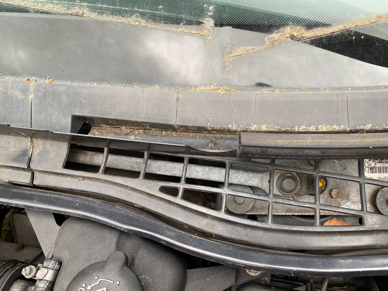

Thanks guys it looks like I have no choice but to cut the scuttle away. I have a large but flexible carving knife with a sharp point that I’m hoping will do the job. Wish me luck everyone…

I have used a flexible carving knife, but my weapon of choice would be a "hobby knife" with sectioned snap-off blade. Put some tape on the glass to avoid visible scratches.

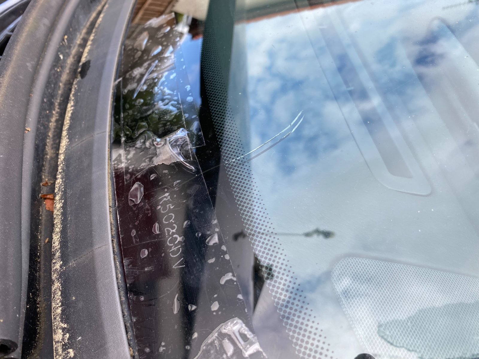

Looks like I've just written off the car. #-o
Trying to get this strip up is nearly impossible. Even with the sharpest strongest knife I have I can barely cut through whatever is holding it on - so an earlier post that mentioned using a box cutter, yeah good luck with that when even a brand new very sharp carving knife can barely touch make a dent on the bonding agent.
Unfortunately I've cracked the glass already after barely even starting:
Given the likely cost of getting someone to replace the windscreen and the work that still needs to be done to get the car MOT ready in just under 2 months I think realistically the car is a write off now and I just have to give up on it. :cry:
Utterly frustrated, disgusted, fed up and very angry with the designers of the scuttle and whoever decided dashboard mounting nuts needed to go behind it. This isn't how I wanted Xantia ownership to end.

Mandrake wrote: 22 May 2022, 16:21 Looks like I've just written off the car. #-o
Anybody else think that bead is thicker than original :?:
Remember you might get windscreen cover on your insurance if applicable :roll:

Bead ?
I've checked my insurance and I do have windscreen cover - with a £100 excess for replacement.
Unfortunately from further attempting to cut the strip away I now have another separate crack radiating from near the same corner along with a small fingernail sized chunk of glass under the edge of the strip right in the corner that has lifted away from the window when I tried to lift the corner that I thought was already adequately separated, so things are just going from bad to worse. #-o
On the other hand there has been a white splotch in that corner of the glass since I've had the car which makes me wonder if there has been a crack at the edge of the screen letting moisture into the layers and trying to cut the strip away has allowed that crack to grow.
So I don't know whether I could blag it on insurance or not. The only way I might be able to do that is to press forward with trying to cut the strip away, do the matrix repair, put everything back together, stick the strip back down with some black silicone, then make a claim.... :^o (It's no good trying to do a claim when the car is half dismantled and even if they went for it I'd then have to undo their work to get the strip out again almost certainly breaking the new glass)
Not the sort of thing I would usually do but if its the difference between getting rid of the car and keeping it..... also the insurance does say that it covers "accidental damage" to the windscreen - I would class this as accidental!!!
I wonder if a professional glass replacement includes a new scuttle - I can't see them reusing this one as it's in a terrible state, and unlikely to ever be waterproof again.
Interestingly when I checked on autoglass's website it claims they can still supply them and have done two windscreen replacements on Xantia's in the last 6 months which was more than the zero I was expecting!
