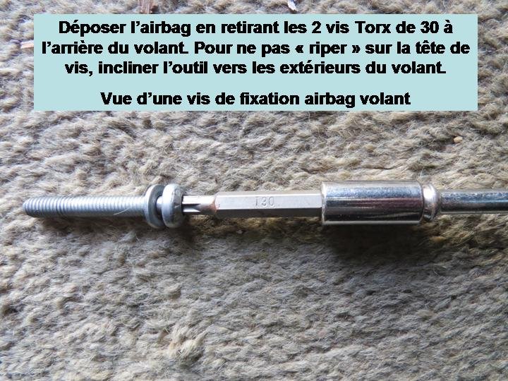

Are you absolutely sure its a T-25 ?Airbag is retained by two 25 torx screws from the rear of steering wheel (1/2 lock each way for access)
I cannot find anything that will engage properly in those holes. I've tried T15, T20, T25, T27, T30 and T35 - none of them give any proper sense of engagement, nor do the security torx variants.
Unfortunately I only have a multi-set with the little barrel joiners so I can only assume the barrel is fouling on something and that I need a dedicated torx screw driver with a single piece small diameter shank to have any hope of getting it undone.
However I'd need to know for certain what size it is or perhaps buy a selection around that size range as I do need some dedicated torx drivers.

Just checked and on my XII they are torx 30 and I have quite a lot of room so a magnetic bit holder should slide inMandrake wrote: 14 May 2022, 20:26Are you absolutely sure its a T-25 ?Airbag is retained by two 25 torx screws from the rear of steering wheel (1/2 lock each way for access)

Thanks - after I saw Stickyfinger's post I tried T-30 again but still no joy. I think the issue is that my T-30 bit is very short and only sticks a little bit out of the barrel adaptor compared to the picture above and the barrel is being fouled by something. I have a long shank T25 and I can feel that goes about 20mm further in before it bottoms than the short one.Skull wrote: 14 May 2022, 21:03Just checked and on my XII they are torx 30 and I have quite a lot of room so a magnetic bit holder should slide inMandrake wrote: 14 May 2022, 20:26Are you absolutely sure its a T-25 ?Airbag is retained by two 25 torx screws from the rear of steering wheel (1/2 lock each way for access)sorry for my error (also they are slightly angled towards the centre of the wheel - I normally look through the windscreen whilst engaging)

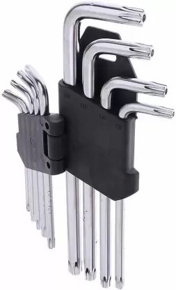

Simon try to get a T-50 as well for the steering wheel bolt (if you haven't got one already ?)
I've got a set like these (you might struggle with screwdriver clearance)
TORX SET
TORX SET

I use a set like these...if tight, I just put a bit of tube on the short section to extend it and give more leverage.

I've ordered the angled torx set you linked to from ebay - it looks like I won't get it until Thursday, although I probably won't have time to work on the car until next weekend anyway as we're out most of tomorrow.
I'll grab the torx screwdrivers from Screwfix as well so I have both options - I've needed a few more torx drivers of various sizes for a while now as I often find myself struggling with the bit and barrel joiner ones I have as they are often too short and too fat to reach into equipment I'm trying to work on.
