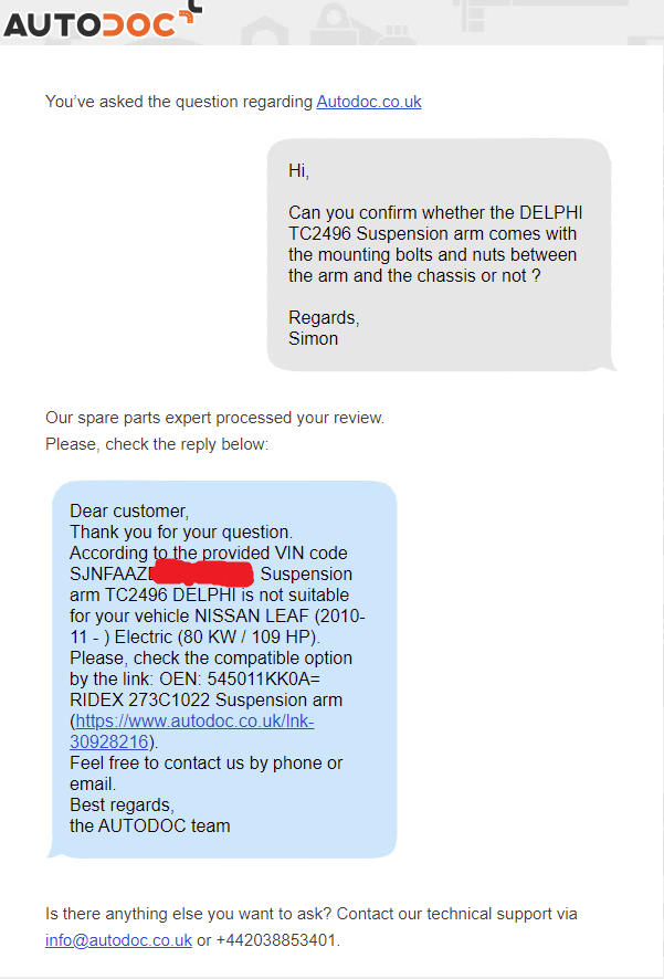

I really hate dealing with Autodoc. :(
I sent a message the day after ordering the Delphi suspension arm asking whether it included bolts or not and I get back the following reply (nearly a week later) which (a) doesn't answer my question and (b) seems to be totally wrong!!
Despite their claim that the part is incompatible with my car, I used the number plate search filter on their site before looking up the part, AND double checked the OEM part number (545011KA0B) here:
https://nissan-europe.epc-data.com/leaf ... 401/54501/
Against the OEM part number here:
https://www.autodoc.co.uk/delphi/7479625
So where are they getting their information from ? There are only two revisions of Leaf even listed on their site - ZE0, which goes from 2010 to mid 2017, (24 and 30kWh models) and ZE1 (2017 on) which is the 40 and 62kWh facelift models. (In fact as far as I'm aware the front lower suspension arms are the same on all Leaf's)
I guess I'll have to wait until it arrives and hold it against the original arm to be sure but I sure am annoyed with them trying to throw me a curve ball like this...they don't even make it easy for me to respond as their message looks like a text message sent in an email with my only means to reply being to send a new email explaining myself all over again.

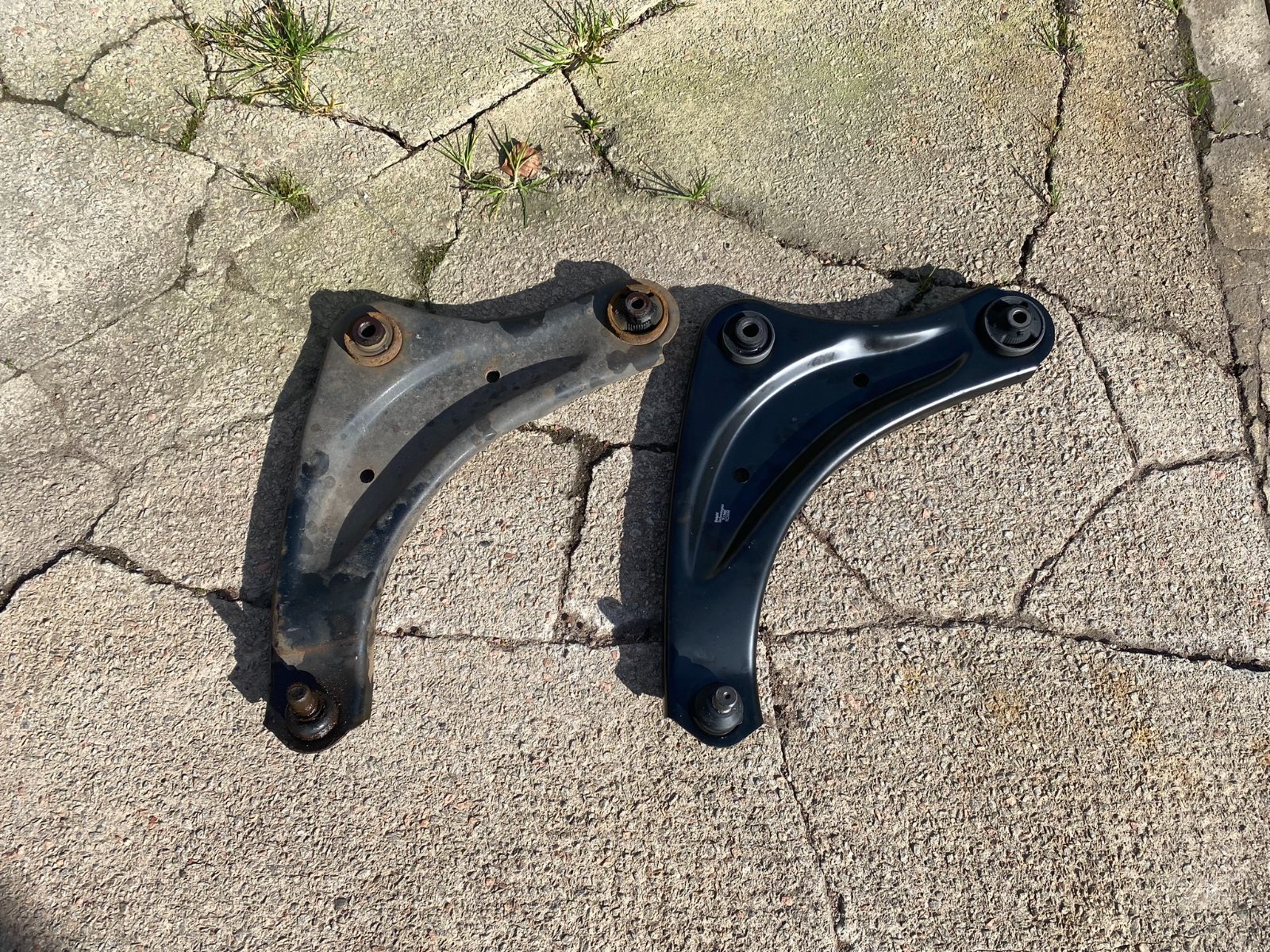

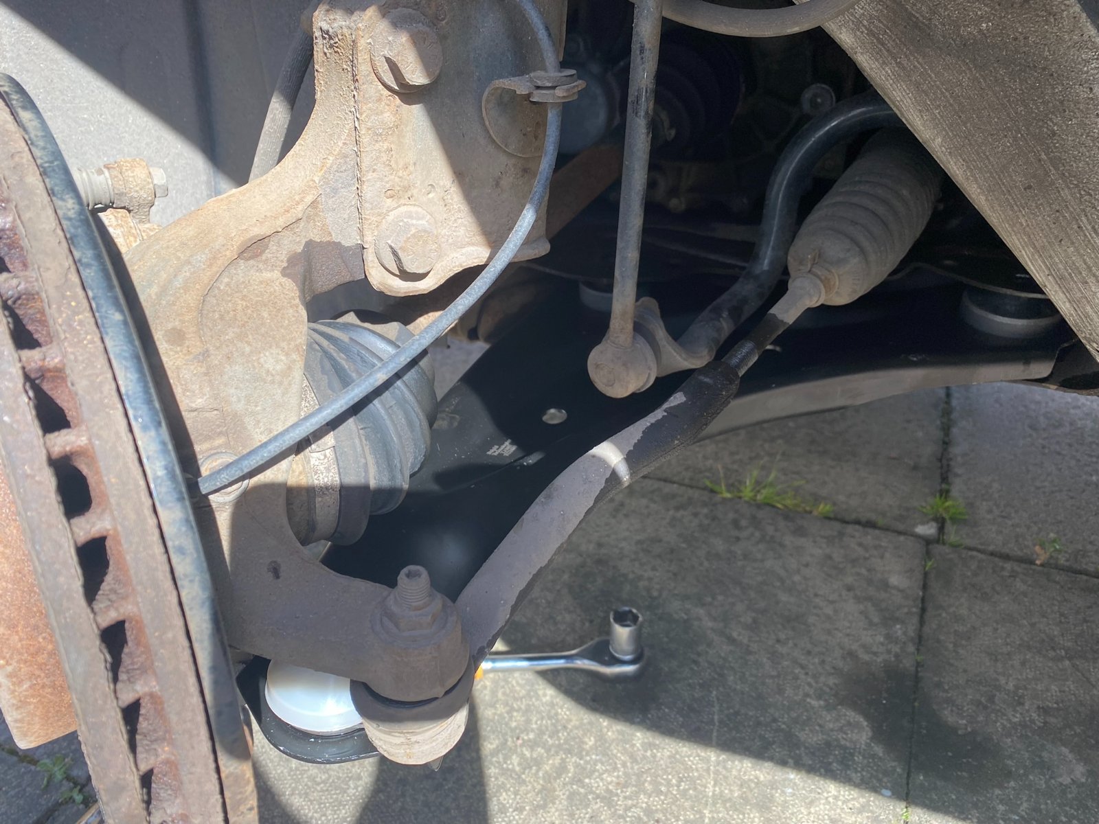

The new Delphi suspension arm arrived last week and after fitting it on the weekend I can confirm that the Autodoc chat message from the previous post was wrong - the arm is a perfect match, as I knew it should be.
For once a car job went relatively smoothly for me - swapping the arm over was a piece of cake really. With the steering turned to extend the track rod and the bottom ball joint disconnected there is just enough room to push the bottom of the hub forward to clear the arm without disconnecting anything else, allowing the arm to be inserted into the "slot" on the body and the vertical bolts to be inserted through the bushes with no tension on the rubber bushes: (ball joint not yet engaged in the hub in the picture below)
Both bush bolts and nuts were in perfectly fine condition and were easy to undo and refit - a little too easy to be honest as they are supposed to be 155Nm and 145Nm respectively, so I don't think they were previously done up to the correct torque... [-X
I also reused the nut and bolt through the ball joint split retainer on the basis that it's not a nylock nut and I had fitted a brand new nut and bolt a few months ago, and it too was fine.
The service manual recommends doing the final torqueing of the two arm mounting bolts with the car stood on the ground supporting its weight - this was a little bit awkward due to the low ground clearance but I was able to get both a spanner on the nuts on the top and torque wrench on the bottom reaching under the car. (Plan B would have been doing it on ramps)
And after going for a test drive I can confirm the creaking is gone. :) The boot was indeed split, all the way around the top.

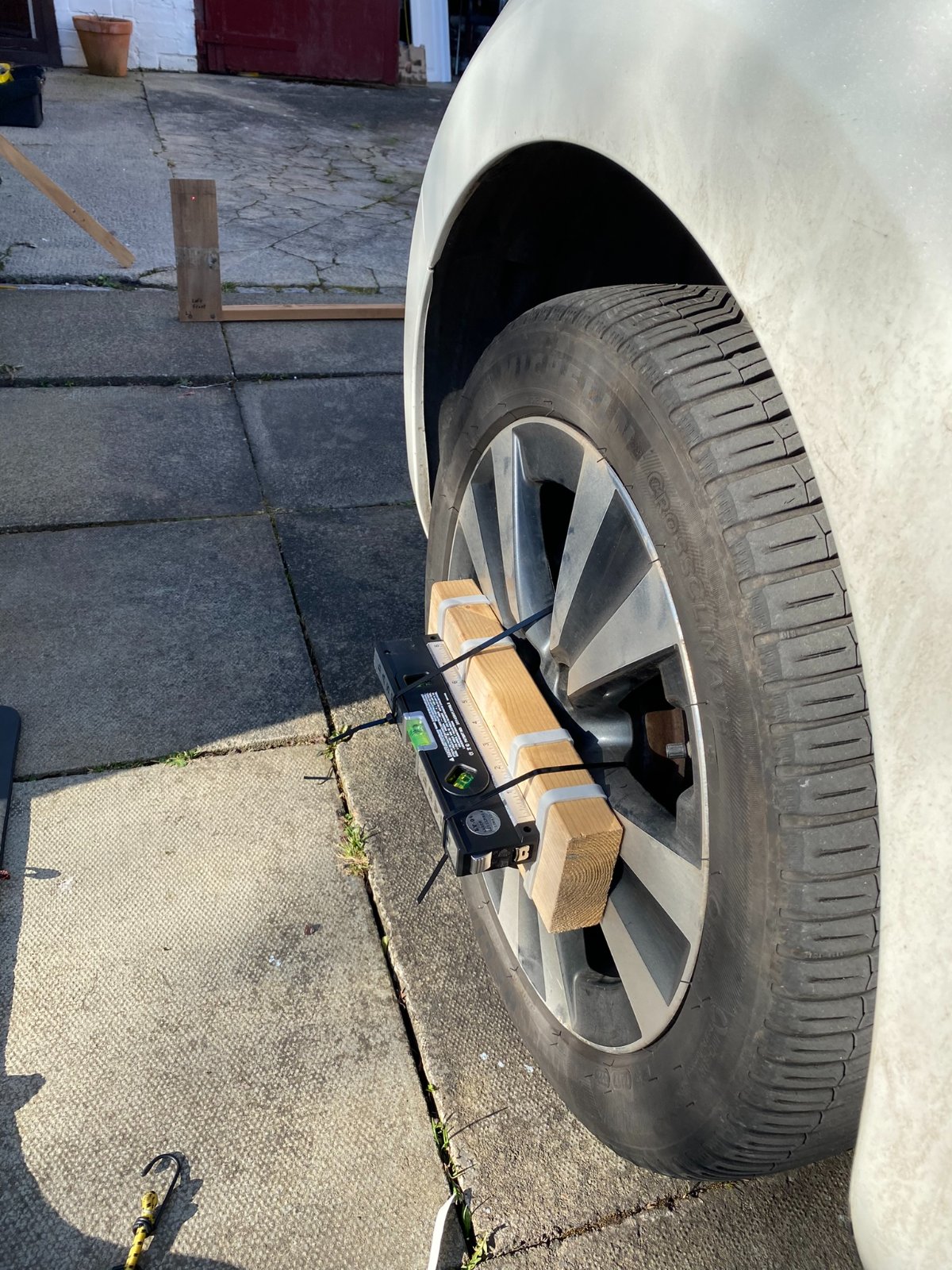

The following day I checked the wheel alignment - it took a while to try to adapt some way to securely attach to the 5 spoke Leaf rims which are raised in the middle but this is what I ended up doing with a block of wood, some foam strip and cable ties, very secure:
The correct spec for the Leaf is 0 to 4mm toe in with 2mm recommended, however I measured almost exactly zero toe in even after repeating the measurements a second time.
One thing the car has always had is very light steering, and a slight offset to the steering wheel where I had to turn the wheel about 3 degrees to the right to go straight, according to the wheel angle sensor reported in Leafspy, (Also quite visible by eye) so I had been intending to check the wheel alignment long before the suspension arm swap but never got around to it.
I worked out that I could increase the toe in and correct the steering wheel offset at the same time if I lengthened only the left hand tie rod, so that's exactly what I did. As always it's a very sensitive adjustment - just a half turn on one side took it from 0mm to a full 4mm toe in, so I had to back it off by half again to get close to 2mm.
By fluke (or not!) the steering wheel is almost perfectly centred now when going straight ahead, and the toe in is right in the middle of the specified range.
The improvement in steering feel and motorway directional stability is quite dramatic after fixing the toe in. It now has quite significant self centring torque and does not wander slightly at speed anymore. Steering feels a little heavier than with zero toe in but not unduly so.
It's always puzzled me why manufacturers accept such a wide range of toe in values like 0 to 4mm as "OK" - the steering feel is totally different between 0 and 4 mm and 0mm should never be within the acceptable range IMHO, they should be a bit more fussy and specify 1-3mm for example.
As the steering wheel offset did not change when I swapped the arm I believe the toe in error was there all along and swapping the arm did not have any noticeable effect on the wheel alignment - not surprising when the mounting bolts and bolt holes are a very snug precision fit. While I was at it I also did a significantly overdue front/rear wheel swap.

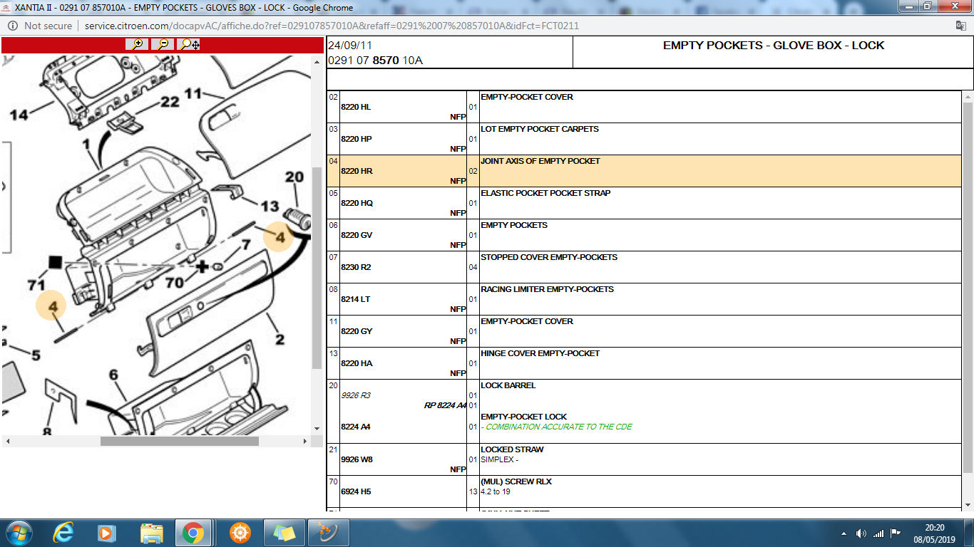

1) I can't get the glovebox out - I've removed all the screws around the frame of the box and the left side seems to be loose but the right hand side is hanging on firm. Can't find any screws underneath ether. The strip that goes right along below the gearbox is also still firmly attached with no visible screws. The car has a passenger side airbag above the gearbox as well as the Series 1 handle.

Glovebox has torx screws under the felt as well as the visual ones - I think there's 9 altogether ? [Edit - diagram added but doesn't really show screws]
