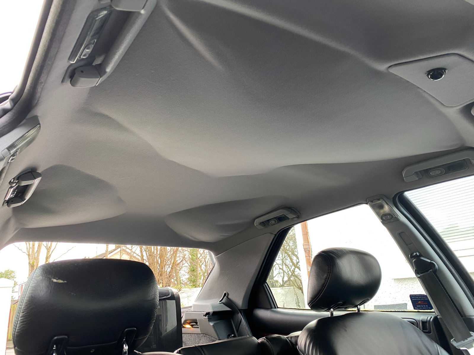

However rude shock number three has me really stumped. It seems that despite the car sweating a bit inside over the last few years due to lack of use, it decided now was a good time for all the ceiling lining to let go and fall down!!
It seems that the fabric layer has just let go of whatever is above it, presumably due to excessive humidity in the car for an extended period of time, and I have absolutely no idea how to fix this or whether it even can be fixed without major work. Is it glued to the layer above it ? It's shown no signs of sagginess before then suddenly it all drops down. When I try to smooth it back up into place it kind of clings to the ceiling again but starts to come down again. The fabric doesn't even feel damp, even though the car was sweating on the windows.
Drying the car out is almost impossible at the moment with the weather we have - I can't leave it open during a workday as nobody is home, in the evenings its still freezing and wet, and I tried to use a portable dehumidifier shut inside the car a couple of times but it turns itself off after an hour or two due to the ambient temperature being to low for it to function properly, and without heating the interior as well it can't pull much moisture out of the car.
It's not just inside the car that is suffering from damp - the felt lining under the bonnet has the same mould on it as well, presumably just because its been so wet and the engine has not been run for weeks to dry it out due to the coolant leak.
So has anyone ever dealt with collapsed ceiling lining before ? :? For the first time with this car I really feel like its various problems are "getting away from me" and I'm not able to get on top of them. The heater matrix is a "minor" problem on paper but a major job to do, especially when all the carpets need to come out to be washed and dried, (with nowhere really to leave them when they're out of the car) and I still have a rainwater leak to find as well.
It could be at least another month before I'm physically able to do demanding work like a dashboard removal, and like the carpets I don't really have anywhere to store the removed dashboard so that I can work on the car in my own time instead of trying to do a quick job.

Bad news on the headlining. I think that the fabric is laminated with a foam backing, and the foam has perished and separated. If that is the case, there is no way to successfully repair it other than by finding a better roof lining panel, or fitting replacement cloth (not a job for a novice upholsterer).

HEADLINING + page 9
Headlining is a tricky job and not one you want to have too many attempts at ... I'm on my 3rd effort and it's still not brilliant ....
