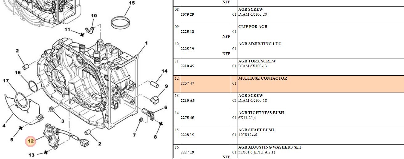

Looks right. Can anyone confirm it's the right part number though as I can't seem to find the switch in service Citroen ?Hell Razor5543 wrote: 22 Feb 2020, 14:09 Might this be of interest?
https://www.ebay.co.uk/itm/CITROEN-AUTO ... SwvxBd5O7k
The picture on the ebay ad shows 0501 209 956 and underneath that 04 2020 03. The first one looks like a part number but when I do a google search for that I'm getting all kinds of other things..

Think this is it?
Not shown as NFP, but it is £212....

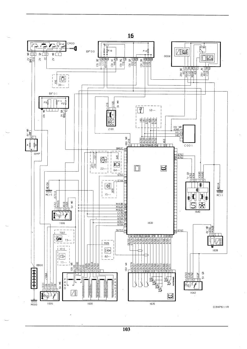

Simon,
We now have a lot more XanI and XanII circuit diagrams than a while ago.
Can you post your VIN (sorry to have to ask), and we can scour through to try to nail down your F4, and the correct diagram (if not the one above).

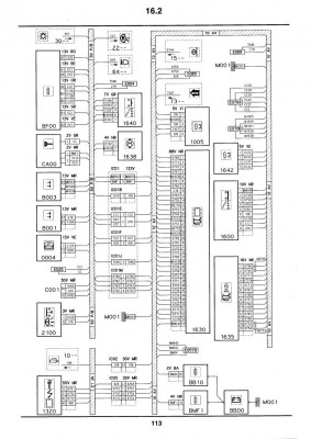

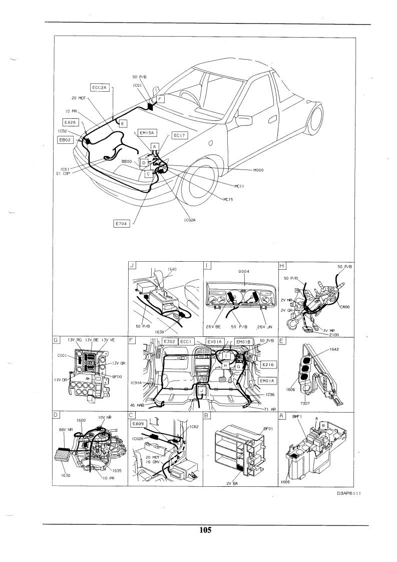

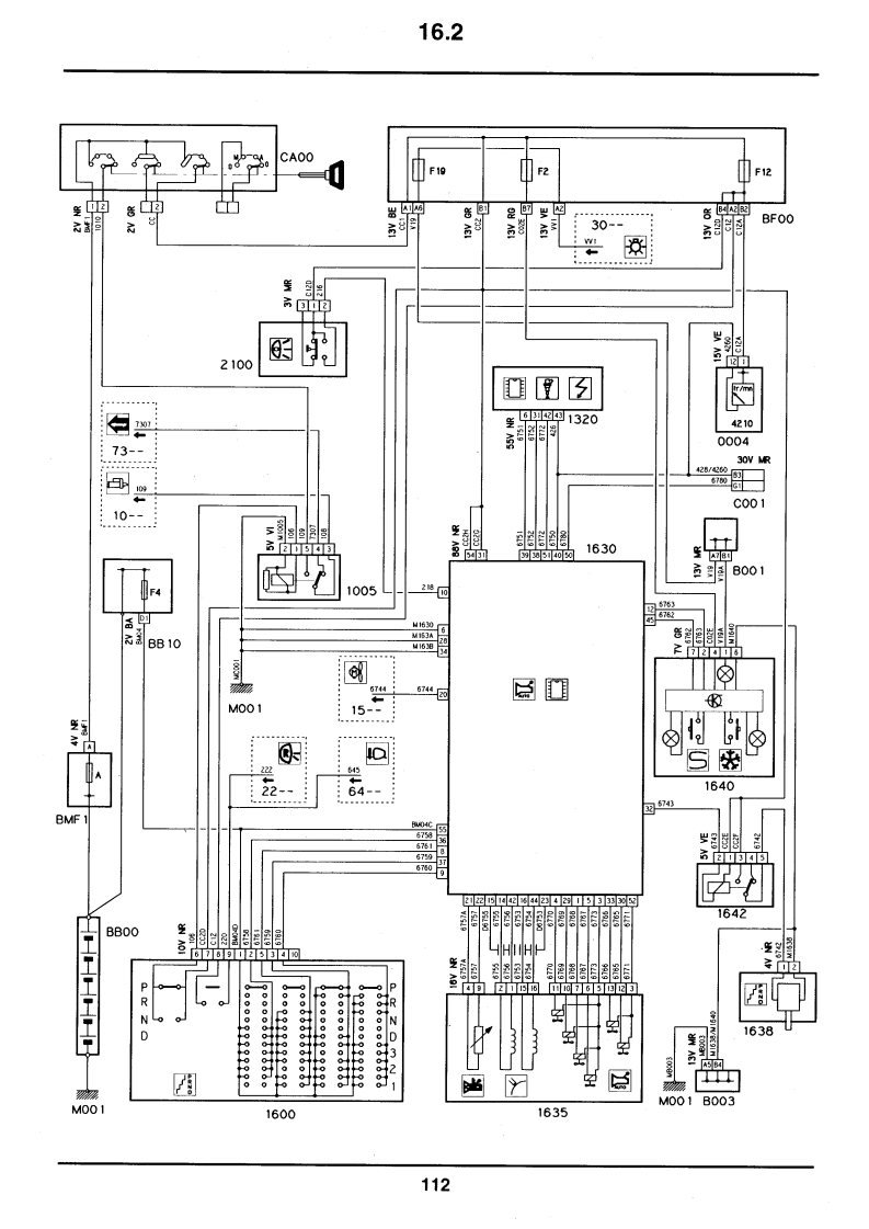

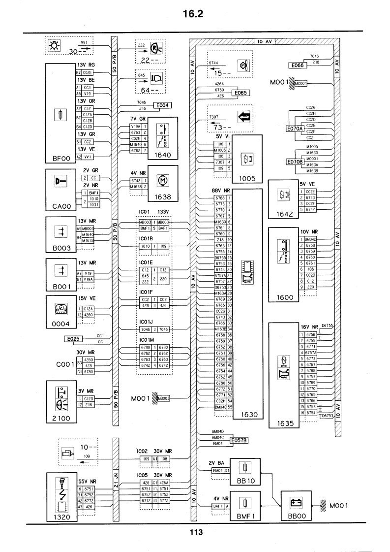

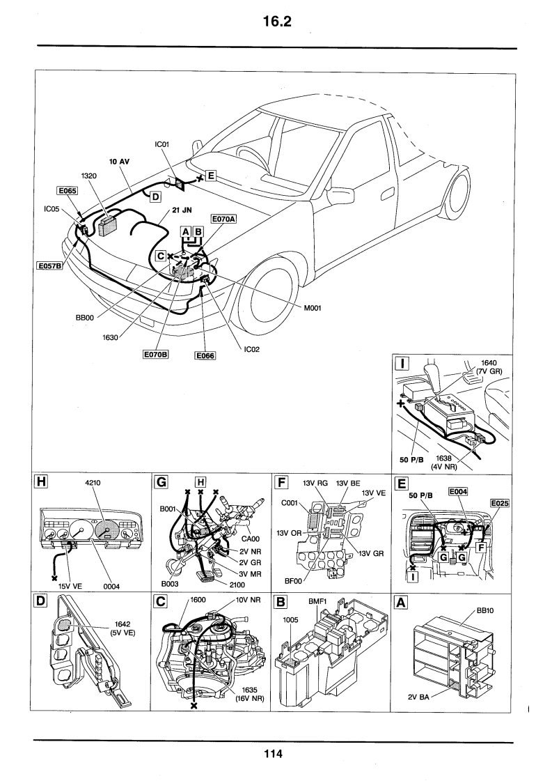

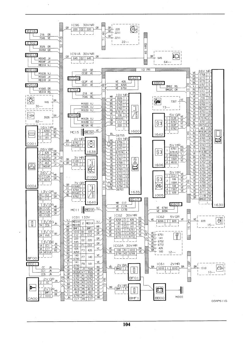

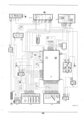

Your RP (7515) gives build date of 6 June 1997.
This sits close to two published circuit editions:
- one is "S2 MY1998 for RP7483?" and published July 1997
pages... (the diagram Mike posted above) in which engine bay F4 is listed as 25A, "Injection or Not Used"
- t'other is "S2 for RP7668 [6 Nov 1997]?" and published Feb 1998
pages... in which F4 is listed as Empty
So you can take your pick.
Looks like they were catching up on getting the actual circuit diagrams into print,
and that you were correct about the later cars not having the ability to have F4 whipped out.
Hope the second set of diagrams might be of help.
