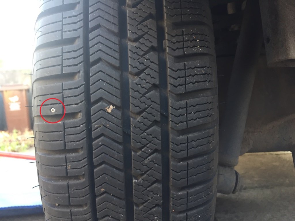

Unbelievable. Looks like I have a tiny screw in my brand new tyre, and it must have been there within the first week or so that the tyre went on based on when I first noticed pressure loss...
It's too late in the day now to get anyone to look at it, and my worry is if they take it off the rim but it turns out to be not repairable I don't have a spare wheel for the car to keep using the car while waiting on another tyre.
It looks like it might just be within the "minor repairs" area of the tread but it's hard to be sure. Not a happy camper.
Edit: spoke to a local garage I sometimes use on the phone and after describing where it was he said it's probably too close to the edge as they need 20mm of flat tyre wall around the repair. So I'm probably up for a second new tyre in a month.

That tyre is pluggable/vulcanisable. They will have 20mm of 'flat' to work on by the time the tyre is in the vulcanising clamp/press. Someone just wants to sell you another new tyre.

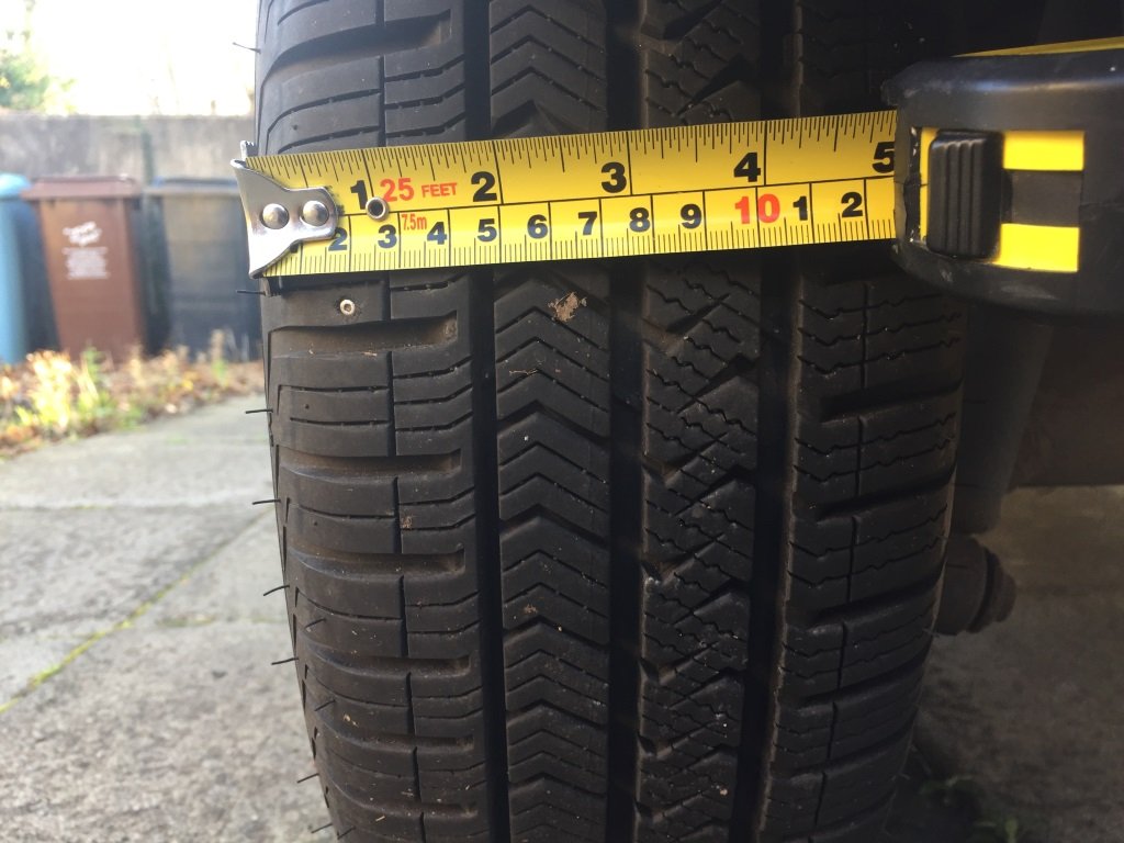

There's a handy guidance note and diagrams (pdf) from the British Tyre Manufacturers' Association on what they deem permissable to repair.....
http://btmauk.com/wp-content/uploads/20 ... -tyres.pdf

bobins wrote: 17 Nov 2018, 13:43 There's a handy guidance note and diagrams (pdf) from the British Tyre Manufacturers' Association on what they deem permissable to repair.....
Yes, I've already had a look at that and by my measurement the puncture is right on the borderline or perhaps outside the allowed area. It all depends on exactly where you measure to since the edge of the tyre is a curve not a sharp edge.

If that tyre is a 175/55/15 then the allowable width for repairs is 114mm, with the centre line at the 3 inch mark on the tape measure. As you say, the puncture is right on the borderline of 57mm from the centre line. Time to get the vernier gauge out, methinks

Pretty sure they'll decline to repair that - they tend to want it to be well in the tread. I'd stick some tyre weld in it, and forget about it....

Disappointing. Here, that would be straightforwardly repaired, and done well: plug, internal patch and vulcanise. The worse that could happen, surely, is the return of a slow leak - and most unlikely if the repair were done competently. Here (like many other places) things get fixed, almost as a matter of pride.

After having a closer look at it I've decided that it's a used pop rivet.
It's not leaking at all at the moment so if I had a spare tyre on-board even a space-saver, I'd probably just keep driving until it gave me problems knowing that I'd be able to change the wheel myself and get home in a reasonable amount of time when it did finally let go.
But with no spare I'm reliant on the AA to get me out of trouble when it does spit the dummy, and the last two times that's been a major inconvenience which has lasted hours and fortunately both times no 2 year old on board so even though I've upgraded my AA coverage to include "relay" I don't really want a ticking time bomb that is going to give trouble sooner or later. If it's a smooth pop rivet stem plugging the hole instead of a screw it's more likely to be ejected when hitting a pothole etc, (plenty of those in Lanarkshire and Glasgow!
I'm going to see Cooper Brothers on Saturday to get them to have a quick inspection, if they say they can fix it I'll give that a try, if not I'll just back order a new tyre for fitting the following weekend and get it swapped. At least on this car the tyre's are relatively cheap! They're considerably cheaper than Xantia sized tyres, even for a Quatrac 5.

- x 2943
Re: Simon's new Xantia V6 and Peugeot Ion blog
My tyre place would repair that while I wait, it's a simple plug job in that area.
