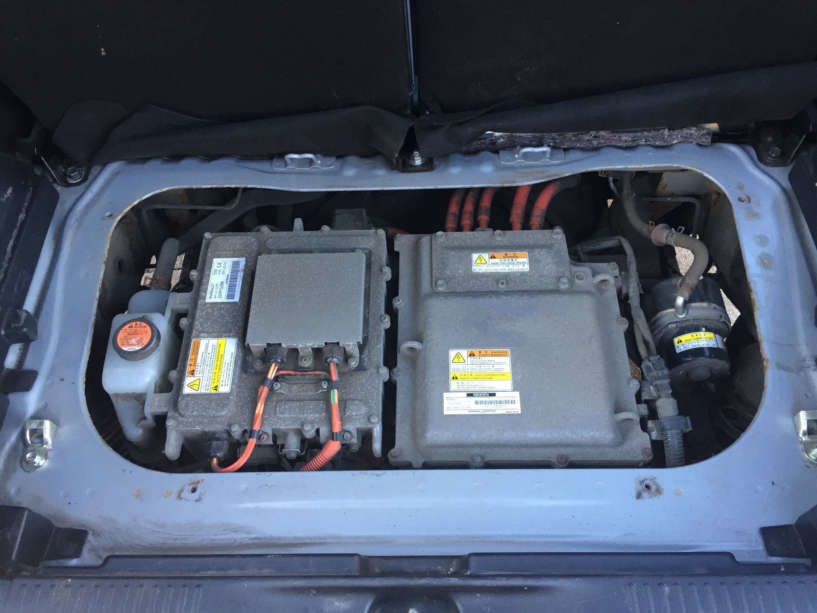

What exactly is the function of the inverter? I ask as I'm wondering as these vehicle get older and less valuable if there might be a work-around...
Does the inverter just behave as a smart battery charger or does it sit between the battery and traction motors and control all aspects of the drive?
I have no doubt that whilst repair of the original unit may not be feasible someone will devise a substitute system.
It's the kind of thing I would have (might even now, given the right circumstances) done in a heartbeat and with great relish...
It is, from my viewpoint, the equivalent of doing a DIY rebuild on a 4HP20 gearbox... It hadn't been done before but I blazed the path and proved it could be... This is no different in principle...

white exec wrote: 05 Feb 2018, 16:57 For us, that's a No, then.
Sobering information. Wonder what the cost of a new one is?
I'm guessing that the inverter is the most complicated bit of the EV powertrain, and executes all the motor (acceleration, regen braking, etc) control functions . . . or are there other similarly complex units?
The drive inverter is a high powered DC to AC inverter usually using IGBT's to convert DC from the battery to variable frequency variable voltage/current 3 phase AC to power the motor. So yes it sits between the battery and the motor, and can be easily spotted as it will have two large orange cables going to the battery and 3 large orange cables going to the motor. It's also responsible for regeneration where it harvests the output of the motor and turns it back into DC to charge the battery.CitroJim wrote: 06 Feb 2018, 08:09 What exactly is the function of the inverter? I ask as I'm wondering as these vehicle get older and less valuable if there might be a work-around...
The speed of the motor is controlled by the frequency of the sinewave. The torque control depends on the kind of motor - on an induction motor the inverter introduces deliberate frequency slip to generate torque by making the sinewave frequency slightly higher than the actual measured rotation speed of the motor. (Or slower to regenerate) For a permanent magnet motor like in my Ion, torque control is achieved by varying the phase of the AC in relation to the measured absolute position of the rotor - the more phase lead the AC has over the rotor position the more torque the motor produces and the more current it draws.
If you imagine a rotating magnetic field produced by the 3 phase stator, if you keep the field slightly head of the pole of the magnet on the rotor it will generate a torque. If you keep it in line with the magnet there will be zero torque and if you cause it to lag the motor will generate a negative torque - eg deceleration. Because the phase of the current reversed in relation to the voltage that means the motor is now acting as a generator.
The inverter is not responsible for overall control - for example taking throttle and brake inputs from the driver - that is handled by another small ECU - on the Ion it's called the EV_ECU or Electric Vehicle ECU I think, which performs most of the control that you would expect from the engine ECU in an ICE car, and is the ECU the throttle is connected to. It takes the drivers inputs and commands the inverter to produce the power to run the motor. So the inverter is basically just the high power electronics side of controlling the motor.
They're pretty incredible when you think about it - even in the Ion with its paltry 47kW motor you have a relatively small box that has a 55kW solid state DC to 3 phase AC inverter - for cars with higher power output the power electronics are correspondingly bigger! Also amazing when you consider that faults in the drive inverters is exceptionally rare. I follow speakev regularly and I'm only aware of one EV owned by anyone on the forum that has had a drive inverter fail, so they seem to be very robust, and I think the guy with the faulty Ion one was just very unlucky!
Perhaps, but the drive inverter design is very specific to a given car, and has to be able to communicate back to the ECU(s) that control it, I think it's more likely that we'll just see a second hand market for them using units recovered from scrapped cars - as in the case of the link I provided. And some types of failures may be repairable by specialist repairers.I have no doubt that whilst repair of the original unit may not be feasible someone will devise a substitute system.
You'd need a pretty good knowledge of high power solid state inverter / power supply systems and circuit diagrams to be able to diagnose and fix one, so it's not a job for the shade tree mechanic, but there are plenty of people who would have the necessary electronics skills to do it. Whether repair is economic or whether it just proves to be easier to get 2nd hand units from scrapped cars as we tend to do now with ICE cars remains to be seen.
Yeah, 5 grand - more than I paid for my whole car.RichardW wrote: 06 Feb 2018, 07:45 I looked it up this morning - ref my comment about repairing the car.... 5 grand!! That'll be why he didn't get it repaired then. <1 hours labour to fit it, on the up side.
Swapping one over would be easy. You can disable the traction battery by removing the front passenger seat, under that is a safety cutout link plug that you pull out that disables the traction battery. (It's basically a link half way along the series string of cells) Once that is done no high voltage can emanate from the battery enclosure. The inverter itself is under the boot floor - you just lift the rear carpet and base up, undo a few wing nuts and lift the access panel off and it's right there!
Here is a picture of mine - it's the box to the right with the 5 orange cables.

Right, got it... I'm familiar with those systems and the circuitry as it's essentially similar to the phase-locked motor-alternator building UPSs I used to work on 30-odd years ago...
Those used such an inverter to drive a motor which in turn drove an alternator... The motor was so controlled to keep the alternator outputs in sync with the incoming mains which, essentially, only charged the batteries - all 440v of tem in two banks... All 2V lead-acid wet cells! One monthly task was to take their SG readings and top them up...
It was important to keep the UPS outputs in sync with each other (we had a pair) and the mains so that in the case of UPS failure (and for maintenance) the whole thing could be instantaneously bypassed to allow the building to run on raw mains...
I still have a 640A fuse and an alternator bearing from one of them as souvenirs... The bearing is about 15" in diameter!
The power of the thing does not faze me at all... I grew up fixing high-powered HF radio transmitters which were more plumbing than electronics...

Just realised after looking at my own picture that these guys have mislabeled this box!! It's not the drive inverter at all, its the onboard charger! (to the left on my picture)Mandrake wrote: 05 Feb 2018, 12:52 Price on request for a second hand one. Ha!
https://www.proxyparts.com/car-parts-st ... d/7736095/
The onboard charger is what plugs into the 240v AC mains to charge the car, rated at 3.6kW on the Ion. So that listing is wrong. I wonder if I should contact them to let them know...
