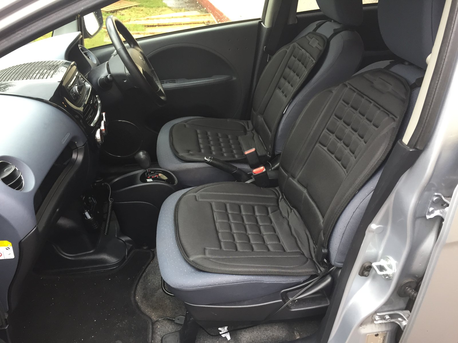

Was in Lidl yesterday and of course they had items of interest in the bargain isle.
Picked up a new car phone mount as the old one is worn out and likes to fall down, also picked up two electric heated car seat covers.
I've never really had an opinion on electric seats/covers before - my first Xantia V6 had them (and is the only car I've owned that had electric seat heaters) but never really needed them as the heater in the Xantia is really good. Not so the heater in the Ion - not only does it consume gobs of power (5kW on full blast) which cripples the range for a car with only a 16kWh battery, it's also not actually that hot once outside temperatures are below 0 degrees.
At -7 recently I had it turned right up to get a luke warm cabin with the air blowing out being warm but certainly not the roasting hot air you get from an ICE heater. The reason being the heater matrix only runs at about 60 degrees at most, compared to 90 degrees for the heater matrix in an ICE, so when the incoming air is frigid it can't get it as hot...
A lot of EV owners rave about electric seats allowing them to minimise use of the main heater. I also find the seats in the Ion quite hard and uncomfortable - previously I had a seat cover and a memory foam cushion on the drivers seat but I was still getting lower back ache.
These covers in Lidl actually looked really padded and well shaped like they might be quite comfortable - especially in the butt area where the Ion seats are uncomfortably hard.
So I figured I'd take a punt on them as a padded seat cover to make the seat more comfy and any heating effect they might have would be a bonus! I bought one at first but went back for a second after trying it.
Turns out they fit the small, narrow Ion seats rather well, and look better than the old seat covers I had:
They are actually really well padded and comfy, and transform the comfort of the seats for me.
They also work amazingly well as heaters. They're about 30 watts each, and you start to notice some warmth within about 2 minutes and after about 5 minutes they're really warm even through layers of clothes. And boy does it really make a difference! In 5 degree weather yesterday I was driving around with the main heater turned off completely and the seat cover was all I needed. I had warm clothes on too of course, but with your core warmed up your hands don't seem to feel cold, and cold hands is often the first thing that makes me turn the main heater on.
The power use of both seat covers on together is about 60 watts (5 amps at 12 volts) and this is 1/100th of the cabin heater on full blast which is almost 6000 watts. (Or about 3000 watts maintaining the temp once up to temperature) So the power use is so infinitesimal compared to the main cabin heater that I can basically leave them on all the time when driving the car with impunity and no impact on range.
And even if I do still need some heater, I can reduce it considerably.

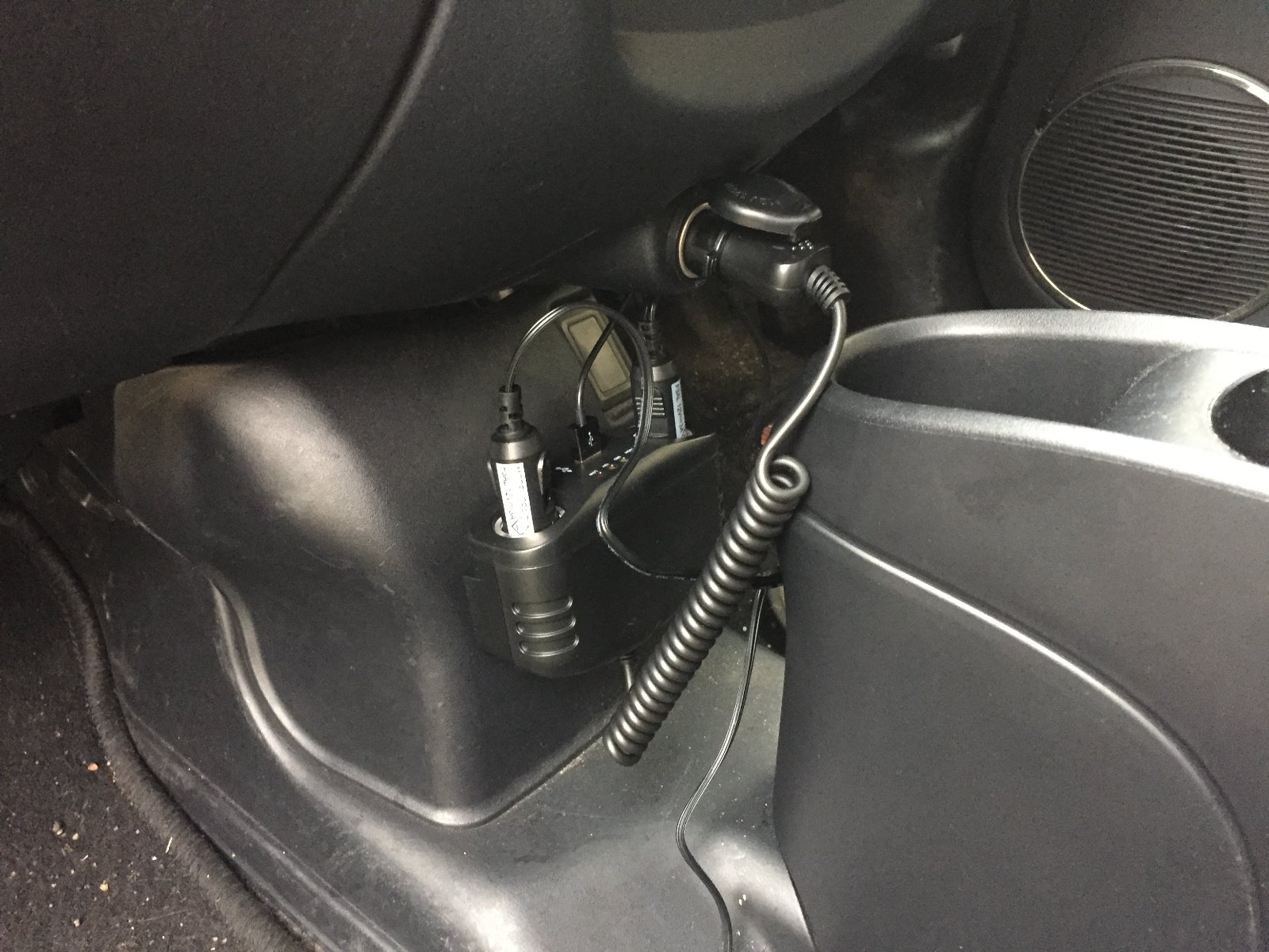

To power them both at the same time and also my phone I picked up a double plug + USB unit from Halfords and mounted it in a convenient little spot:
Ended up quite nice and tidy. There have been two times now since I've had this car where I've had to turn the heater off for the last 10 miles in below zero temperatures to make it home due to unexpected detours pushing me beyond the heater-on range of the car, and I've arrived home like an icicle - very unpleasant.

They do look good Simon
Made for the job and pleased they give satisfaction...
