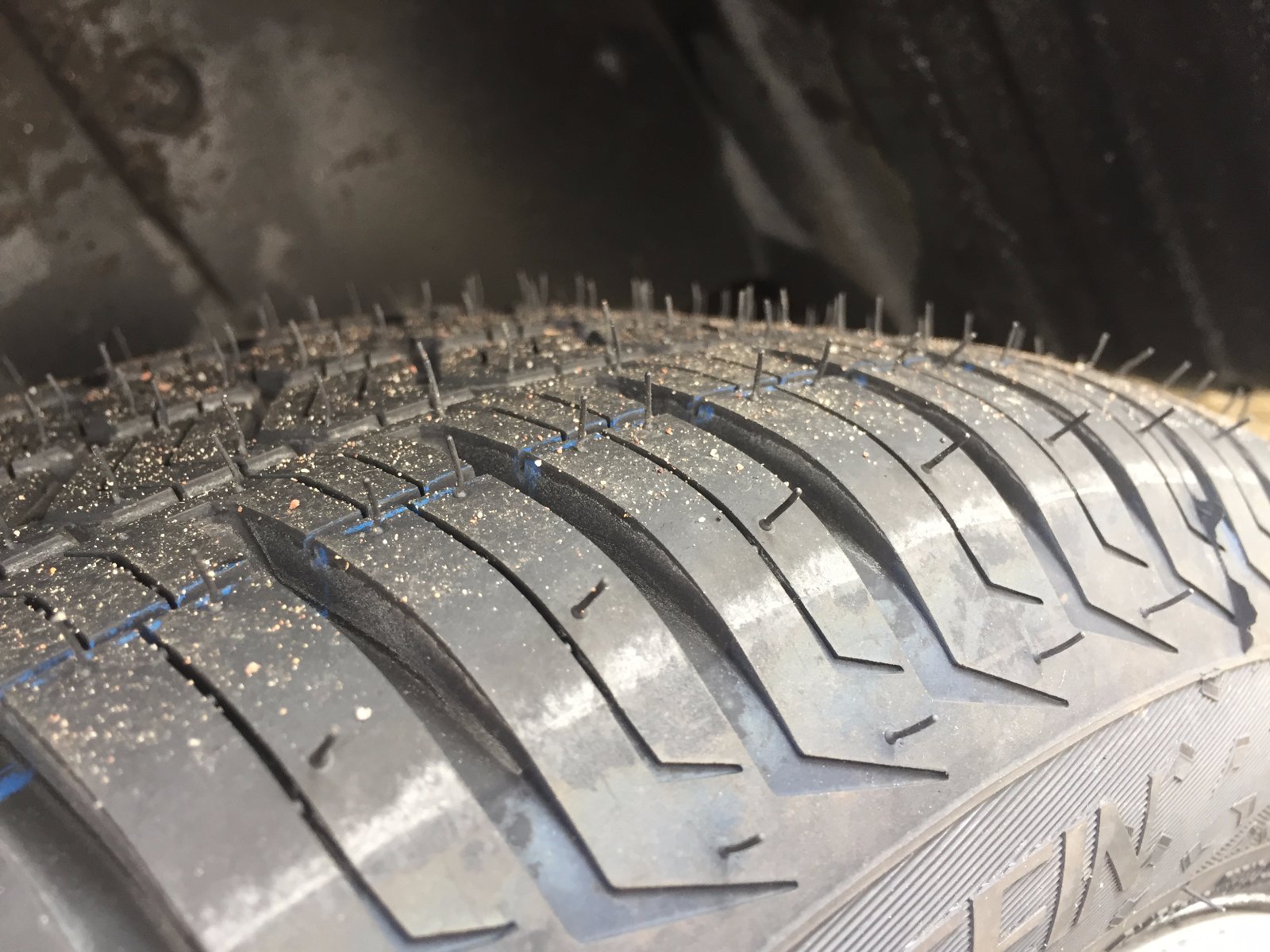

Another thing I thought might be causing the grip prblem is that these tyres have an absolutely insane number of tall little spikes sticking out of the tread, which I assume are injection moulding points ?
All brand new tyres have some of these spikes but usually only towards the edge of the tyre, not all over the main tread as well!
Perhaps these will cause reduced grip on smooth seal until they are worn down, as they may prevent proper contact with the main tread blocks. I'd say it will take a week or so of use before they wear off.

Take a beard trimmer to those little spikes! 8-)

or drive like a nutter for 5 miles :)

white exec wrote: 19 Aug 2017, 20:45 Take a beard trimmer to those little spikes! 8-)
With 40 miles a day I'm sure they'll be worn away within a week. :) It might also be that brand new smooth shiny rubber doesn't grip as well as rubber that has a rough finish to it after being worn in for a bit, a bit like brand new discs and pads don't work very well. I'll give it a few days and see how they feel on my familiar route after that.

I always like to see how long I can keep those little spikes - both on car and bike tyres!

Ok The Vredesteins have done a few miles now (about 150) and although they still have the little spikes that Jim seems to love so much :-D they seem to have settled down now and are gripping more like I would expect.
No obvious wheel spinning on the inside tyre when accelerating on a tight bend as it was initially, and grip seems pretty decent overall for what is essentially a modified winter tyre operating in "summer". However I do notice that the tyre is very "soft" compared to the previous summer pair, primarily in the sidewalls. I guess that is to be expected however I'm thinking that I might need to up the pressure a bit, at least while they are being used in warm weather.
