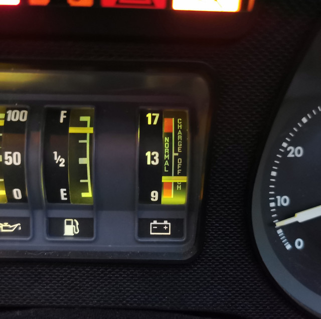

After disappearing for a few weeks the charging issue on the Jag has reappeared.
The alternator is still producing power, albeit vastly reduced and is relative to engine speed. I've noticed over the last couple of weeks that the cut in point has been sitting unusually high, at about 1500rpm. Anywhere below that it would sit off charge. No slipping belt this time, it's actually an internal issue.
New alternator time methinks. It's probably a regulator issue (don't think it's a sticky brush like I had on the Saab as the ignition light on the dash is behaving normally), but given how much of a pain access is (I'm assuming it's not really any better from underneath) I'm disinclined to mess around swapping parts. Even if it costs me an extra £150 or so I'd rather just fit a new one. Otherwise Murphy's Law ensures a bearing will self destruct in six months time requiring me to pull it out again. Once it's done it's done. I could potentially overhaul the old one on the bench and sell it on later to recoup some of the cost maybe. Though given what a pain selling anything is these days it'll be far more likely to disappear onto a shelf in the garage as a standby spare.
