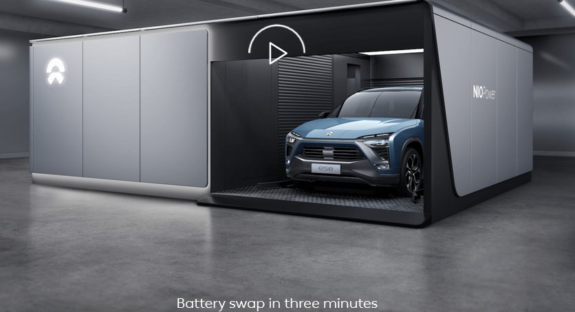

There's one other option that you haven't mentioned Mandrake a quick change battery service, pick up a fully charged battery at Halfords/Kwik Fit or the like, unplug your flat battery and pop in the charged one, if they made it possible on the car's build.
- Posts: 26401
- x 7162
Re: Electric Cars:what's available?

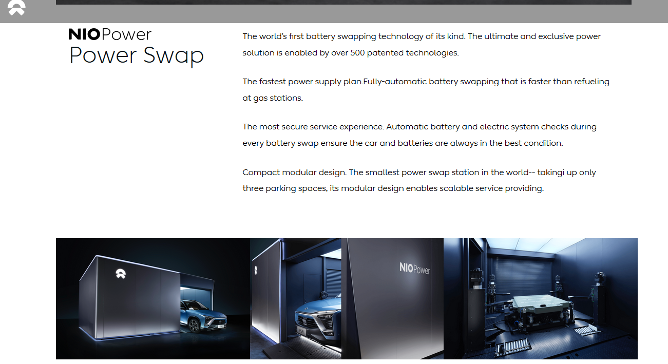

Chinese are thinking about it....Battery swap by robots in three minutes!
https://www.nio.com/nio-power?noredirect=

I didn't mention it because it's a complete non-starter and will never happen with cars.Gibbo2286 wrote: 16 Sep 2019, 16:22 There's one other option that you haven't mentioned Mandrake a quick change battery service, pick up a fully charged battery at Halfords/Kwik Fit or the like, unplug your flat battery and pop in the charged one, if they made it possible on the car's build.
Renault trialed the idea briefly with the Fluence and Tesla also (half heartedly) trialed it with the Model S. But there were no takers.
There's far too many logistical problems for it to make sense when you think it through. I'm reluctant to give a big long exposition about all the problems with this idea (as they've been beaten to death in threads over on speakev.com) but here are a few obvious problems.
1) Making a "one size fits all" battery for an EV to allow for quick battery swaps between different models of car just isn't feasible. The battery is the heart of the car and everything about it is intracately designed around it, including the chassis of the car. Unlike the battery in a power drill with a click connector and a few low voltage terminals the battery in an EV is typically 300-400 volts, can supply peak currents anywhere from about 150 amps (my Ion) to over 1500 amps (Tesla) weighs 200-500Kg, has data cabling between the car and the battery pack to allow the embedded onboard cell monitoring ECU's to communicate with the rest of the car, some cars have glycol coolant loops that would have to be disconnected from the car, etc...
Battery design is very competitive and proprietary, there is absolutely zero chance of manufacturers cooperating in making some sort of lowest common denominator interchangeable battery, and the resulting car would be a huge compromise in terms of range and performance. Not going to happen.
Would you really want qwikfit messing with this even if they could ?
2) Now that we've established that an interchangeable battery that would work across models of car is infeasible the whole plan makes even less sense than it did before that. A "battery swap station" would have to keep spare batteries for every model of car that might come to the station. These batteries are the size of the floor pan of a car and weigh hundreds of killograms. Where are they going to be stored ? Who is going to pay for the capital cost of having these batteries sitting around ? Storing Lithium Ion batteries unused at 100% charge causes (relatively) rapid degradation, but for a battery swap scheme to work the batteries will need to be sitting 100% charged ready for use. So they won't last very many years before they see severe degradation, especially if they don't get used much.
The facility for storing dozens upon dozens of batteries and automatically wheeling them out and installing them in cars would be massive, and dwarf a typical small petrol station or a row of rapid charger stations. Two petrol nozzles (petrol and diesel) cover most cars, likewise two rapid charger cables (CCS and Chademo) cover rapid charging most cars. A battery only fits one model of car.
There is already a huge shortage of raw cells to make batteries for EV's - how can anyone afford to divert a significant percentage of the cells made into packs that will spend a lot of their life sitting degrading on a shelf and not usefully powering a car ? That seems awfully wasteful of materials to me just to save a few minutes charging.
3) Who owns the battery ? If you start with the battery that came with your car and then it gets swapped when you went on a trip, then what ? Whose battery do you have now ? Who has your battery now ? Will you ever see it again ? What range does the one you have now have left and how well has it been treated ? Does it have failing cells and/or has it been knocked around ? How does this affect your manufacturers warranty given that the battery is the single most expensive item in the car ? If it has significantly less range than your original battery or fails on you, what recourse do you have ? What if the battery swap station machine or operator damages your battery ? Bit of a holiday ruiner ?
Conversely, if you have an old car with a high mileage heavily degraded battery and you go in for a swap and come away with a much lower mileage higher capacity battery, who pays for that ? Do you get charged more if you hand in a worn out battery, or do you get away with getting a new battery scot free just by using a battery swapping station once ? Seems easily scamable to me unless the battery swap company is the one that owns all the batteries in the first place - and I can't see that happening.
Nissan and Renault tried battery rental and by and large, people didn't go for it. Nissan have already given it up and Renault are the only manufacturer hanging onto offering cars that are not "battery owned". Unless you only lease the battery in the car, as you do with some Renaults, the ownership and liability problems alone will nix any attempts to do battery swapping.
4) Can a battery swap system ever truly offer a swap time much less than a 30 minute rapid charge in practice ? I highly doubt it. I'm about to drop the battery out of my Ion to change a few cells and I expect it to take a couple of hours at least just to get it dropped down out of the car. To be fair I'm working without a hoist and the car isn't designed for quick battery changes - but neither is any currently made EV, with more modern EV's being more difficult due to more complex systems like glycol cooling loops.
Once you take into account checking whether a battery of the right type for you car is available and booking it in (?) there's no chance that it could be done faster than a 30 minute rapid charge.
Rapid charging speeds and locations have increased tremendously since the early days when battery swaps were seriously considered. It just doesn't make sense anymore if you can do 150kW charging.
In theory a car that could maintain the full 150kW over the entire charging session and had enough battery capacity could add about 300 miles of range in 30 minutes. That's more than the entire range of most EV's today. 150kW rapid chargers are available today (mainly in Europe, not many in the UK yet but increasing) with 350kW starting to roll out already.
For these and many other reasons battery swaps on the go for cars do not make sense and will never make sense. Any small window of opportunity they once had when there were few models of car and no rapid chargers has long gone. The correct way forward is to roll out 150kW plus rapid charging and batteries that are large enough to make proper use of those high charge rates. In theory a battery that is larger than about 50kWh and has active liquid cooling can be made to charge at rates of up to about 150kW for up to 30 minutes at a time.

Nio are giving it a bit of an airing as posted a couple of items back. Even a video to click on a few scrollings down the link.Mandrake wrote: 16 Sep 2019, 19:39 I didn't mention it because it's a complete non-starter and will never happen with cars.
"An Experience Beyond Refueling
NIO Power is a charging solution that is powered by the mobile internet. The wide-ranging network of charging and battery swap facilities, supported by NIO Cloud, allows for NIO users to enjoy exclusive power services with a single click."
Even if the "battery swap" bit doesnt take off, its comforting to know that when NIO EV's eventually need a new battery pack, they will only be charged 3 minutes labour, although the hourly rate of the robots could be astronomical of courseNewcastleFalcon wrote: 16 Sep 2019, 16:44 Chinese are thinking about it....Battery swap by robots in three minutes!
