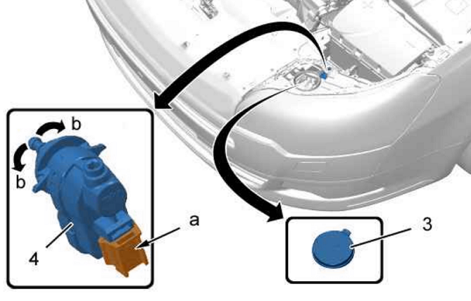

This is one of the more confusing areas between the metallic and hydraulic versions and it is not helped by conflicting information (official), changes in headlamps (Halogen and Directional) for example.Paul-R wrote: 15 Aug 2018, 08:34This brings up an idle thought that I've had in one of my quieter moments.GiveMeABreak wrote: 14 Aug 2018, 22:49With your Halogens they don’t need a load levelling control because of the hydractive suspension, whereas the bed spring versions do have a manual adjuster ...
I wonder how easy (or otherwise) it would be to add headlamp levelling motor control to my car. Either by replacing with complete units off a non-hydractive unit or seeing whether the lamp housing already has the mounting points for the motor. The column cowl will then need either replacing or a hole cutting for the switch. Hopefully the wiring will already be mostly in place but if not what the heck. I don't know if the BSI interferes in any way but I can't see why it needs to be involved and wiring should then be direct surely? And even if instructions do go through the BSI on the pukka system I wouldn't feel the need to do this on my conversion.
Here's where it gets confusing. Neither of you (Paul & Elis) have directional lighting, and both of you have hydraulic suspension, albeit Paul will have a later model with the later halogens. BUT, according to the wiring diagram for Paul's RPO and Hydraulic suspension, it still shows the manual headlamp adjustment unit on the wiring.
So according to my information B-Directional Xenons were also available on the Metal sprung versions - so in this scenario they would also have height correctors fitted to the axles with a slightly different arrangement of interacting with the Dynamic Beam Control unit I suspect.

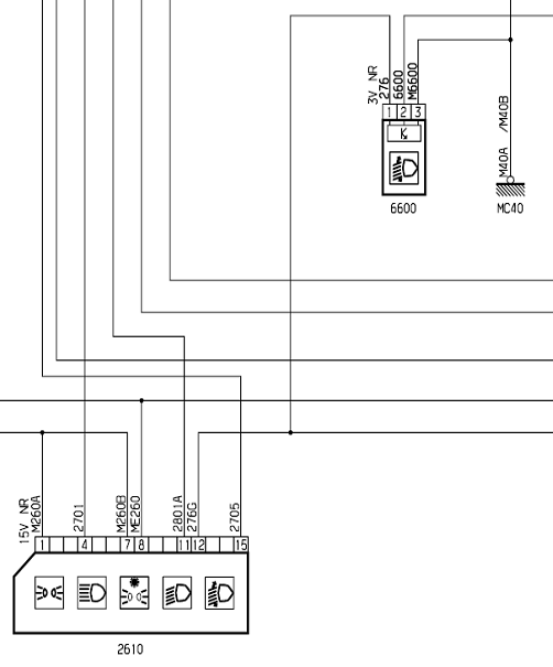

| 6600: Headlamp Height Adjustment Control 276: Headlamp Corrector Position Control 6600 (wire): Manual Headlamp Height Adjustment Authorisation (BSI) M6600: Earth | This is the Lamp Corrector Module, located in each Headlamp (item 15) |
For a description of the Manual Adjustment System:

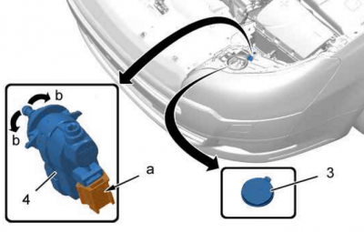

Having compared the system with mine, having the Bi-Directional Xenons, the Dynamic Beam Correction unit is a lot more involved with wiring to multiple systems.The manual headlamp height adjustment is used to compensate for the weight at the rear of the vehicle.

So given that the manual unit won't do anything for the azimuth of the headlamp beam, would it not be better to put a temp mask on that can be peeled off? Surely it has to be more than just the vertical angle of the beam that can dazzle on the continent with a RHD?

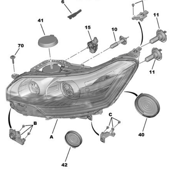

They always recommend replacing these in pairs Richard and something I have always done (as on all my Bi-Directional Models, I have upgraded the bulbs when acquired to a higher performance version). But I've never had one go as yet through usage!RichardW wrote: 15 Aug 2018, 12:27 Interesting stuff about the DS1s Marc - my new-to-me 3008 has HIDs, and the driver's side is much brighter than the passenger side (it doesn't look too much different from outside, but when driving it is obviously different - so much so that when you come up behind another car (admittedly only in half light as I haven't driven it in proper dark yet), there is little reflection from the NS light). I had a look and the NS is a Phillips, the OS I can't tell as the label is smeared - I suspect the OS has been replaced. So I think I will have to replace the NS bulb before the winter (or perhaps both to make them match). Is it worth going to a brighter bulb, or does that just annoy oncoming drivers? It seems to me that the lights are high, but it was tested before I bought it, and passed OK. It also has the swivelling lights, I am reserving judgement on them till I have driven it in proper dark - they seem a bit hyperactive to me as they only appear to have 3 positions, left, centre and right so the move quite noticeably with even small steering inputs, which is distracting, but maybe that's just because I am looking to see what they are doing!
As for the directional element and speaking from the MK II and X7 C5 point of view, you really notice the directional function on country lanes or on windy roads. Moreso without a car in front of you and without street lights of course. Perfect for where I live.
The system is very quick to react and each headlamp has a specifically defined azimuth range depending on the angle of the steering wheel. It is hardly noticeable with smaller turns and of course does not work under a certain speed or in reverse.
My lights move smoothly throughout the angles, but as soon as you come to a stop, or the steering angle falls within a certain range, the projectors immediately return to dead ahead quite quickly to reduce any dazzle to oncoming vehicles, and likewise when moving off - they need to be sure you are moving before the directional function kicks in. The best way to check is in an empty car park at night with a wall, where you can see the movement more clearly on dipped as you steer. Yes - I know I'm sad, but that's how I checked mine were working correctly
But if you live in a rural area like I do, then I would have to say that upgrading the bulb makes a hell of a difference in both range and brightness. They are all type approved and legal, so I can only assume that they have to meet all the stringent Euro regs to get approval. They are not cheap, but lights, like brakes IMO are uber important to have right.

I think that is the only way to know for sure Elis - it is a black 3 pin connection in any case - but my concern would be with the BSI's command and control - again because it is using a multiplexed K Line on the network and we would need to know how that would impact on the current system you have....EDC5 wrote: 15 Aug 2018, 14:08 Does this mean that there is every possibility that the wiring is already in place behind the steering column cover ?
I might investigate if that's the case.
This is the unit:

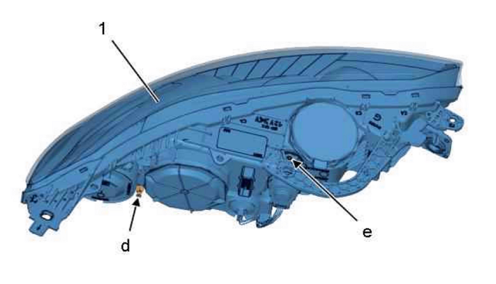

Actually, is there a place to manually move the reflector with a screwdriver on the light cluster itself?
I can see some Allen type plastic bolts but I'm not sure what they are for.

Sounds like the baseline headlamp adjusters to me.EDC5 wrote: 15 Aug 2018, 17:26I can see some Allen type plastic bolts but I'm not sure what they are for.
- x 6960
Re: Marc's X7, Rants, Raves & Everything Else
Watch out for the headlamp adjustment bolts - don't move those as it will bu**er the headlight alignment up and you'll have to get it re-aligned at a garage with the kit Elis.
| Adjustment of Beam: Height 'e' Azimuth 'd' | |
| These are the Adjustment screws on the Halogen |
| Access to the Beam Corrector Unit | Beam Corrector Unit |

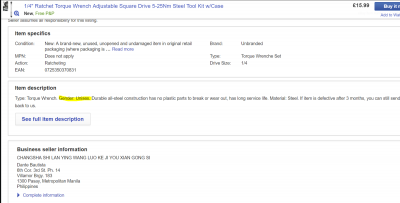

Well, I was having a browse for a cheap torque wrench today and came across the latest thing from the Far east - a Unisex 'Torque Wrenche Set'
Hmmm.. I know it's all the latest fad to be gender neutral these days and all that, but I think this is going a bit far!
