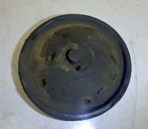

Two things - first of all came back last night to find a large black object where I park the car - so got out and retrieved it and took to Citroen parts in a rush to try and see if it was off the X7.
Luckily it had a part number on it 9684789580, which when I searched on was returning crank pulley! Can't be that I thought - since when are these made of rubber
So a deeper delve and a trip to my local mechanic and on the lift to find it is the crankshaft pulley plug seal that conveniently fell off at some point - but very considerate of the old girl to do so where she is parked and not on the road
The following is not my part - as it's back on the car now - but very similar to this below:
So cap will go in but will easily fall out, so we applied some mastic gasket type compound to hold it in place, which will allow it to be pulled out if necessary in future.

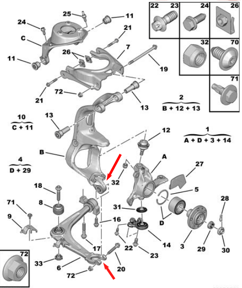

Over the last few weeks I've been hearing an occasional clunk / knock when braking harshly (although not all the time) and sometimes when pulling away harshly (again rarely), and further, when going over a small pot hole or are of missing tarmac on occasions - hearing the knock.
It doesn't happen on full lock left or right so I ruled out the driveshaft and CV joint. I recently had the drop links and both ARBs replaced - so I was suspecting something not mating or slipping under load...
So whilst at the garage this morning with my mechanic, he gave everything a good pull and push and bingo found the culprit. A bush in the lower part of the front pivot support. With a small lever it was moving from left to right without much effort - so causing the clonking noise under load. He suspected it would probably be doing the same up and down when being driven, hence causing the noise going over a rough road.
As you can see from the above , this is the bush in question - and of course Citroen only supply the whole pivot support (B) at a very uncool £357! and do not supply this bush for some crazy reason. You can see where it would knock back and forwards when attached. The left hand one is solid as a rock though.
So my mechanic has located the bush alone for £10 from his parts supplier so will be getting that done soon.
So this is another area that can be added to odd noises for future reference.

Is this crank pulley seal meant to fit over the end of the crank pulley? If that's the case, mine has dropped off a long time ago
Interesting about that one bush being worn. Is it a big job to get to it for replacement?

The rubber crank pulley cover fits within the inner rim of the crank pulley. It's a friction push fit and there's a nipple in the middle so it can be grabbed with pliers and pulled out. Don't know if it's to keep muck out or for sound deadening - or maybe both.

I think it's for damping and for keeping crap out Robin. Hopefully the mastic will hold it in place.
Elis - Yes, I would never of noticed had it not deposited it right on the driveway! Not a big job as they should be able to remove the support from the wishbone and knock it out and slip another one in whilst in situ.
