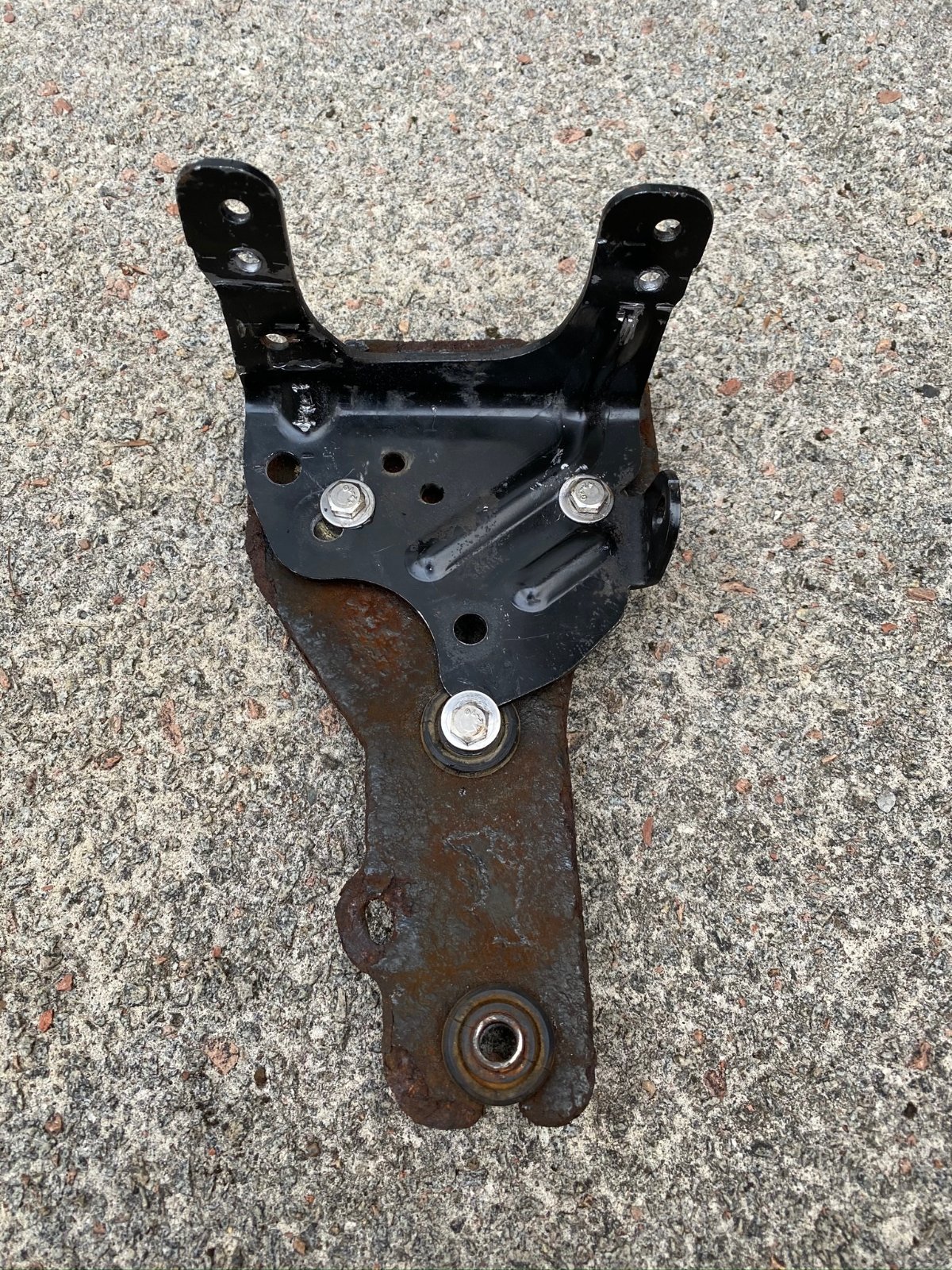

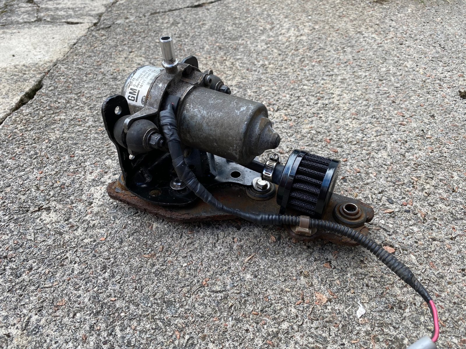

So the vacuum pump repair in the Ion is coming along nicely. Not quite finished yet because although the pump arrived on Monday the filter hasn't arrived yet, hopefully today.
While the pump works fine with the exhaust port left open it does make it a bit noisier and it will not survive long with the port exposed to road salt as it is right close to the rear right tyre...
I've managed to bodge the bracket that came with the pump to give a remarkably professional result. Will post a few pictures when it's all done.
The only thing I would say though is that the pump is a smaller pump with lower delivery so it takes a little longer to top up the vacuum, also it runs at a higher speed so is a bit more audible. Not terrible but definitely noisier than the original pump. But it works, and it's not £780

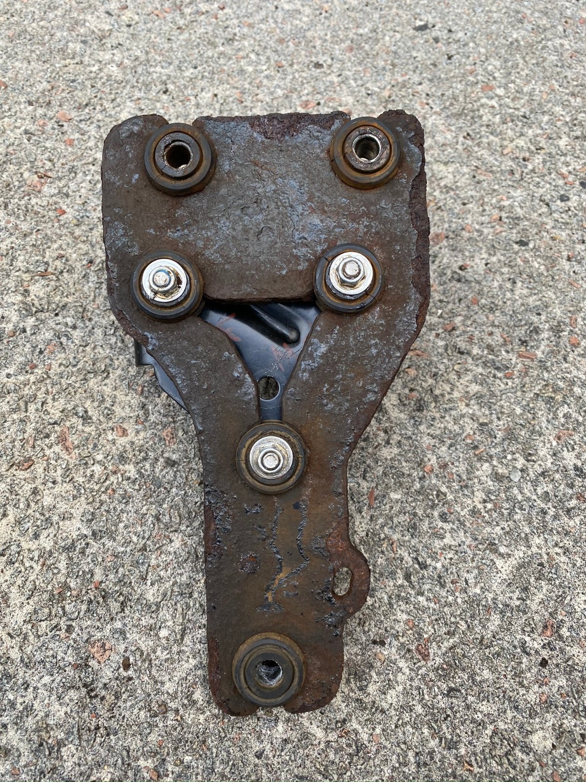

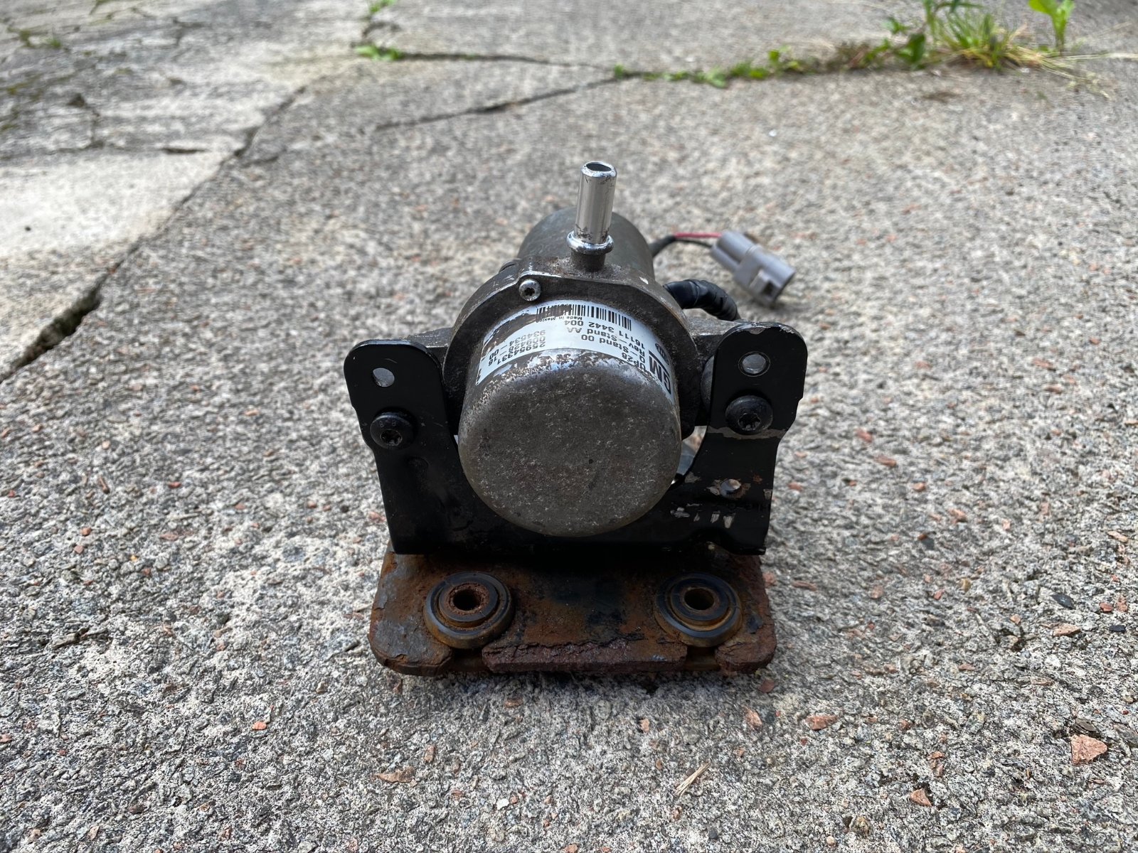

The pump I ordered was S/H so came with the original mounting bracket (from a Vaxhaull Mokka 1.4) and air pipe for the exhaust which turned out to be very fortuitous...
First I straightened out the ears that the pump mounts on, and drilled a couple of holes to mount the bracket to the bracket belonging to the original pump:
I drilled another pair of holes for the pump a bit lower down as otherwise it was a bit high causing the hose to stick up too high for the engine bay cover to go on:

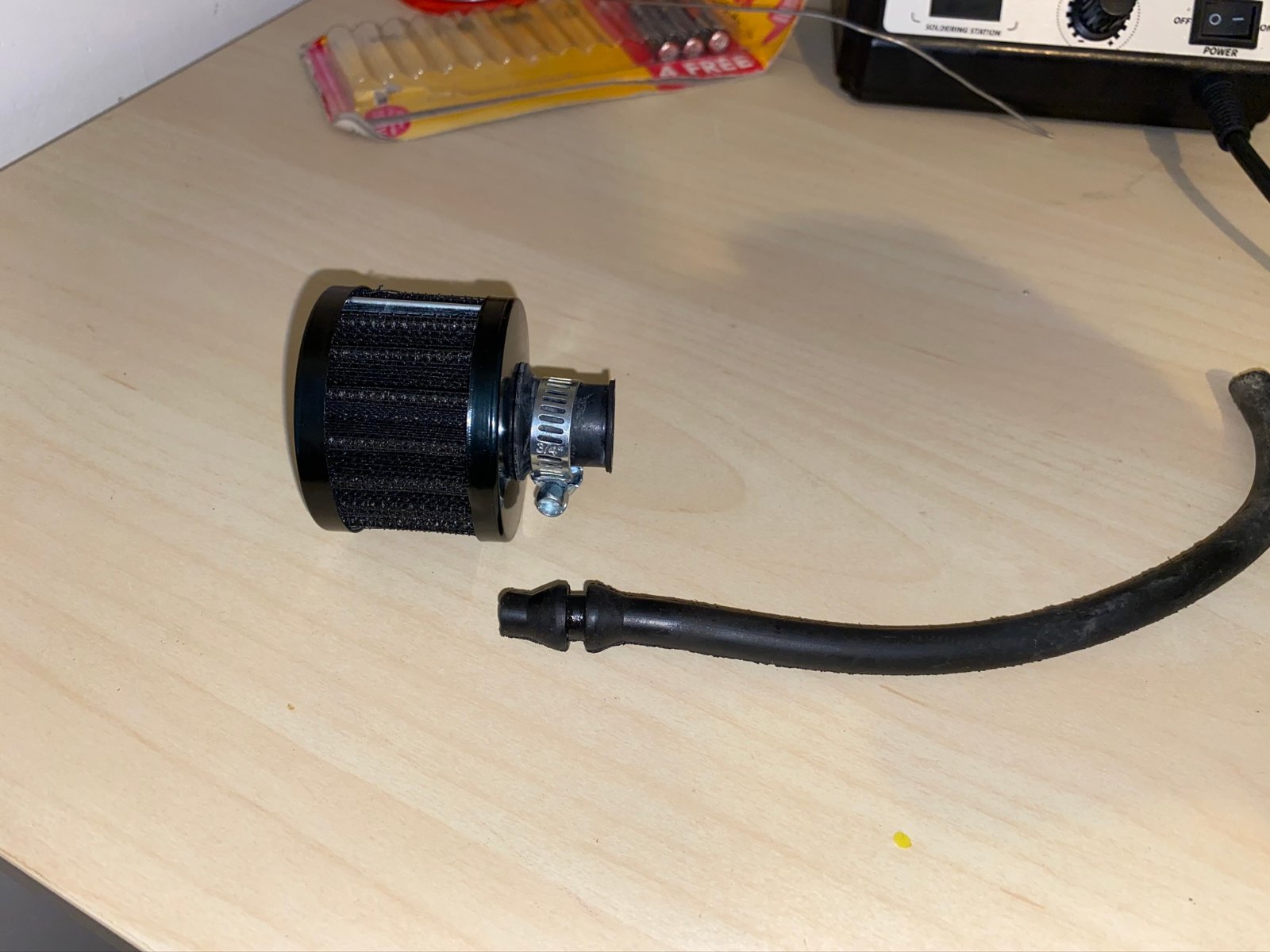

The pump came with an exhaust hose which looks like it would have originally gone into the air filter for the engine, I was able to cut this to length and use the bump to nicely fit the 12mm hole in the filter. Even without the hose clamp it was a snug airtight fit:
I then spliced half of the old cable (including the plug and mounting clips) to the new pump, soldered, heat shrinked and then self amalgamating type to make it water proof, as it is completely open to the road below:

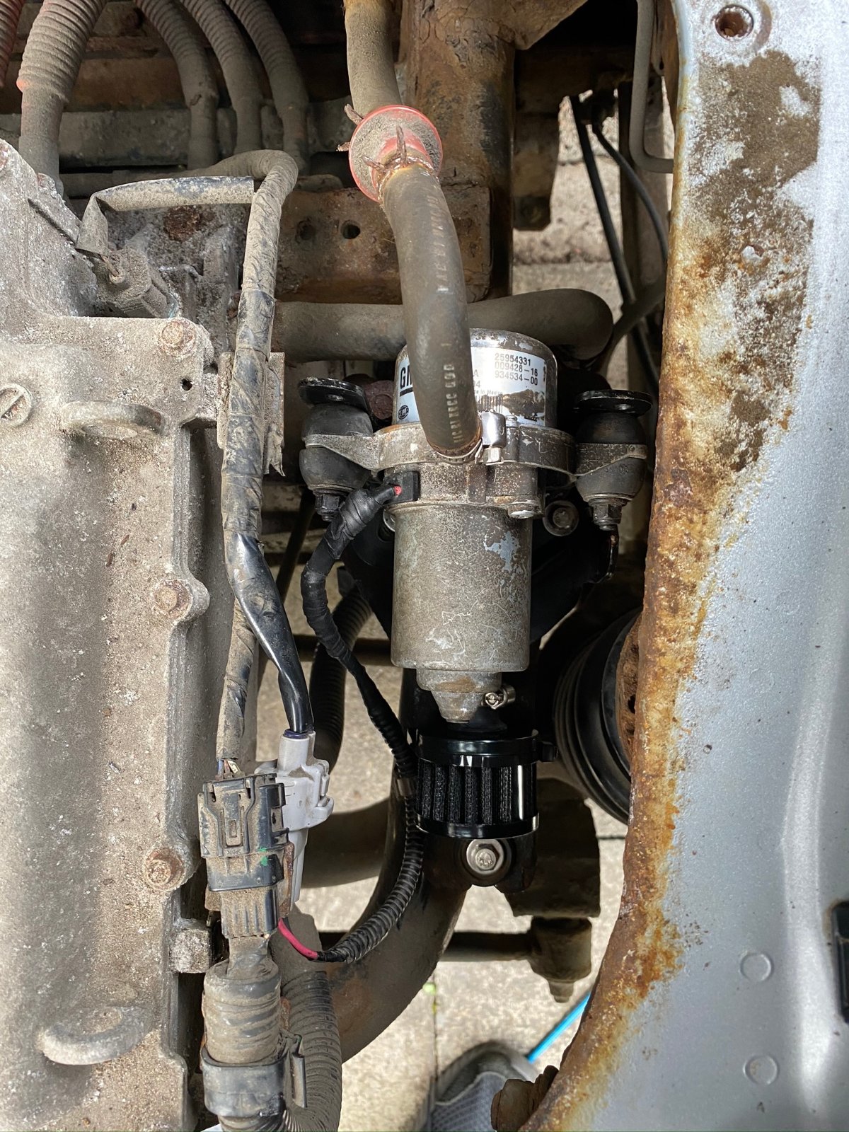

And here it is finally fitted. Apart from the air filter and the shiny new bolts I think it could almost pass as factory original at a glance for anyone who wasn't familiar with what the factory pump should look like.
And yes that is my foot in the photo... there is literally nothing but fresh air between the pump and the road beneath and the tyre right to its side...no wonder it corroded...
I've taken it out for a test drive and it works well. The pump is slightly noisier but you'd only really notice it if you were either outside the car, or stopped with the cooling fan off. At all other times you can't hear it.
Quite pleased with that little repair. What started off looking like a difficult and awkward bodge turned out with a little bit of thought and working through the design to be very simple, sturdy and reasonabily elegant. The motor is mounted on two sets of bushes now - the two built into the side of the motor, and the old and new plate are bolted together through the original bushes.

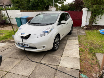

Well it looks like I'm going to have to rename my blog as the Xantia has a new driveway buddy. Bye bye Peugeot Ion, Hello Leaf!
With the successful repair of the vacuum pump I was able to go ahead with using the Ion as part exchange...
It's a late 2016 30kWh Tekna with just 24k miles on the clock and a battery state of health of 92.2%. (Somewhat better than the current 70% SoH of the Ion's degraded battery!) Condition of the car is pretty much immaculate.
We took it for it's first drive today to the beach mostly on motorway and managed 93 miles with 11 miles left with a full load of passengers. In the same 70mph motorway driving conditions the Ion would be lucky to manage 35 miles and wouldn't have made the trip without two charging stops.
Although there are a couple of minor negatives (which I'll elaborate on later) I really like the car - and good job too because I took a leap of faith and bought it without having ever previously driven one!!
Once I've had a week or two of daily use under my belt I'll write an actual review of my likes, dislikes and impressions about the car - mostly likes and very few dislikes fortunately. While it doesn't have the character of the Xantia it's still a very nice car and a big step up from the almost cart-like Ion and is going to make a great, comfortable commuting/family car.
