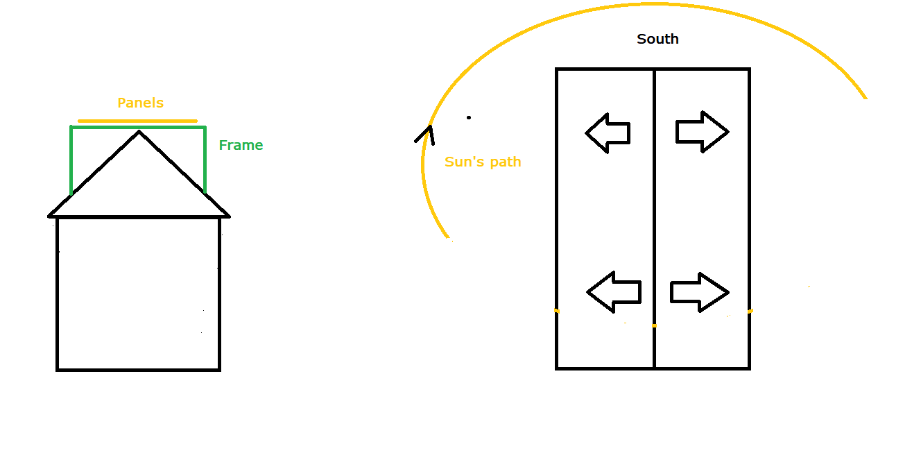

I am throwing ideas around with regard to a potential solar panel installation, which in time may be combined with a wind generator or two, with a home storage system. The initial problem I am considering is the simple geographical layout of our house. If we go for relatively accepted mountings which side of the roof should they go on? Or is the idea I have sketched below feasible to give maximum exposure although the angle of incidence issues may not be ideal? Or is a tilting frame which can rock from east to west as the sun goes round a possibility? Comments from all you existing users are invited!! :-D
Own creation
Own creation

Re: Energy Matters:Home Solar
This may help you decide:

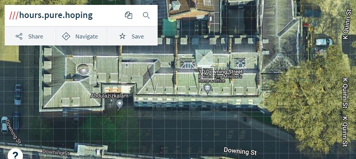

One of the tips for finding the direction of your roof, without going to find that readily accessible compass is to use what 3 words.
Number 10 Downing Street does have a decent South facing roof, and the quirkily named what three words of...
With the current weather sorting the directions is very simple. Due south is the direction of the sun at 13.00 hours (noon GMT) which is the method I've always used!! :-D
