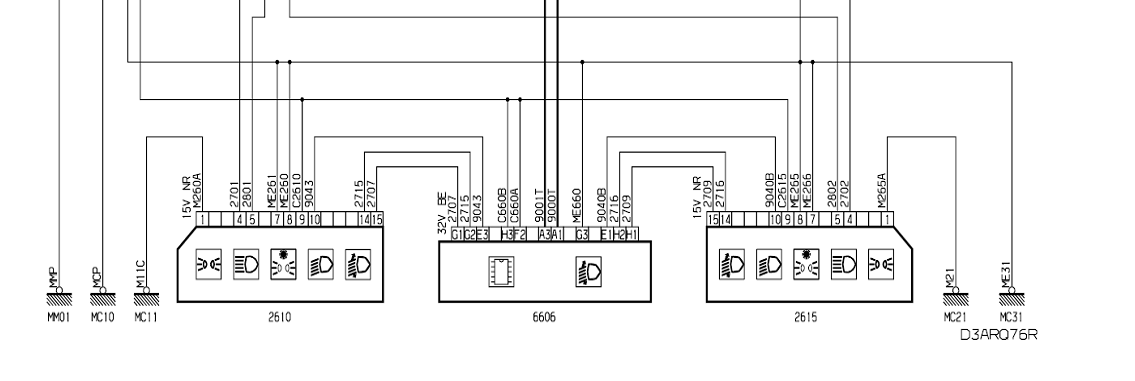

Im have left and rght hand static cornering light: Open circuit.
In BSI i have these errors:
C9AA and C9AB. Any idea where is should start looking for?
Is there a relay responsible for this or a fuse maybe?
- x 6962
Re: Directional headlights fault C5
This is an open circuit fault on both lamps. Check out Fuse F6 (10A) in the engine Fuse box (air flowmeter - directional lighting - headlamps dynamic correction control unit - diagnostic socket)
C9AA: Lighting fault on the left-hand static cornering light: Open circuit
C9AB: Lighting fault on the right-hand static cornering light: Open circuit
6606 : dynamic headlamp beam correction unit
2715 : left static turning bulb earth
2707 : left-hand corner light control
9043 : headlamp LIN bus
2709 : right-hand corner light control
2716 : right static turning bulb earth
Have you changed the bulbs or replaced with LEDs by any chance....?

If you have a fault with the Dynamic Beam Correction unit, then the headlamps will default to a backup mode - i.e. they will remain static. It is the same as switching the directional headlamps off in the steering wheel accessed menu under lighting configuration.
