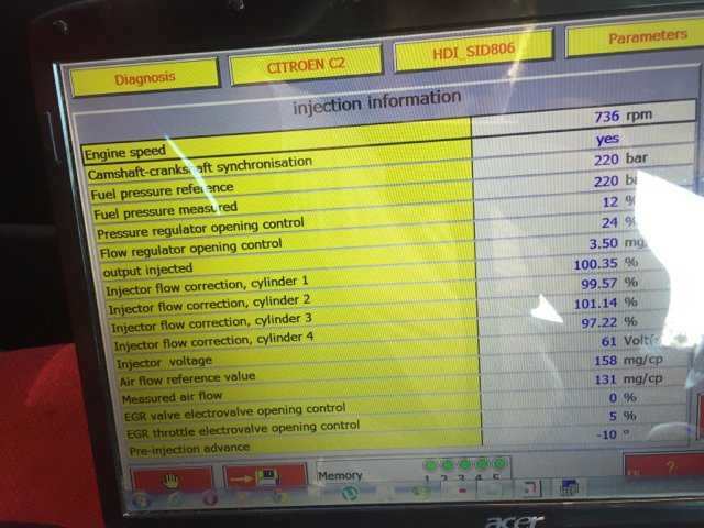

I forgot to mention that when I was trying lexia on it yesterday I found a page that had injector correction values in 2 were at 98-99% and the other 2 were 101% from what I remember I guessed that it was normal because they were all close to the same number it also showed 71v going to the injectors ?

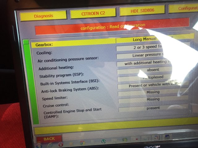

ok I've had a look at the turbo pipe and can't see anything wrong even while it's being revved. I still can't find the injector coding on the lexia software ? I went into configuration and manual configuration but nothing for injectors ? I cleared codes again and took it for a longer drive came back and scanned again faults showed were egr and flow meter ? I seem to get different faults each time I drive it but egr seems the most common one.
This is all I get in configure menu ?
Here is the parameter info after a drive

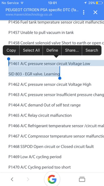

I've still got the issue but I've found this
This is the main fault code I keep getting but I've been resetting it each time I start the car ?
Does anyone know how long the learning takes ? I might try taking it for a longer drive tonight

Good idea not to keep resetting it if it is learning, or the cycle will just keep starting again. I would ignore that for now and allow it to complete - short runs won't help - it will likely need to go through a range of operating temperatures to complete the cycle. Looking at those Injector values in the pictures now, they seem very close to each other. Get your EGR checked next as you suggest.
Update - just been out to the C3 to get the dust off the Lexia Software to try and find the coding area:
- Run a Global Test
- When it's finished, select INJECTION from the list
- Then select CONFIGURATION
There will be 4 options: Manual Configuration, Automatic Configuration, Calibration Ideal Reference Coding & Injector Classification. - Choose INJECTOR CLASSIFICATION
This will then show you a picture of an injector and the code locations. Proceed with * which returns you to the coding screen, where you can see the codes against each injector. Follow instructions at bottom of the screen to input values.

Thanks for that I will have a look but that is the area I was looking in although I was going to manual config but I'm pretty sure I only get manual config, Internet config and calibration menus but like I say I will have a look
