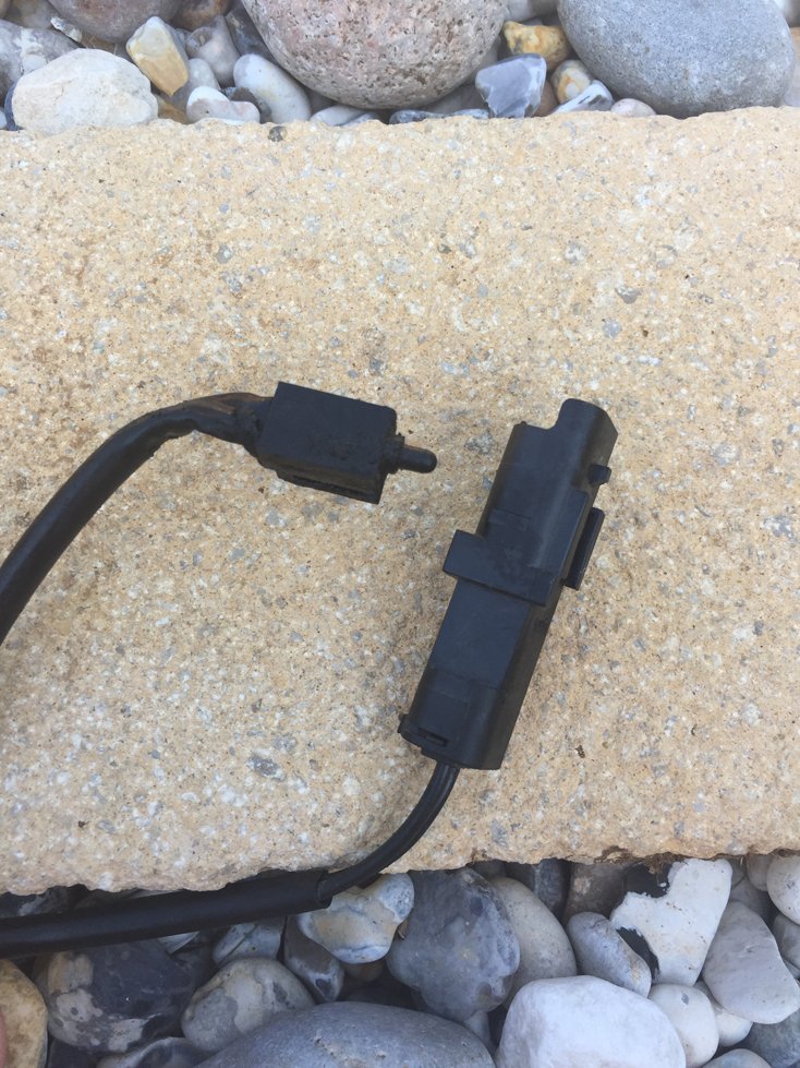

Right today was another pig of a day.
The C3 Alarm has been going off randomly over the last week. I out it down to the hot weather - so fired up the mobile HAL 9000 for a quick diagnostic and nothing.
So decided to disable the alarm temporarily so we could all get some sleep. after having to leave it unlocked for a few days to stop it going off.
I managed to locate it and told it the Alarm ECU was not there, but that didn't work and sure enough 3:00AM in the morning I scampered out near enough in my birthday suit to unlock the bloody thing.
I though it odd that the alarm lights on the dash were still flashing, so off we went yesterday again to double check the parameters - and I also found that I had to go into the BSI and remove it twice before it would save. Talk about twitchy!
Finally last night no alarm lights flashing when locked, so I knew then it was disabled. Now here's the interesting part - took it for a drive to make sure everything else was working and what do we get but the door open warning telling me the bonnet is open
So I stopped and checked - locked tight - opened and closed it, but still the warning. We never had this before at all. So back home tools out and had a good nosey about the lock suspecting the bonnet alarm sensor. The whole area was covered in grease, so I'm wondering if the sensor nipple has been contaminated.
So what is interesting is that it takes the alarm to fail and be disables before I get a warning about the bonnet being open.....
So looking to try and find how this little sod comes off. Thankfully the sensor runs from the bonnet catch mechanism, along the top of the radiator area and connects to a plug that goes to the ECU inside the car. The thing is held on by 2 industrial strength clips that were a git to come off and then a plug type clip that holds it to the chassis without being able to get underneath to get at it - so brute force prevailed and got the thing out with only minor blood and bones exposed.
I did have to take the bonnet catch off to get the sensor off as that clips on and once removed, has gone all feeble and weak - so it is going to have to be replaced.
So now the shock and awe bit:
Checking for the part 633943 - Citroen want £58 for it! Basically for 2 lengths of electrical wire, plug and a simple filament sensor! This must be one of the classic overpricing examples I have ever seen (apart from my steering rack of course).
Now for the second really annoying thing - I had a squiz on ebay last night and chap had one for sale (genuine) for £30 odd quid - but this morning went to order it but the little blighter had gone - so if you are one of those people out there who bought it - I was there first
So I have just spent the afternoon taking it off and here is the £60 worth of hi tech wizardry:
So the search goes on for a replacement as there really is no way to open the sensor and clean it up.

I just plonked those cables down to photograph and just noticed that they very much look like the Greek symbols for 'Alpha' and 'Omega' - which just about sums it up!

Marc, do you have the option of killing the interior volumetric sensors (if you have them), and leaving perimeter protection operational? I know it's a different system, but XM vol sensors could trigger falsely and easily in hot weather, even without a stowaway fly. OE includes a vol sensor defeat switch.
PS. Isn't that little rectangular box with the small plunger sticking out just a push-switch? I have exactly the same on each of the two XM bonnet catches.
