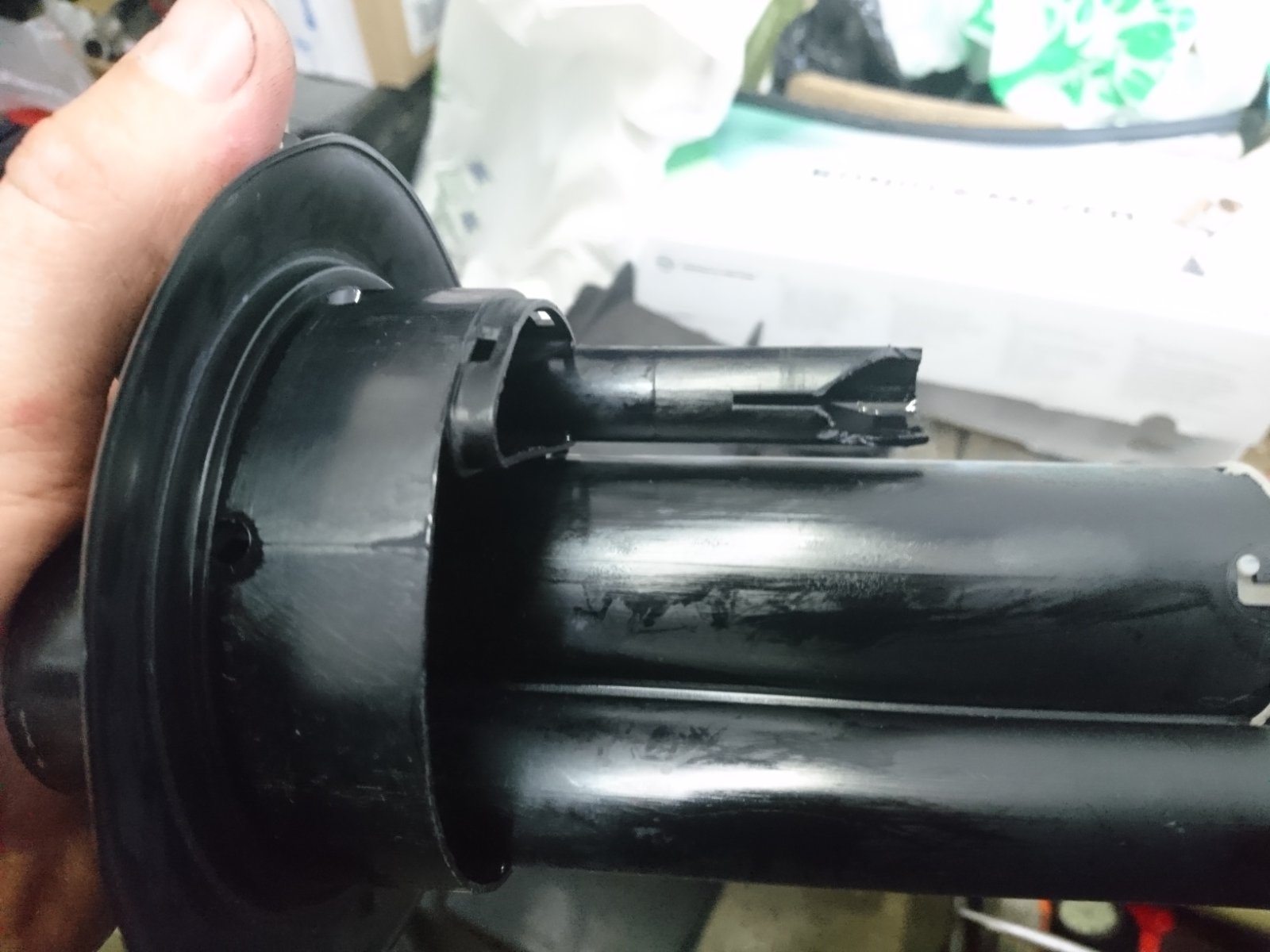

xantia_v6 wrote: 14 May 2020, 21:16 I remember that one person found that the plastic top of the LHM tank had a crack in the port for the suction hose, and that caused an air leak that was very difficult to find.
I had another tank from XM and CX, and the problem was the same.

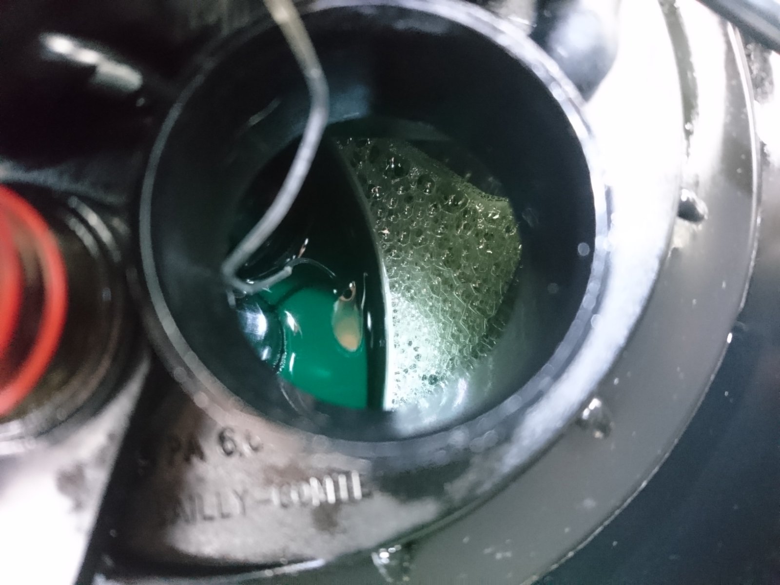

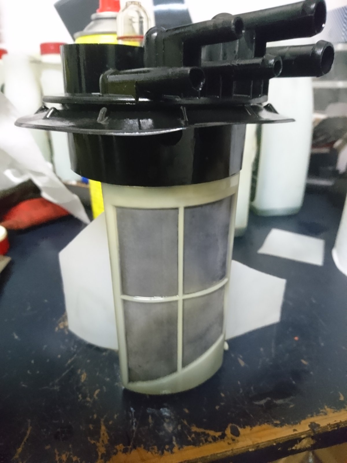

Today I made a partition in the tank. For now I will watch how it will behave.
x 1751

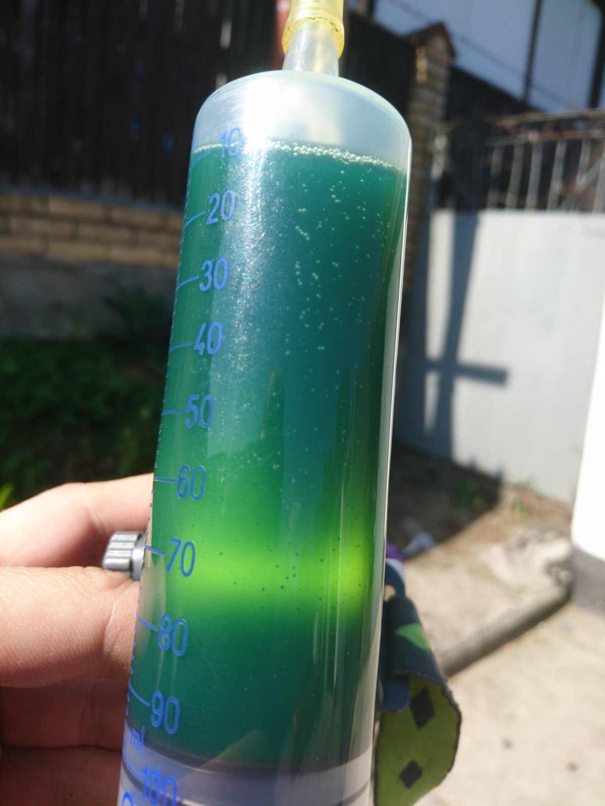

Can you post a photo of a dipped sample of aerated fluid from the reservoir?

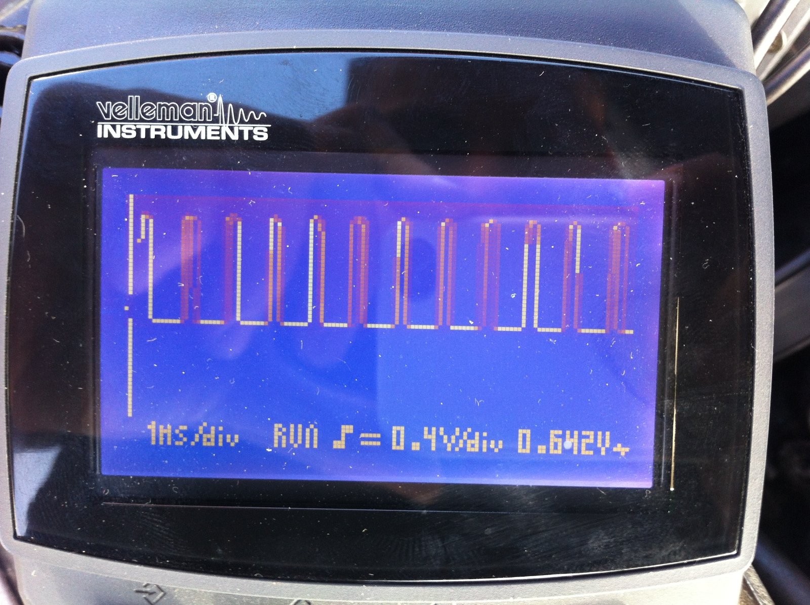

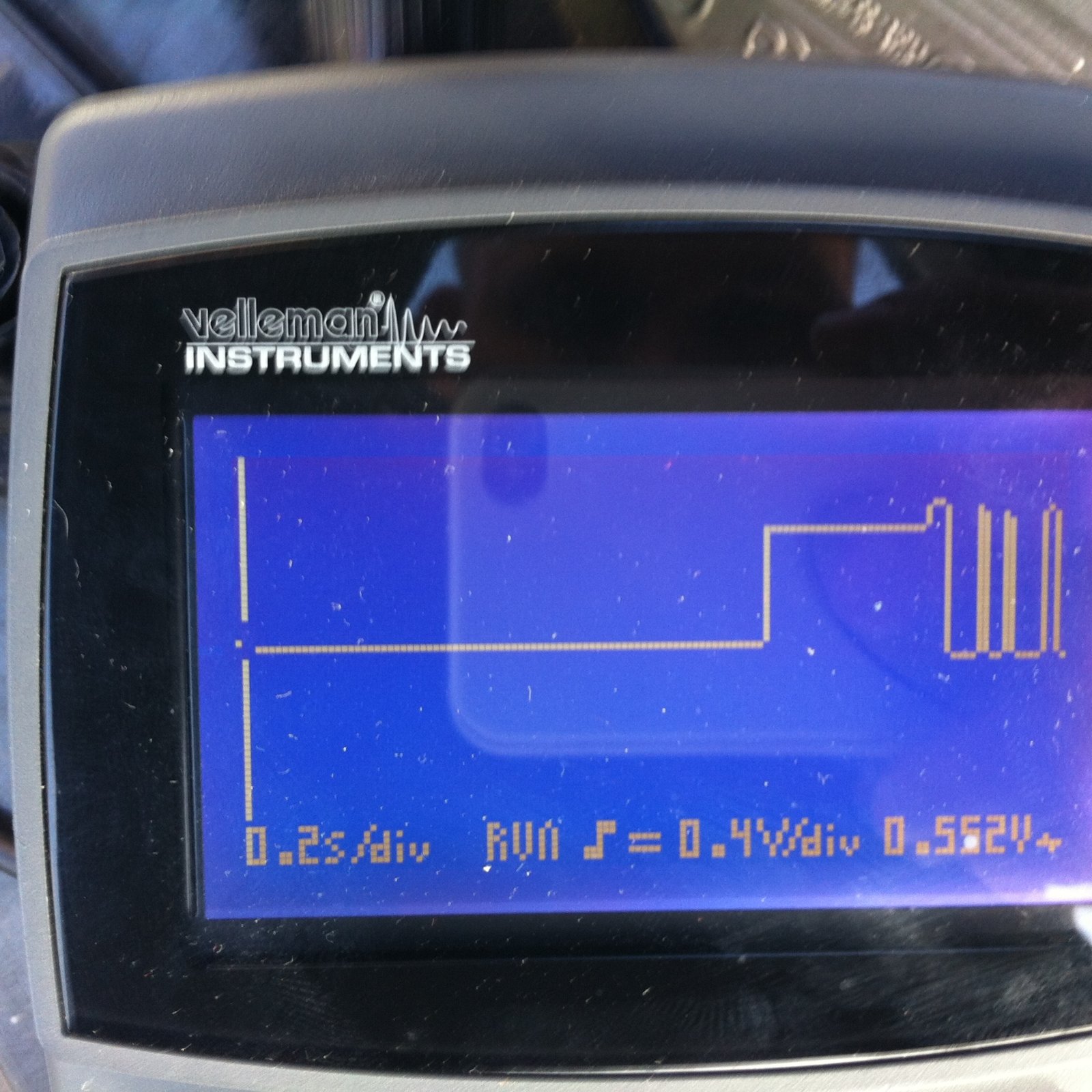

The diodes remain when it is soft. If the sensor catches an error, they continue to glow as it is soft. It does not light up only when starting the HA self test.
I'm going to buy a 24mm long cap to unscrew the solenoid valve and then to the garage to pull some oil from the tank.
x 1751
Re: Workaround for bubbles in LHM return flow
That confirms the crash is not caused electrically (suspension stays in Soft mode), but is hydraulic.

This is not an electrical problem. I changed to computers. I adapted the old H4 computer to the H5 version and it was the same. I checked the computers impulse and everyone had similar parameters. Old H4 had a more complete impulse. H5 less filled.

Today, oil looks better! A lot less air blisters. Maybe this partition in the tank helps a bit in not spreading the air around the system.
After 10min it travels around the city

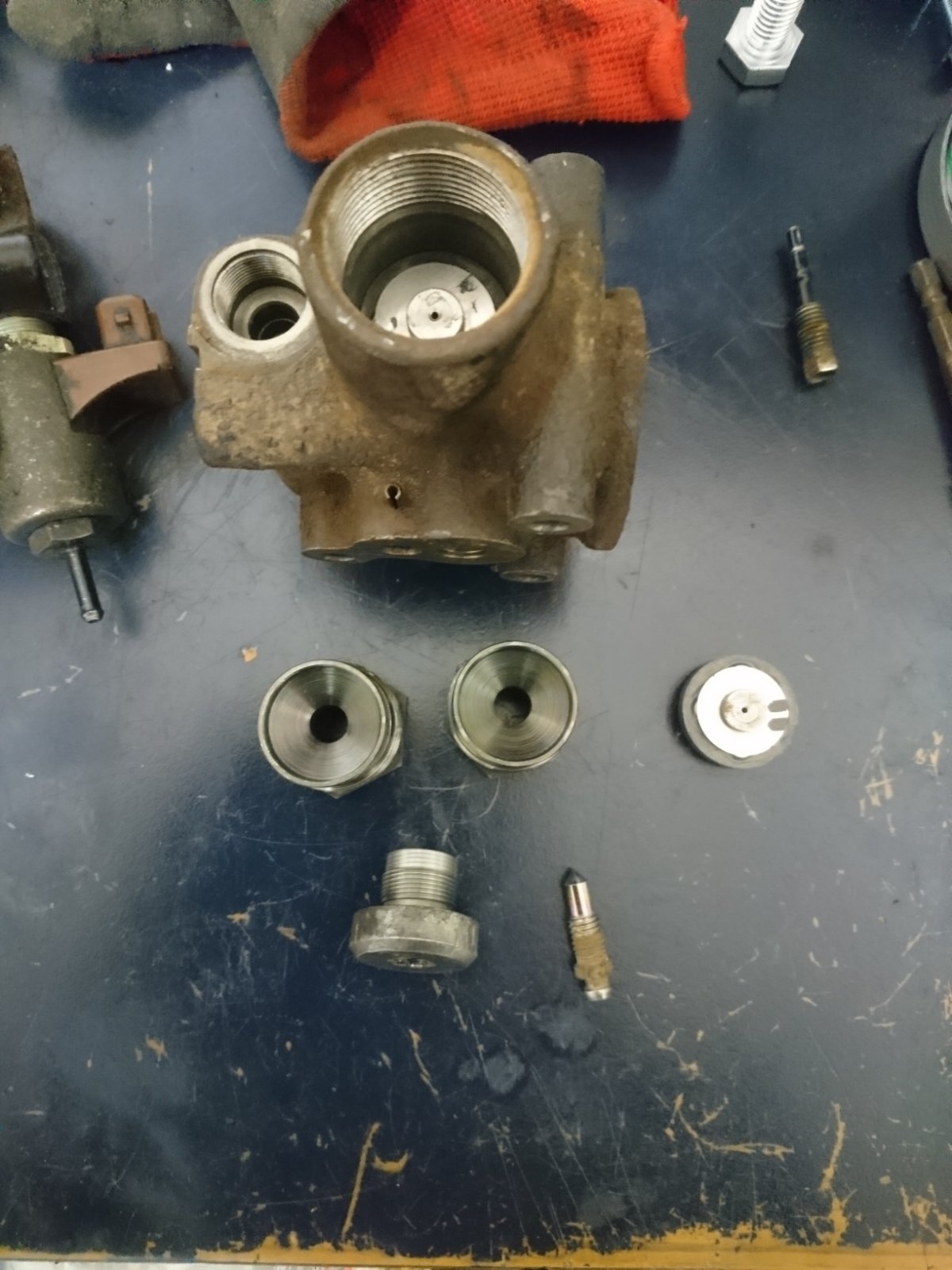

I changed the HA blocks. I did the front and back. By the way, , I gave new seals for EV solenoids because I had to disassemble them into parts. After all, the rear suspension works smoothly all the time! Almost like in CX. The front bends less than before, but in the front I had a block with Xantia chokes installed and probably that's why I hit the bottom bumpers sometimes. It is more stable. He still shakes on the holes and makes noise. Now just the front axle. I still need to change the front cylinders, because on the left side it makes a lot of noise and seems to be loose. I will drive and test so that I bleed as soon as possible.
x 1751
Some real progress, there. You have been extremely busy to get all that done so quickly! :)

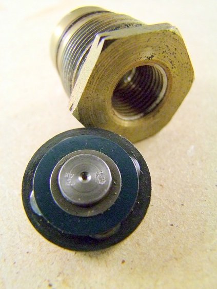

It is important to fit your original XM damping inserts (two for each HA block) into the new Xantia valves.
Xantia has a different damper front and back, and different to XM.
XM dampers are the same front and back.
The damper inserts have a small dotted stamped number stamped on them (next to the small hole in the steel).
You should have four with the the same number - they come from the XM, and are the ones to use.
The centre spheres should also have NO DAMPER INSERT in their necks, just a large (5mm) hole, because the damping is in the block, not the sphere. An incorrect sphere here would result in a very stiff ride.
You really do know how to crack through the work, and have some good XM knowledge there. All good stuff! =D>

There were other chokes in the block in my XMie. All plates full and 1.16-1.18mm hole. I drilled them 1.2mm. As you showed in the picture, I pulled out of the Xnatia block with a 1.1mm hole and I had one previously mounted on the front. So many years of checking these components gave me practice and I unscrew and tighten everything with my fingers :)
I have, of course, balls without 70bar glands. Corner I have factory 40bar and 0.6mm gland maybe because. Maybe there were other chokes in the blocks in 2.9V6?

We never could make any sense of the engraved/dotted numbers on the damper inserts. The numbers don't seem to correspond to drilling size. (I measure drilling size with a needle, coloured with felt pen, then pushed into the hole. This marks the colouring, and at this point I use a micrometer on the needle to measure the diameter.)
As well as the drilling, there is also the matter of the washers (or stack of them) used on the outside of the damper. These allow a large flow of fluid to by-pass the small hole, in the case of impact or rebound. We do not know anything about how these washers are selected. Likely a secret factory listing, with both hole and washers specific to individual type dampers.*
For this reason, it is important (we assume) to stick with the dampers originally fitted to the car.
*For non-Citroen (aftermarket) spheres, we can only guess whether the various manufacturers have any accurate specifications for the washer stack. Sure, the spheres will work, but how well in the case of impact and rebound?
Personally, I use genuine Citroen spheres, and fit them with Tecnosir (Valprex) regassing valves. This gives genuine spheres a long life, and can allow their pressures to be properly set, and prevented from dropping so low that the sphere is ruined. I now check sphere pressures roughly every 3 years.

MatPL wrote: 15 May 2020, 19:57 I spread out a few HA Xm blocks and none even had 1.2mm. Your HA block had 1.25mm you measured it?
I've measured a few sphere dampers, but not those that were in the XM when I fitted the new regulators.
I just took them out, and moved them across into the new units.
Book says 1.25, so just slight larger (less damping) than corresponding Xantia ones, which makes sense, as XM is a heavier car.
