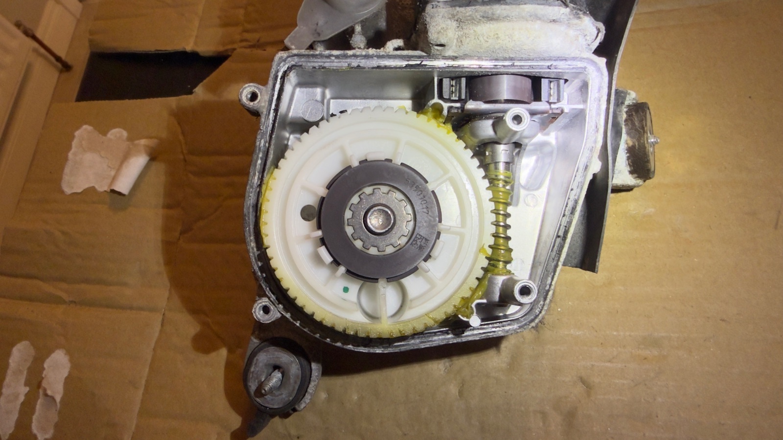

You need to find the post from Ask_dj from 2021, May I think.
A good description and picture of the magnet and how to move it into position.
From what you say it could be your driver's side magnet that moved.

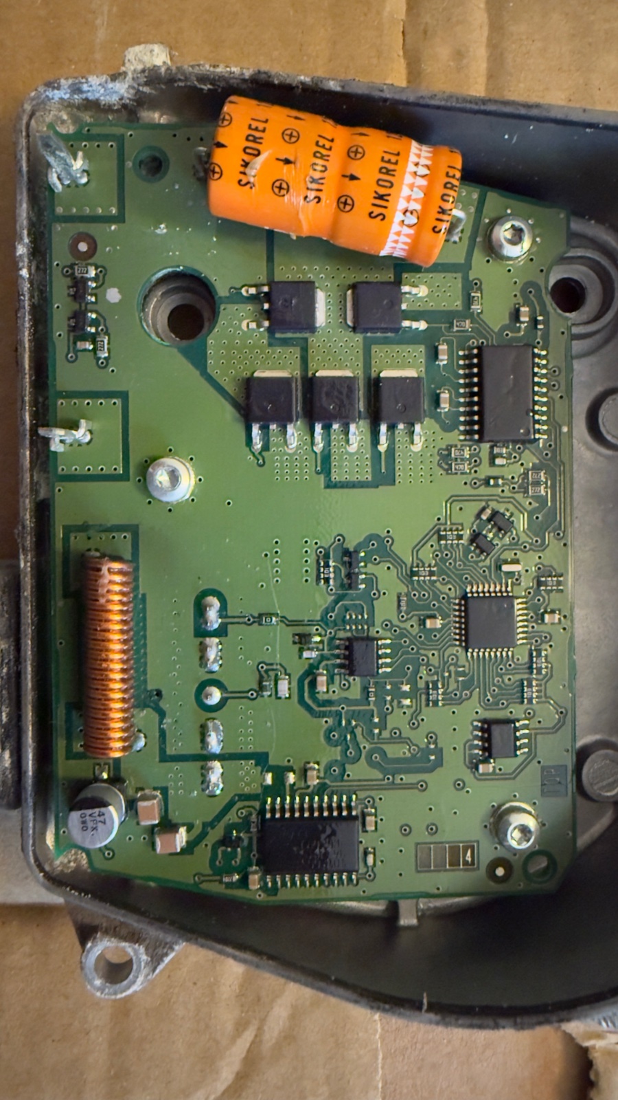

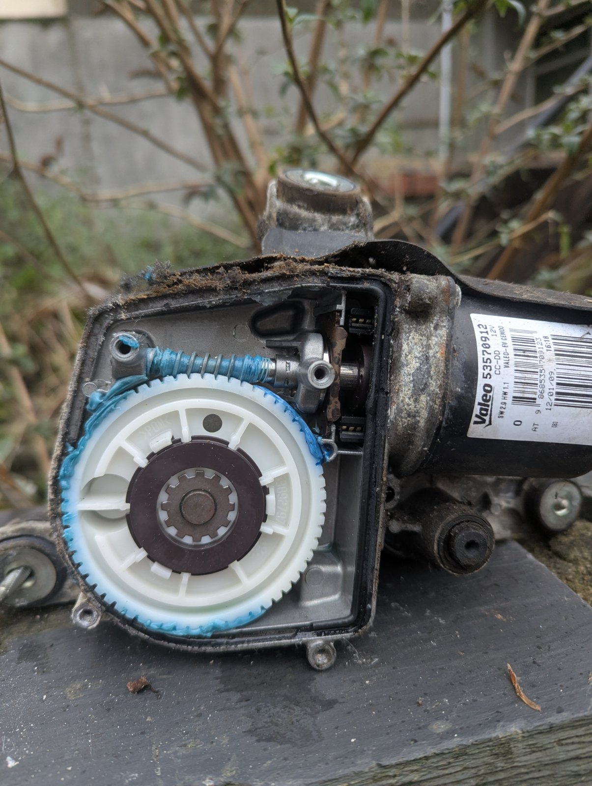

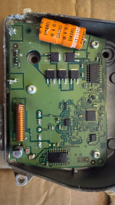

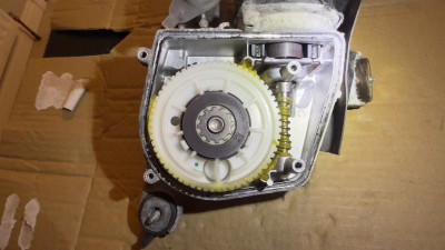

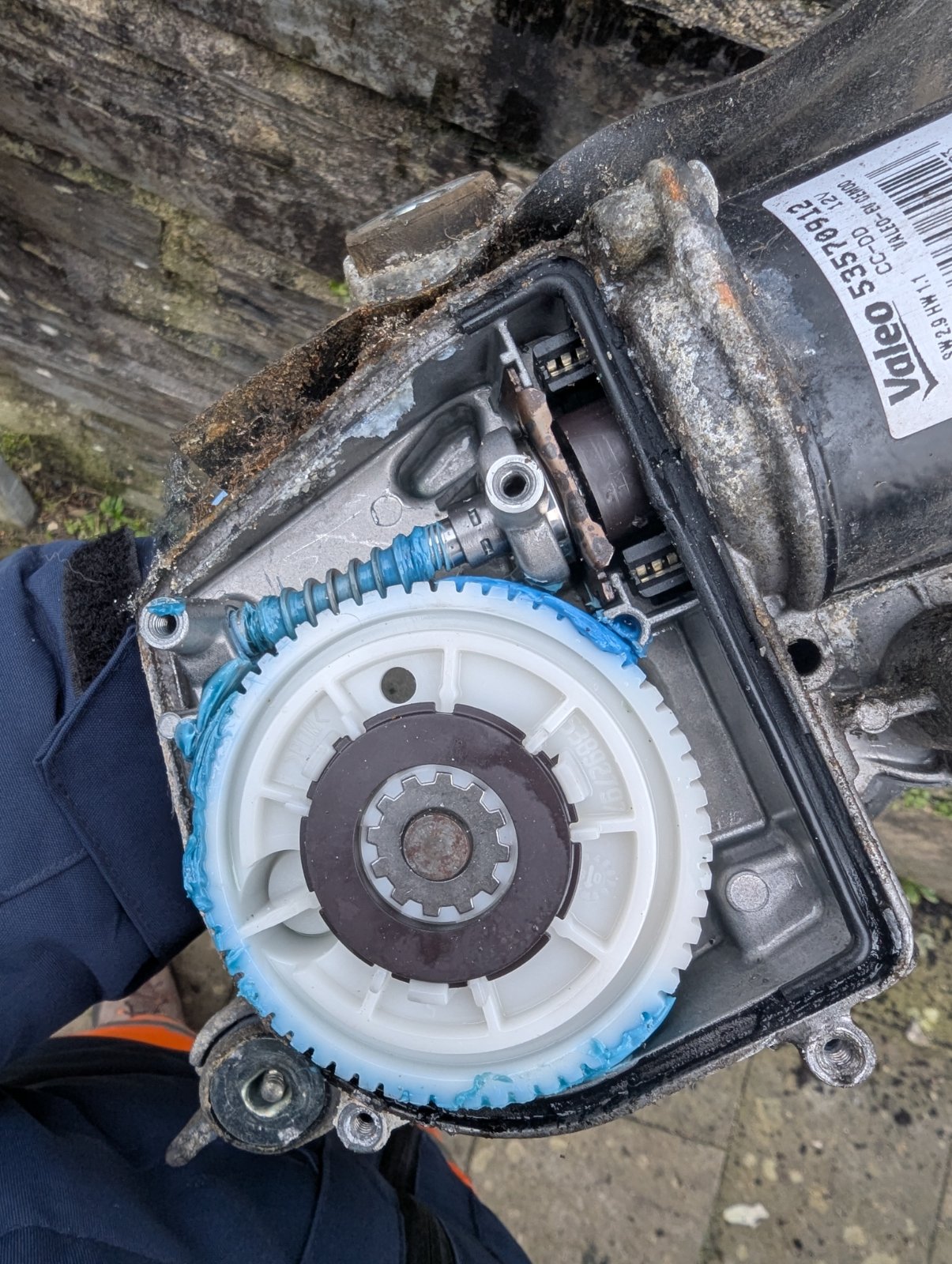

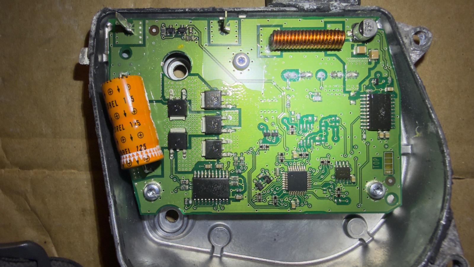

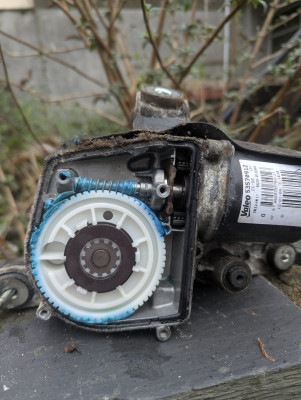

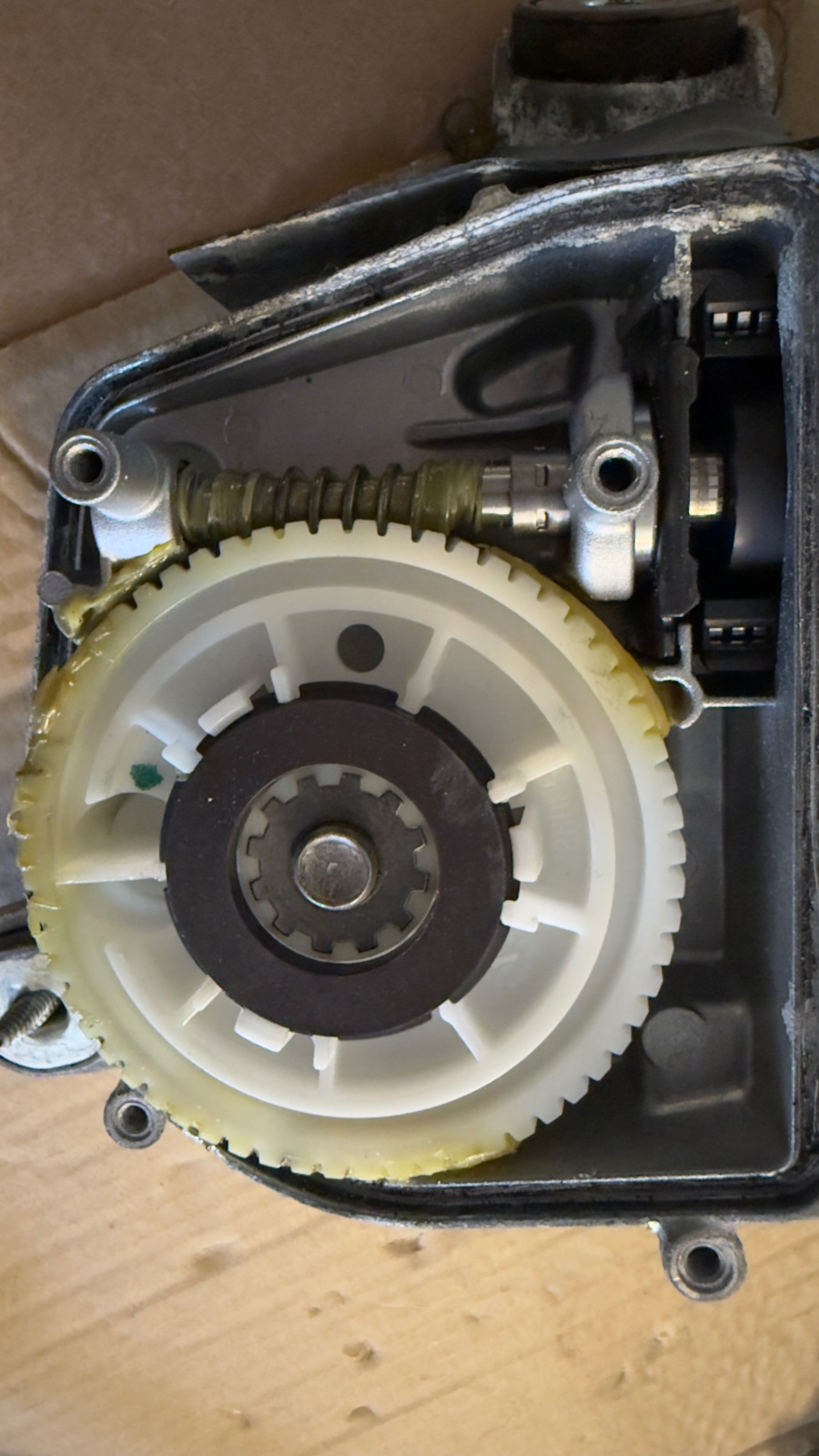

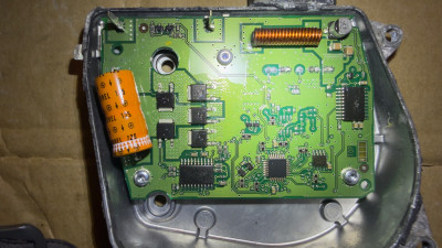

Just a few pics of clean undamaged circuit boards and the magnet on drivers side (4th photo) slid out of position compared to passengers side (3rd photo) where it should be between the contact terminals.
