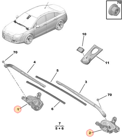

As for the parts, please see below:
(1) Front Right Wiper Motor, part: 6405KZ, £430.02
(2) Front Left Wiper Motor, part: 6405LC, £430.02
Prices are of course UK which include our VAT @ 20%, so just to give you an idea.

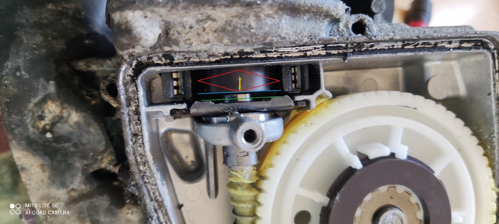

ASK_dj wrote: 24 Jan 2021, 14:18 Hi find issue to fix wiper motor .when open bottom cover ,with pcb and gear ,on motor spindle find magnet which moving axial when wiper not work . find this magnet must fix and not moving . I apply a drop super glue to fix this part to motor spindle on position where blue line go in green line in picture . ,when faulty magnet part moving axially show in by yellow arrow . After this intervention wiper work fine again , don't forget to seal cover .Image
Moderator note: Click photo ? to enlarge, to see marked detail
Sorry to be dim, but I cannot work out where the magnet is. Is this a picture of the inside of the actual wiper motor?
I took the offside unit out greased and cleaned the wiper shaft and link - as per the excellent video posted by rust&oil ( During the process I could not see anything that might give access to this magnet. Anyway the motor seems fine in that it does a full sweep. It is the nearside that only moves a tiny bit. Is this a motor (as in) mechanical problem - in other words get a new wiper motor, or is it an electronic management problem? There seems to be terrific confusion over which is which. The arm only moves about 25º Which isn't enough for a full sweep of the screen.
Would anybody care to make a guess as to whether the problem is the motor, a magnet somewhere I cannot find, or the electronic control?

I think I have just found the answer which tells me where the magnet is! Here:- viewtopic.php?t=59504&start=15

Still trying to solve my problem. The righthand wiper sometimes works - sometimes not. I bought a replacement lefthand wiper with the part number shown on the diagram in another post here. 53569612 (see photo) Took out the motor that was there and found it had the same part number as the driver's side 53570912. Anyway I put the replacement one in and it does not seem to work.
While I was trying to fix the things I took out the sometimes working driver's side motor and looked at the magnet in there, I moved it to the position shown elsewhere in discussions about C5X7 wiper motors and glued it. Put it all back together, re-installed it and it works okay. I have not given it a long test to see if it sometimes doesn't work - as that feature is quite random.
Oh and just for good measure I did a BSI reset - which didn't change anything!
Since the part number is the same on my nearside wiper motor as the driver's side I have thought I could just try swapping them over to see if that tells me anything! My existing nearside wiper arm moves about 5º - I don't know what that means. Should I try checking the magnet in there too?

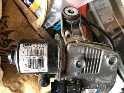

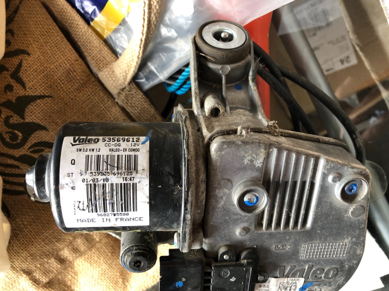

Just to add my 5 penny worth, the part numbers off the black motor cover for our C5 X7 exclusive are 53579012 and 53571012 but sorry not sure which is driver's or passenger side. The date is March 2013, it is a 2013 plate car. The cover does not have Valeo cast into it as shown on your photo.
I assumed that the electrical connections were not interchangeable or given the master and slave - if they did physically plug in, would not work.
However I do think that it is worth popping the "C" clip off the wiper shaft, examining it with a view to cleaning it up and re packing with grease to ensure that any mechanical resistance is kept to a minimum. Similarly keep the well under nut that holds the wiper arm free from debris.
After re greasing both motors and moving and thread locking the passenger side magnet all worked as expected.

Thank you - it all helps. I will investigate that magnet and grease the wiper shaft. It is odd that it moves just a few degrees as if it is getting a signal, so maybe the magnet is slipping. I found it really hard to remove the so-called non-serviceable cover on the driver's side, but once inside I found the circuit board was as clean as could be. The place where the wiper motors sit is a real dirt collector. I've been cleaning them out for years! I'll let you know how it goes. Thanks.
Update.......I have now super glued magnets in both motors and after a BSI reset both wipers now work! I think the small amount of movement I was getting on the nearside motor was entirely due to the magnet slipping and therefore misaligned. I found warming the sealed unit where the magnet is located with a hairdryer made it easier to separate the part.
