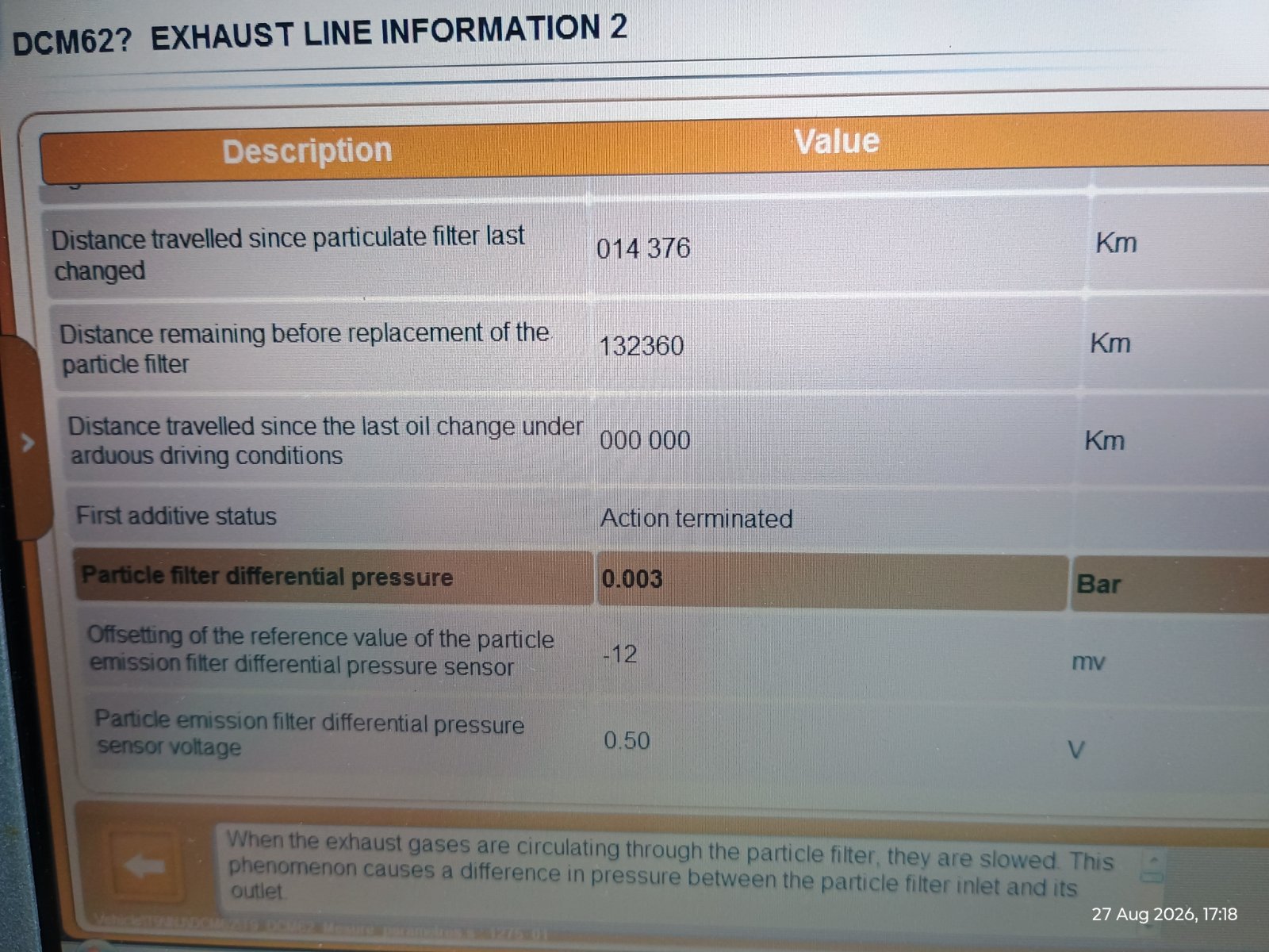

Am sure I've seen much higher logged (will be in this blog somewhere) - from memory I thought it was a couple of hundred logged in the fault vide details! Will double check when get chanceHuskyxantia wrote: 26 Aug 2026, 09:25
Before Cleaning & Extended Road Test (High Soot / Pre-Regen): The differential pressure across the upper and lower pipes was hovering at elevated levels under load (often reading around 30\text{ mbar} to 50+\text{ mbar} at higher RPMs), which triggered the initial DPF warning light 8 miles into your drive.

Lower numbers look more like false positives.

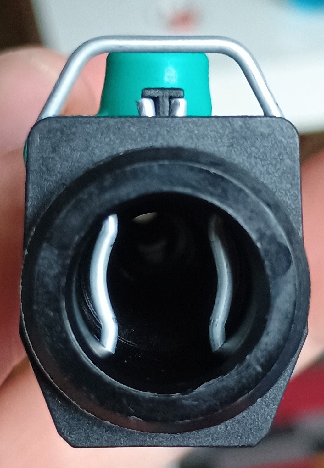

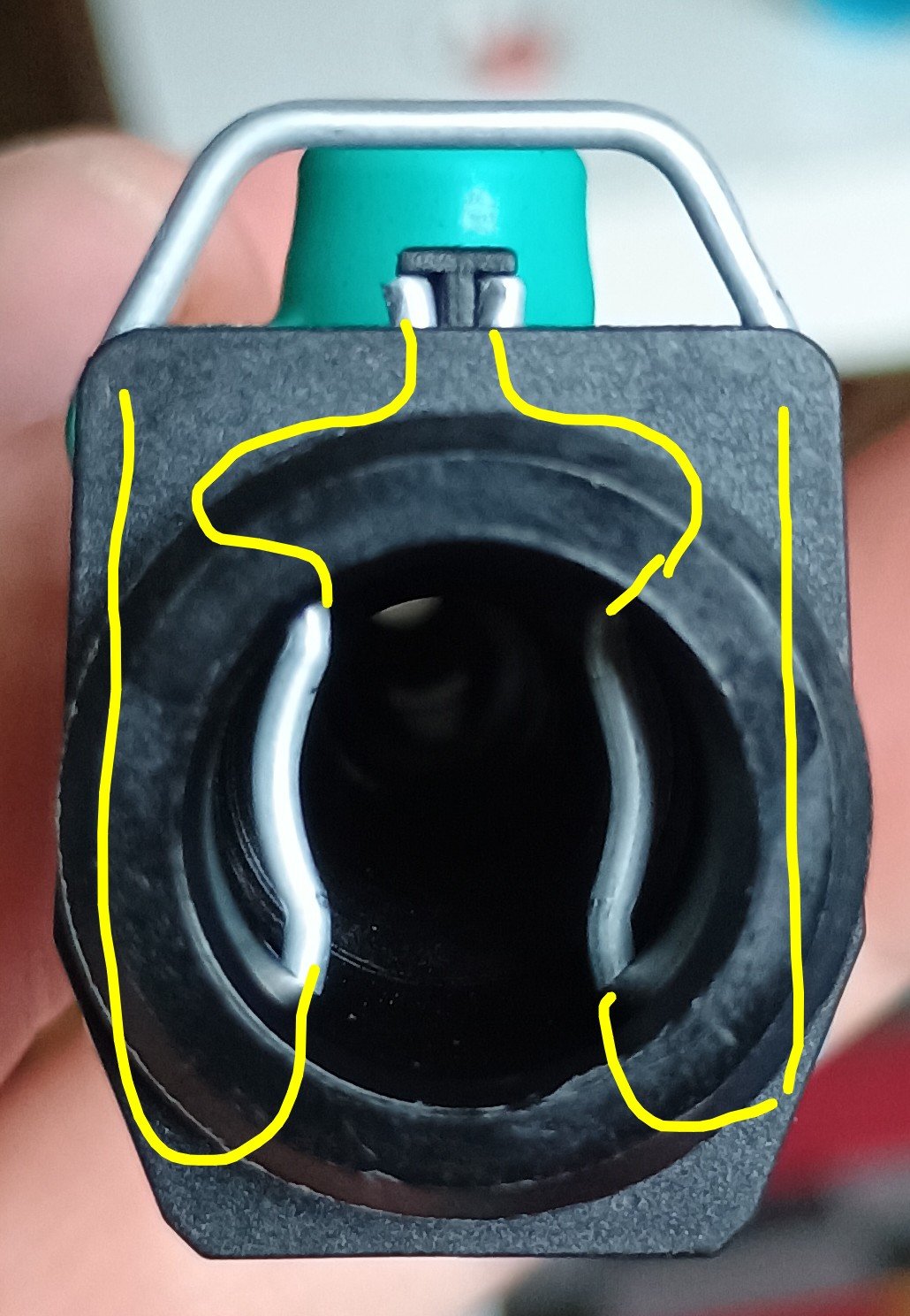

Bleeding fitting has arrived today,
You can see (but not easily remove otherwise I'd take it out to measure) the full extent of the intact clip: Approximate routing of the wire clip here: Hopefully I can get it installed and bled correctly, this afternoon. Looking weather dependent as to how enjoyable (or otherwise) the task might prove to be!
Ominous dark clouds loom overhead

...but (having donned a bright yellow waterproof) the new part fits, some vacuum bleeding was needed but the clutch job = complete!

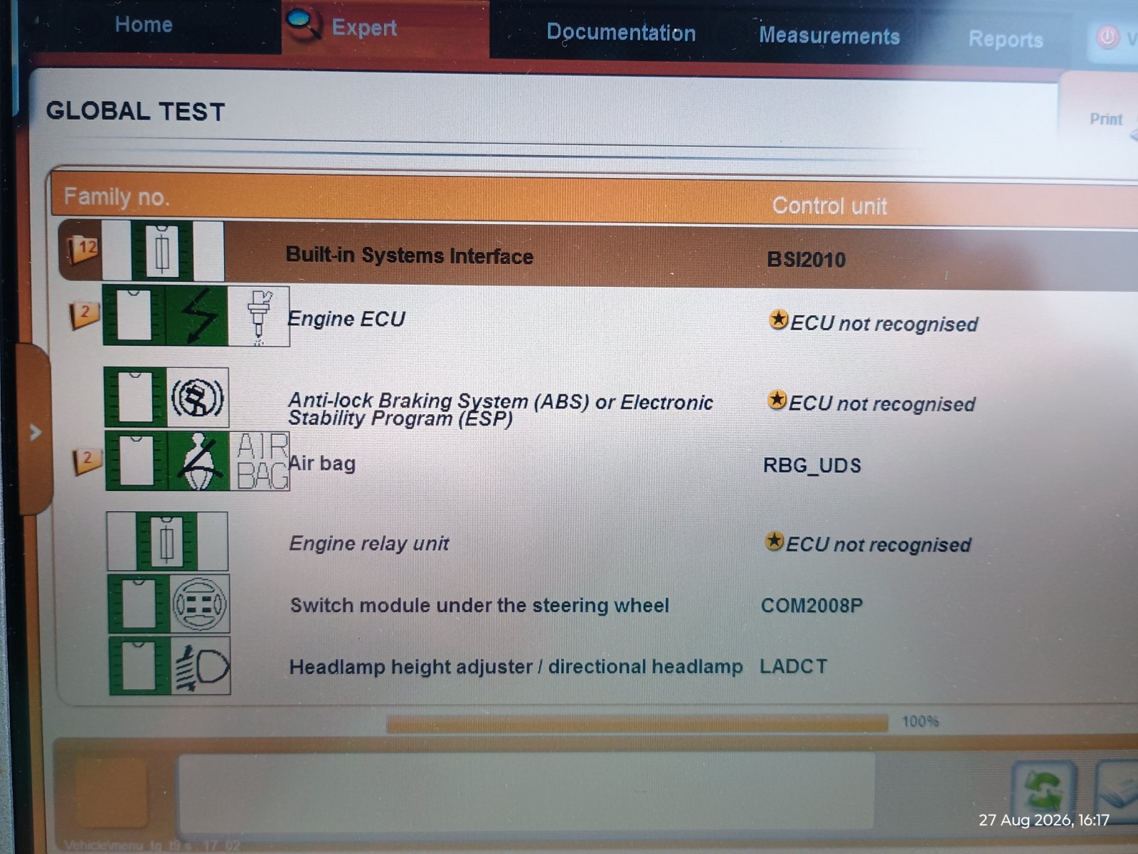

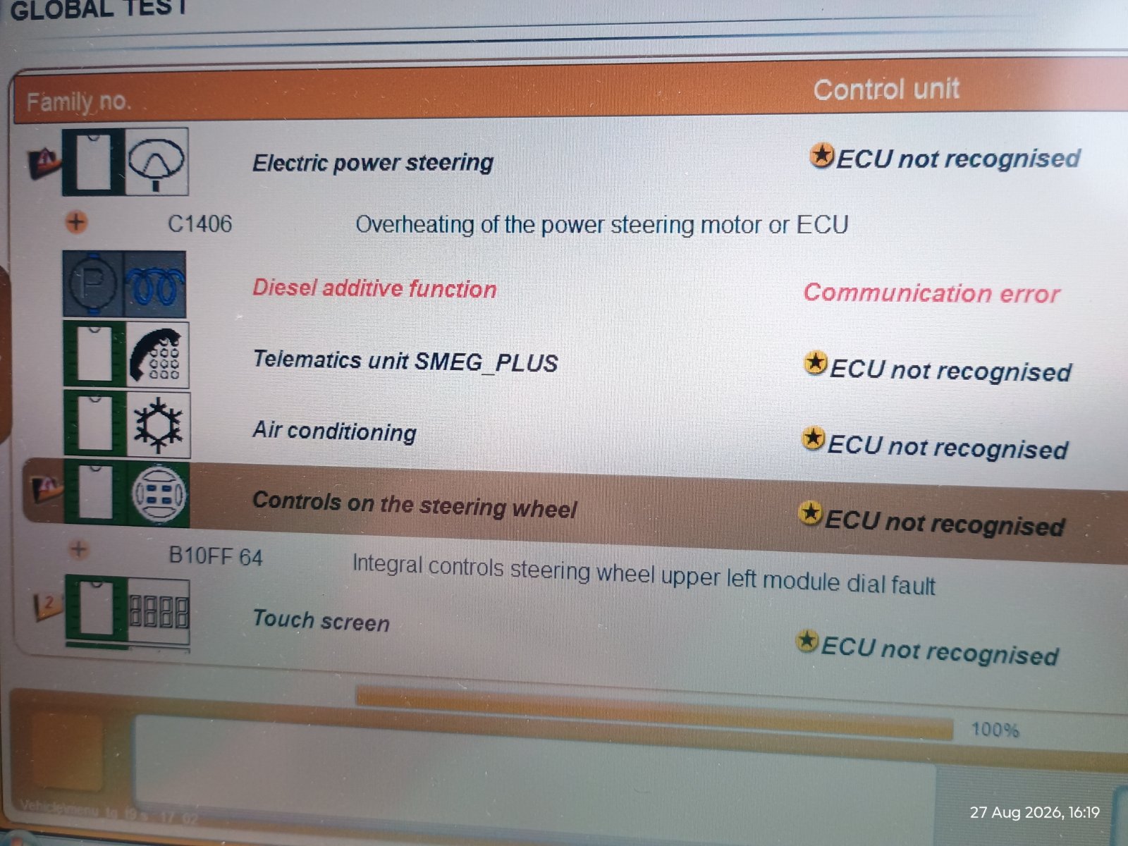

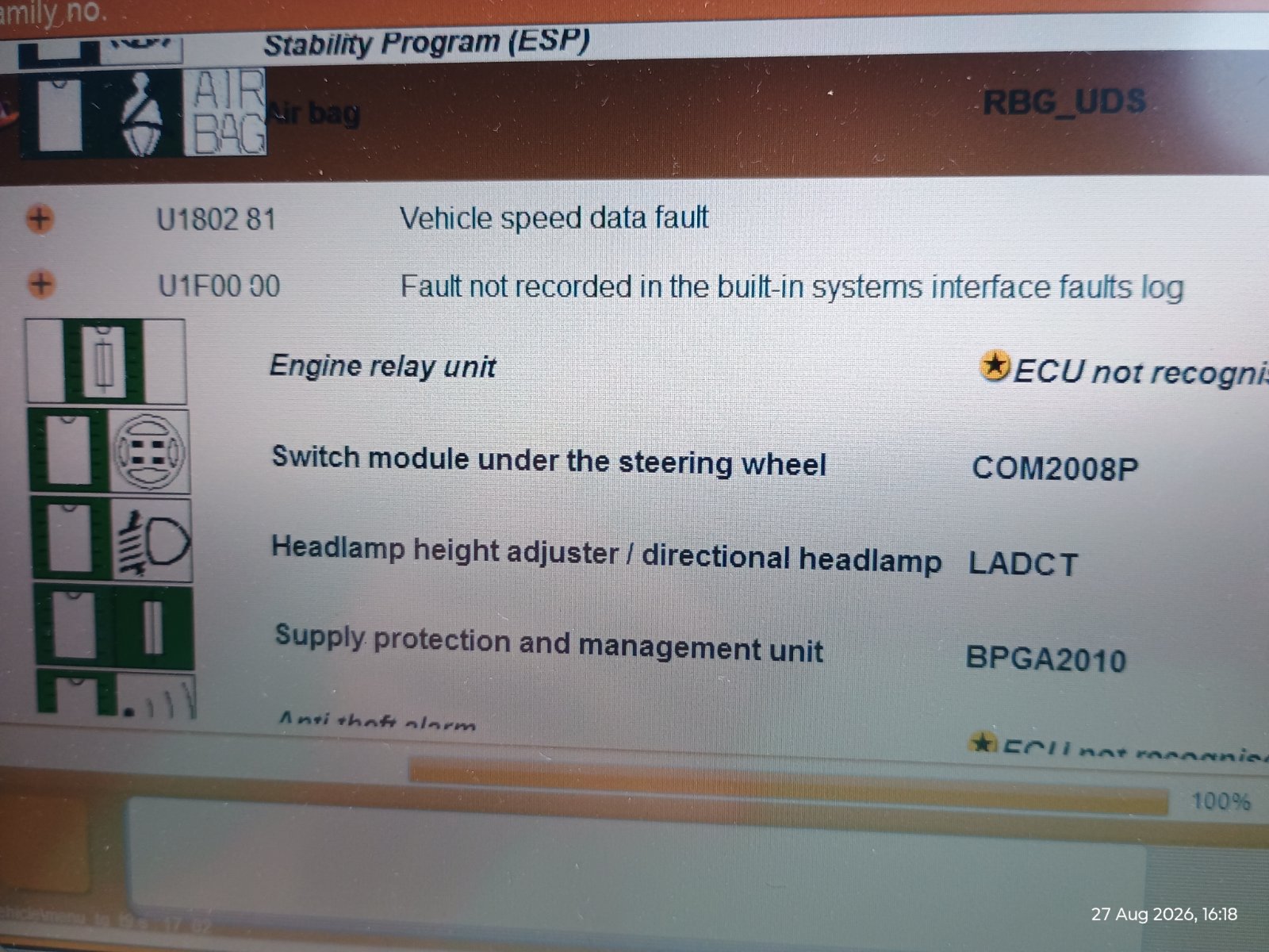

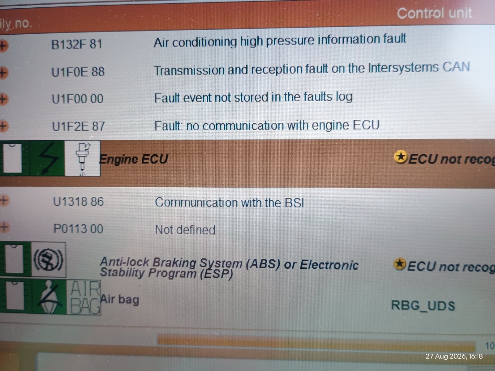

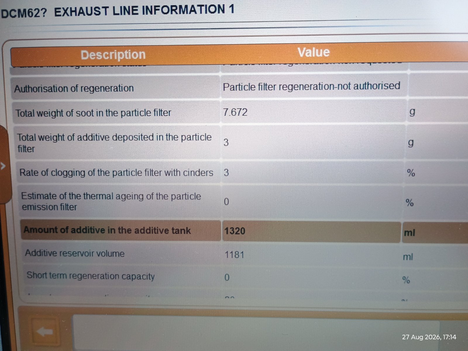

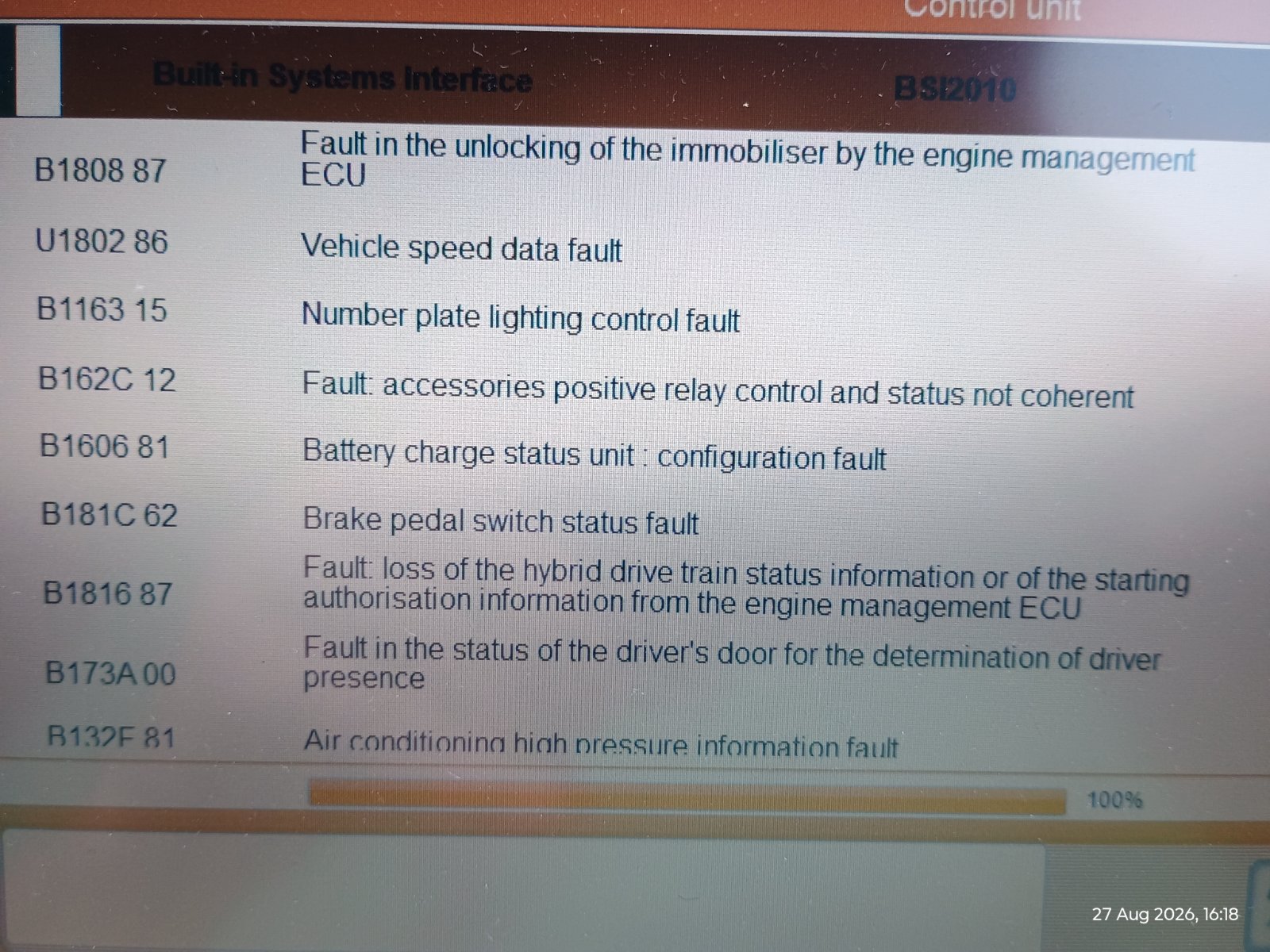

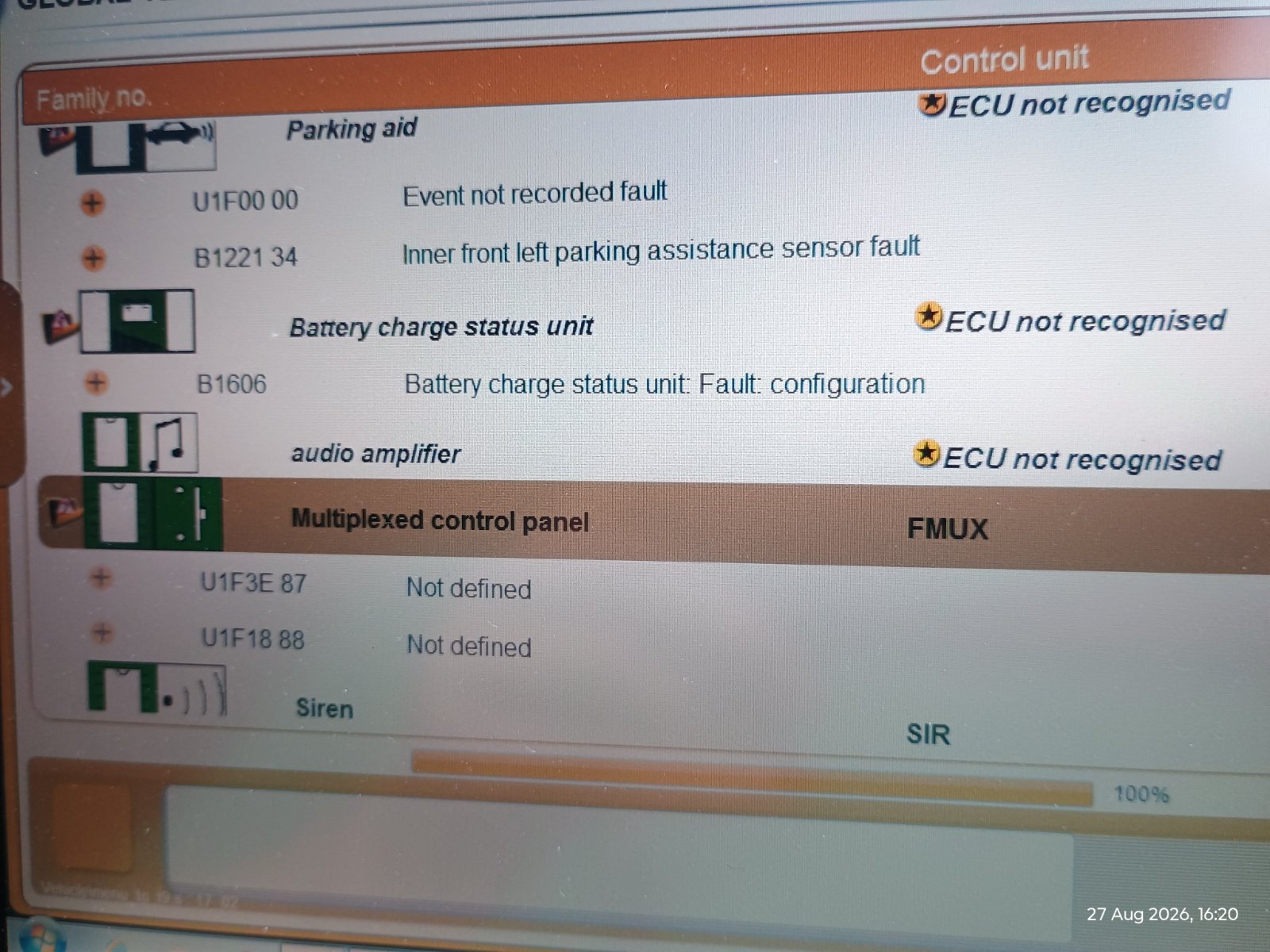

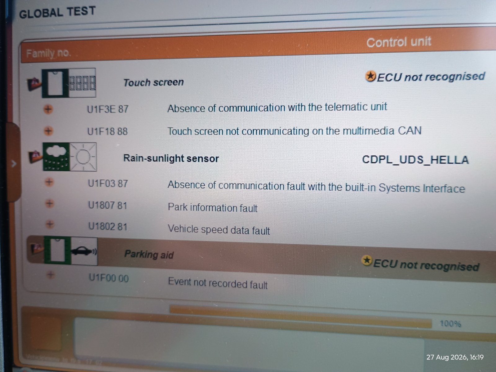

Red 2016 308 hatchback:
Quick upload of images from Diagbox, lots of codes logged, most didn't return other than 2 on BSI. And one elsewhere (memory failing as to what!)

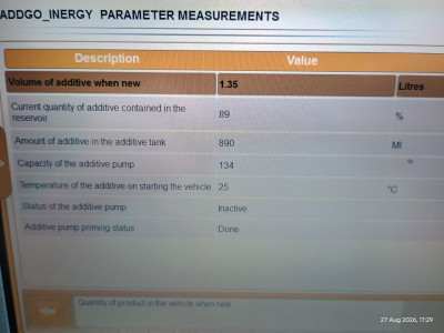

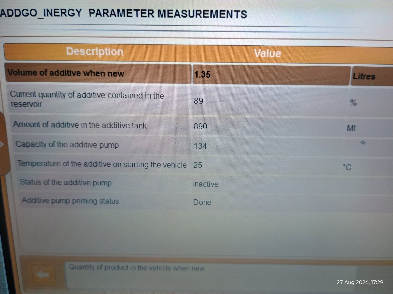

It does think it's well in hand with DPF additive, so I'm going to top that up (or at least try to) in the hope the red stuff in the adblue was part of the same, err, misadventure as to when the car was told that was replaced.

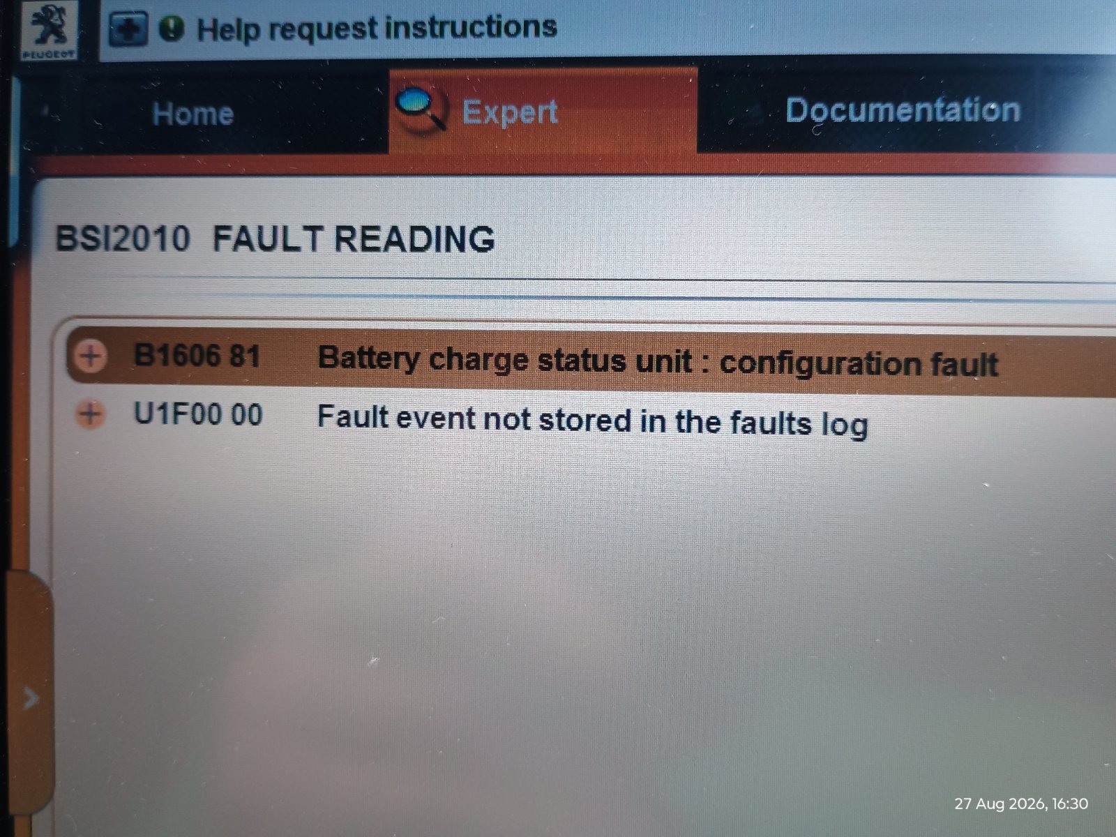

The ones that came back (BSI)

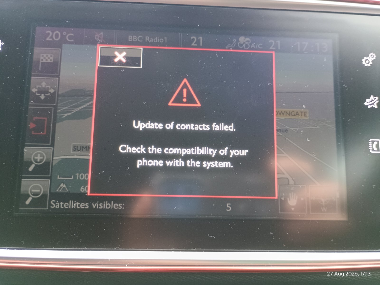

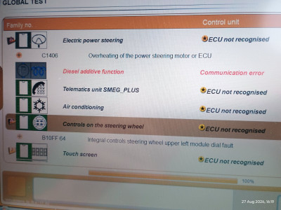

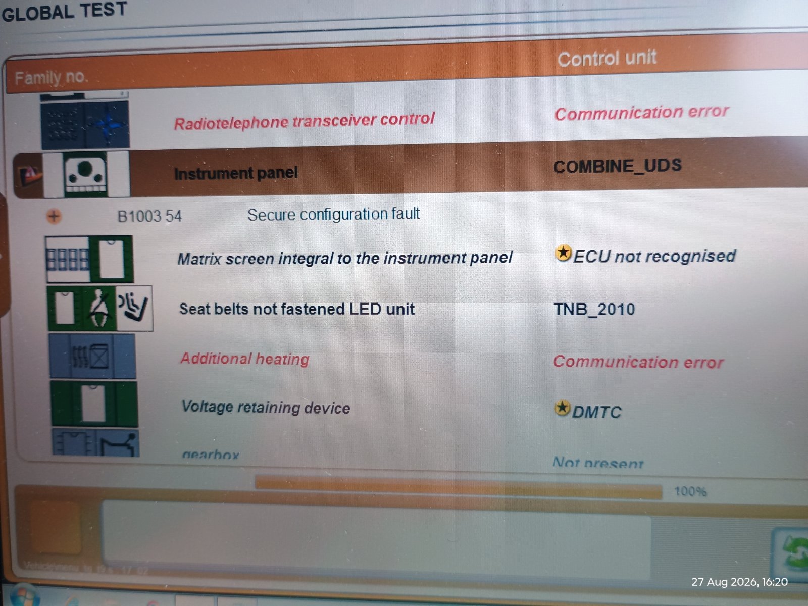

This is annoying, remembered to grab an image of it:
One of those "appears and click the cross to make it disappear, for less than half a second when it springs up again" infinite loop type irritations
Info stating lots of DPF additive too:
