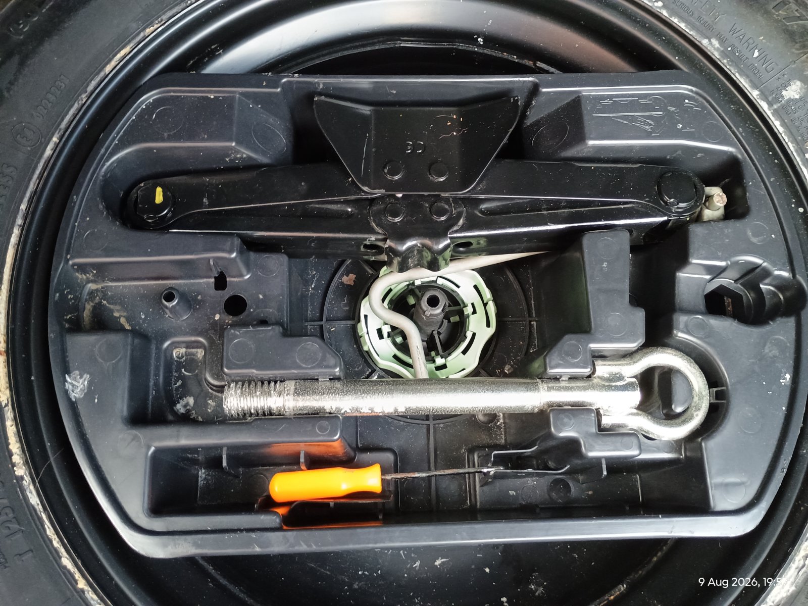

Reminds me, notable absence??
- Spoiler: show
AgreedDefinitely empty the tank and refill...
Checked the service history: specific mention of Adblue top up years ago (2018) and lots of unspecific "topped up all fluids" on service sheets since then, so "who dun it!?" remains unknown.
Yes, I remember mention on here of that happening to a lorry and tens of thousands of damage done!Tipping a can of Adblue into the fuel filler would not end well I fear!
- Posts: 20704
- x 7971
Wheelbrace not clipped under the parcel shelf either?

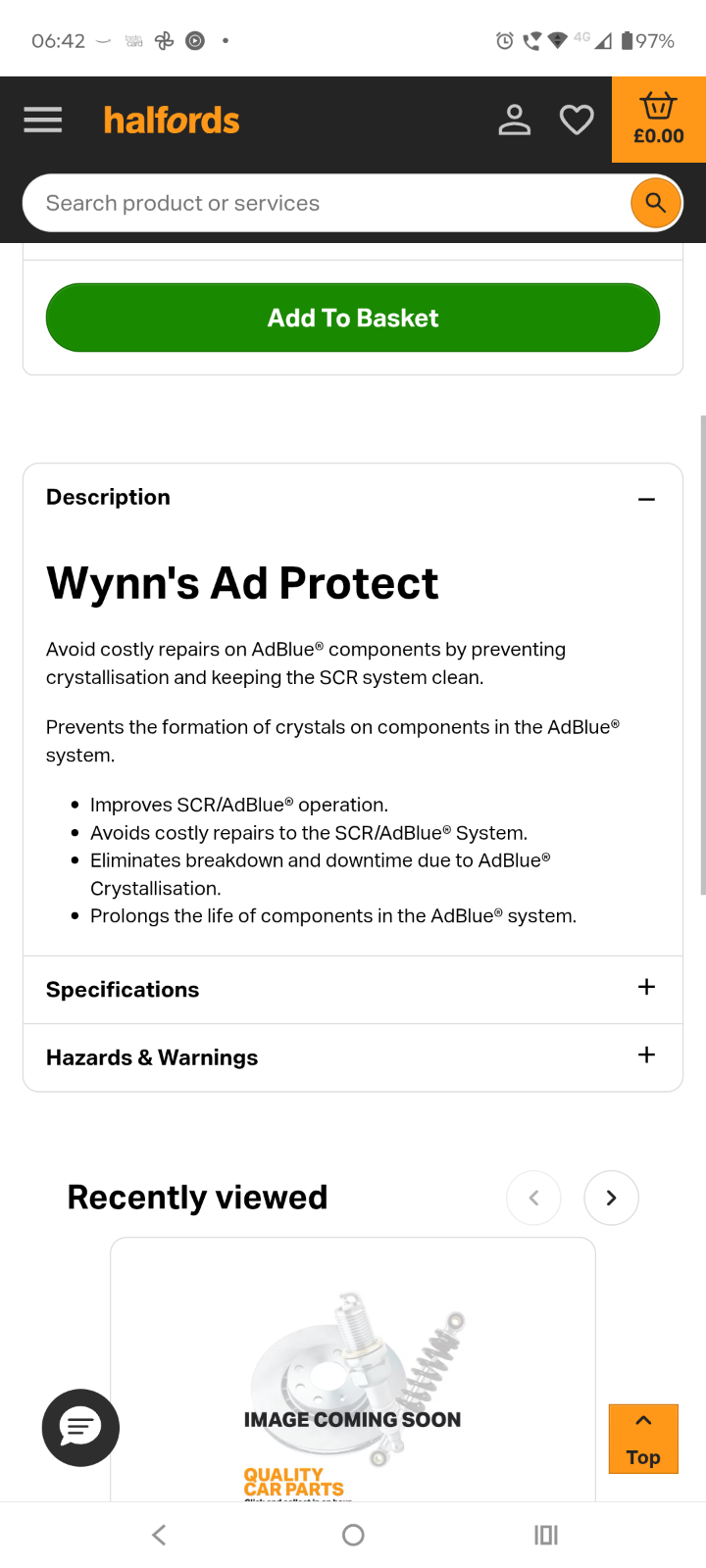

500ml Wynn's Crystal Clear and Protect = bought, eBay, £9.60 Inc delivery
https://ebay.io/m/DHUqaK
Seems it's changing its name as Halfords list "Ad protect" instead:
