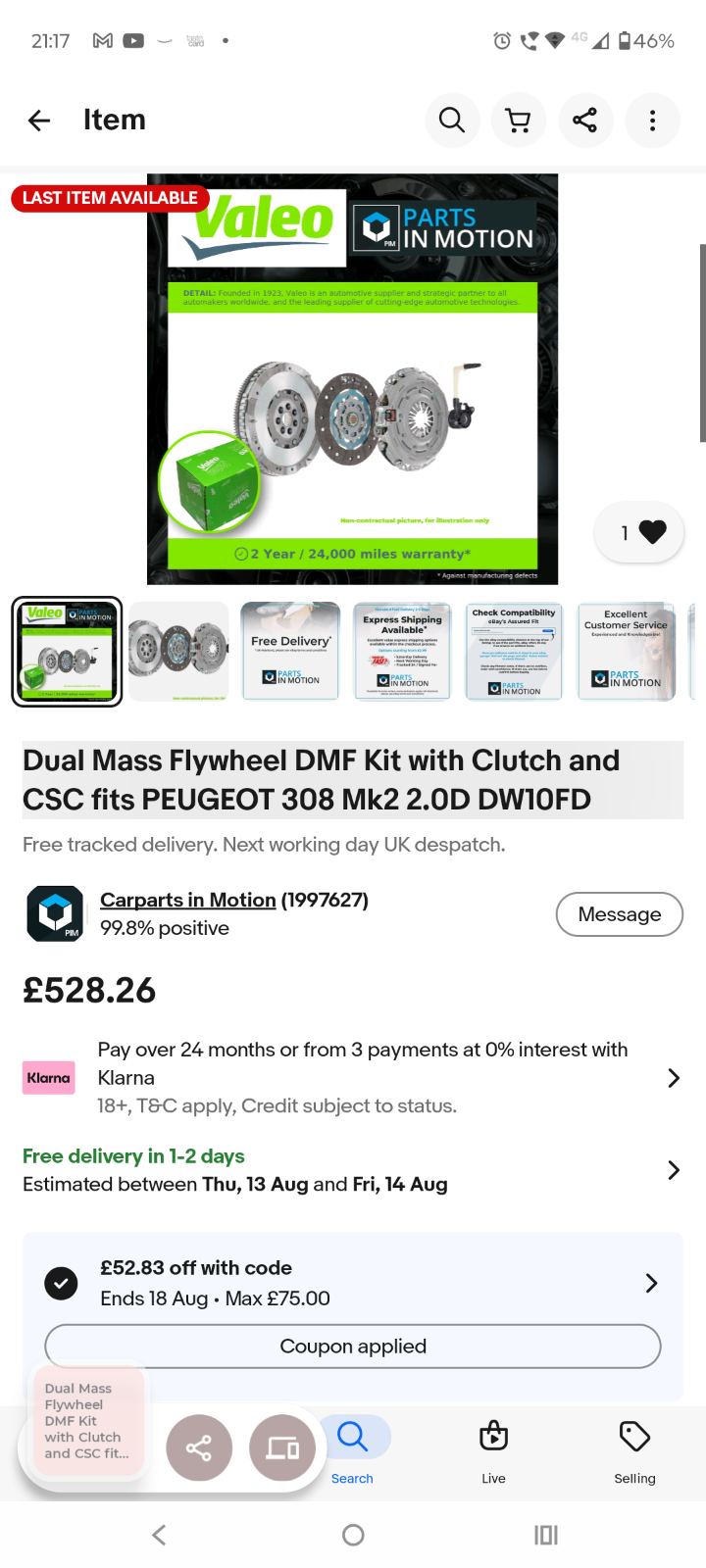

Indeed tonight I've "put my money where my mouth is" to the tune of £475

Normally the gut is right , think your be ok with that kit and ai does love to make a tangled ball of wool out of its own work .

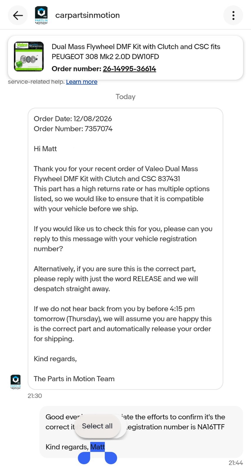

May I suggest online automotive parts, I ordered a set of front springs for my C8. They contacted me a day later saying they wouldn't fit and I needed different ones. Good checking on their behalf or I would have had springs for a C8 Corvette.
