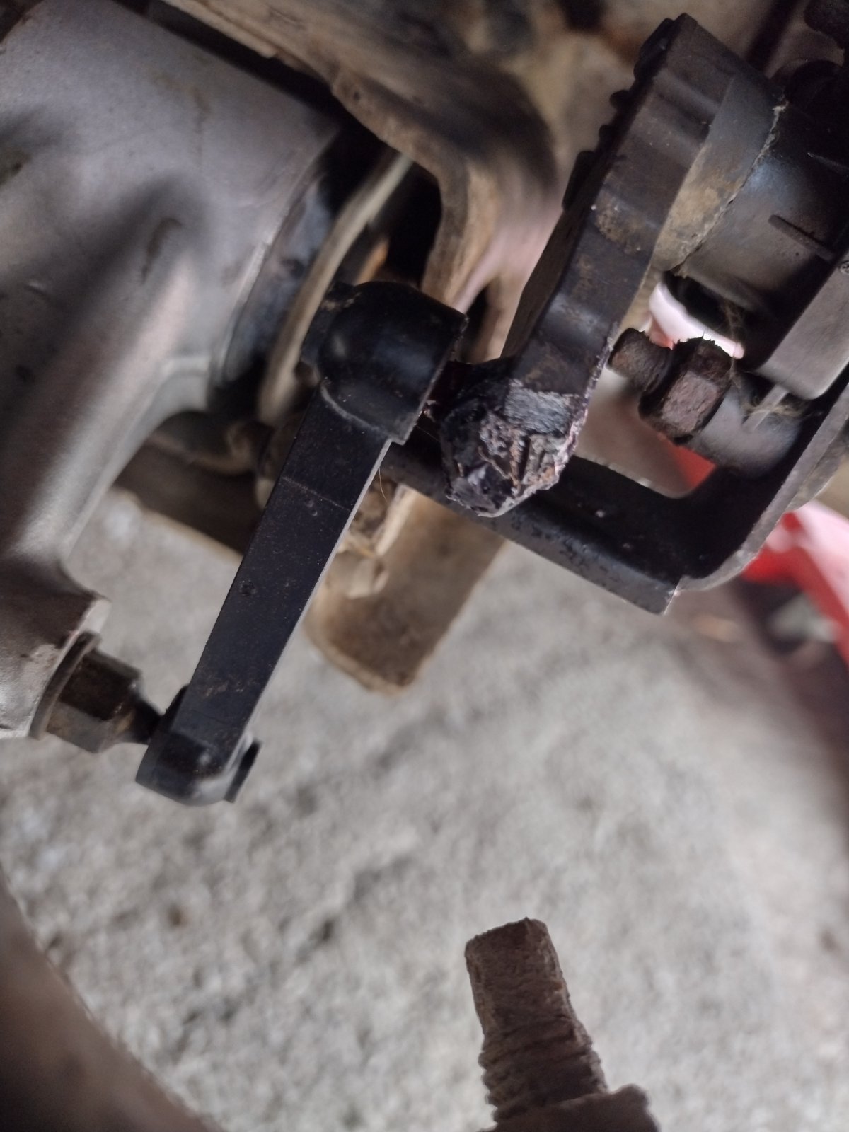

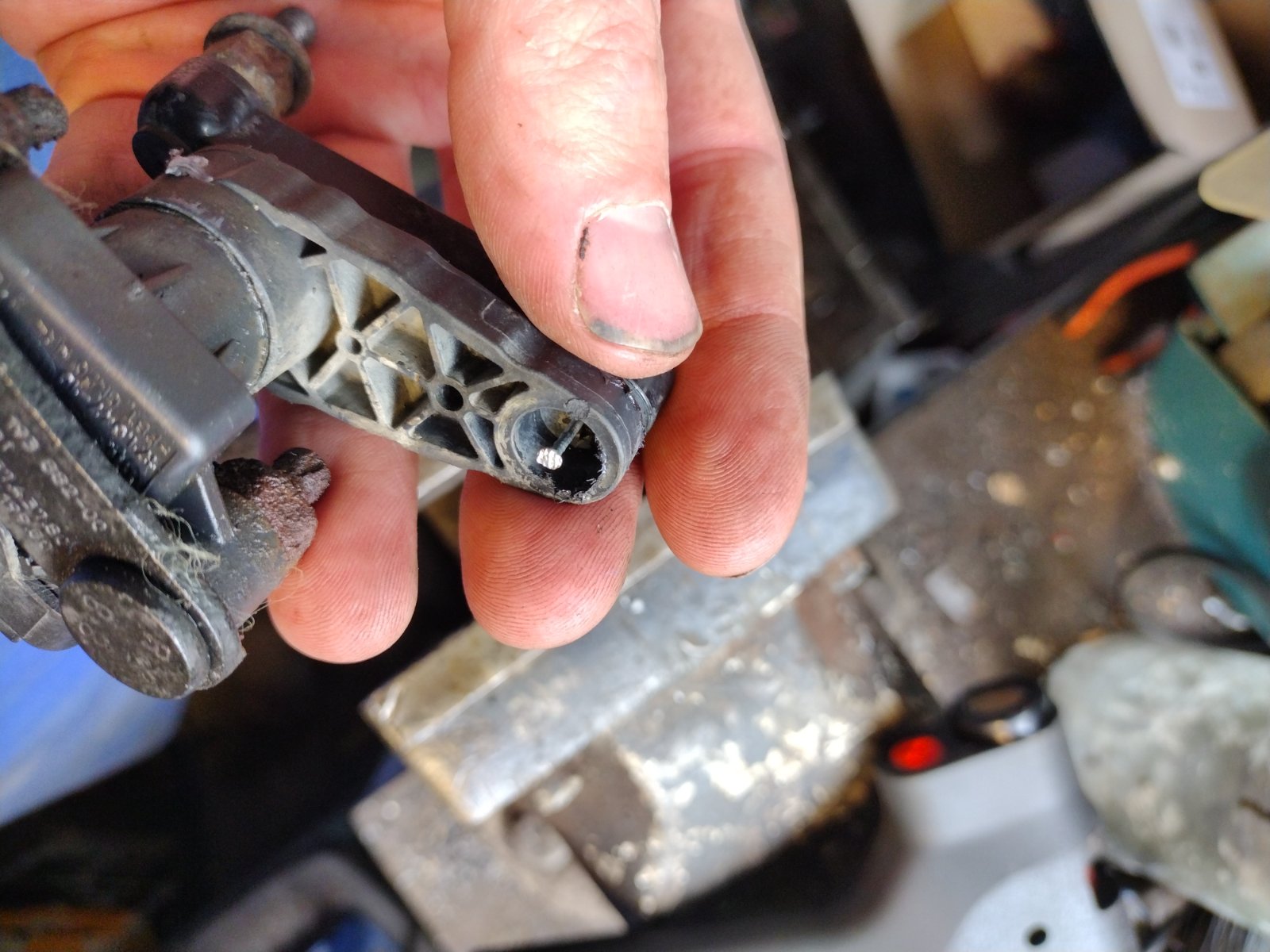

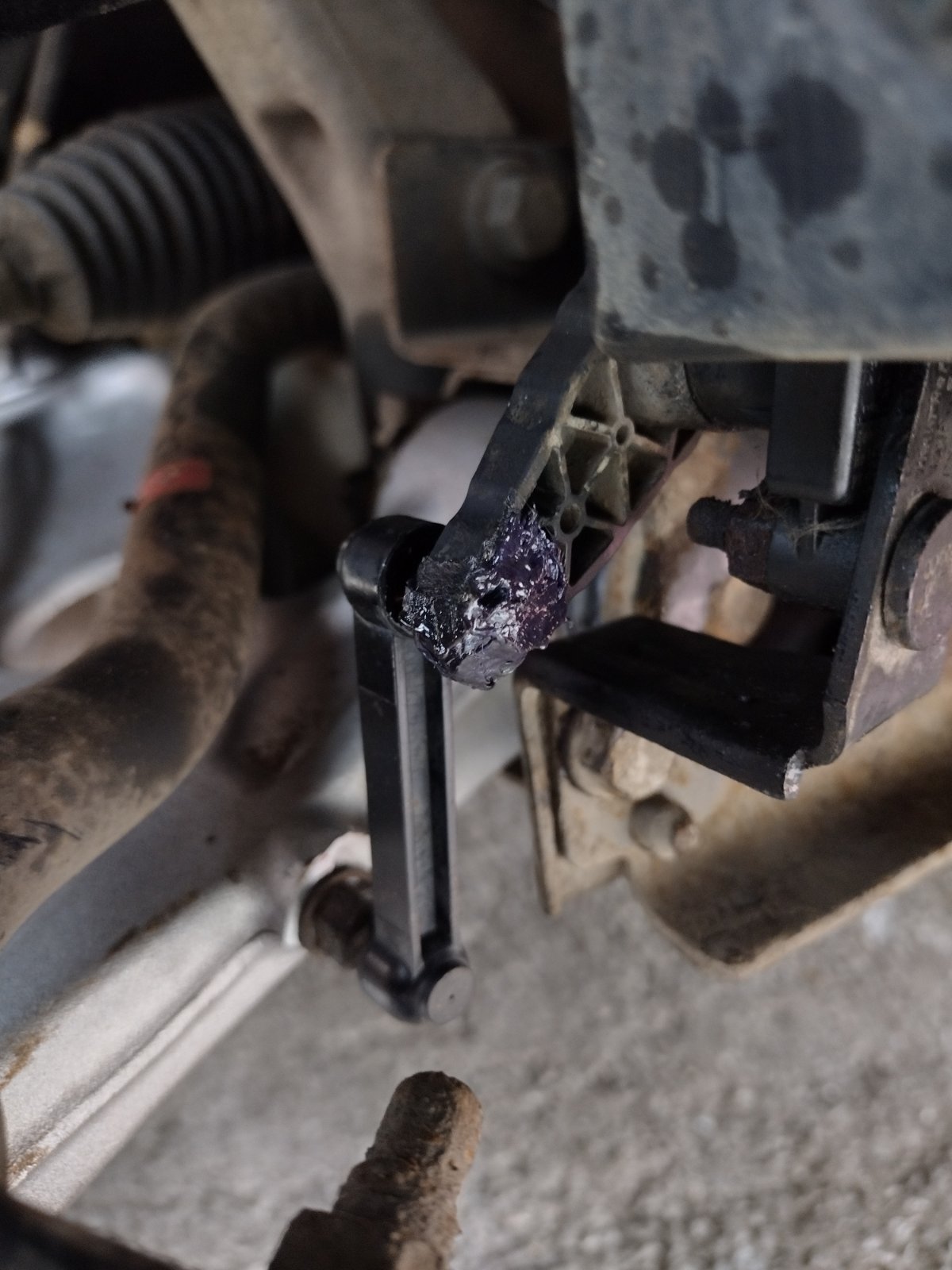

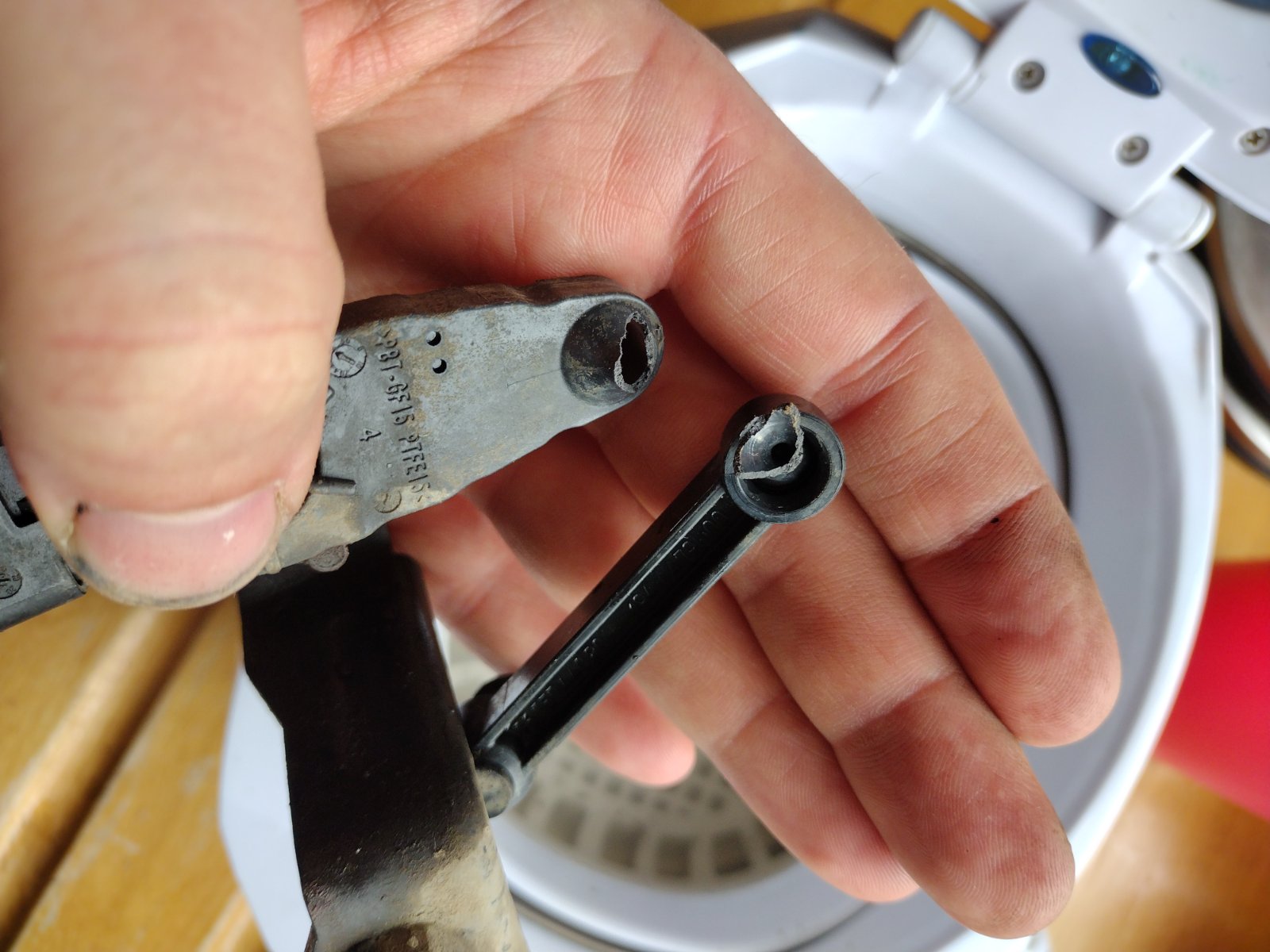

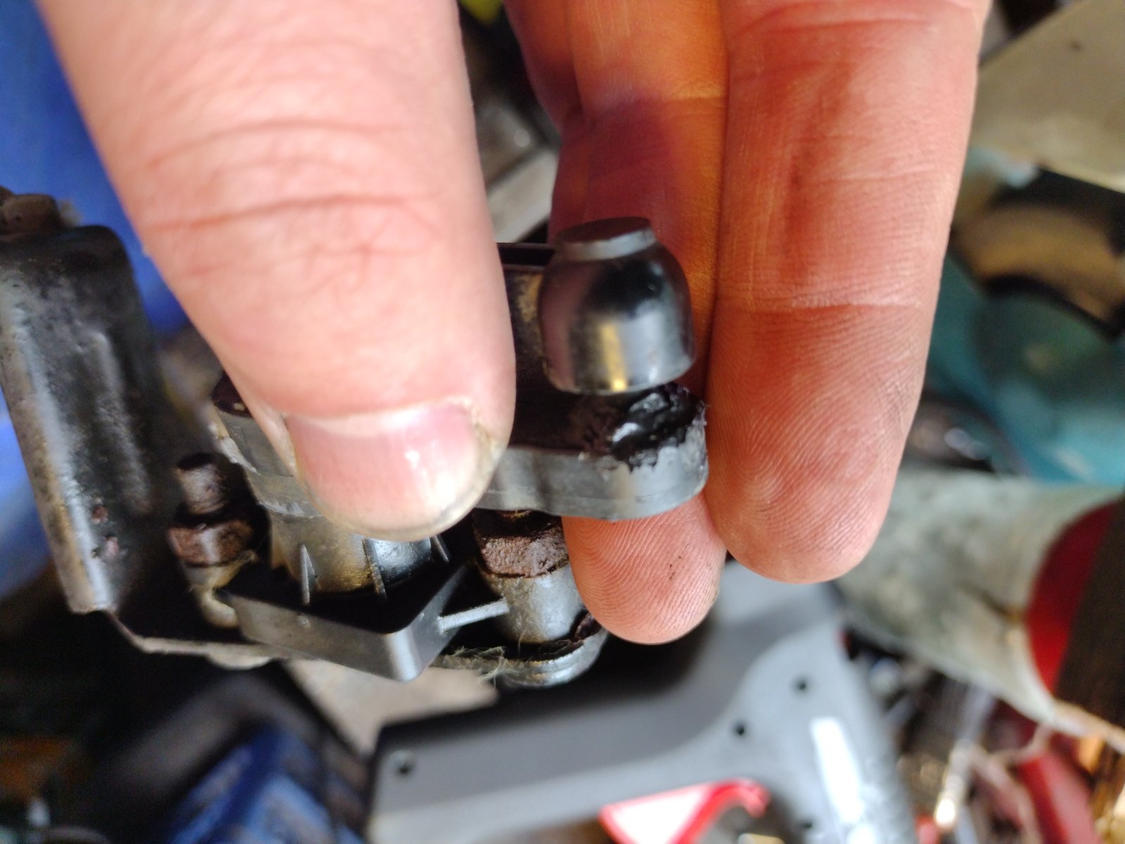

And forgot to remove the suspension level sensor when removing the wishbone so I've snapped that in two. D'oh!!

Initially melted back together with soldering iron, then a heated panel pin inserted through into the ball, going to fill this recess on the back with the hot glue gun

Ride height sensor repaired

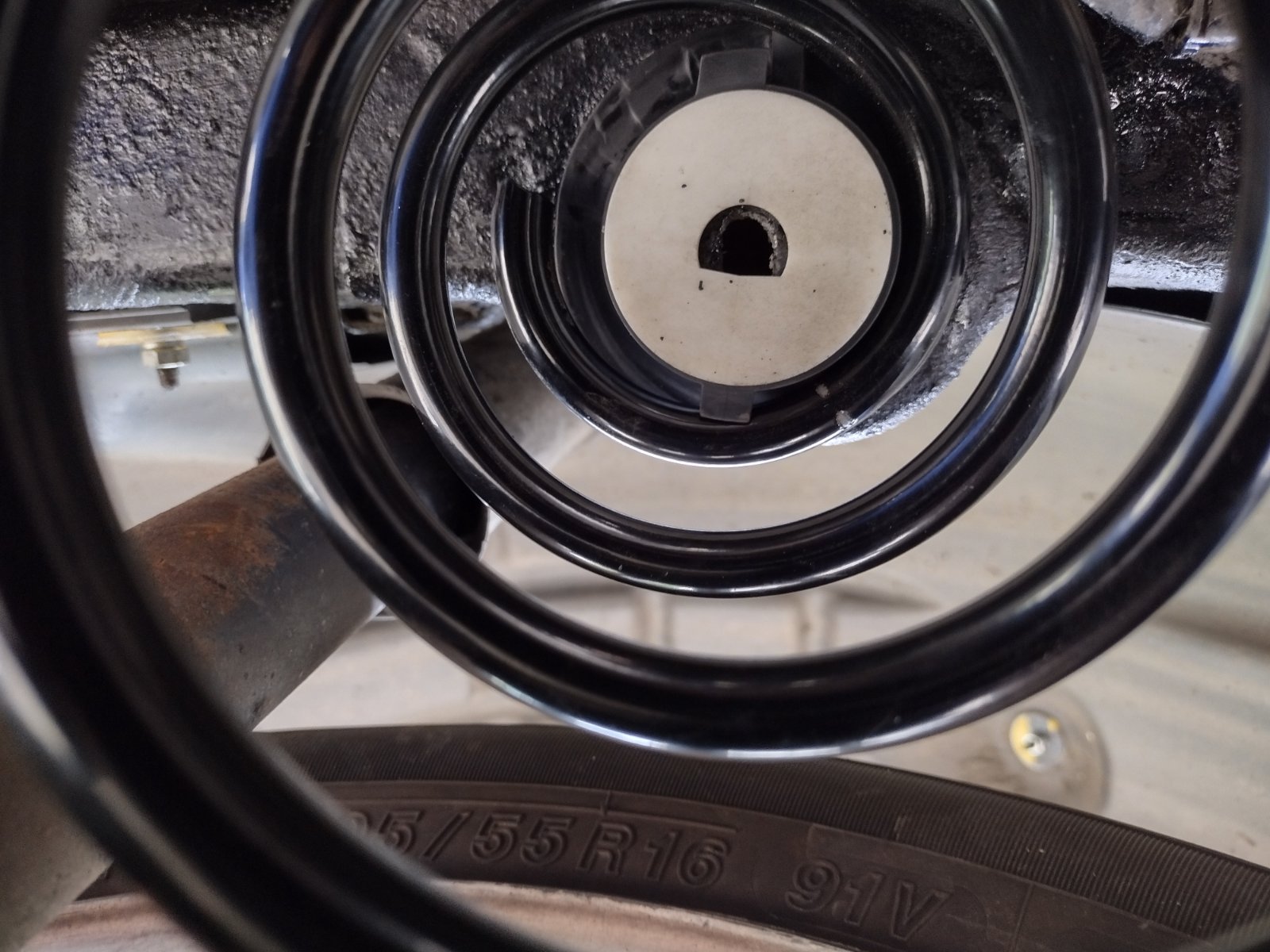

I think I've solved it: springs were upside down!
I decided to take them off again as clearly not right as installed. Makers name was upside down on both sides. There is a tiny, tiny difference top to bottom. Not really visible but a fraction tighter wound final loop on the bottom end.
I've swapped them over, though am not overly enamoured with how the top sits:
Rather abstract image, viewed in situ with phone slipped between the coils, looking up

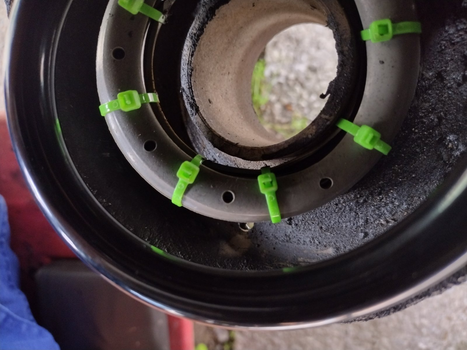

Also put the "noise deadening" sleeve on the other end, this time with numerous cable ties (hopefully of the non biodegradable variety!!)
Looking down inside the spring
