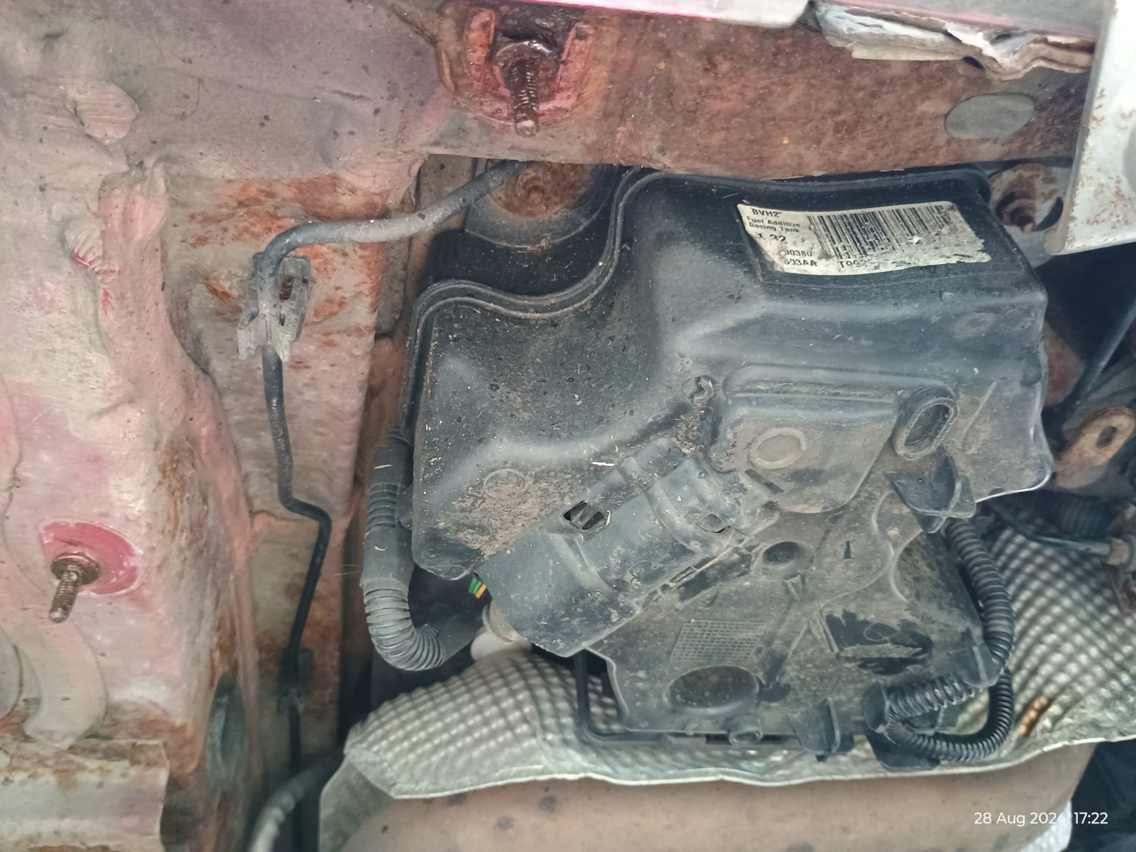

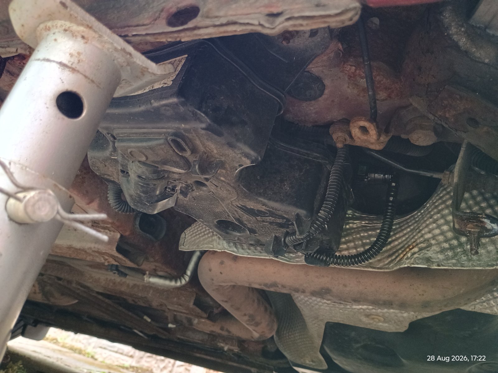

... Though the forecast was for heavy rain which never materialised. So I've set to and dug my way to the DPF additive tank location. Brief detour as thought it was on the right hand side = nope! #-o
Huskyxantia
Posts: 3744
Joined: 30 Jul 2018, 22:11
x 856
Unread post by Huskyxantia »
Left ...
:-D
Posts: 5264
Joined: 25 Apr 2022, 09:03
x 2310
Unread post by MattBLancs »
Huskyxantia wrote: Today, 17:34Left ...
Yep I can confirm

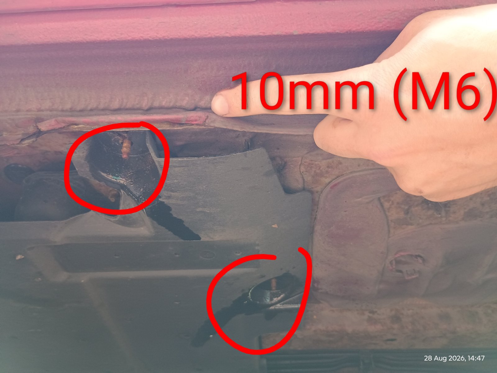

Don't look here:
3x 10mm to remove a cover that didn't need to come off
But can look here:

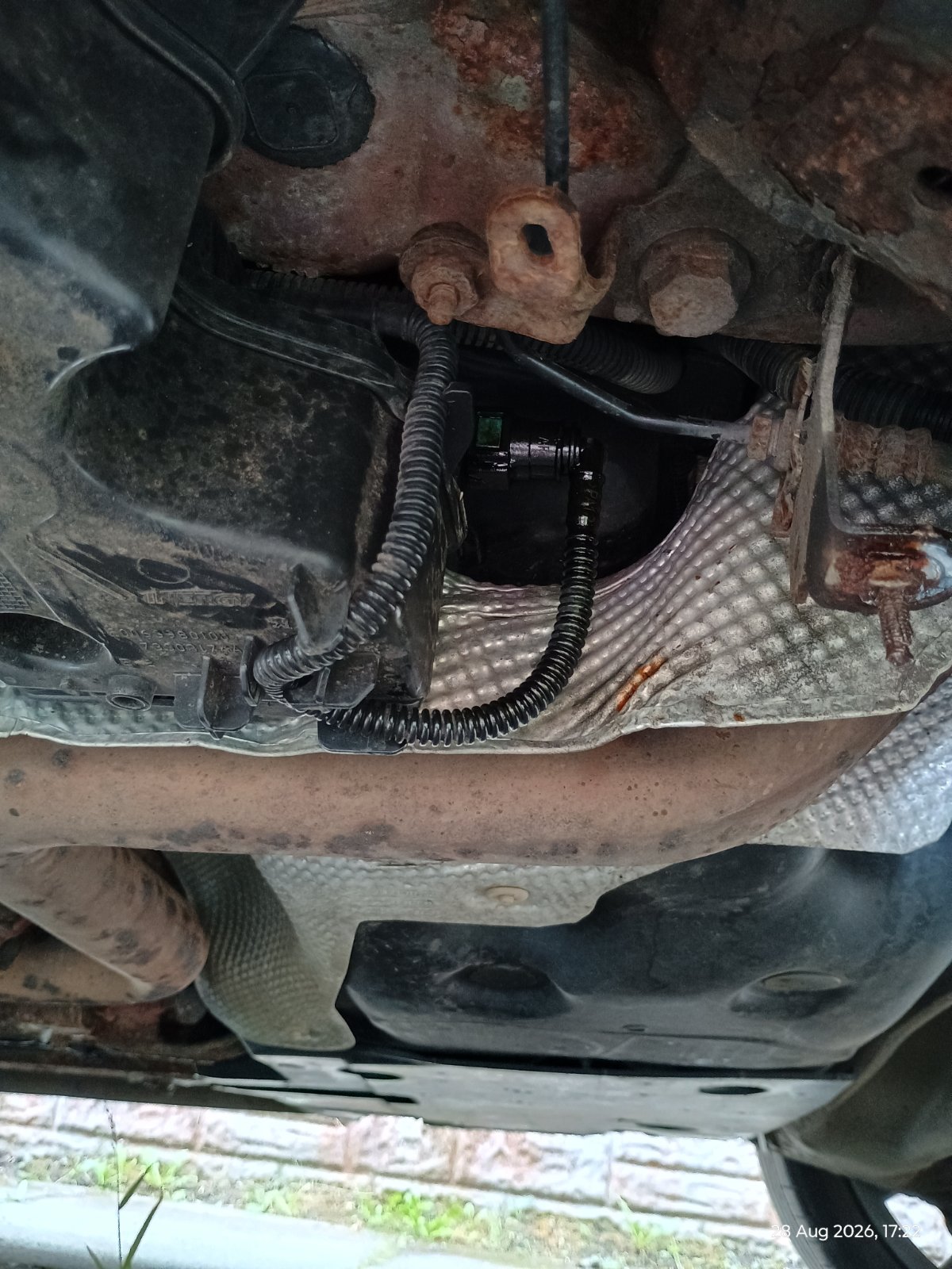

So, having reached the tank, disconnecting the hose connector:
  • on tank connection= "overflow" connection
  • Hose connection= route in for the new fluid
Put an empty bottle on the overflow and the new full bottle on the other. Raise and invert the full bottle and let it glug in under gravity. Thus felt link a VERY long time to lie on your back holding the litre bottle at arms length!
Place your bets, Diagbox reported tank as being full, how much of the litre went in?
Spoiler: show
are you having a guess then?
Spoiler: show
giving up?
Spoiler: show
fair enough!
ALL of it! :)
