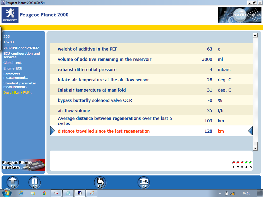

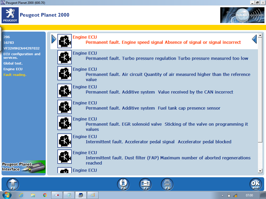

206 = back once again with the ill behaviour
I know it's not a 206+ thought it was an mux. Enter the VIN, next screen offers diag tool or pp2000. The last time I went for diag tool which then opens up PP 2000. However! This route gives vastly less options down heading straight to PP 2000, don't know why.
Straight to PP 2000 today, a raft of fault codes awaited me.
- Spoiler: show
- Posts: 5112
- Joined: 25 Apr 2022, 09:03
- x 2231

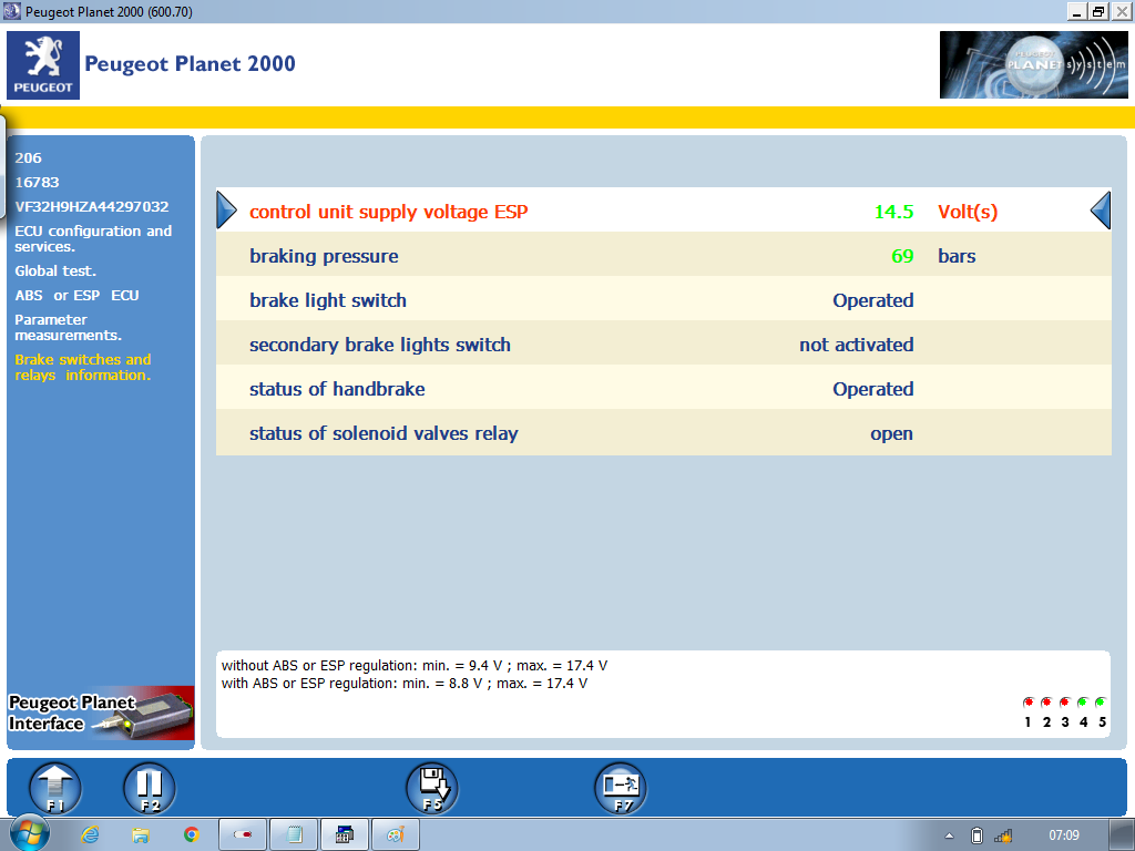

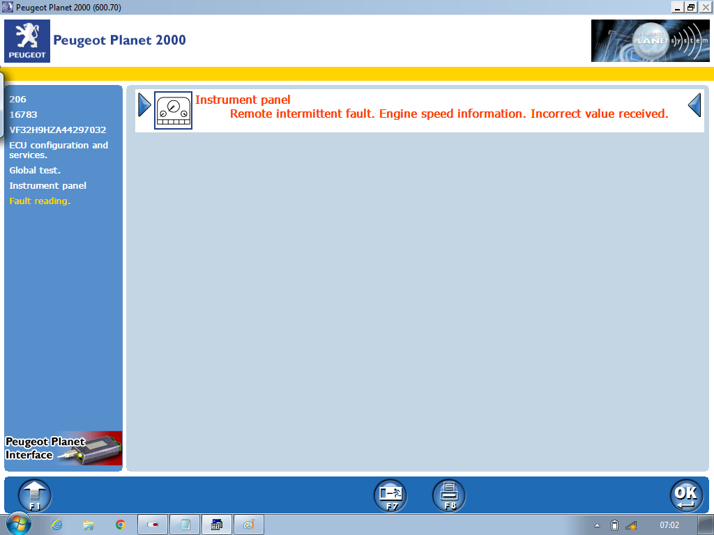

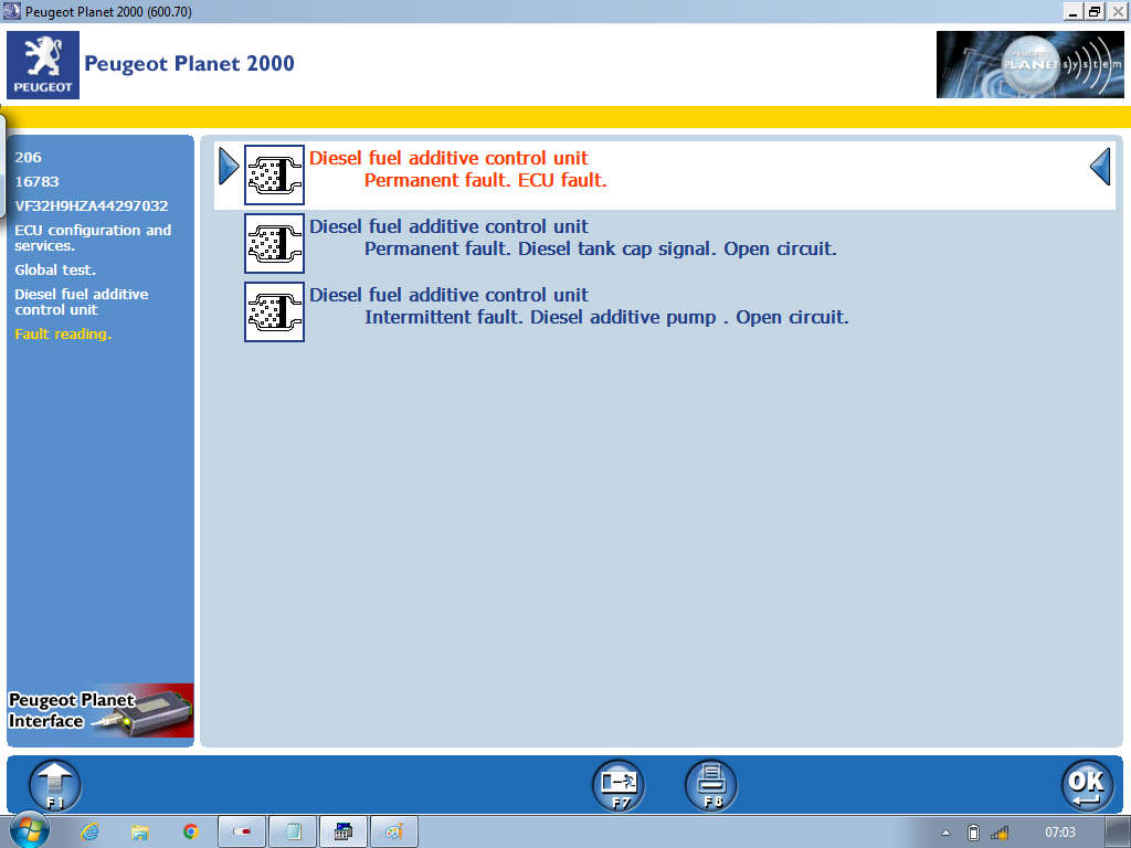

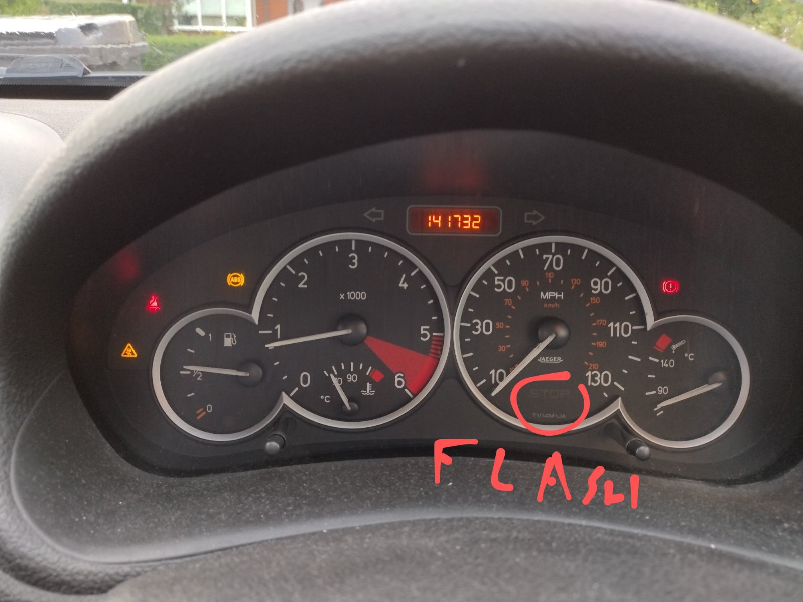

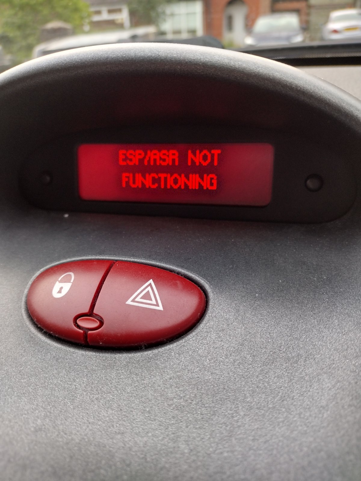

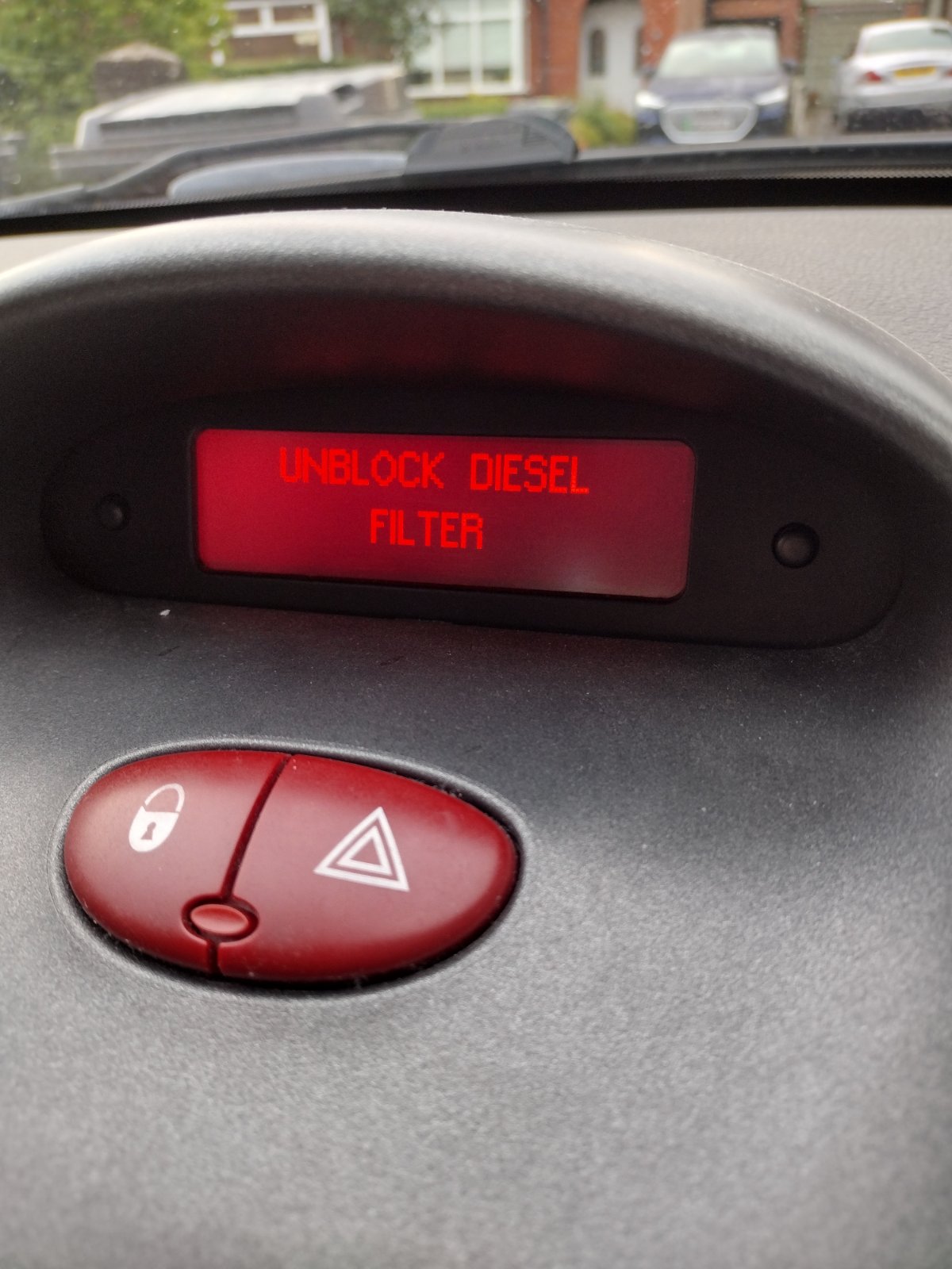

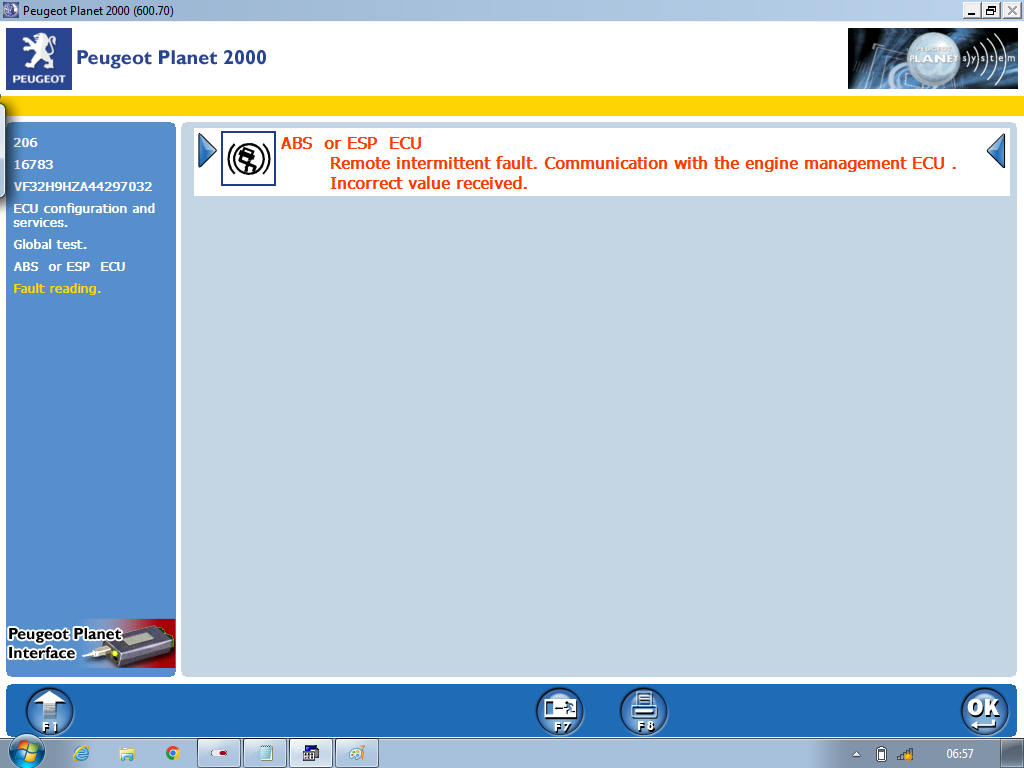

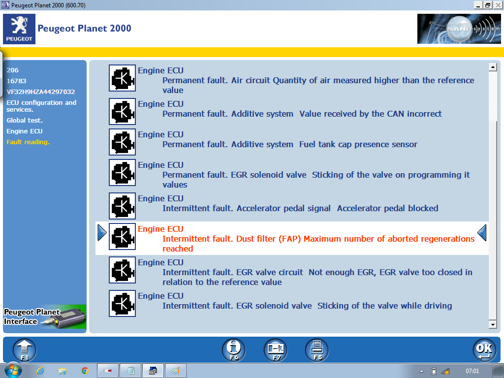

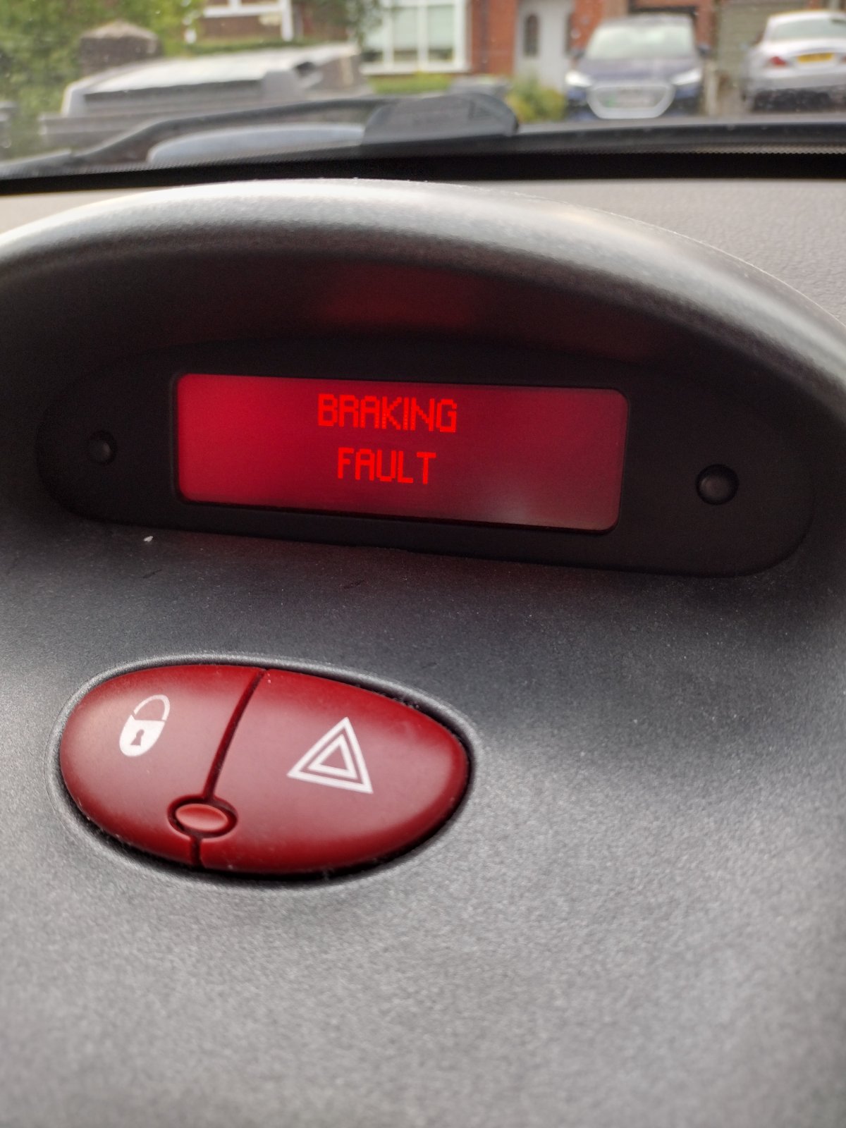

Symptoms described above but short version: driving along everything. Then, normal ABS fault on dash and car slowing down as though brakes applied (foot on throttle pedal, not brakes!) Clears when restarted.
I took it for 3 test drives and of course it refuses to play up on demand!
However when forming global test it seems to trigger the MFD and dashboard instrument cluster to reveal all. PP2000 print screens follow:
- Posts: 54800
- x 8196
Gosh, that's quite a crop of fault codes
Is this what I might have to look forward to with my new car?
- Posts: 5112
- x 2231
Comes with the territory to an extent JimCitroJim wrote: 28 Aug 2023, 12:39 Gosh, that's quite a crop of fault codesIs this what I might have to look forward to with my new car?
The tank presence sensor I'm also aware of too, the others I need to get my head around.

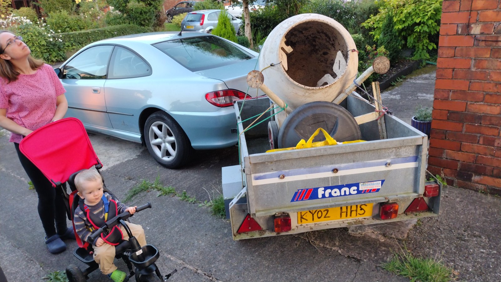

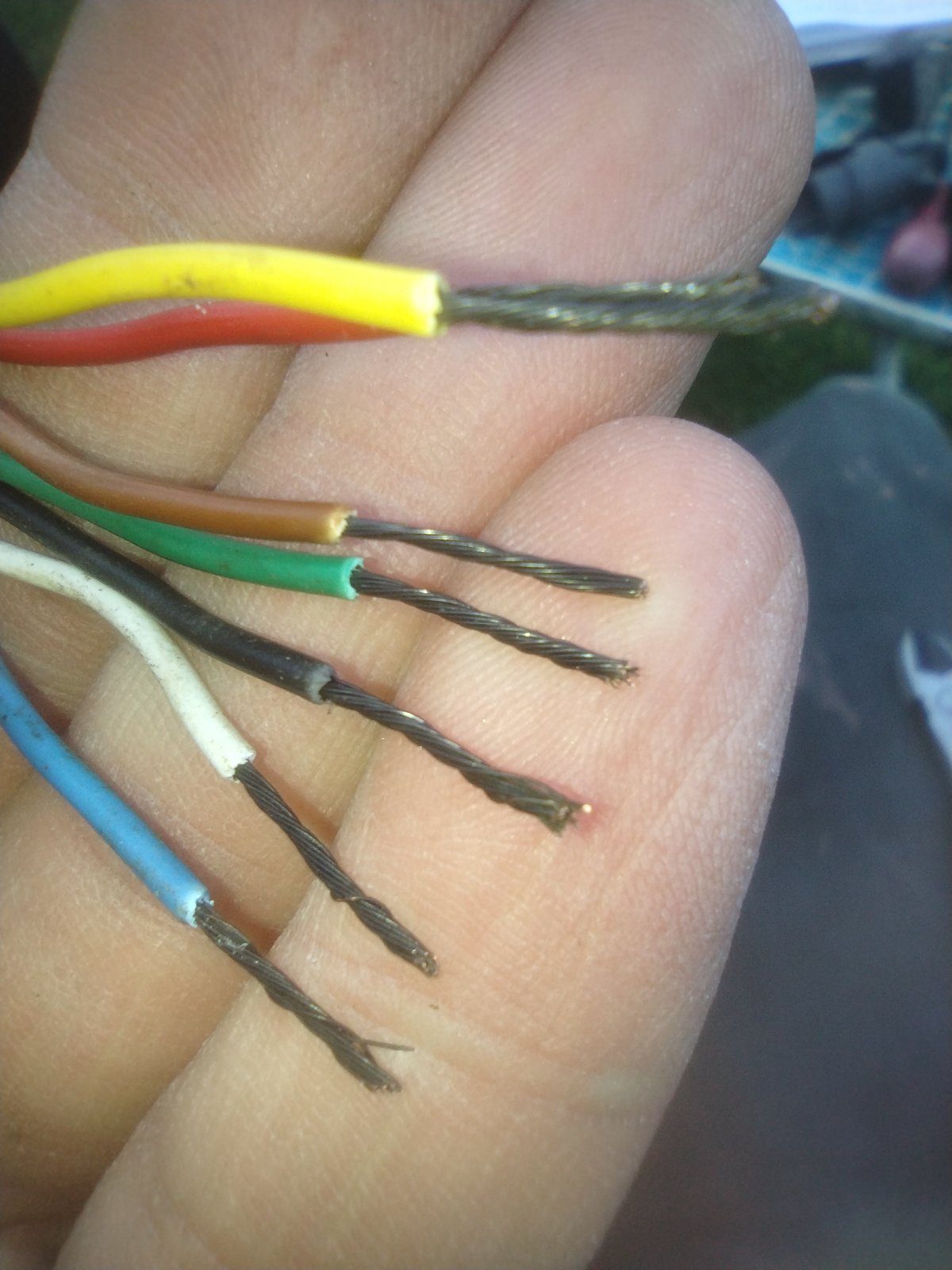

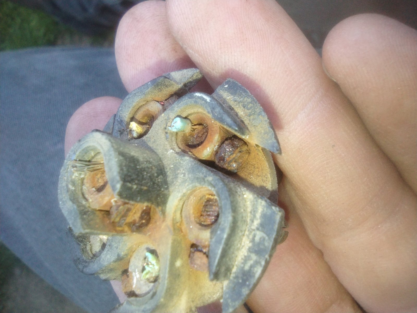

Wonder why the trailer lights weren't working (just snipped the wires from here, for some reason they wouldn't unscrew either!)
Did you ever see such a miserable oxidized bunch of conductors?
Wonder what I can do (other than shorten the cable to the point it'd be no use, so need complete replacement) to get any spangly copper on show

Don't be daft Matt, you've clearly not got enough metal around the rust!!!

Oh thanks Mick you have just ruined my night!! I'm now trying to think of what we used at Duxford to free up rusty parts after being in the ground for 60 years!!!! And no, it wasn't WD-40

I'm trying to remember if this plug was newly installed when I got the trailer (less than 4 years ago) - the lights were knackered and replaced, just can recall if the plug got swapped at the same time.
