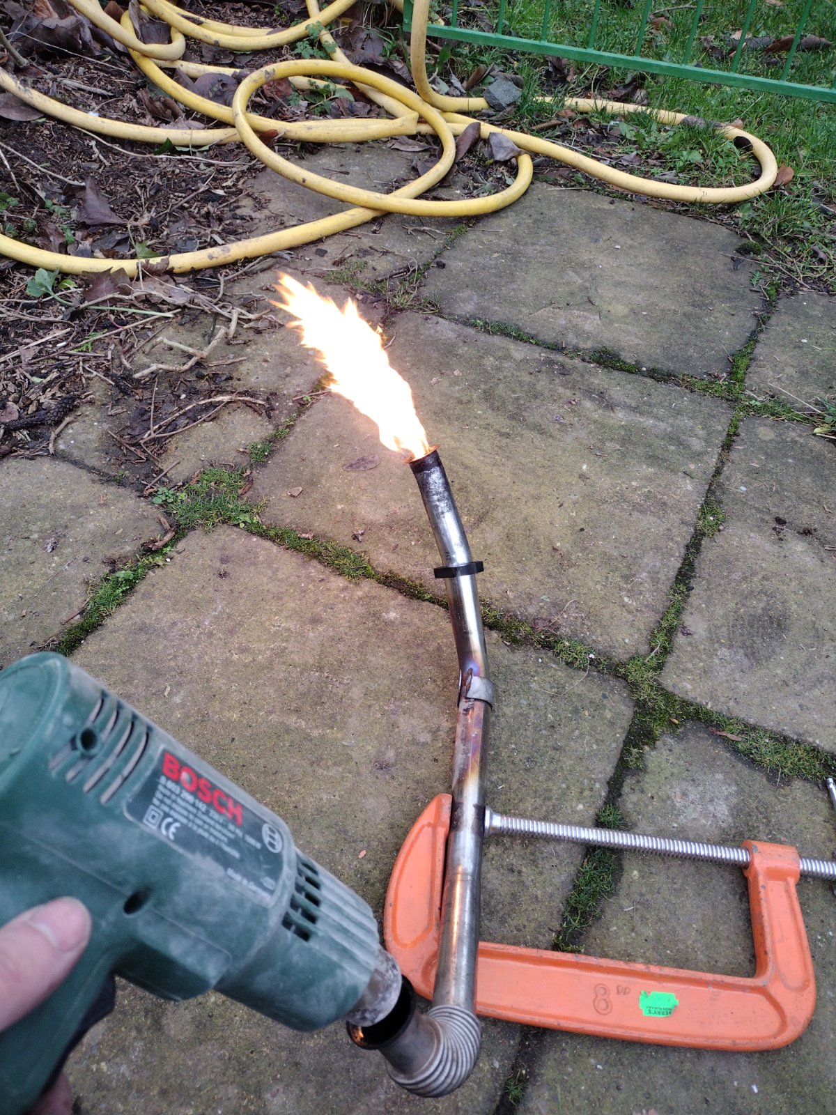

First step was to clean out the pipe, and for this fire is the answer. Heat gun down one end, roaring flame (and occasional glowing hot globules of carbon!) Ejected from the other, thusly:
Cleaning with fire
Cleaning with fire

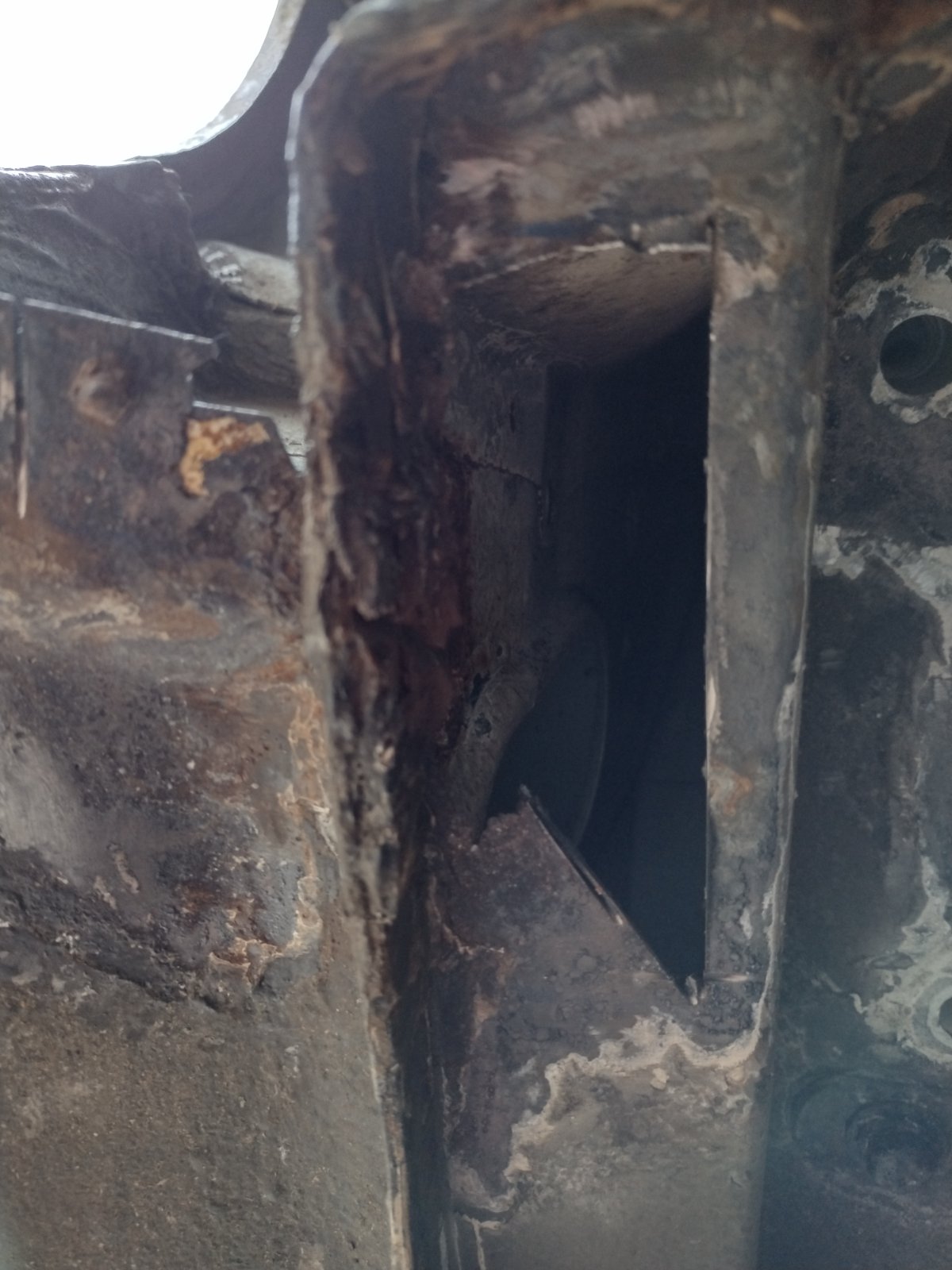

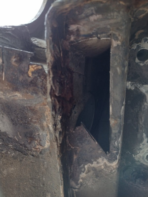

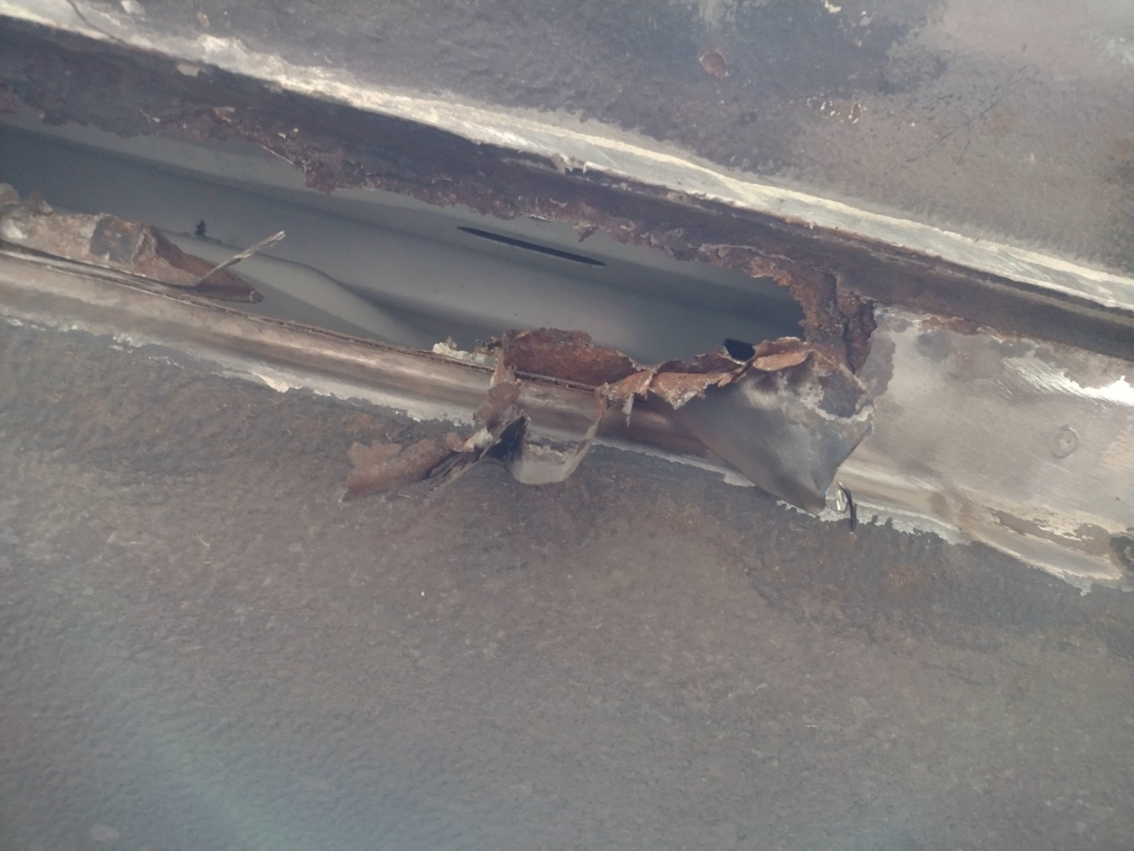

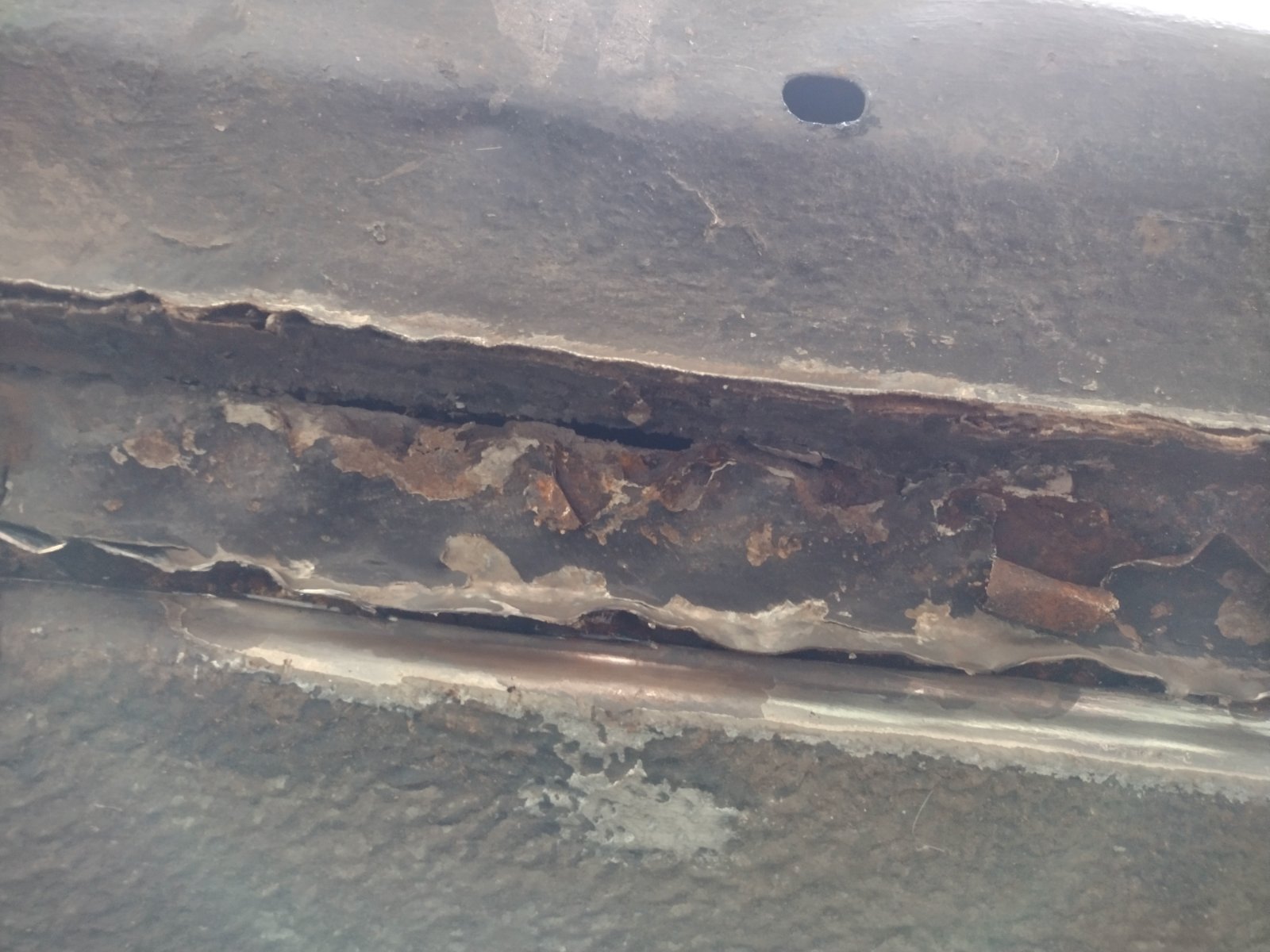

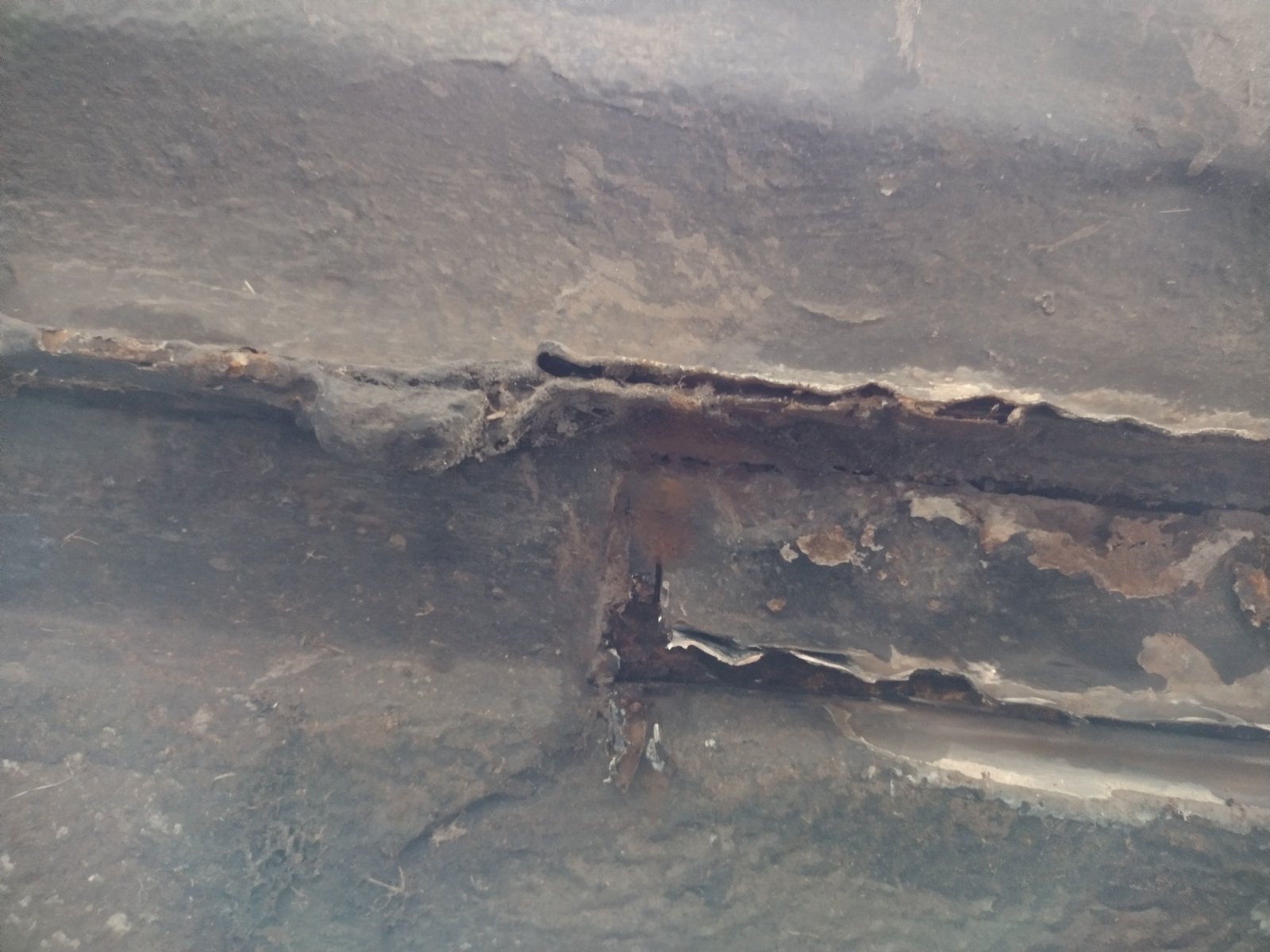

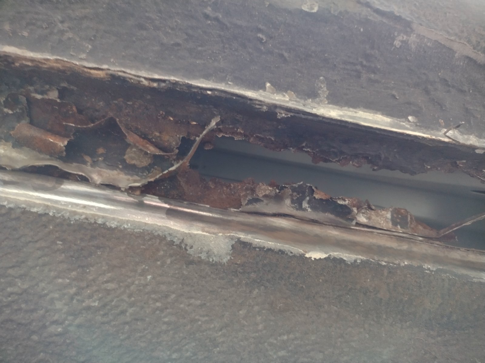

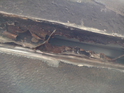

After that spot of progress, it was time to go backwards again with another look at the rust.
Further forward significantly worse than what the MOT man flagged up.

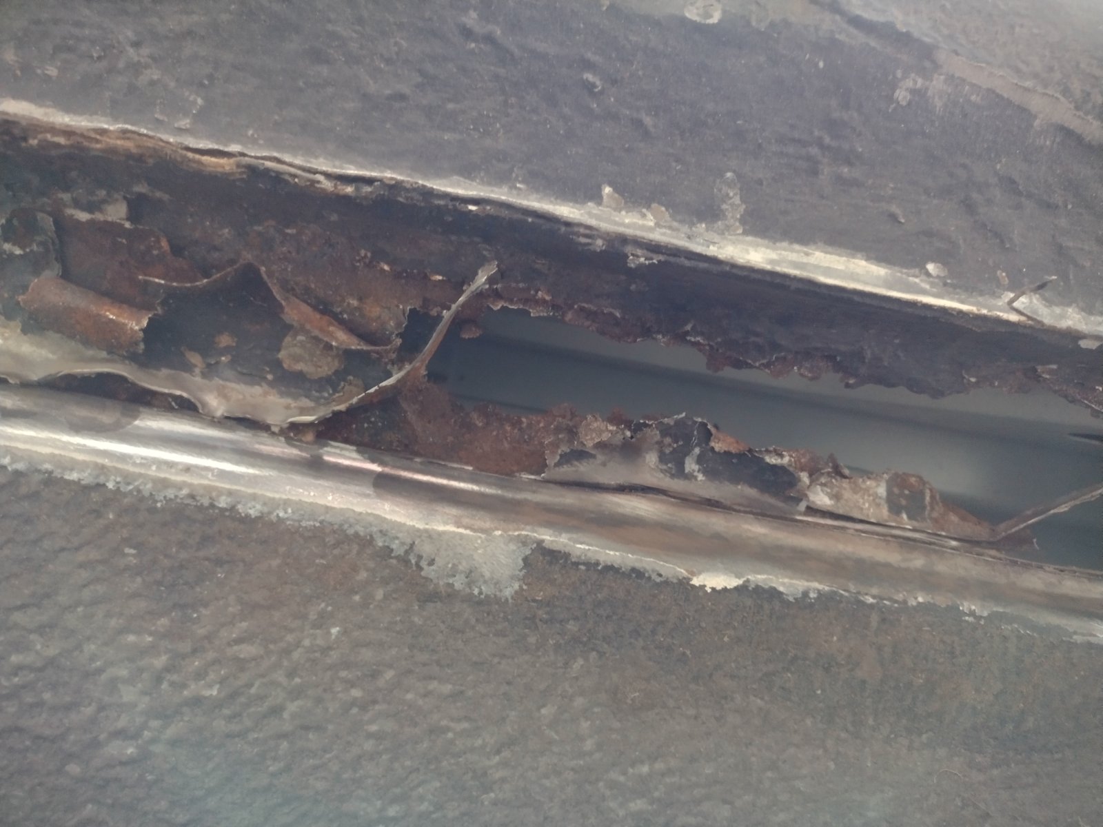

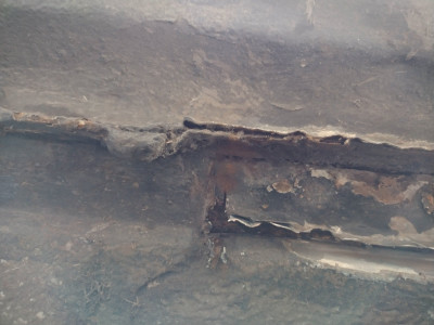

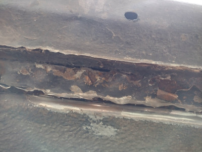

MOT issue:

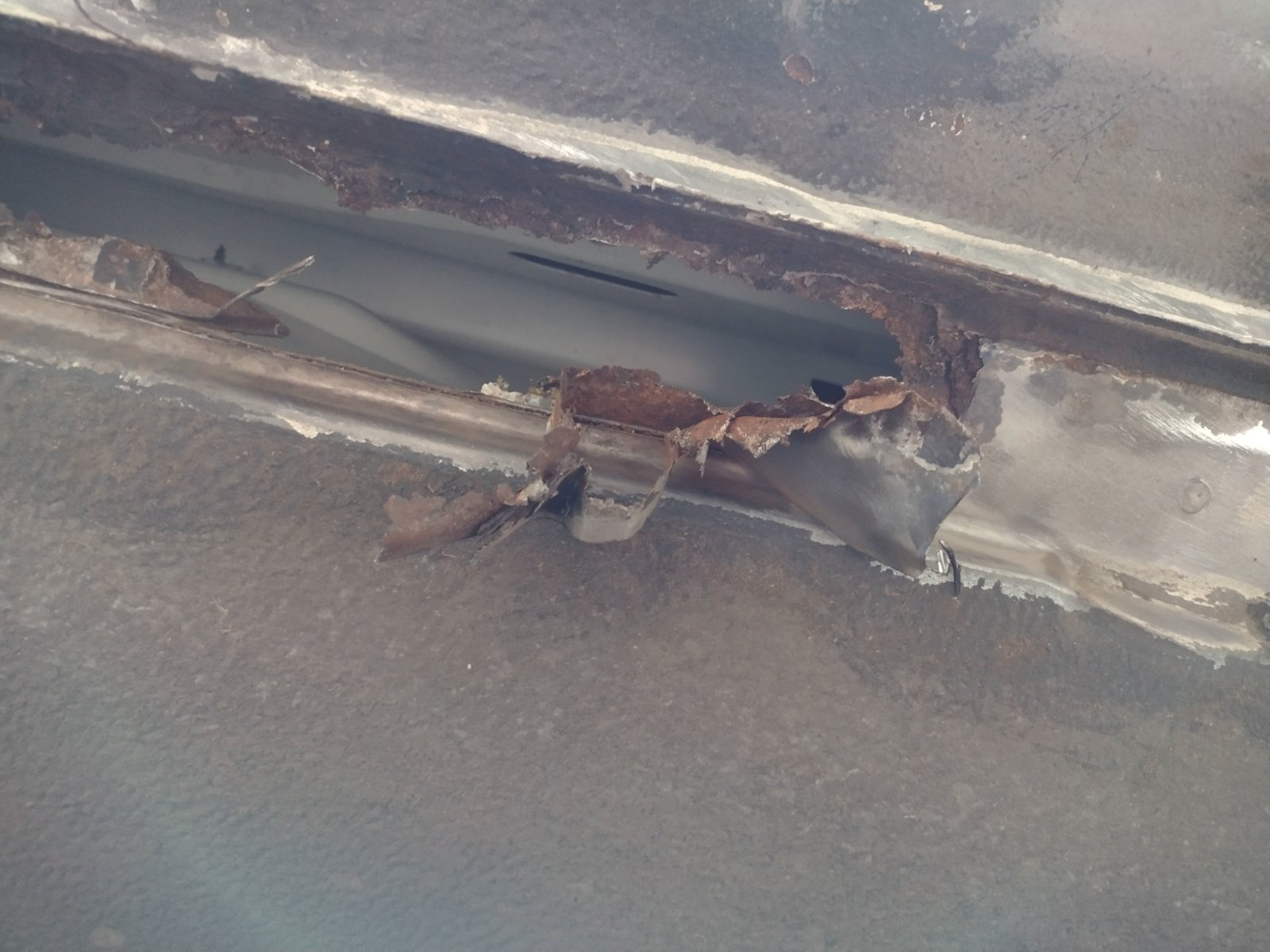

Further forward:
Posts: 21134
x 8116
Oooh! That looks nasty Matt, have you reached the "I've come this far............" stage or are dead horses and whips the order of the day? :-D

Loving how you cleaned that pipe Matt... The same method we used to clean our 100cc racing Kart exhausts although often we'd use oxy-acetylene as the carbon deposited by the use of Castrol R40 in the (rich) 2-stroke petroil mix made for some very hard carbon in the exhaust...
I've used the same propane torch method on 2-stroke motorbike silencer baffles. Ordinary mineral oil makes for softer carbon!
Your welder is going to be busy!

CitroJim wrote: 21 Dec 2023, 15:09 Loving how you cleaned that pipe Matt... The same method we used to clean our 100cc racing Kart exhausts although often we'd use oxy-acetylene as the carbon deposited by the use of Castrol R40 in the (rich) 2-stroke petroil mix made for some very hard carbon in the exhaust...
Interesting about different oils giving different carbon challenges, Jim, thanks! I'd be too worried about melting things with oxy-acetylene, the wall of the stainless pipe was glowing red in a couple of places with my method!
Had a propane blowlamp on hand, but this self ignited just with the electric heat gun (smouldered for maybe one minute first, then off and away!)

I couldn't tell what those photos were of. But practice makes perfect. Or would it be simpler to remove and fit a new part?
