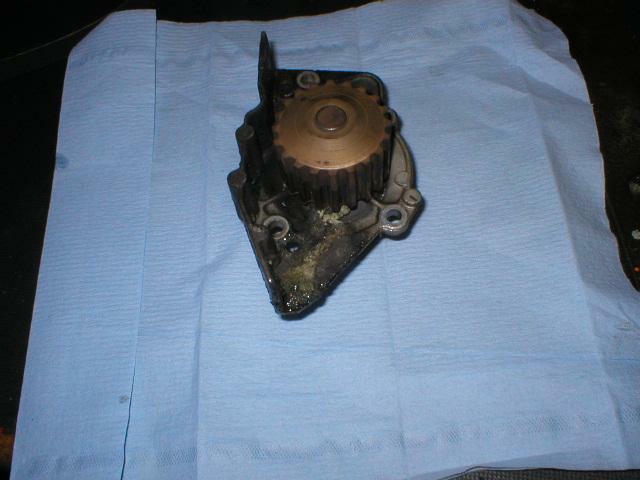

Indeed it is Colin :D I undertook some deep relaxation and battery charging today; I replaced the cambelt and waterpump on project Activa... A good dose of spannering always does the trick.
Good job I did too... The waterpump had been seeping at some time...
The crank pulley centre bolt was stupidly tight and I had to use the old XUD starter motor trick to loosen it. That's a first on a petrol XU. The bolt should only be done up to 80 ft lbs.
Another first was to find the crank pulley timing hole was exactly where it shoud be. So often they're a mile out.
But worse still, the cambelt was so loose it was almost ready to fall off. It was tensioned to 5 SEEM units instead of the more correct 45 :twisted:
The reason was due to a well worn tensioner which oddly was running silently but it sure had plenty of play. Luckily, I had a serviceable one that came from Robyn's 206; they're the same remarkably!
