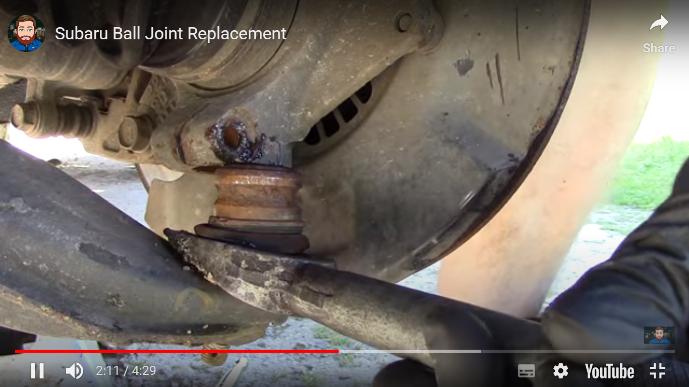

If you happen to tune in to this before you get started a few thoughts if your activity starts to frustrate.
I have seen YT vids of the struggles with Subaru ball joints. I'll shove one in the spoiler...starting at the bit where the ball joint gives in, where a pickaxe blade combined with the force generated by the cars own force by compressing the suspension on a jack and then releasing the tension with the pick axe blade wedged in a position to exercise the force in the right place.

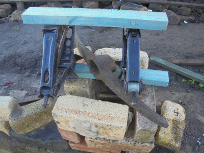

Couldn't really remember the set up there Mick so don't know if this helps.

That one is going on toolbag tales too....excellent find gibbo...like his style!
"hope I don't find one on the Snap-on truck for 80 bucks in a years time"

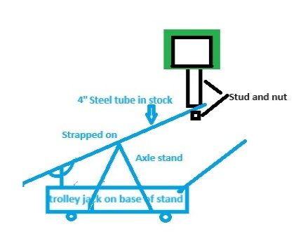

Thanks Gibbo for the idea, it is exactly the same setup as mine so if I can take the principle and come up with something that won't need welding or a slide hammer but pulling on the stud it may be the way to go. This is my first thought comments invited:
The main issue I can see is drilling the end of the tube to accept the stud and then that in theory the pulling force will be in an arc but the distance to pull is so small I don't think that will matter!!

With it being so stuck, the shock of the hammering which so far hasn't worked you would think would be more effective than the gradual pull, but hopefully your proposal will work.
I did say I would put in a spoiler the pickaxe method. I've got two of that particular tool lying around at chez falcon minus the handles! Last resort-the pickaxe method

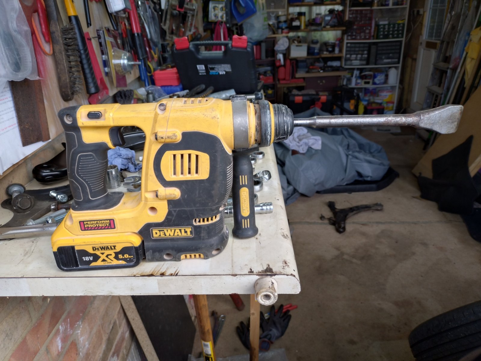

That method separates the ball joint from the arm, that is not my problem as I am replacing the arm and ball joint. I just need to get the joint out of the hub. The other side came out with a few taps of the club hammer but this one has so far survived everything I have thrown at it!! However I have just borrowed a Dewalt battery powered hammer which is my next move to hammer all round the joint and hopefully free up the corrosion!! If that doesn't work by itself I am going to rig up that seesaw plan and then, once I have created sufficient pull, have another go with the percussion hammer!!
Watch this space!

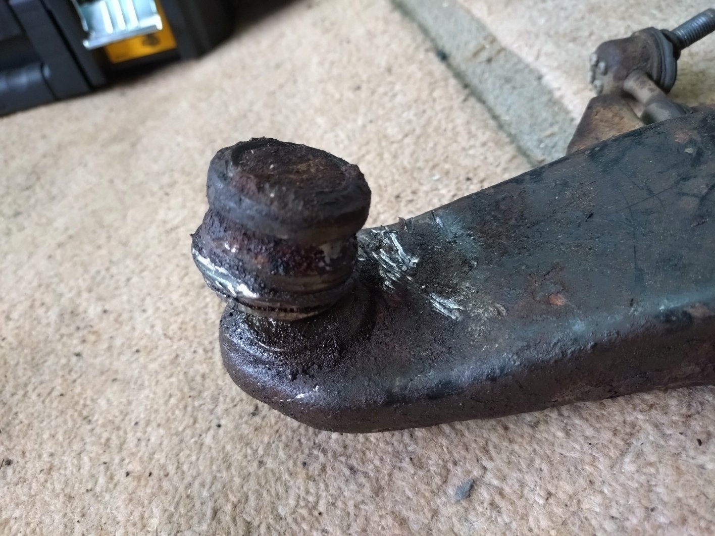

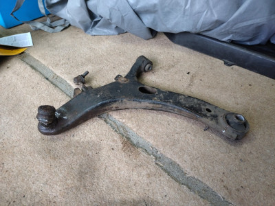

Eureka!!!!
Who needs posh pullers when you have a battery hammer?
This is the offending bit, much cleaning of its socket before the new one goes on!
And the winning tool, applied to the exposed lip
So now after a celebratory glass of wine I shall go and clean it all up and fit the new arm, then just need to book it in for laser alignment and it will be ready for Wales!!

I used the hammer around the casing of the knuckle with a blunt tip and then put on the sharp tip and attacked both the lip and the arm itself. It didn't actually give way during the hammering but I sensed it was loosened so I removed the inner pivot bolt and the back mounting so the arm was hanging on the ball joint. A couple of up and down wiggles and out she came!! 15 minutes in all!
I then cleaned the inner surface of the knuckle until it shone and applied anti seize copper grease inside. The new joint slid home by hand only and my temporary pinch bolt went in and secured it. I then installed the arm with the aid of my small jack to raise the inner end up to its pivot while keeping the hub aligned as necessary. Refitted the rear mount, installed the drop link and then the pivot bolt. Torqued as per the manual although I'm not sure my torque wrench is that accurate anymore, well it is 45 years old!! I have ordered a new one so I'll check the bolts with that when it arrives next week!!
I then took the car for a test drive and it is beautifully smooth although the steering wheel is 3 or 4 degrees to the right. Not surprising considering I have now replaced all the front bushes, both track rod ends and the ARB mountings and drop links front and rear! It will be booked in for laser alignment next week and I will fit the new air filter which still hasn't turned up so I'm going to go up to Cambridge on Tuesday to get the pinch bolt and hopefully the filter which is paid for but not delivered as promised. Words will be had!!
