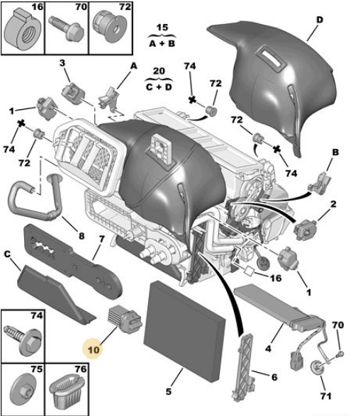

Re: Fan ressistor c5 2009
Ok, that's better!
So same as per the link in my previous post, part number 6441S7: Item 10 below: £141.84 UK Sterling from Citroen - there are cheaper ones out there - but beware of any too cheap!
Instructions for removing in the link in my previous post.
Thanks! But out of this diagram Its difficult for me to locate where it is ? Can you possibly give me more information?
Its on the driver side behind the pollen filter?
- x 6957
In my post before your VIN I provided a link:
viewtopic.php?f=3&t=55875&hilit=blower+control#p499891
it's all there... Diagram is for a left hand drive so will be as you see it - the same side - driver for left hand vehicles and passenger side for right hand drive vehicles.
