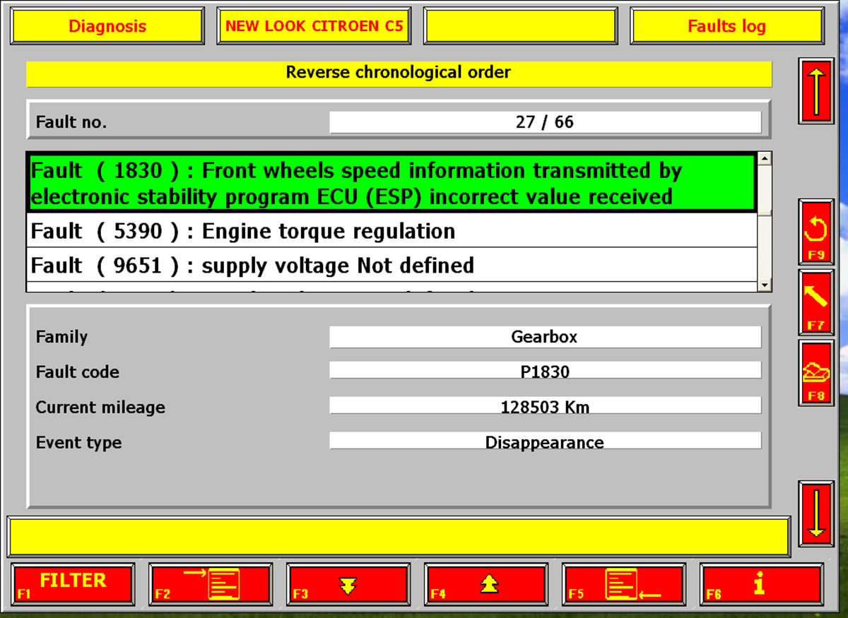

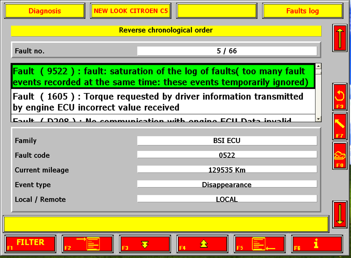

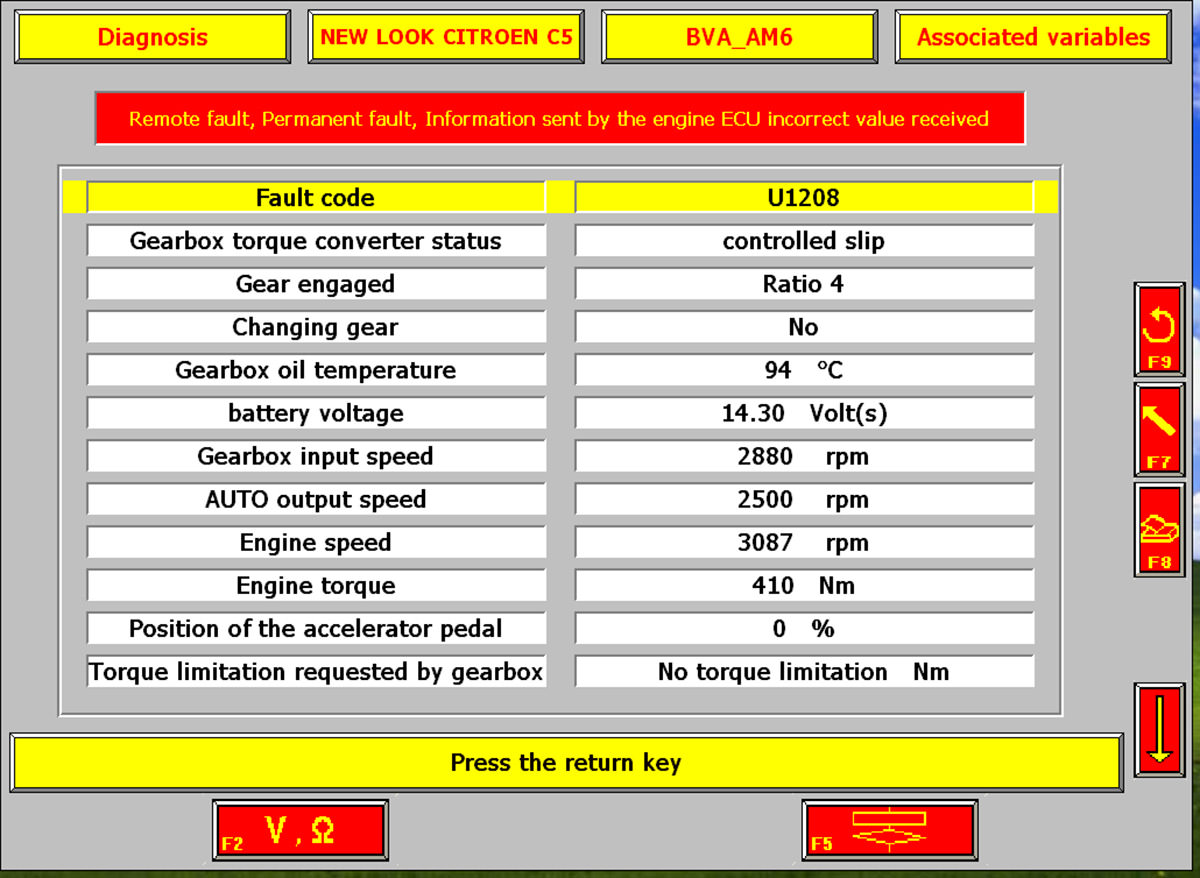

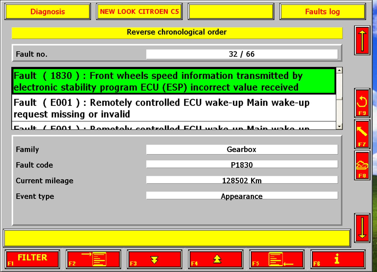

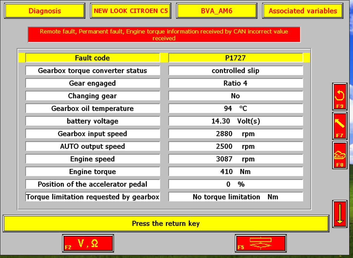

I then hooked up the Lexia and found various faults listed but the main theme was the Engine management system communication giving wrong or no data to the other sub system, interesting one was “Too many faults happening together can not log them so they will be ignored.”
Some of the error code were:
Fault D208 No communication with engine ECU Data invalid (Family ABS * )
Fault 1165 Fuel Pressure Signal Pressure too Low
Fault 9522 Saturation of the log of faults BSI ECU (Too many fault events recorded at the same time: these events temporarily ignored)
Fault U1208 Remote fault, permanent fault, information sent by engine ECU incorrect value received
Fault 1605 Torque requested by driver information transmitted by engine ECU incorrect value received.
Fault P1727 Engine torque information received by CAN incorrect value received.
Fault 1830 Gearbox issue, Front wheel speed information transmitted by ECU (ESP ) incorrect
Fault 5390 Engine torque regulation
Fault P05D2 Remote fault, Temporary fault, Data invalid engine ECU incorrect value received
Fault F406 Engine oil pressure sensor
