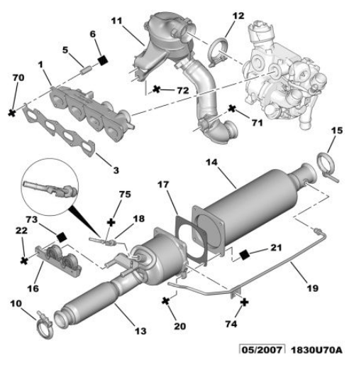

can anyone give me the OEM part number for a DPF ... 2009 x7 2.2 hdi 173bhp engine number DZ604006932

The Citroen original part number (item 14) for your car (we use the VIN
which I have from your last query, not the engine code) is 1706G4. Current price from Citroen is £836.10
There is also an exchange unit part 16 113 231 80 at £431.16 - all above include VAT, but it is unclear whether the latter one includes or excludes the surcharge fee.
Anyway searching on these will give you alternatives.

Re: OEM Part Numbers
Thank you 105545 miles.. there is no warning light up yet,, just the fuel tank access not properly locked , but after looking at the Lexia it says characterisation of the fault .. particle filter overload .. so I recon its just a question of time and wont to get something done now,, the PEF differential pressure is at 0047 MBAR.. do you know what it should be that's at 1703 rpm... the downstream temp on the Cat is 095 c ...
