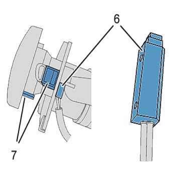

You should have the Bosch EDC16 CP 38 Injection system in your X7.
These are the magnets on the cap and the electrical connection to detect when the cap is opened.
