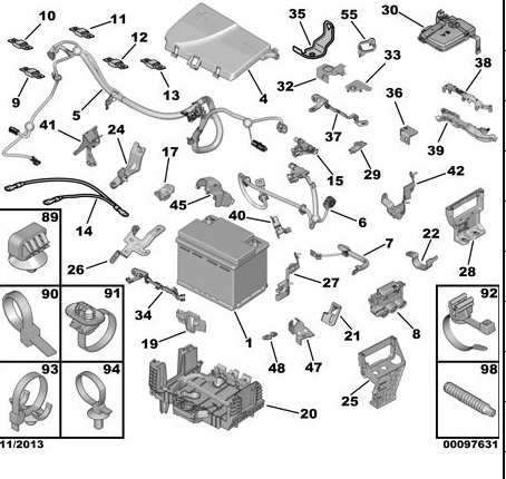

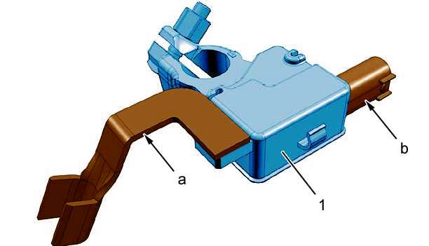

Absolutely a weak battery is a big no-no on the X7. Too much going on prior to and after the car is locked, so will always drain slowly. I trickle charge mine (on the vehicle is recommended and make sure that the negative charging paddle is clamped to the battery charge status module - not the negative battery terminal directly). This is so the charge status control unit can accurately determine the charge state prior to and after charging. It incorporates a voltage sensor and a power sensor.
So in the above, clamp the negative charge paddle to to 'a'

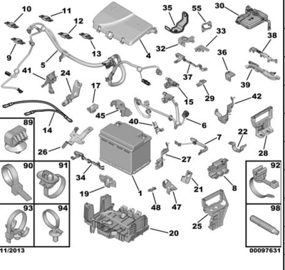

Interestingly my car does not have that fitted.
- x 6956
Re: My C5 is Giving Power Steering, suspension and Other Warnings - Battery?
Have another look Alasdair - part 15 - and still in use up to the end of production on all models.
If not, I can only suggest somebody has replaced the battery wiring and not replaced the unit.
I'll get a photo of mine tomorrow and post it - diagrams can be deceiving.

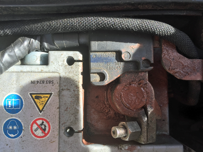

- x 6956
Sticky - Here's the one from my car - and that's Copper Ease, not rust by the way
