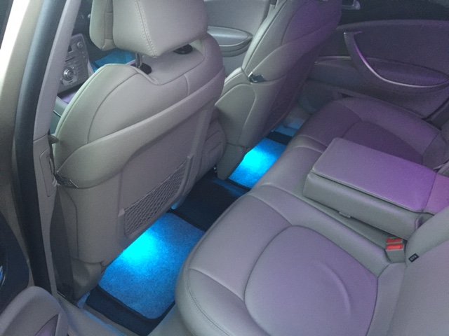

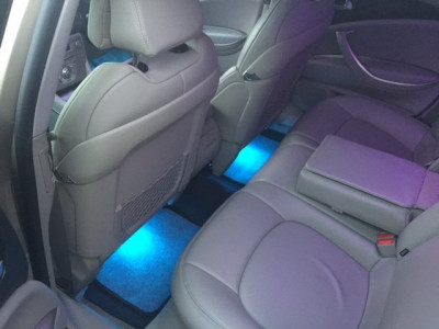

I have LEDs on my number plate lights - they provide a much crisper and cleaner light. It also gave me the opportunity to clean the lense covers and bulb holders out as they were quite grotty.
I used the following as they are a 'wedge' type W5W fitting and can also be used for the door, pavement, footwell and other interior lights, so if you wanted to change the lighting inside the car as well as optionally the colour, these will do, Available in White and a range of other colours (for interior).

How did you manage to replace the rear footwell lights? Replaced all other w5w bulbs but haven't figured out how to remove these ones?
C5 X7 Exclusive 2.0 HDi Auto
- x 6948
Re: Regarding plate bulbs
The underseat driver & passenger seat lighting? The bulb holders are clipped up with a very tight cable tie. Putting the front seats forward and inclining the seat backs also makes more room.
It's a matter of getting a bright LED torch and getting your head under or use a mirror to unclip the cover and put the LED in.

Did you cut the cable tie?
- x 6948
Yes, then used one of my own to gently keep the cables tidy - but didn't put it up as tight as they had.
