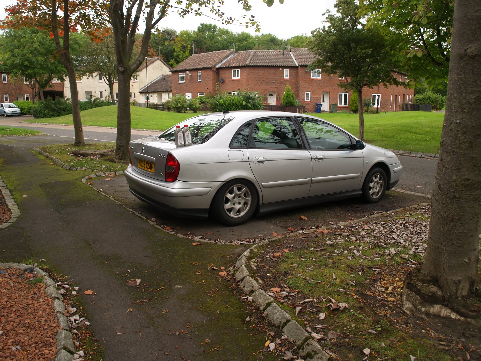

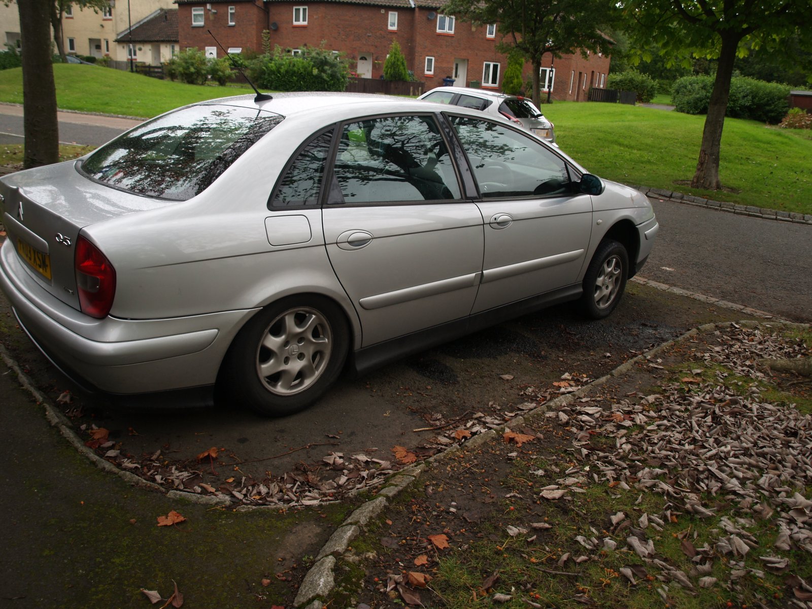

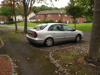

Went out this morning to find the car squatted down at the rear.
Reservoir empty.
Had to walk for almost two hours to my motorists shop, only to find it had shut down :(
A further walk to an industrial estate drew a blank too so a further walk to Halfords netted me 2L of Comma MVCHF which is touted as an alternative and is light green, which made me think of Citroenmad's (Chris) experience with his first C5.
That did nothing so returned to Halfords and bought their last 2L of the MVCHF and dumped that in - still no rising of the rear :( and a respectable pool under the car.
I suspect that the new and vicious speed bumps installed near work may be responsible.
Contacted my mechanic and awaiting advice - problem is it can't be moved until it gets up off it's arse.

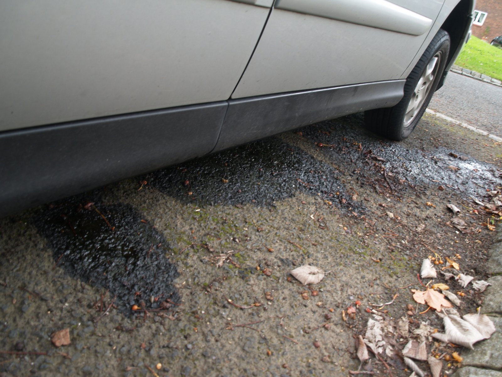

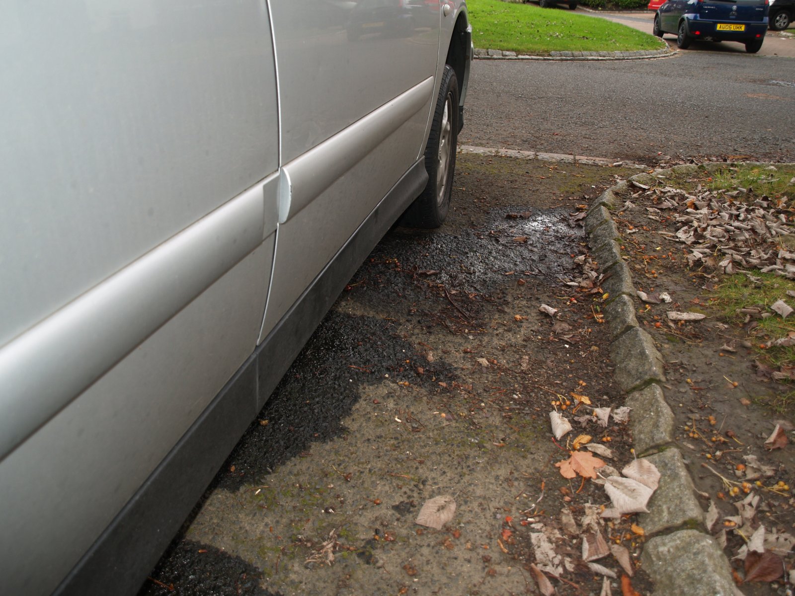

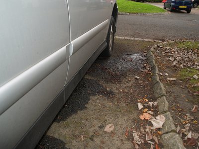

Just had a closer look and took some more photo's - just in time as it is now chucking it down again.
I think I was wrong about it being rearwards, it seems as though it is running down the sills and dripping off due to the rear end being so low.
x 6950
Re: C5 suspension grump
So the front seems to be stabilised, so possibly one of the pipes feeding the rear. Very little you can do as you say until it's lifted off the ground. I hope you don't have to wait too long for the mechanic. Has he got a flat-bed to get it to the garage?

I'm assuming that it is those silly McPherson struts shoving the front up while the trailing arms allow the rear to settle lower.

Was able to jack up the front a bit and shove a light and a mirror under - even crawl under a bit but still none the wiser as to the source of the leak.
At least it doesn't appear to be the rack and is probably a suspension pipe out of sight without the car on a lift.
x 6950
Yep, hard to tell if it's leaking in one place and pooling in another because of the angle. Good news if not the rack - fingers crossed it might just be a split pipe.
