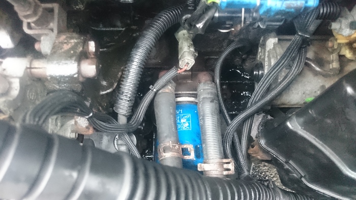

First job is to find the cooler. It's mounted on the front of the engine block, sandwiched between he block and the oil filter. It has two coolant hoses on the top of it, and the oil comes through the middle (this will become clear later).

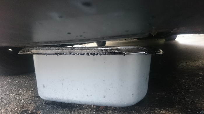

Now is the time to place the bucket underneath to catch runoff. Some of the oil will travel along the oil sump, so make sure it's a bit further back.

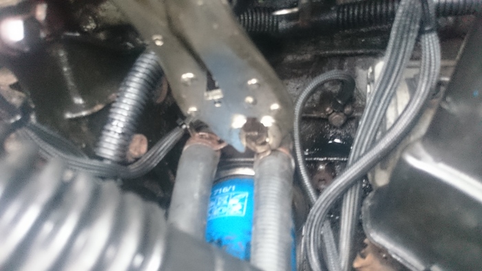

Remove the hose clips on the coolant pipes by squeezing the tabs together.
Slide them backwards, being careful not to damage the hoses.

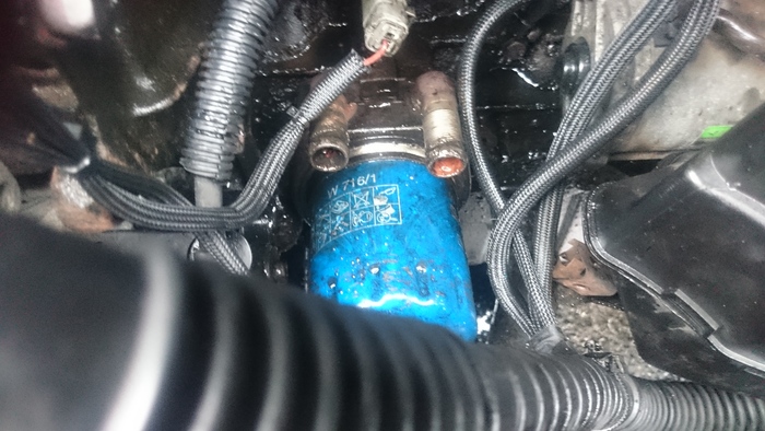

Once they're off, remove the coolant hoses by sliding them off. If they're stuck, don't pull at them. Use a set of mole grips around where the hose was clamped onto the cooler and gently wiggle the hose until it loosens.
Lots of rust on mine, and black on the left one. Not good signs that it's in good nick.

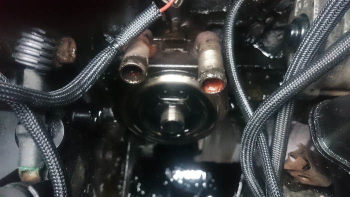

Now remove the oil filter by rotating it anticlockwise. Use appropriate tools if it's super tight. You should then see the front of the cooler with the bolt running through the centre.

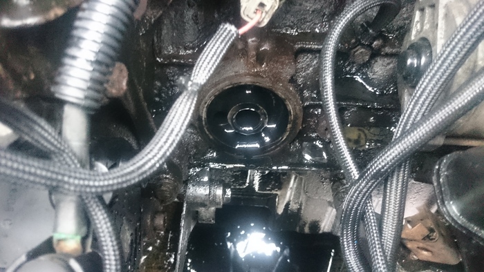

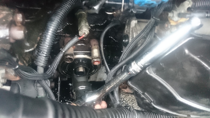

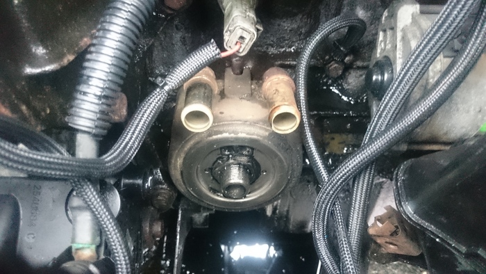

With a 27mm socket/spanner, loosen the nut until it can be pulled out. It's not attached to the cooler, but the cooler will drop when the centre bolt is removed so be ready to grab it.
Leaving you just the engine block with exposed oil channels.
Obligatory "Refitting is the reverse of removal". Place the replacement cooler on, reinsert the bolt and tighten (anyone want to let me know torque rating?), add the filter back on, reinstate the coolant hoses and put the clips back.
